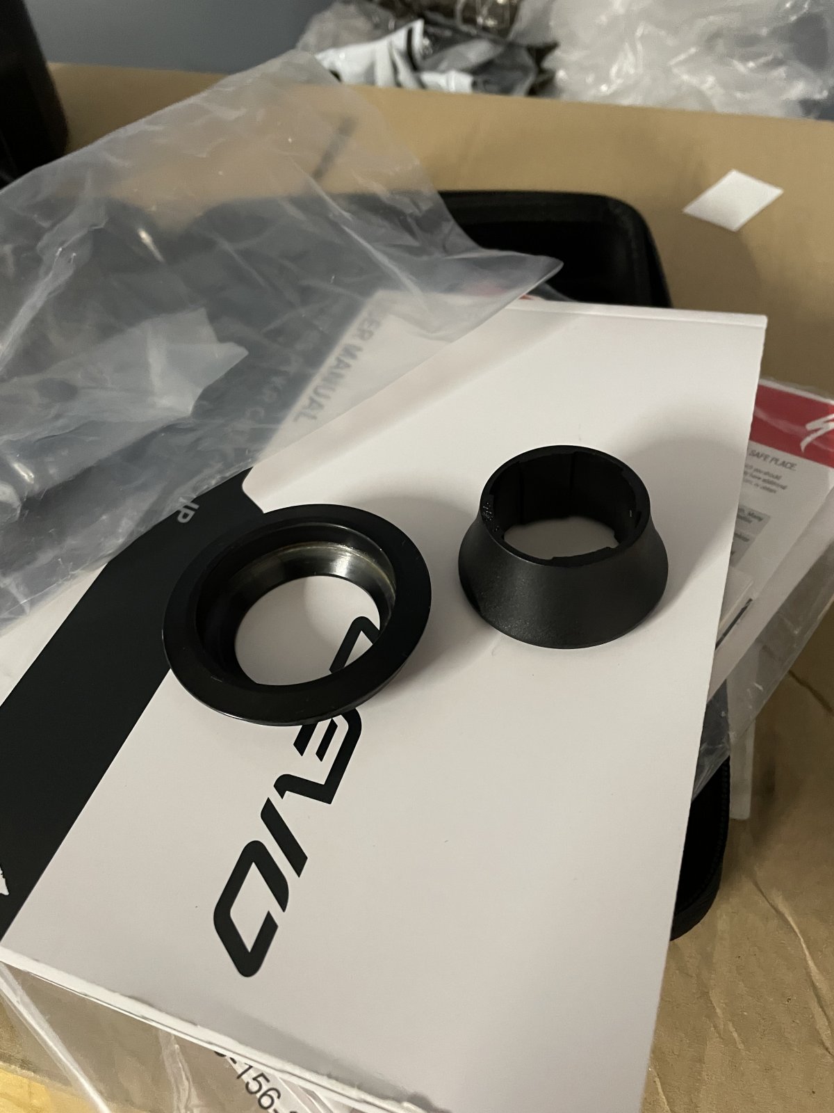

Yes, it comes with a head set and the angle adjusters so you can run -1, 0, and +1 degrees. It also comes with the SWAT tool that fits in the head tube. This is for a frame set bought in the USA.

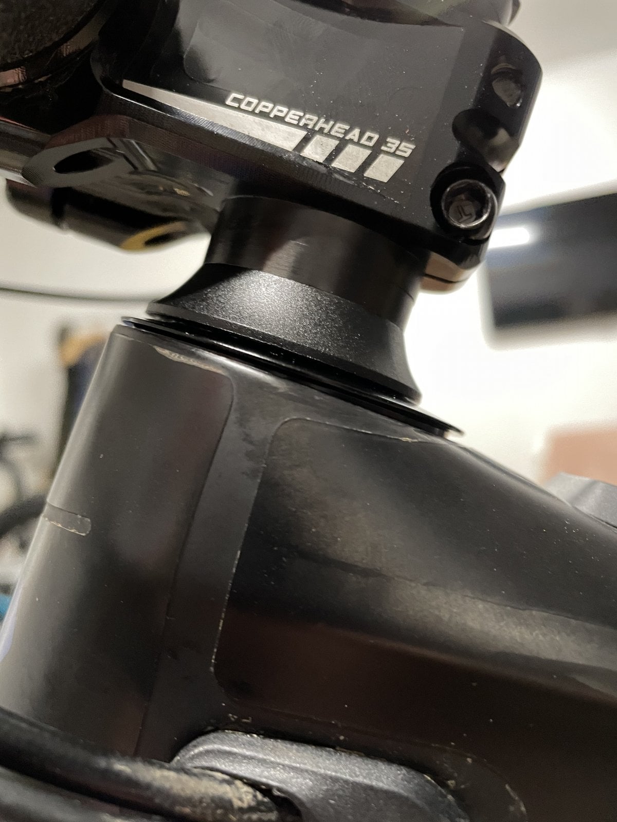

Hi, I have some questions around the +/- 1deg headset cups. Has anybody got the lip of the cup to sit flush with the frame. Here is mine, just cant get it to sit flush:
I can tap it in flush before the fork steerer is installed but as soon as the steerer is in and its all nipped up i get this gap. Like there is a bit of leverage from the steerer that will nolonger allow it to sit neatly. Which leads to second question - possibly linked. In putting the +/- headset cup in I’ve used the steerer spacer that comes in the bag with the spare cup (actually there are 2, a shorter and a taller spacer). These spacers have a small compression o-ring around the outside edge and fit snuggly into the cup inner diameter. So its a better fit in terms of sealing out water etc yet the bike didnt ship like this and leads me to wonder why. Are these specifically for the +/- headset or just an option? There’s nothing in the manual about them as far as i can see.
When i first fitted the slackset cup with the standard fsa top cap i felt a slight bit of play, but less so with these proprietary spacer things - in fact doing a wee test in the garage it all seems snug…..but I’m paranoid about headset play and hate seeing any small gaps in the cups. Just doesn’t sit right (pardon the pun, i’ll get my coat 😀).
14,171
21,078
I think that might be normal. It's come up with levo's and Kenevo's repeatedly over time where people were convinced it sat flush before they did something. Obviously they're not the adjustable/exchable versions, but they generally sit with about a 0.5 - 0.1mm gap.
Surely you have to change both the upper and lower headset cap to change the angle of the steerer. I dont understand how it can be achieved by just changing the the upper cap.....the lower cap will keep the steerer at its original angle??
Jamo
Jul 25, 2020
65
29
Fife
the lower cup/bearing is a conical seating to allow it to adjust 👍
Mikerb
May 16, 2019
6,745
5,218
Weymouth
In which case it will need to be rotated to suit whatever top cup angle is used. It looks like the OP has fitted a steeper top cap but not rotated the lower cap so it will not sit properly.
Gutch
Sep 10, 2018
453
242
South Carolina
Hmm, I never rotated my bottom cap? Mine looks identical to the OP.
Mikerb
May 16, 2019
6,745
5,218
Weymouth
The manual specifically says to do nothing with the lower cup and bearing, as it self adjusts

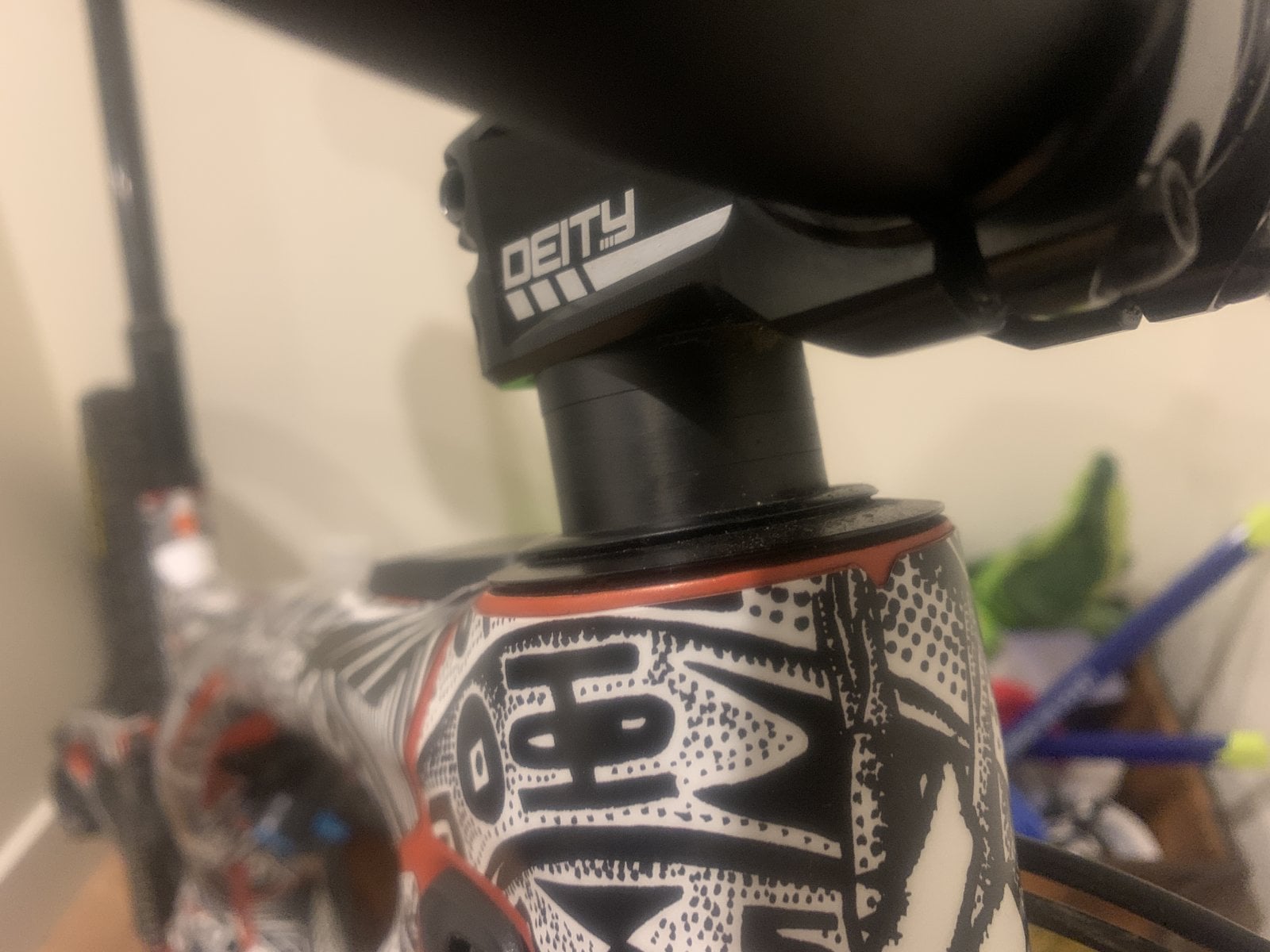

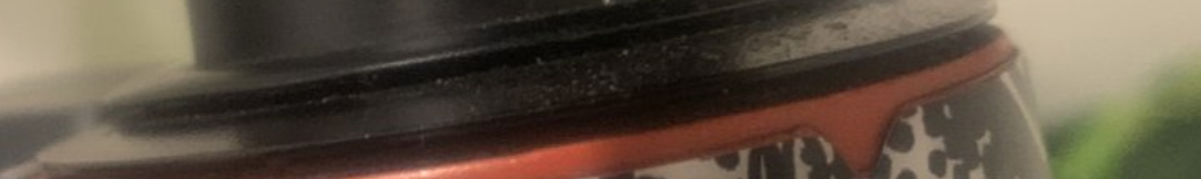

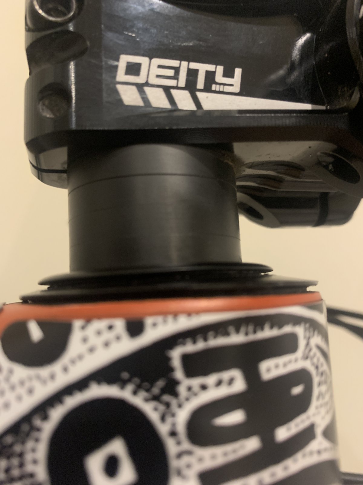

@Squamish Sucks thanks very much for that, agree it has the same gap. Interestingly your gap is at the front of the cup, so i guess you’ve made it slacker and the lever effect is lifting the front. I’ve made mine 1 deg steeper so makes sense my gap is at the back of the cup. Cheers again.

@Jamo Gap is normal. I have the -1 in mine and it’s the same. No need to do anything to the lower cup, it’s self-aligning.
