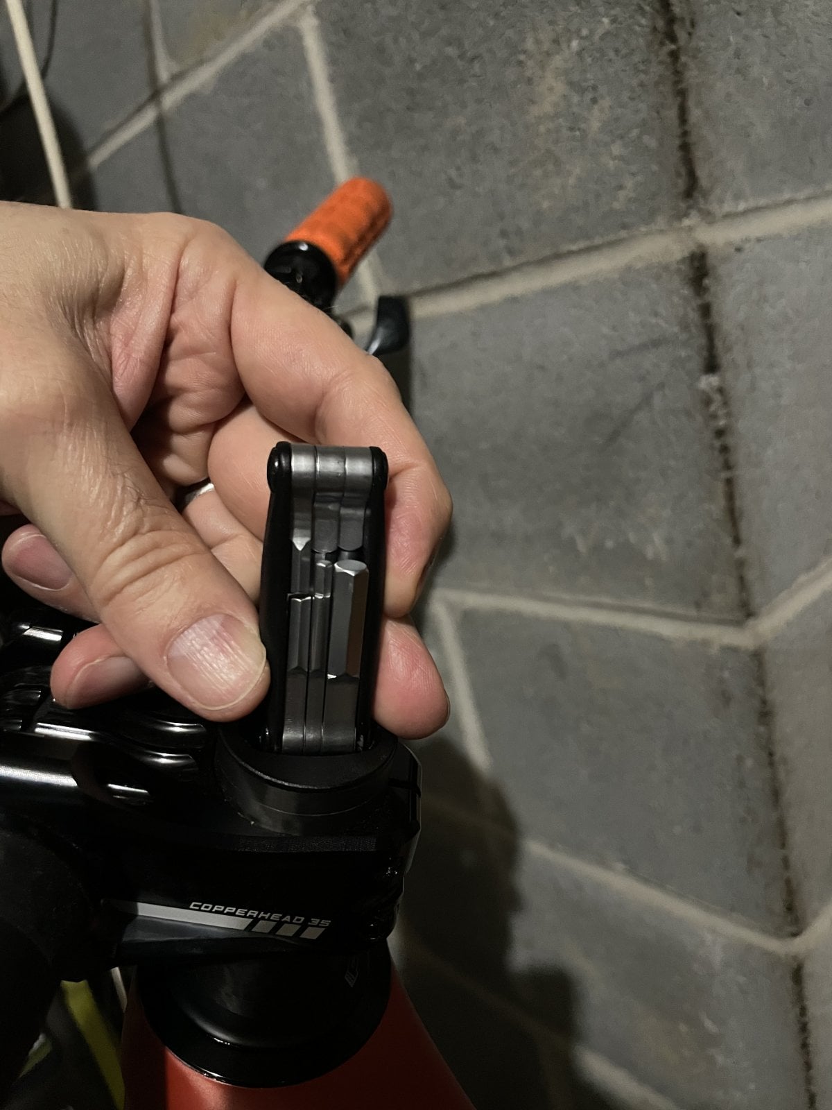

Thanks for this extra info, I did force close it and reopened it but I recon the force closer then made the app not work hence having to delete and reinstall it, the bike has another fault despite the warning update, the multitool won't extract from the stem, upon examination and measuring the holder for the multitool, it is slightly bent causing the tool to stick. I'll never buy a specilized ever again, I hope specilized are reading this. I can't believe all specilized concept stores aren't aware of the app issue, though I guess they'll need it back just to confirm it's not the bike.
The stuck multi-tool problem can be solved by inserting it with the largest hex key facing left and back, as in photo
