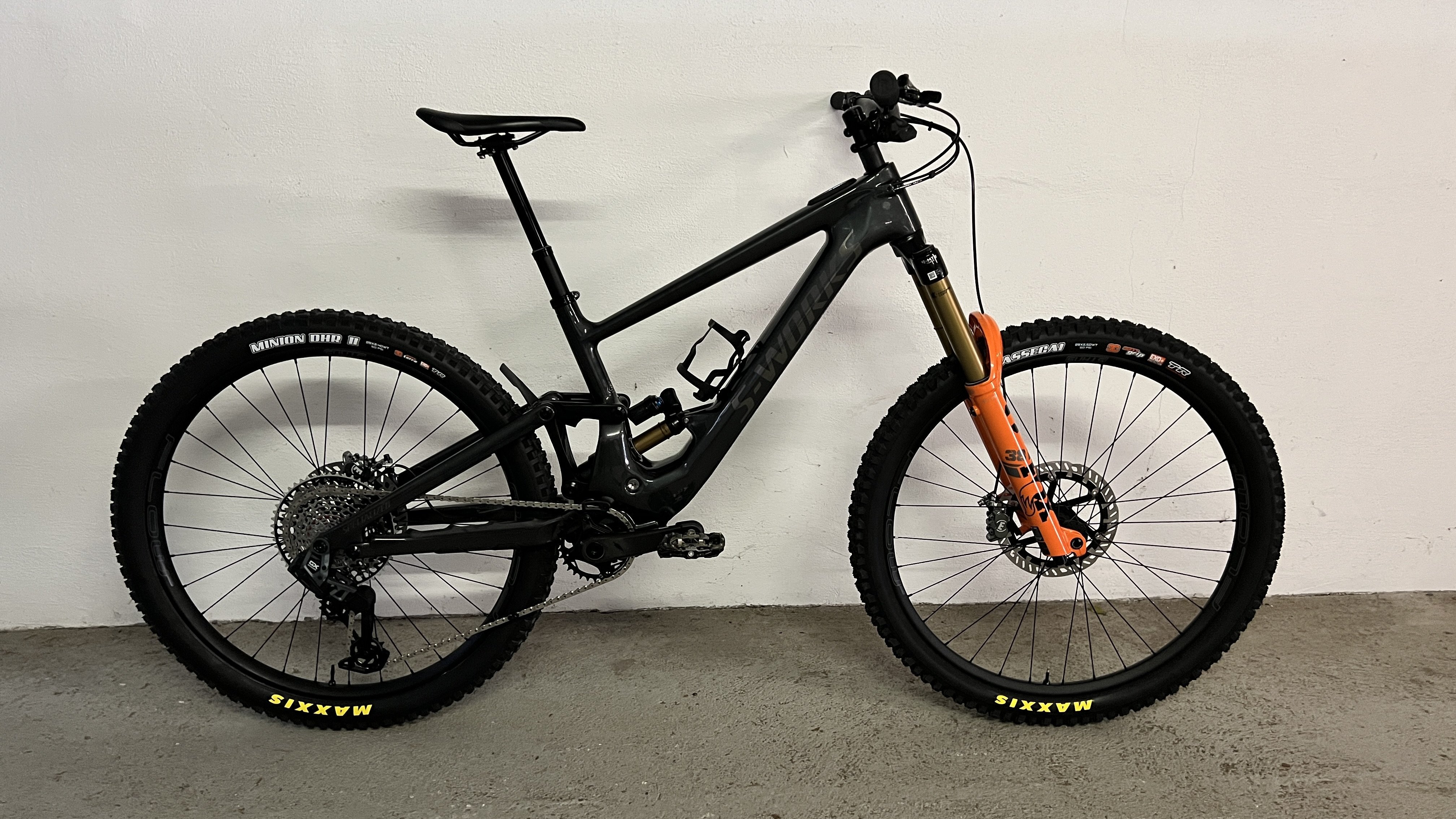

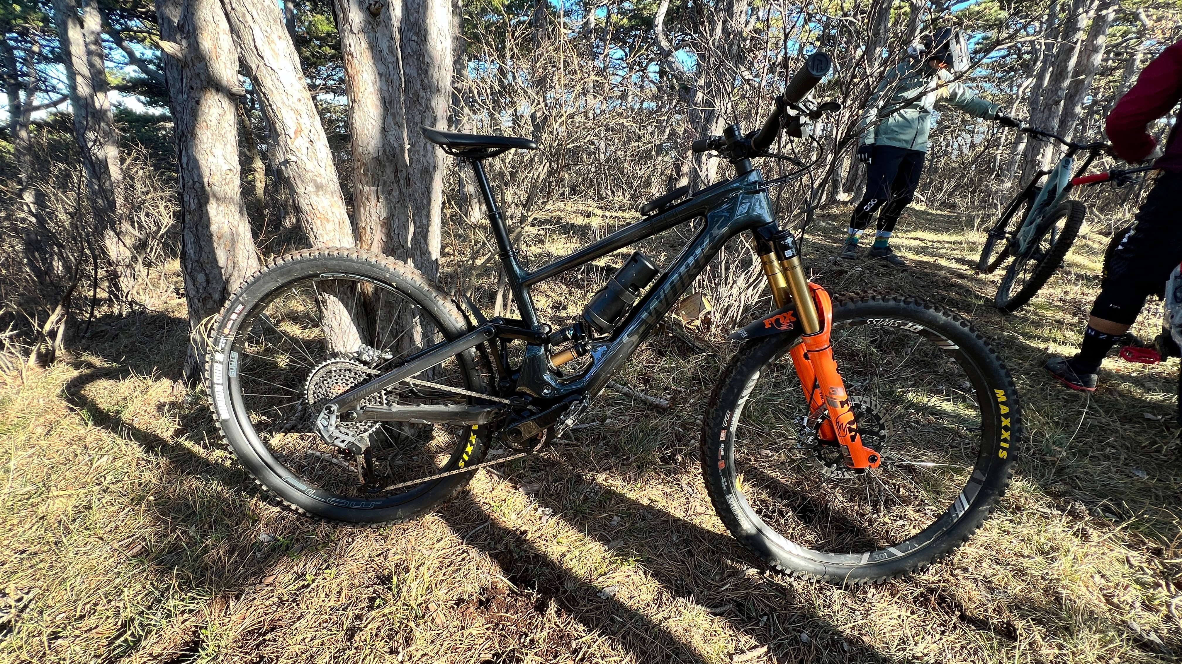

So the bike is finnaly complete. The only thing I really regret is ordering the OneUp V2 on tuesday and finding out the new one is out on friday.
Fox 38 Factory
X0 Group T-type (sram dub stock cranks)
DT Swiss FR1500 wheels
- CushCore Pro on the back
- Ultra Gravity Schwalbe Magic Marry and Big Betty
OneUp V2 210mm
Ergojn Enduro Seat
Hope Tech 4 V4 Brakes
Renhthal Cockpit
Crankbrothers Mullet DH
Size S5, 20.5kg (with pedals)

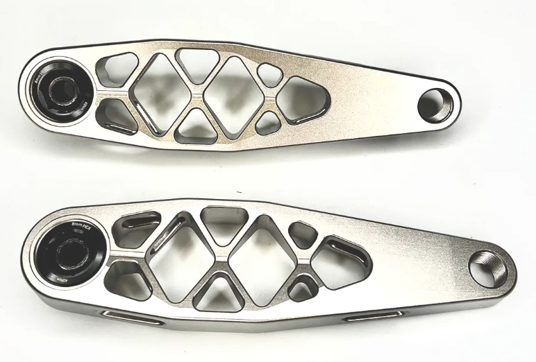

After doing a little research, I was able to answer my own question, which I am sure was already answered else where. The cranks that fit the Gen 2 (1.2) motor do not fit the Gen 1 (1.1) motor. I guess I should be some what thankful as the cranks I was able to source out, which are available locally, are not as expensive as the Kenevo/Levo type! I will continue to work on my delusion that 165mm is not THAT much of a difference from 160mm when it comes to cranks and be glad than I am NOT reaching for my credit card to buy these, as cool as they are! I am sure I will forget all about the desire to want shorter cranks once I am back riding again.
Kenevo and Levo: Titanium Specialized eCrank
Kenevo SL Gen 2: SRAM DUB Mount eCranks for SRAM / Brose and Gen 2 Specialized SL

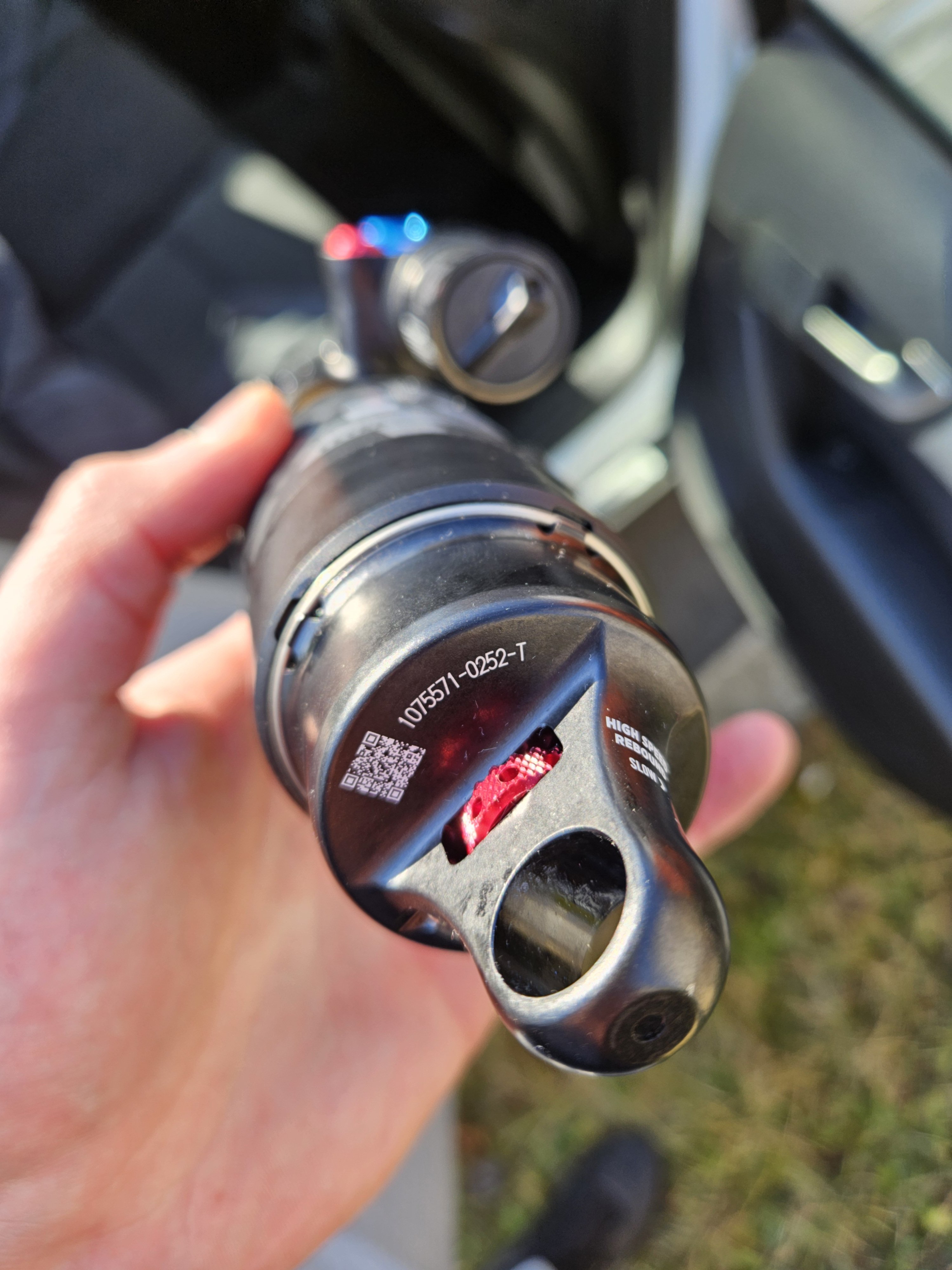

By the way, some of us are trying to know the model year of the X2 fitted on the KSL2, can you tell us what your shock's serial reveal about it this page...?
Bike Help Center | FOX
The shock that came with my KSL2 frameset was made in 2022.

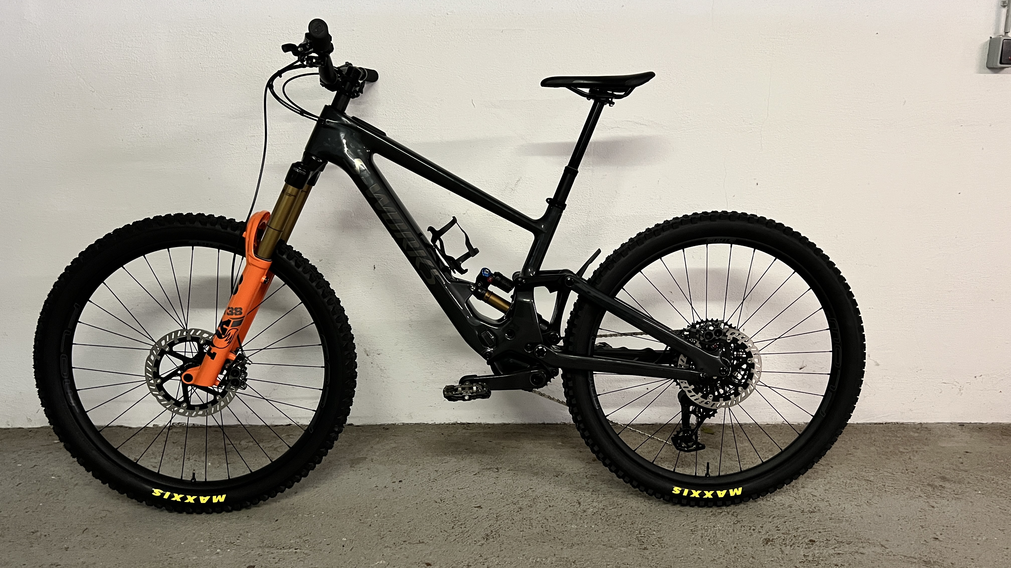

Almost done with my bike (steerer tube still needs to be cut once I found my ideal stem height). Quite similar to the bike of @Teoslav.
- Size S3
- Fox 38 Factory
- Shigura (XTR & MT7)
- Stans MK4 w/ DT Swiss 240s
- Race Face Turbine R stem & Renthal Fatbar Carbon 35
- Wolftooth Resolve 160mm Dropper (31.6)
- SRAM XX Eagle T-Type Cassette & GX Derailleur
- Inserts Front & Rear Rimpact Pro V2, EXO+ Front (Maxgrip)/ EXO+ Rear (Maxterra)
- Ergon Enduro Saddle
Weight: 19,3kg (without padels)
I am coming from a Full Fat Kenevo (Fox 38, Full 29er Setup, EXT E-Storia) and it was my first ride on the KSL2. The first three key impressions were:
1.) I was really positively surprised regarding motor noise (not much more than on the brose)
2.) How much the weight difference (4,8kg to my FF Kenevo) is noticeable - more than expected.
3.) The bike is absolutely silent on the downhill. No rattle, no chain slap, nothing. Love it!
I was able to do extremely steep climbs but of course MUCH more power needed (>550 watts of rider power in Turbo 70/100) compared to the FF Kenevo (no surprise though). Will keep the FF Kenevo next to the KSL as I love them both for their individual riding characteristics.

I will attach the picture of the shock QR code so you can check for the year number. But on the box of the frame it came in said it was made like march 2023 so I doubt it has the 2024 float x2.

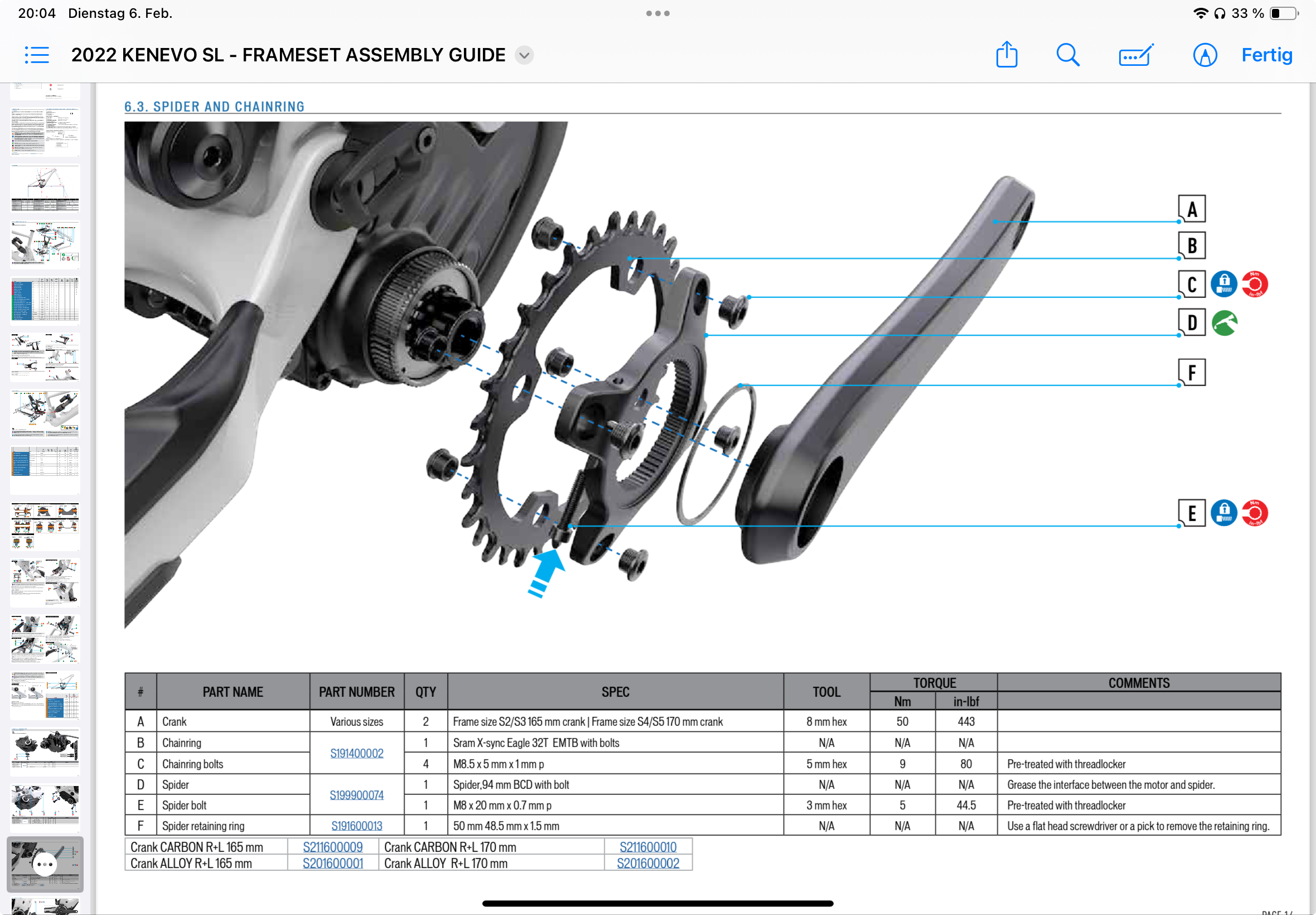

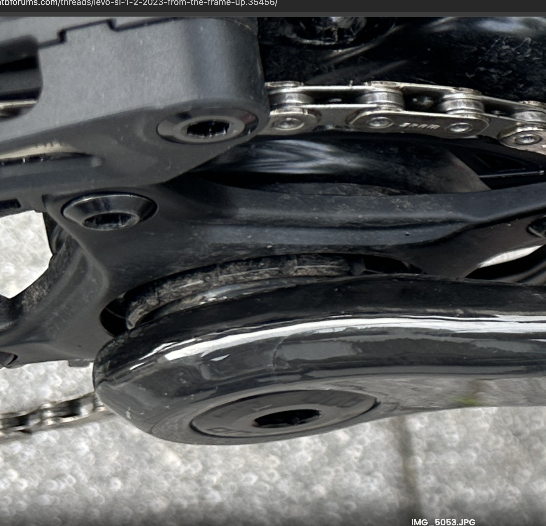

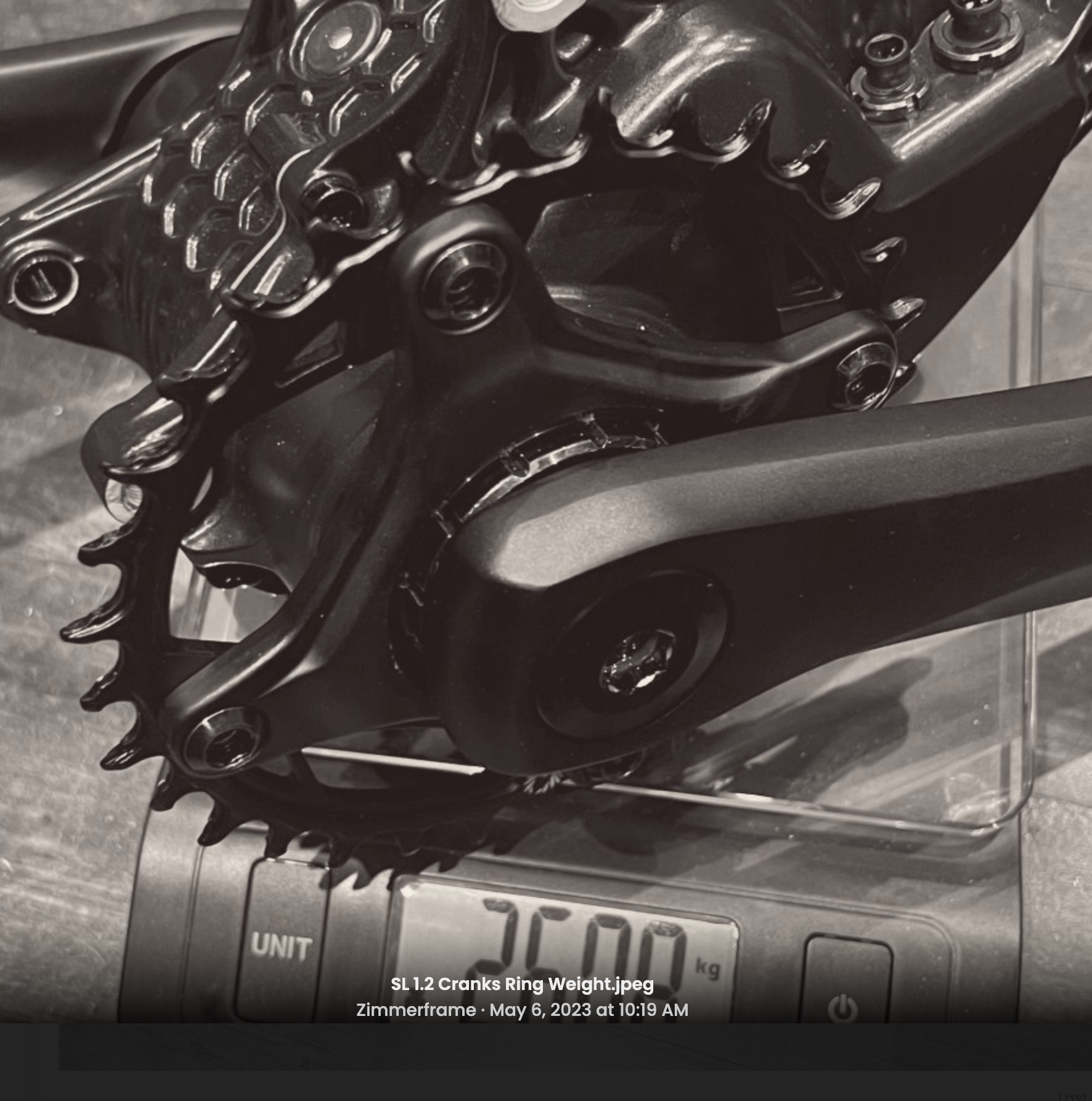

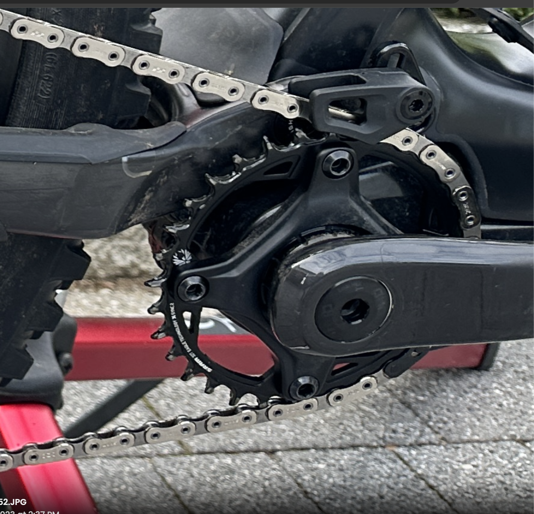

ksl 2 owners, did your frame come with this spider retaining ring (F) or is this not needed anymore with the new dub cranks?
also my spider looks different, doesn‘t have the spider bolt (E), kinda confused right now
MatCret
Jan 21, 2024
49
24
France, FarWest France
Hi! No, it's another spider ring part reference because the "spider bolt, E" is not here. Just got the frame kit today!
Frame kit assembly guide is not up to date.

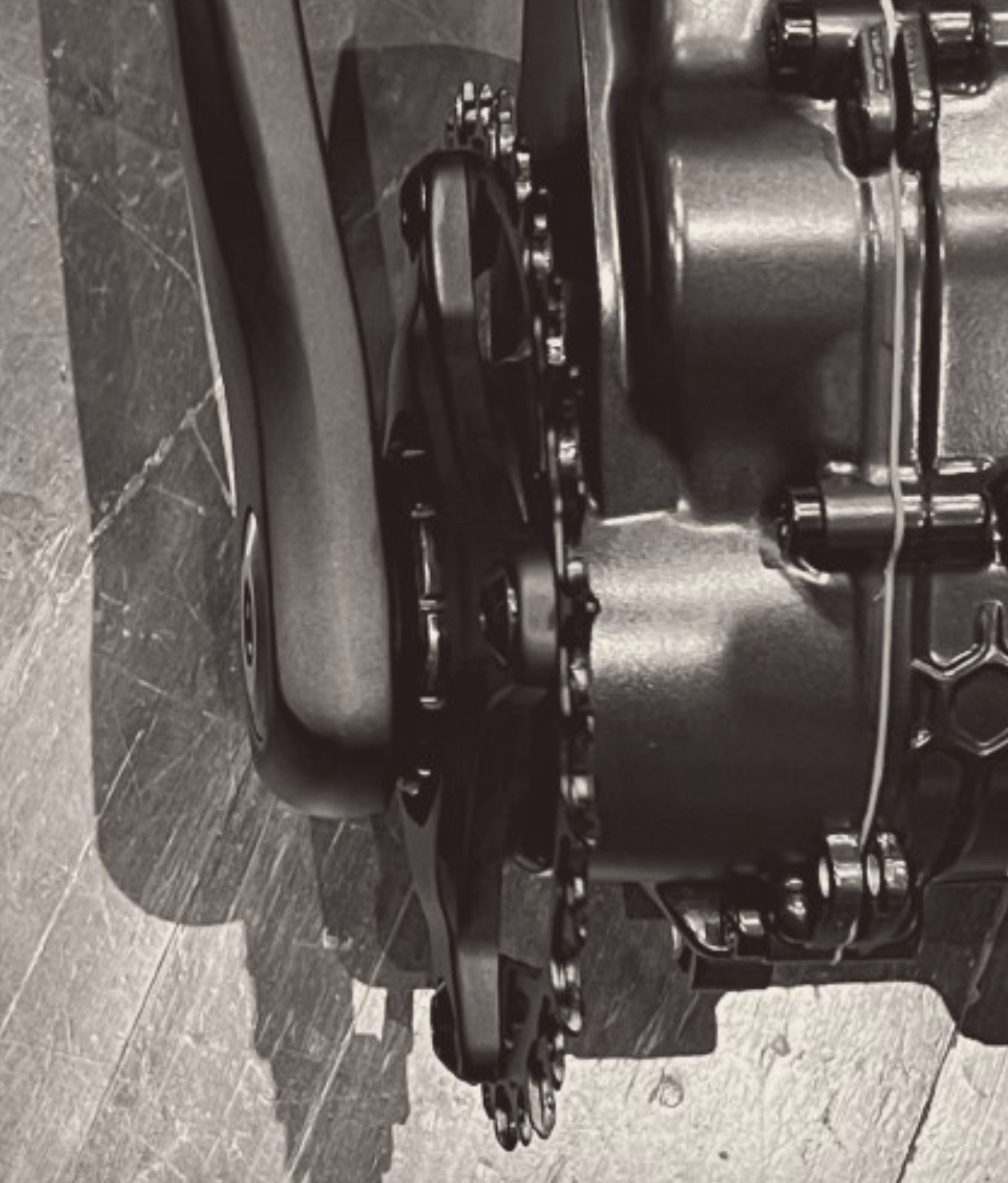

Yeah, something is missing or we missed it while unboxing... look at those pictures:
