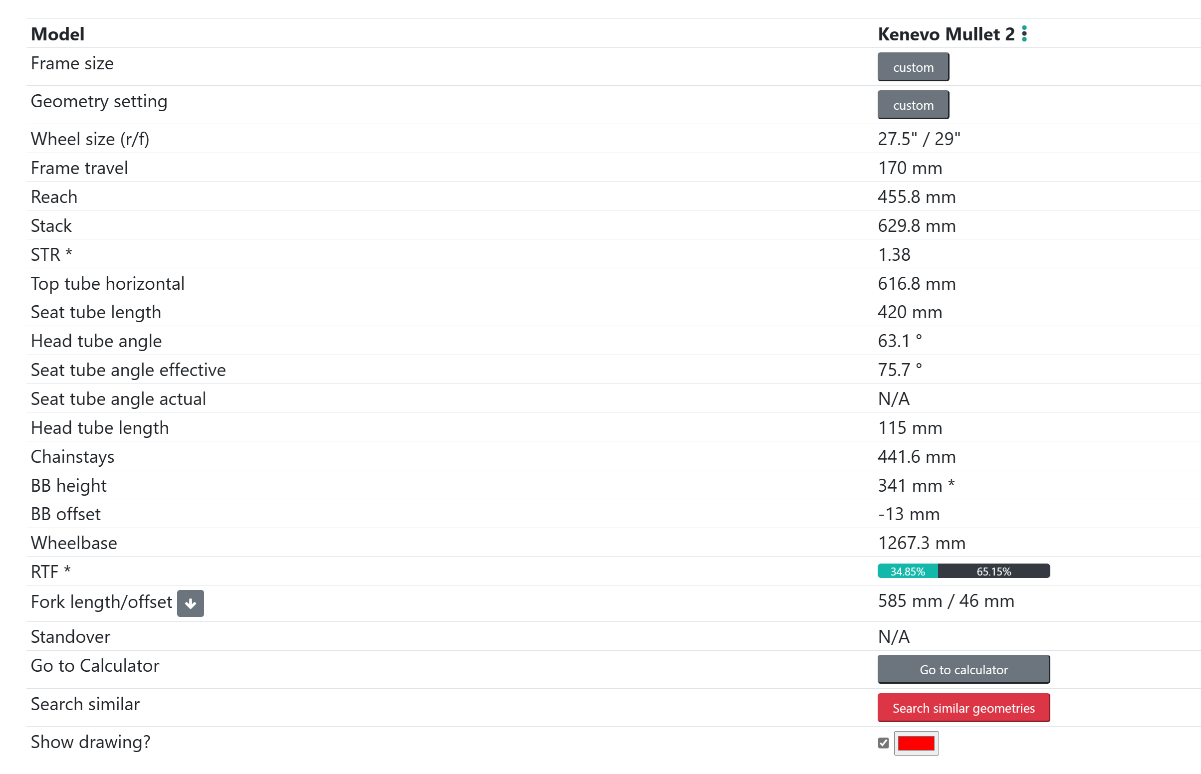

I don't guarantee all these numbers, but this is configuration I used before I converted mine S3. It should (if I input all correctly), feature 170mm ZEB fork, HighBB setting and default neutral middle angle on front.
With that said, with Mullet, BB Drop is kinda meaningless value since it's offset from each axle differently (hence why some websites quote BB-Drop per Axle).
It rides perfectly though for me. I use stock cranks, and I am very mediocre rider and I never strike pedal (and I use thick Deity Tmacs).
The table below is from bike-stats - Alles zum Thema Fahrrad Geometrie

thats similar to what i calculated, i should be quite similar to the banshee titan mullet setup in low settings i ride right now. i even should be able to run the 210mm oneup again without reducing the drop (long legs 4tw)
can someone confirm the ~340mm bb height in real life measurings?

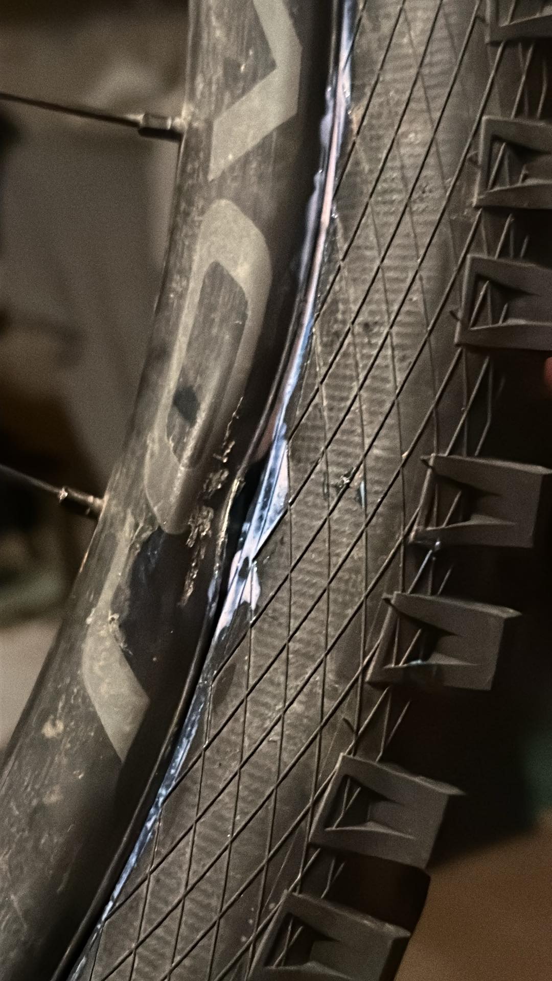

Has anyone else find out that stock Roval alloy rims are really really soft?
I've bend mine twice in 8 months + had a huge dent which is not holding up air anymore so I had to buy a new one today. I am switching to DT Swiss 471.
403391014_2036704920063272_7326085424073355360_n.jpg 404516617_385394230527323_83743056539295534_n.jpg

I added cush to the back. Already had a dent at 2m of riding
Impressive! How much do you weigh? What tire pressure are you running at? If you are using Cushcore and still getting dents in your rims, either you are hitting square edge rocks really hard with your suspension not setup well or those wheels were made out of cheese. Which wheels were you using before you switched? Any issues with them? I upgraded my KSL to DT Swiss EX511 rims.

Sorry I wasn't clear. I JUST put it cush. The first 2 months was no cush and that's how I got the dent. I tend to run lower pressures. Low 20s high teens. But that's because I was used to always having cushcore. I got the KSL and didn't get around to putting in the inserts until just now but I still ran the low pressures. Lol. Bad idea.
Still running the stock cheese wheels

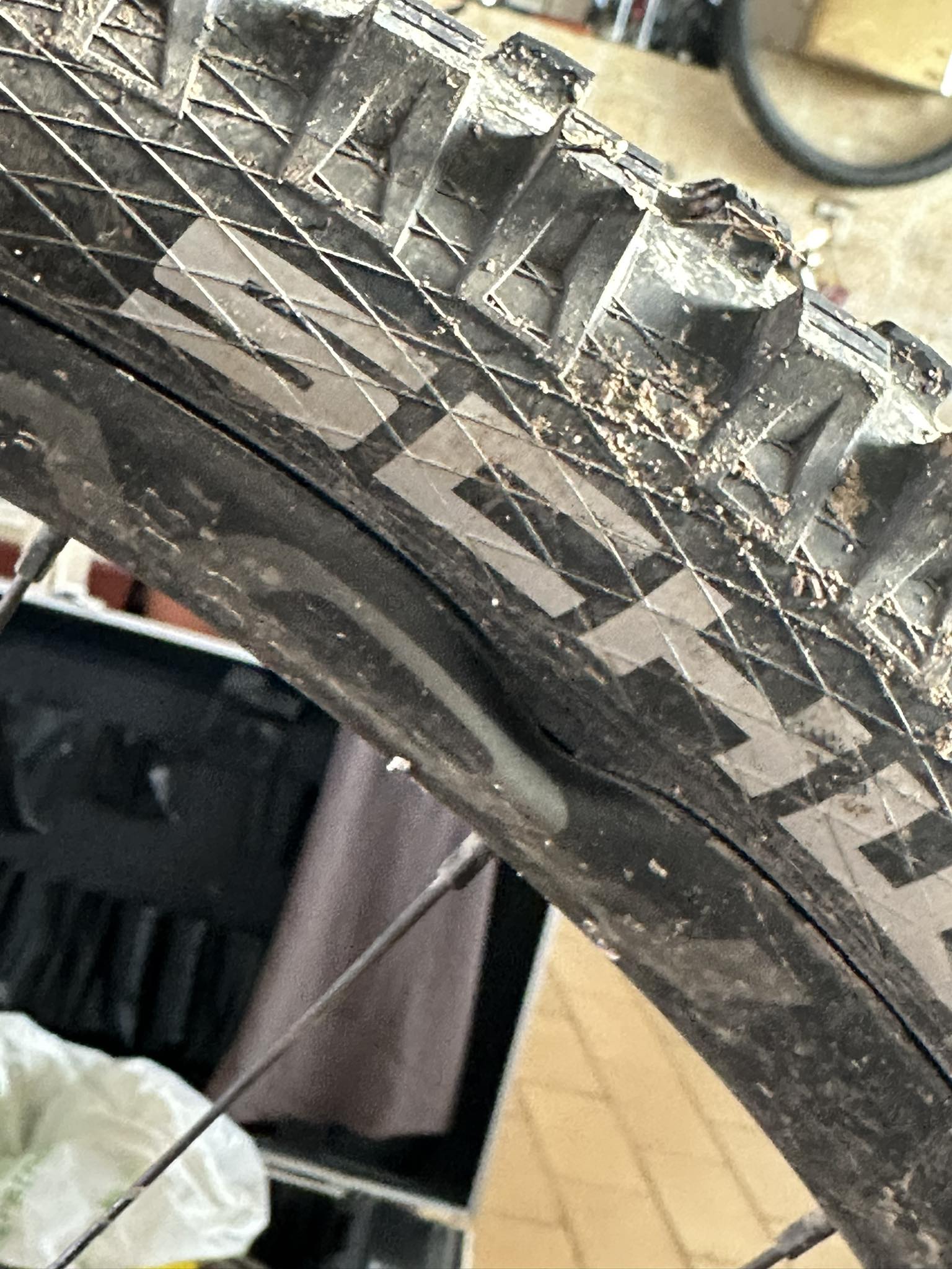

View attachment 132074 View attachment 132075
I don't dent rims. I managed to put 3 dents on the rear stock Traverse on my gen3 Levo.
Built up a wheelset w/XM481 rims. Problem solved.
Same here on my KSL Comp, on my second outing (yeah only 2...), had to upgrade (Duke Fury Star wheelset) and put CushCore.

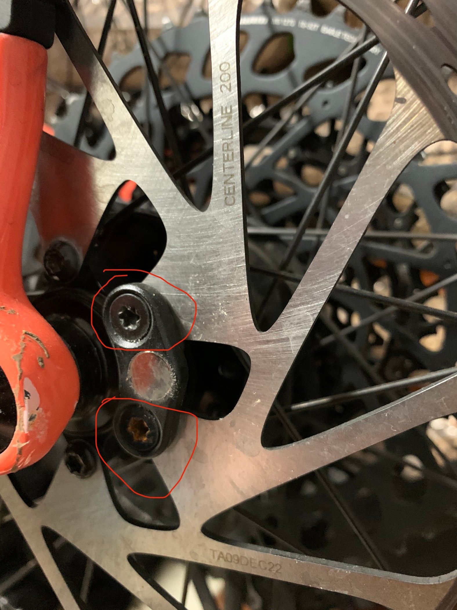

Anyone have successfully used an another sensor magnet than the original ? Stock rotor bends with the Hope hubs...
initzx
Jan 20, 2024
13
France
I've the Pro 5 ones, I think the magnet is putting too much pressure (The screws are tightened with a torque wrench). It's almost not noticeable until the wheel turns. While turning, rotor is twisting.
I've put washers between magnet and rotor, it's way better but not 100% good. Before brake upgrade (most likely T4 V4), i would like to find a solution without DIY.
Buy a magnet and gorilla glue off ebay. Glue the magnet to the disc - worked for me when I upgraded to Galfer CL discs and the Spesh magnet didn't fit. Also it is very discrete, you can hardly see it
I would like a "plug and play" solution, but I'll make a note of it.
