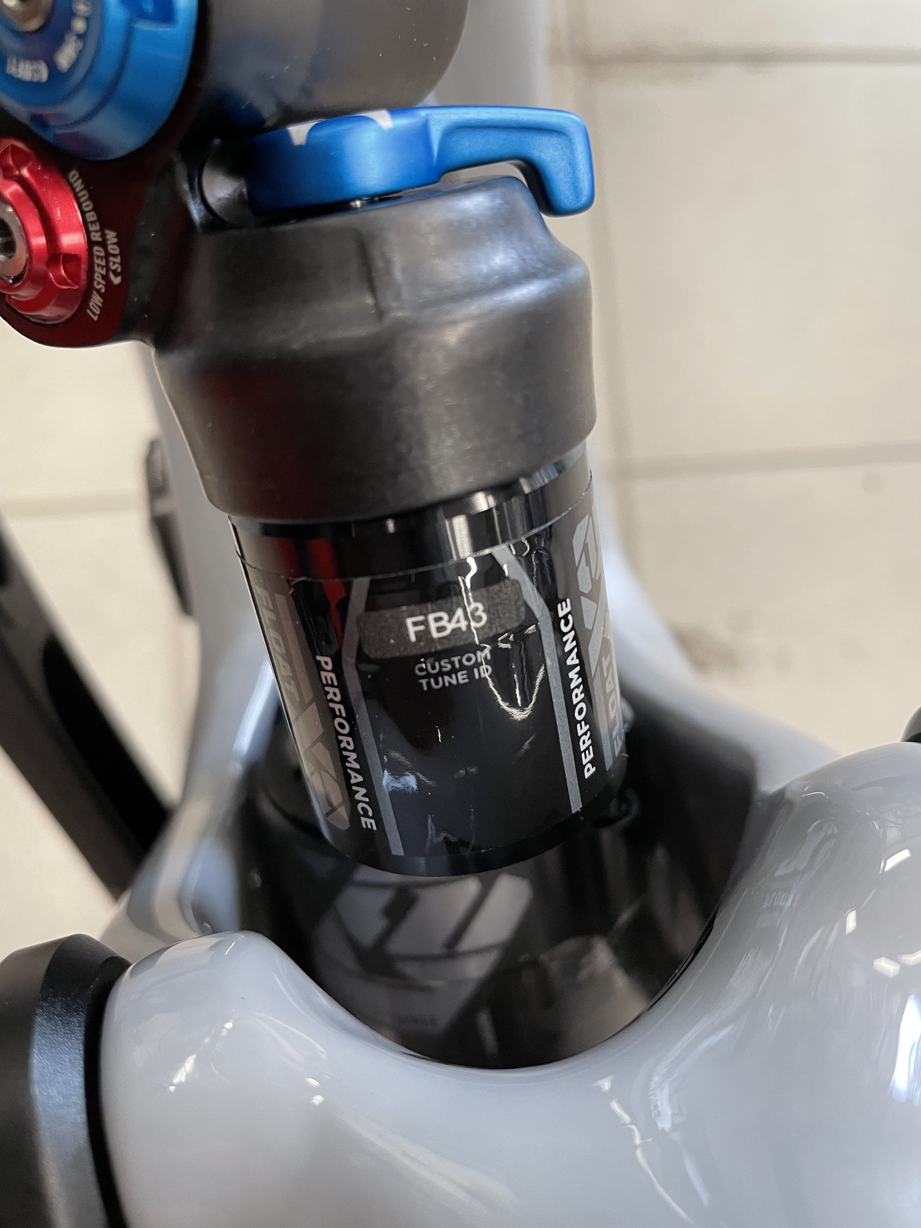

Thank you. The form asks for the serial number or tune ID. So it seems I'll have to take the shock off to get to it, because I can't seem to find it. May be hidden behind the frame.

I can't find the Tune ID. Is it blocked by the frame? Do I have to take the stupid shock out to find it?
Mine tune id code is here.
