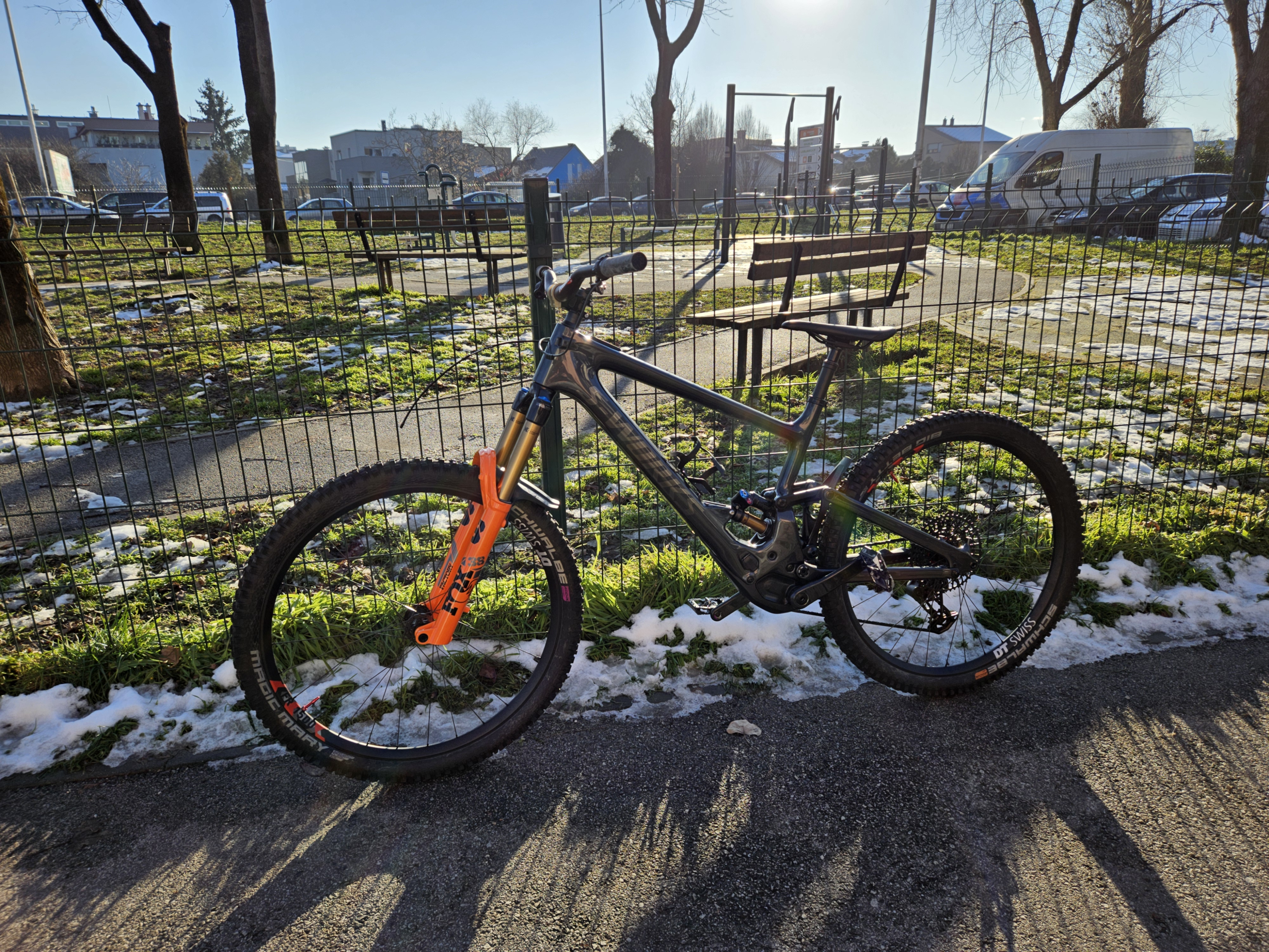

Almost done with mine.
It will be a bit more than 20kg in size S5
