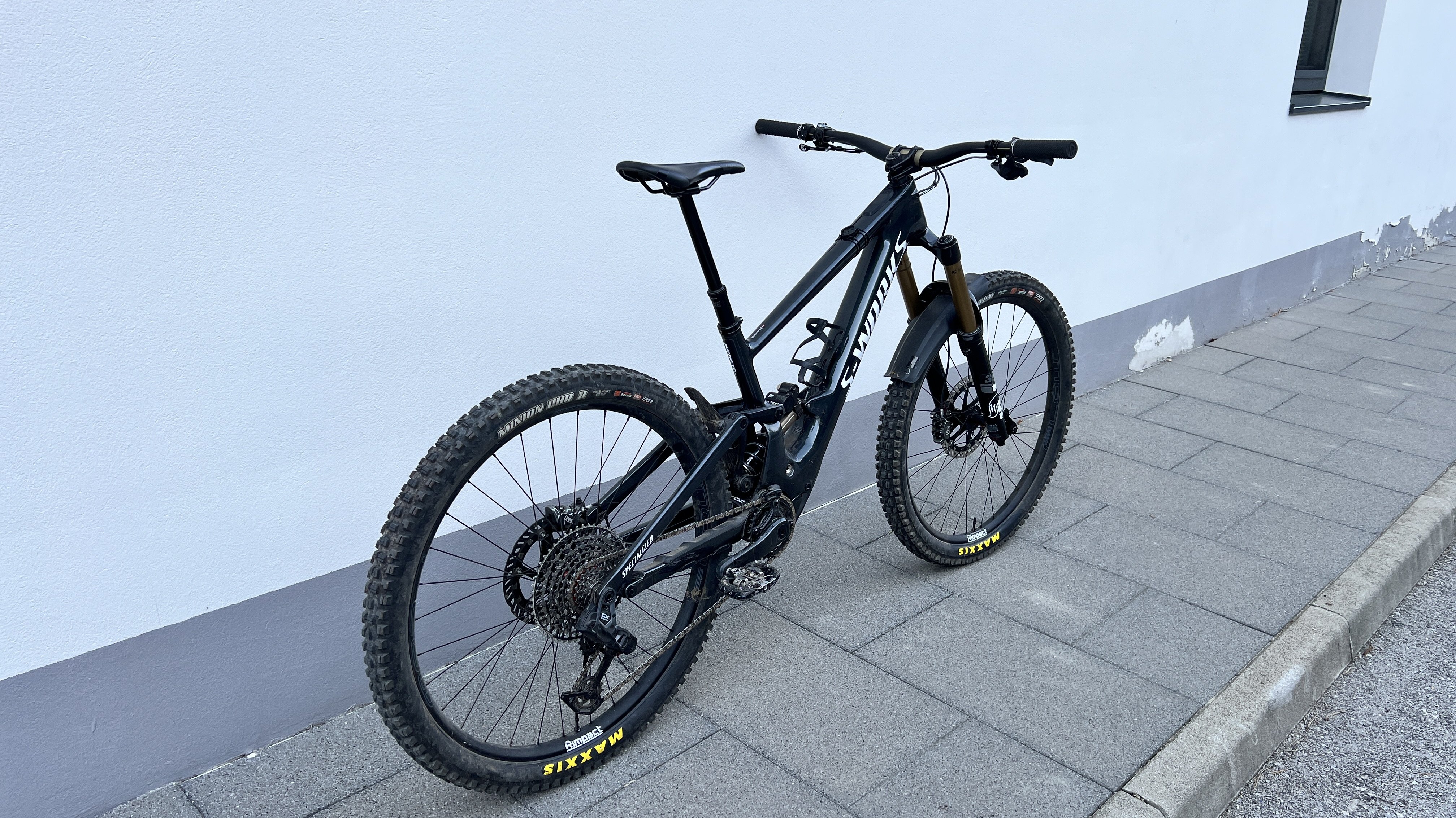

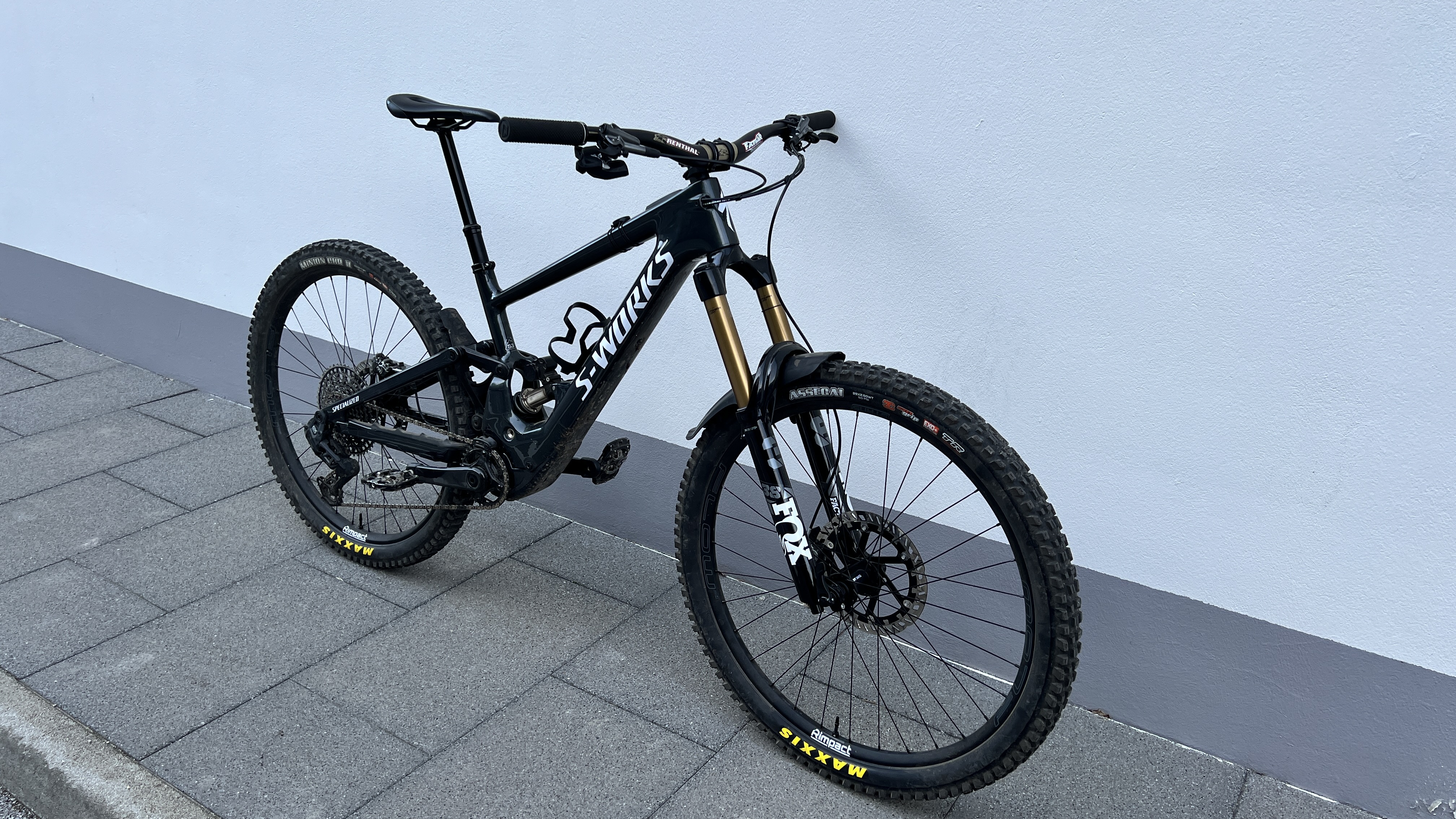

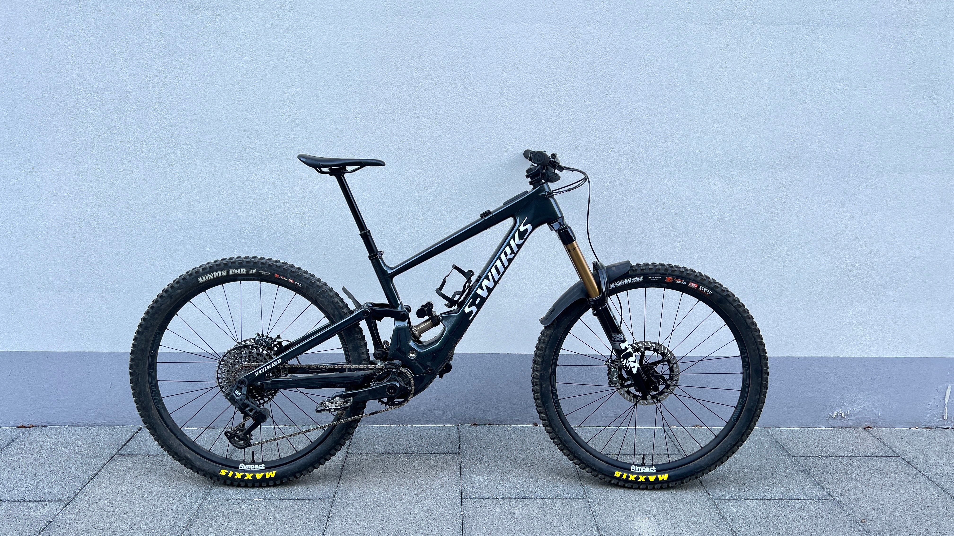

Done with my KSL2 build. Deeply in love with it, especially how the bike goes downhill now.
  • 180mm Fox 38
  • 230x65 EXT E-Storia
  • Setup: low / mid
  • Weight: 19,4kg (w/o pedals)
  • One Up V2 180mm
  • Wheels: NoTubes ZTR Flow MK4 w/ Dt Swiss 240s
  • S3
Biggest surprise to me: no issues with dropper post insertion depth at all! I was really worrying about it: studying all forums/threads about it, calculating seat heights, ordering 3 different seat posts, almost refraining from buying the frame. At the end it turned out to be an absolute non issue for my 5'10 with 34" inseam.
  • 180mm Fox 38
  • Setup: low / mid
  • One Up V2 180mm
  • S3
View attachment 136647 View attachment 136648 View attachment 136649

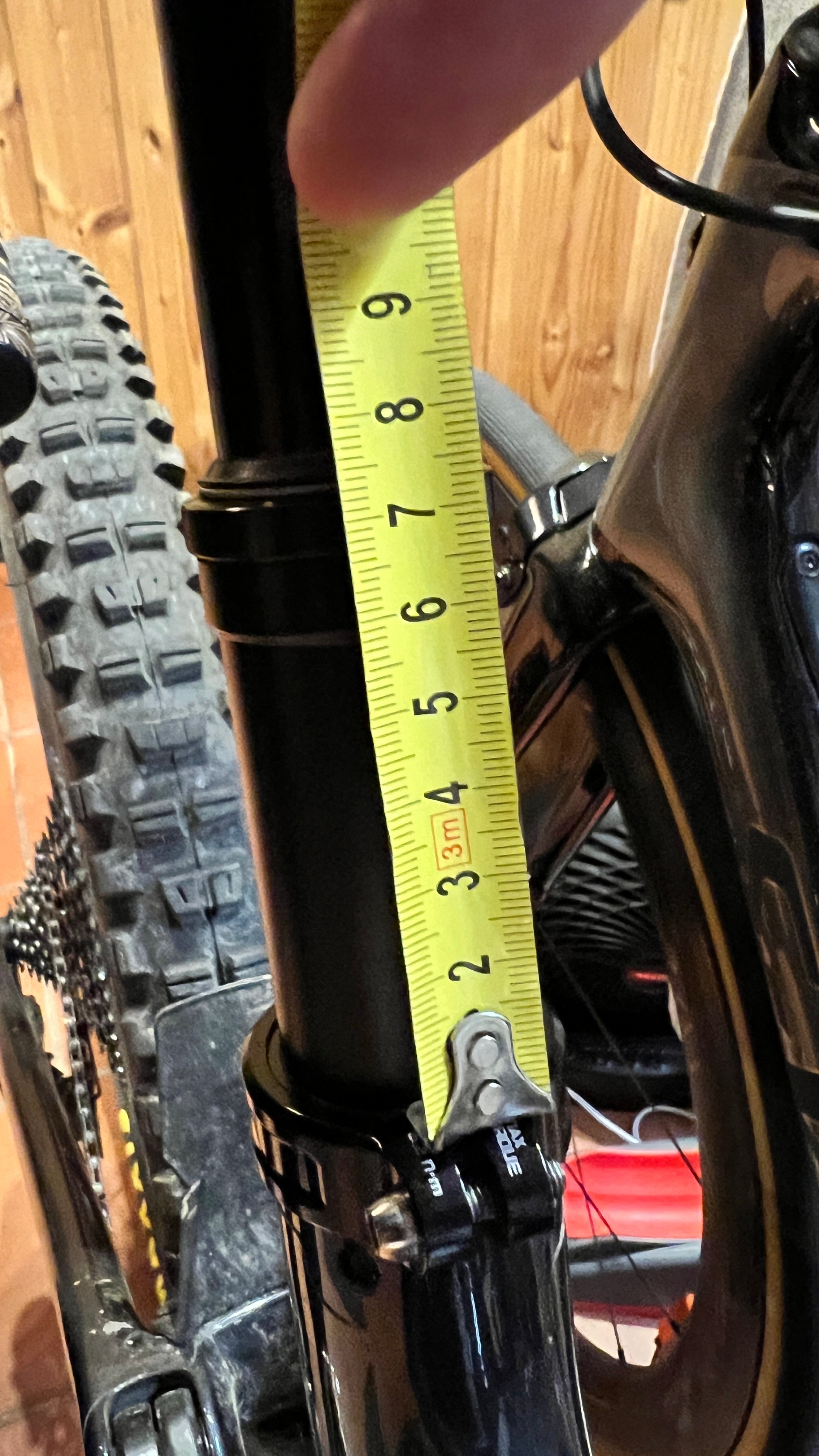

Interesting how you are riding an S3 at 5'10" with an inseam of 34". I am guessing you have always ridden a medium? I am on an S3 at 5'8" with an inseam of 28". I find the saddle to at least a few inches too tall for going DH when its in its lowest possible position. I get too many kicks in the nuts even when using a 180mm OneUp dropper post.
Geas
Jun 24, 2022
41
43
Austria
Long legs, short torso definitely helps on the KSL. I am having almost the exact same seatpost height and lowest possible position as on my FF Kenevo (which has a better max insertion depth). But I can imagine that with shorter legs it's a challenge. The tips 1., 2. and 5. here from the forum helped me to get the max insertion out of it.
sethimus
Dec 31, 2023
182
176
Switzerland

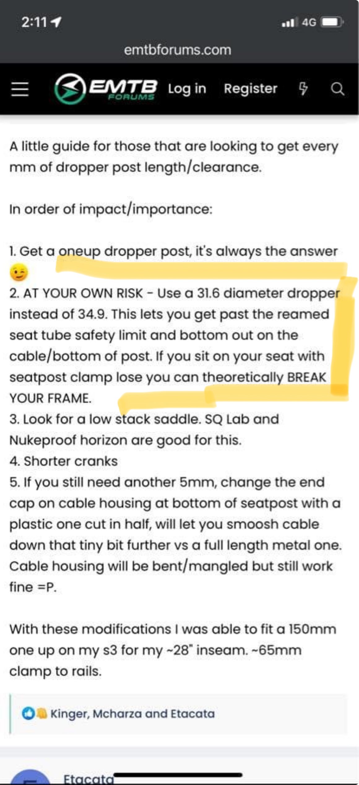

better: use the 30.9mm one like specialized does. the framekit even comes with a 34.9 to 30.9 reducer. i have also long legs and am able to use a 210mm on a s4 frame. and i still have a few mm left (which i will probably use to add an anomaly switchgrade at a later date). 155mm cranks help too… (at least when sitting, standing you lose 10mm+ drop)
Geas
Jun 24, 2022
41
43
Austria
180mm one up v2 31.6 on S3. could be slammed a few more millimeters more, but this would bend the cable housing quite a lot and seat height when fully extended would be too low for me.
KnollyBro
Dec 3, 2020
1,039
2,411
Vancouver
I think that coming from a DH bike where I was able to slam the seat so low that I was getting tire buzz on the saddle, it's the shock tunnel that kills the hope of using any dropper post of any significant length. A few mm will not help my nuts taking a beating when riding the steeps as 70mm is pretty high for the base post to stick out of the frame 🤷‍♂️.
This is one of the FEW complaints to an otherwise great bike!
*edited for typo
Geas
Jun 24, 2022
41
43
Austria
This is one of the FEW complaints to an unwise great bike!
Yes, that's definitely a weak point of the frame design and shock position!
