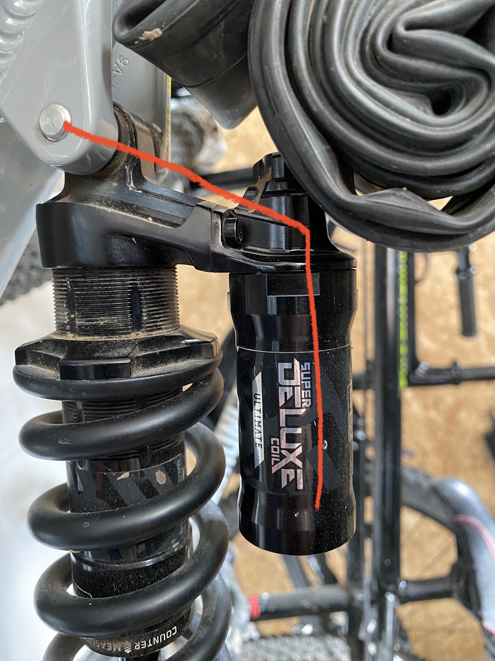

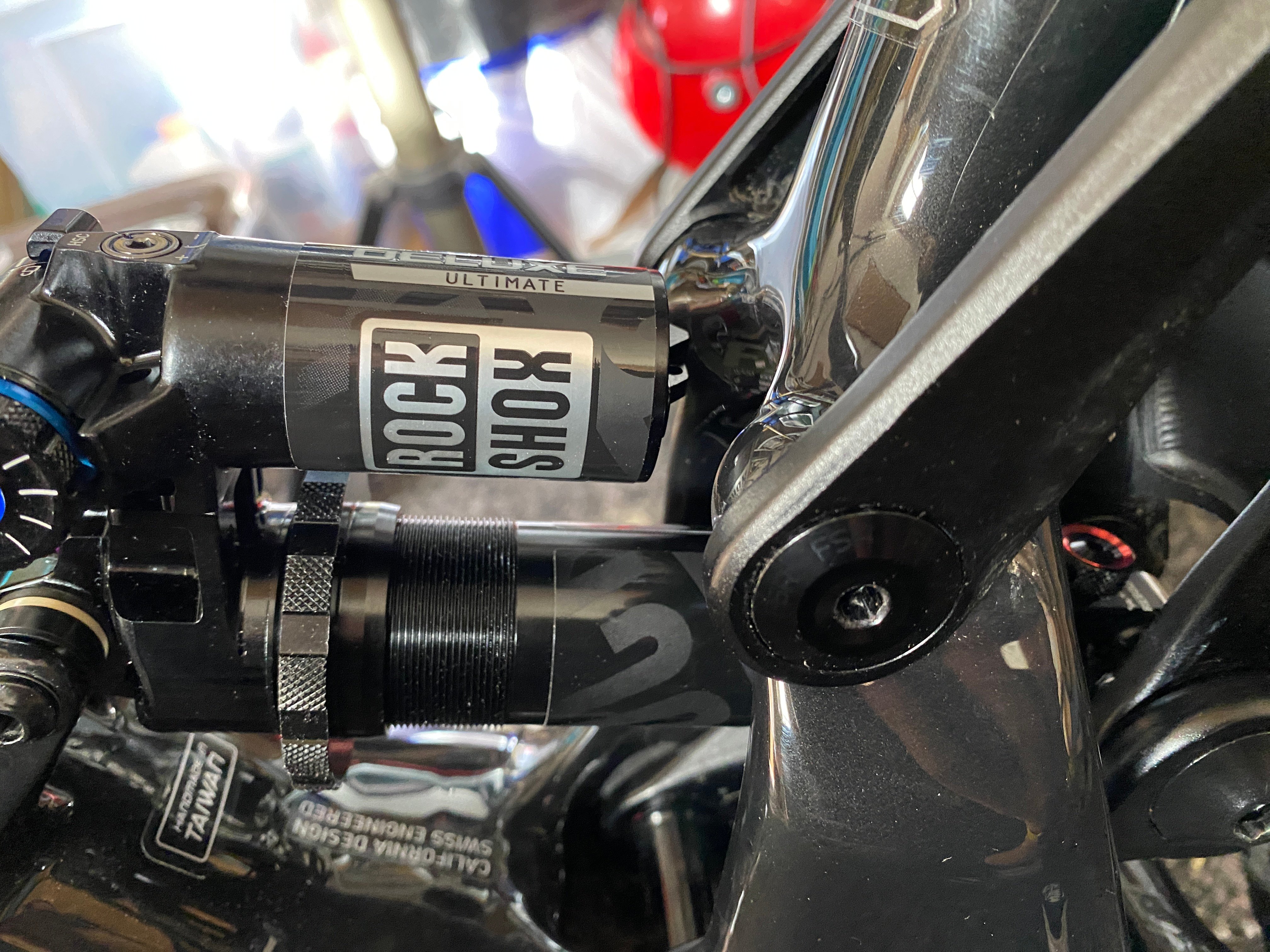

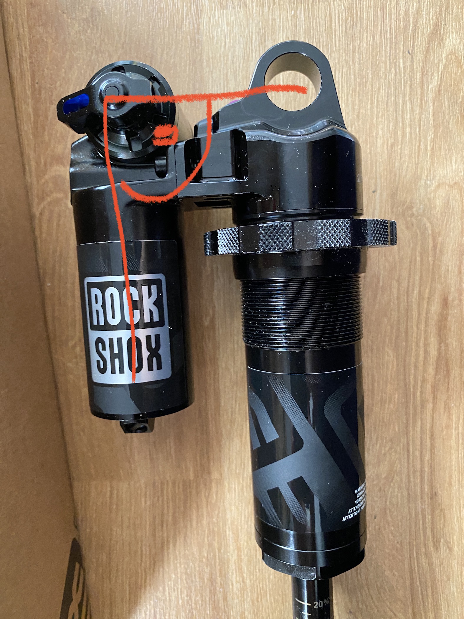

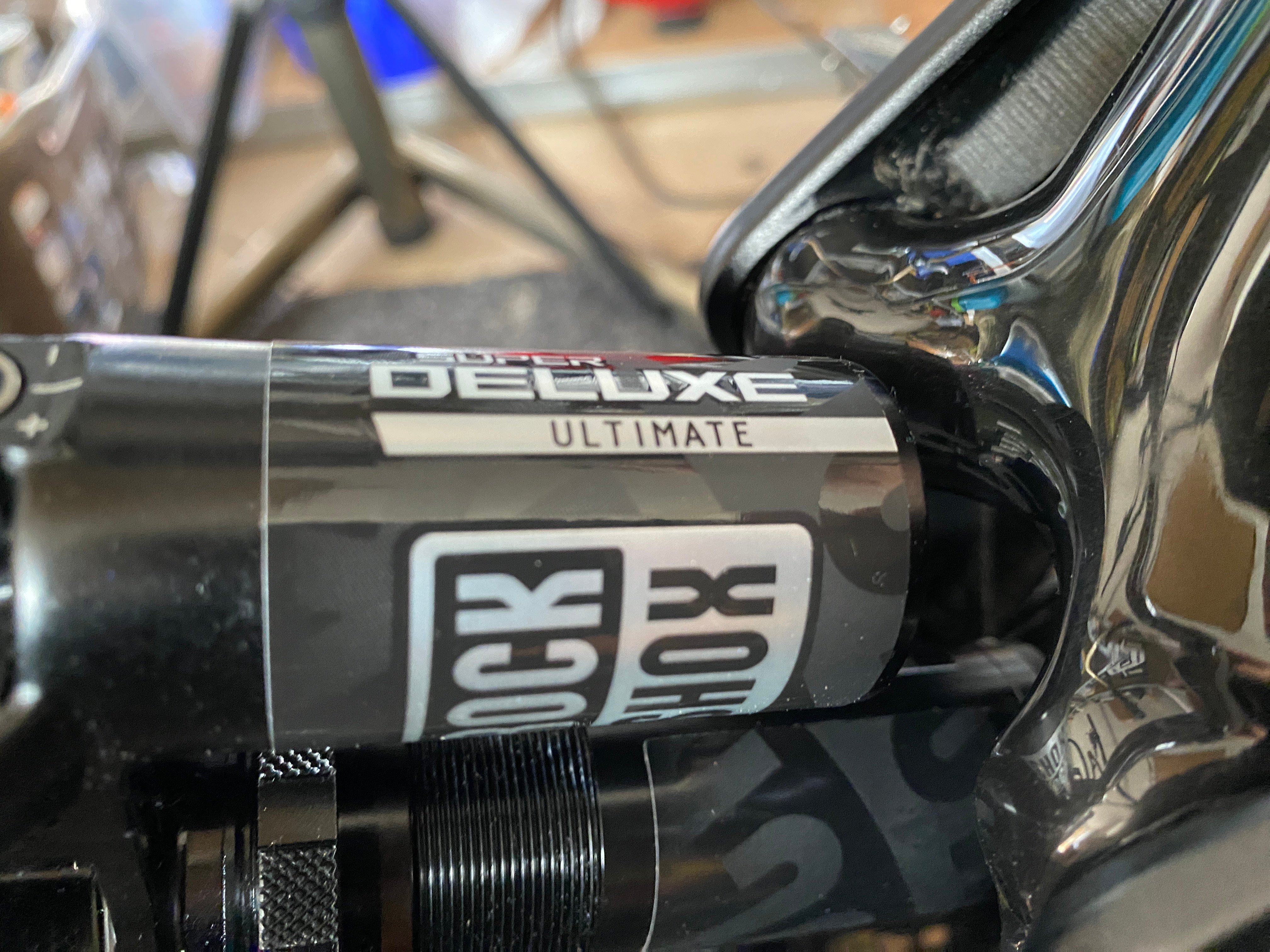

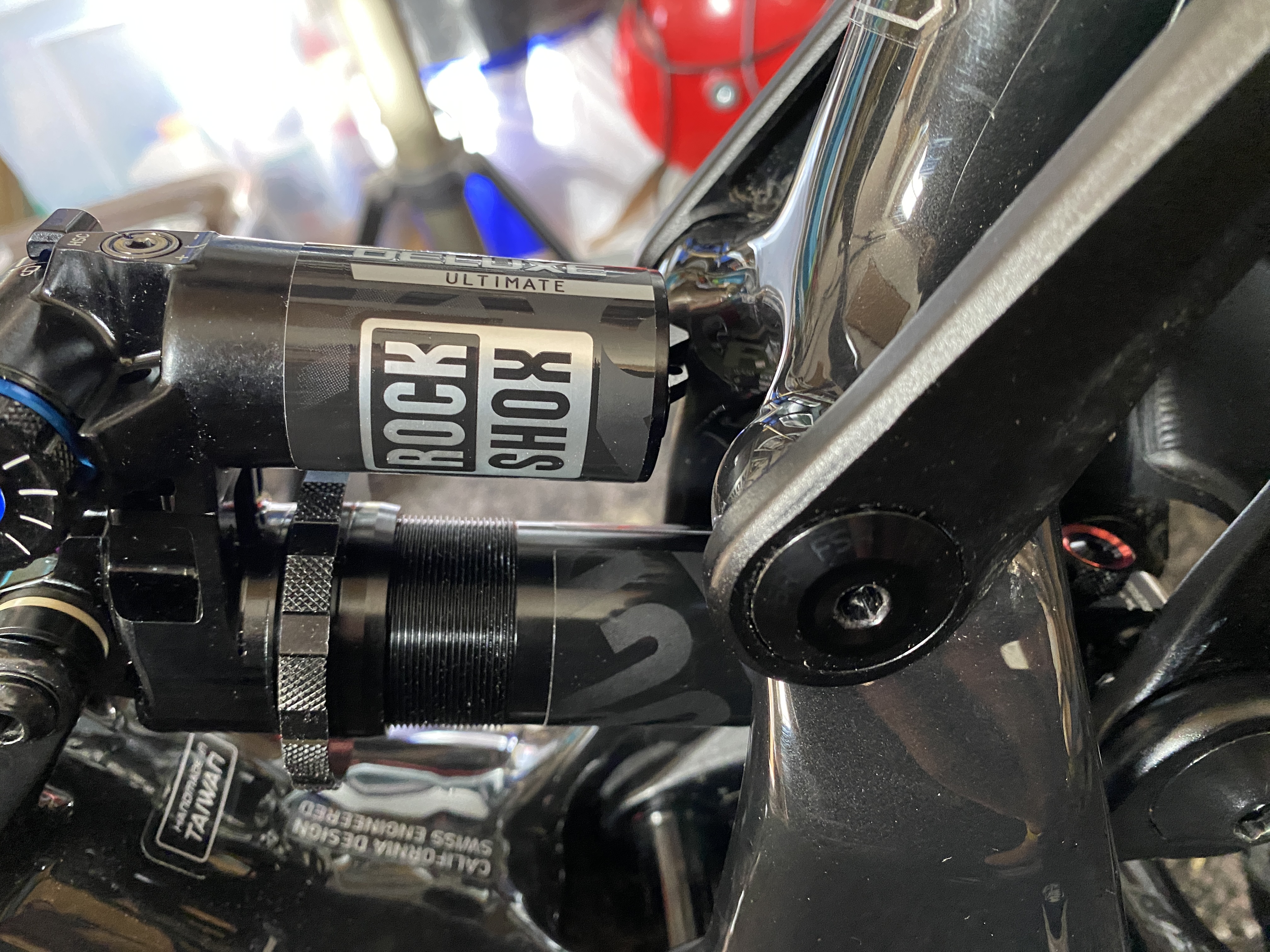

So, the 2023 RS Coil fits my S4.
And I think here is why. Have the old model in my Megawatt. Here are some pictures. The piggy has the same lenght like the old one but the old shock has not the same „length“ from the eye of the shock in direction to the complete shock lenght.
In fact the new model is close to the Float X which came with my comp.
Sorry for my bad english;-)
B2A08006-51F6-45B7-954D-0418386C79BF.jpeg 91D94CEC-11DC-4C4C-A401-575A5517FA72.jpeg 83B234C7-8504-48A8-8B4E-B07795BB2388.jpeg 20A60449-8413-41D8-8E47-CAE621F5EA1C.jpeg
View attachment 100199 View attachment 100200 View attachment 100201 View attachment 100202
Is your RS steel shaft version and normal one, not trunnion?
Henrik
Oct 25, 2022
89
94
230x62.5 Metric, Aluminium shaft
The 23er Coil has a 21% stronger chassis then the previous version and its „E-Bike ready“ says RS.
The new Coil has also a HBO like the EXT. Did a quick run today and will go for a longer ride at the weekend. First impression is „sick“ ;-)

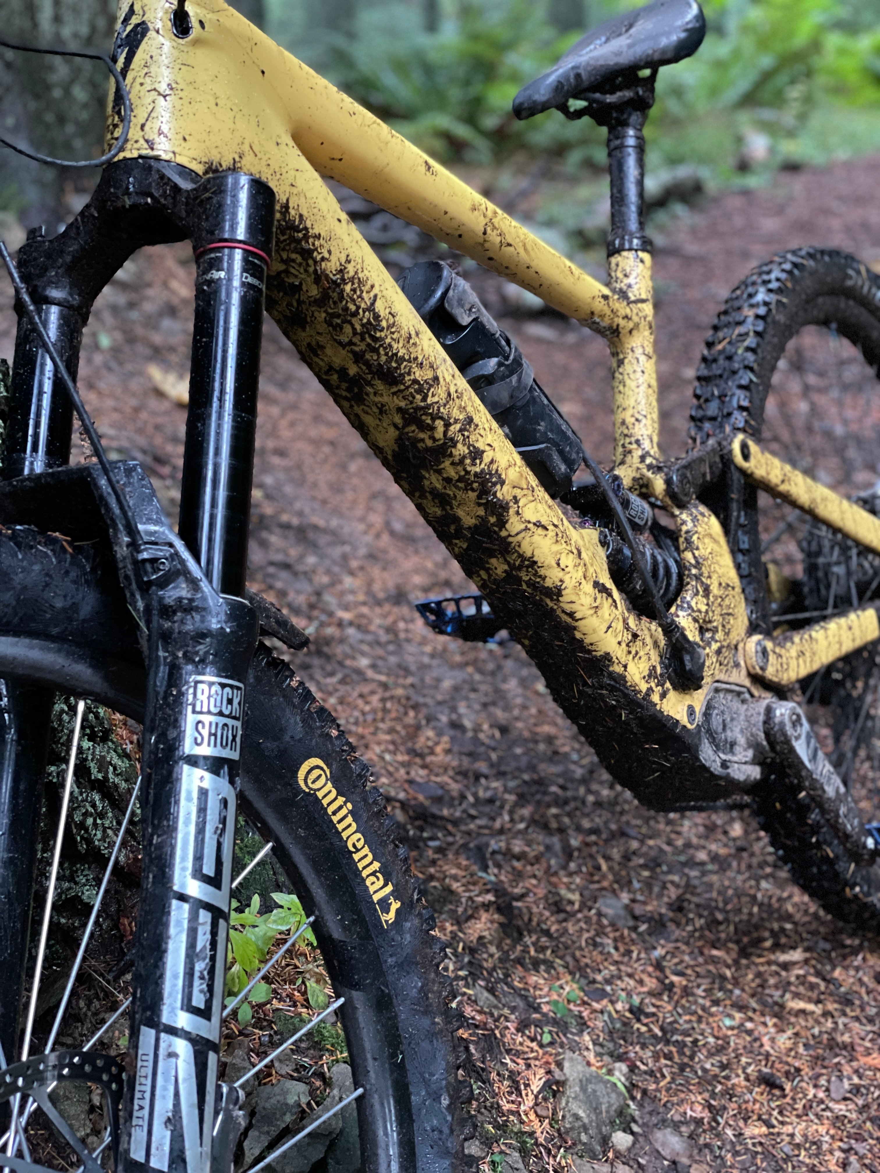

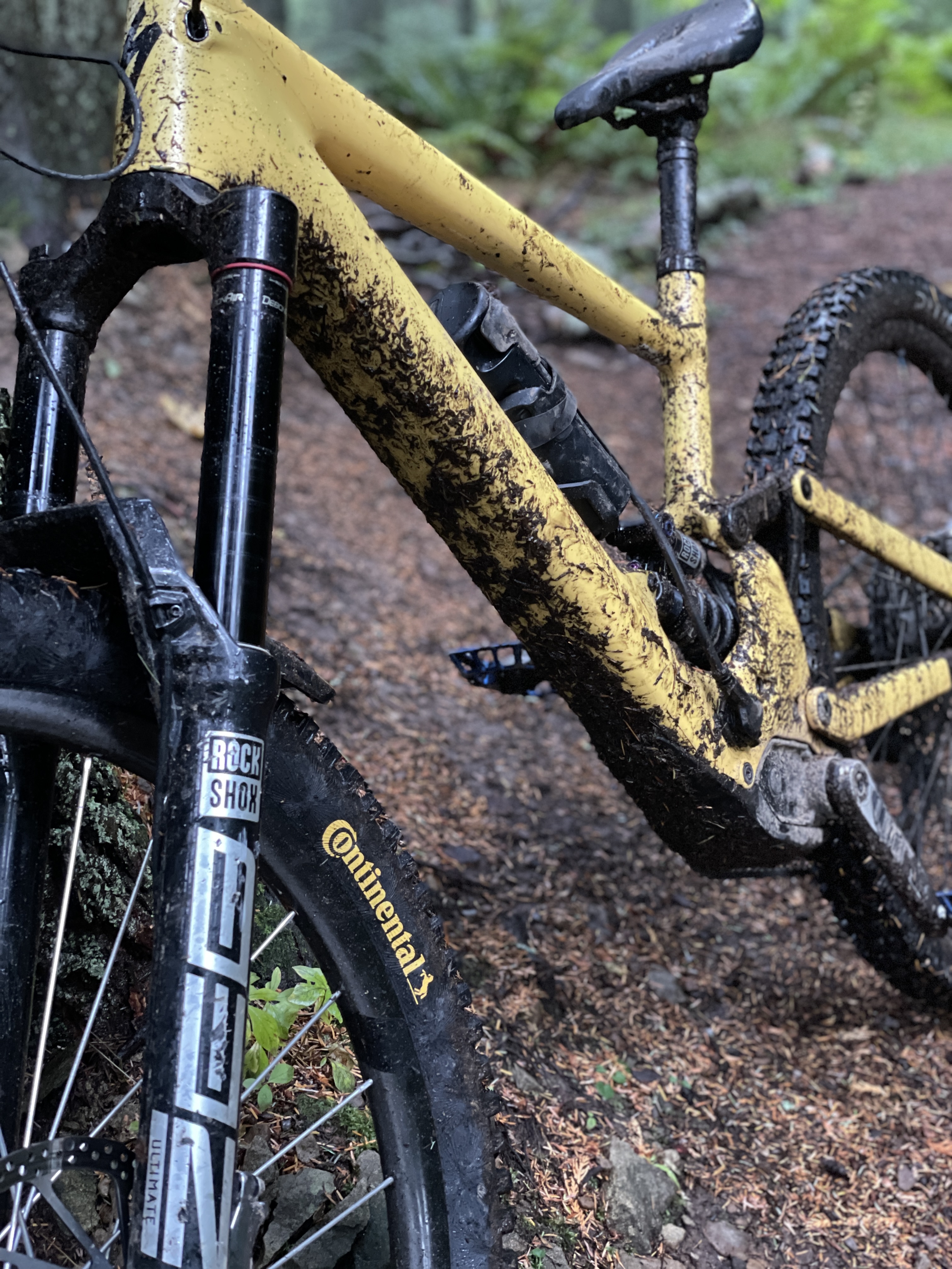

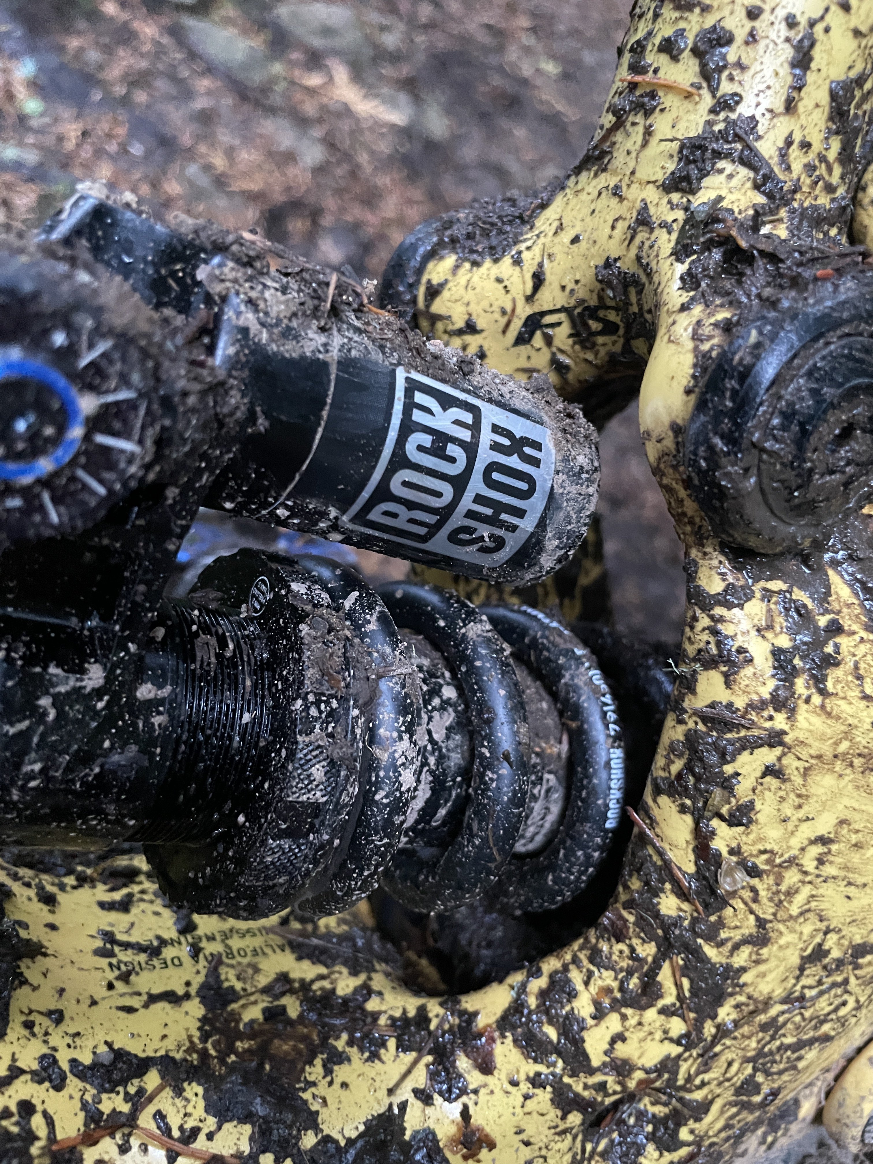

Thanks to this thread I decided to try a 230x65 shock for the 177 mythical rear travel. I went with the RS Super Delux to keep it in the RS family as I’ve been using the 190mm ZEB for a few months and have loved it.
I’ve been using the high position setup in the rear and the 1+ slack position in the front to try and compensate the geometry with the big fork. I haven’t done the math on the angles but the bike has felt amazing for the stuff I like to ride and at my size (6’2” 220lbs).
I had been using a 525lbs spring on a Push but tried a 450lbs spring on the RS. My thinking was a little more travel and the hydraulic bottom out on the new shock would make it more fun.
1st ride impressions: so much fun with a softer rear suspension. Takes some pressure off my arms. The HBO (hydraulic bottom out) on the coil is the real deal. I tried to push as hard as I could into some jumps and hucks today on familiar trails and only managed to get that dreaded bottom out click feeling once which was a big improvement from the Push Industries coil. The HBO jacked to the max actually makes the coil feel like an insanely progressive shock with an lovely ankle saving squish at the bottom of big hits. I felt like I was going faster and popping higher on jumpies. Definitely could feel the extra travel even if it was a small amount. Permagrin.
As far as the pedal strikes go, I didn’t have any problem on the descents but visually it looks like the pedals do sit lower than on the 230x62.5. Haven't done any technical climbs yet but I’ll check back in when I do. The fire road climbs Bellingham were totally fine with the coil lockout.
C4D1E810-A872-4037-9F92-747E014FE682.jpeg 76848FDC-3B5F-4C10-845D-D7BE5A05BBB0.jpeg
View attachment 100525 View attachment 100526
Great you are enjoying it. I would say you are quite under sprung at 450lbs. At your weight at least a 500lb spring would be needed otherwise your sag will be huge.
The extra travel you can feel is because the Push shock gets thru it’s travel way too easily and spends a lot of time on the bottom out bumper and so feels nowhere near a 170 travel bike.
I am running a 450 spring at 84KG. That gives me round about 27-28% sag measured at the shaft.
Interesting. I haven’t really set up a coil before so was just going by feeling. The sag looked around 30% to me. I’ll probably go get a 500. Good thing the RS springs aren’t too expensive.

I assumed when you mentioned you had a Push coil that it was on this bike?
Yeah they set that up for me. Felt too firm so I wanted to try softer. I actually thought it was a 500 push coil when I bought the 450 but actually was 525.
Regarding the Push, I had been using it for about 11 months but the seals went bad and it is going to take 1+ Months for it to be rebuilt by Push. Might sell it after the rebuild. I liked it just fine but the 230x65 is too enticing.
