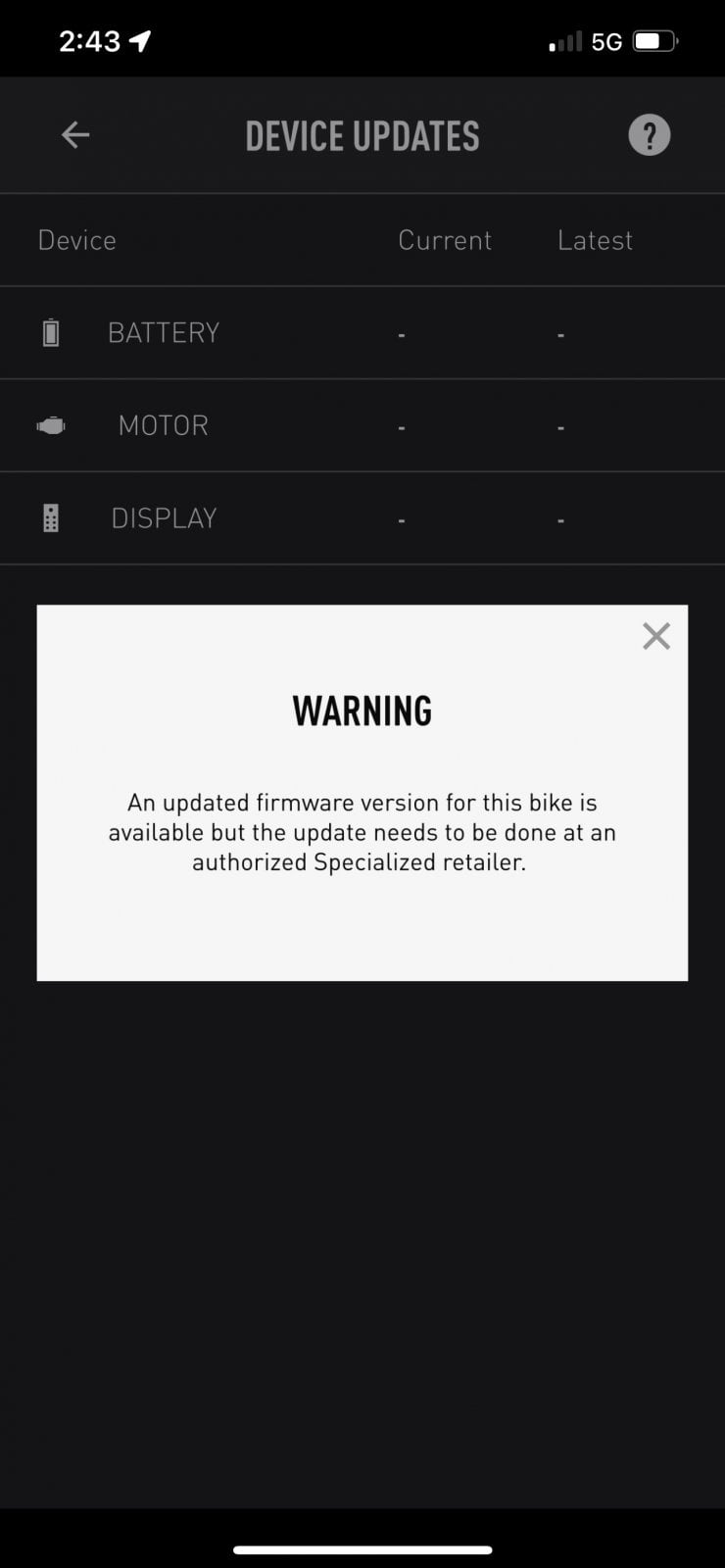

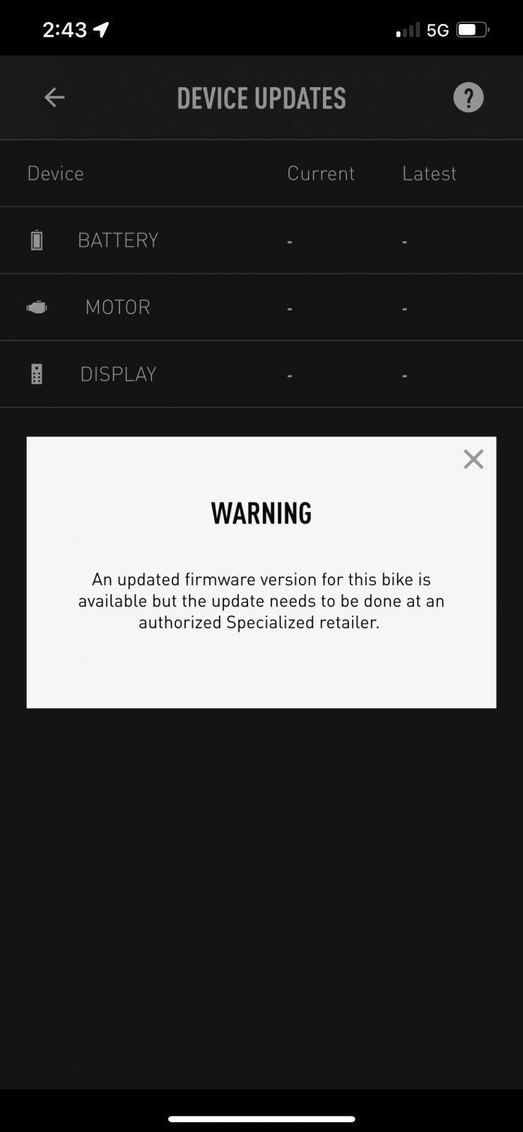

Anyone else had this pop up?
I just connected to Mission Control to change some power settings before heading out on a ride, and I got this message. Everything says it's up to date, and I just rode this bike a couple days ago without any issues.
I was hoping to get this sorted so I could get out for my ride early today, otherwise I'll just swing by my shop when they open in a couple hours.
I didn’t get a message like that but did get this message about an update that needs to be done at a dealer…
MM5K
Jan 24, 2022
52
72
Bay Area
Everything was up to date, but my motor had somehow lost its calibration.
We just had to hook it up to the computer, recalibrate, and it was all good to go. We also changed my wheel size from 2300m to 2000mm, so now I can go 23mph before the motor cuts out!

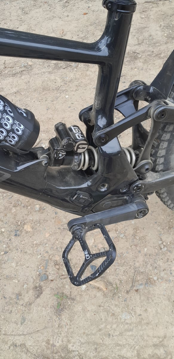

Has anyone fitted a DVO Jade (not the X)? Does the reservoir clear the frame?
Not much on at work at the moment so I've pondering the effect of shock length on a mullet KSL. The Jade is available as a 241 x 75 so with the travel restricted to 62.5/65 might be a way to get the geometry back to stock while keeping the 27.5 wheel.

The suspension would then start at around 3.4 leverage rate, end would be the same since it's very flat on last 4 cm (2.45). Moving sag point so much to the left could leave the bike little bit too soft.
I think it's bit too aggressive solution, do you still find the BB too low in mullet with only BB in high as compensation? I find it rather perfect, but putting headset into steep will inch another 2mm back.
But then again, year ago it seemed like half of all Rise owners long-shocked their bikes in similar amount (210 -> 216 + 4mm from offset bushings) without much complains, so you can experiment.
