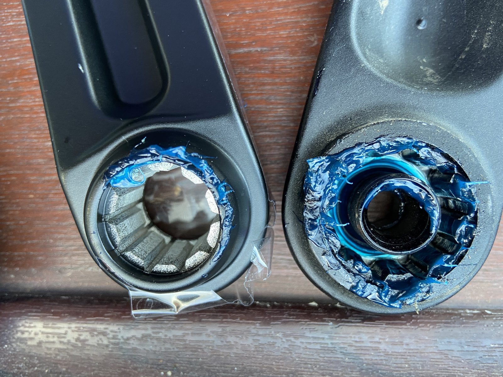

I just bought some 152 Miranda cranks advertised ISIS cranks but they don’t fit ?
any ideas

The only option at the moment for shorter cranks is Praxis. The Mahle motor uses a custom M30 spline interface and there are no aftermarket options other than to buy shorter Praxis crank arms. 5dev said that they are looking at making them for SL’s but as yet they haven’t released anything.
Many thanks I’ve looked all over the net and phoned a few bike shops. I had a S3 KSL and pedal strikes really were no problem. Changed it for a S4 with the 170mm cranks and getting a load more strikes.

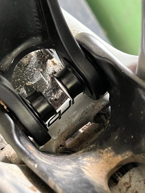

Hi Guys,
need some help. I had removed my Push 11.6 for some maintenance. Now i didnt get the damper between the spacers at the lower Rear Shock Eye. the Space is so closley and it seems that is a way to small for the damper eye. Do you know any tricks to get in?

Remove the rear wheel, flip the bike upside down.
Install the upper bolt first, then use the rear triangle as leverage.

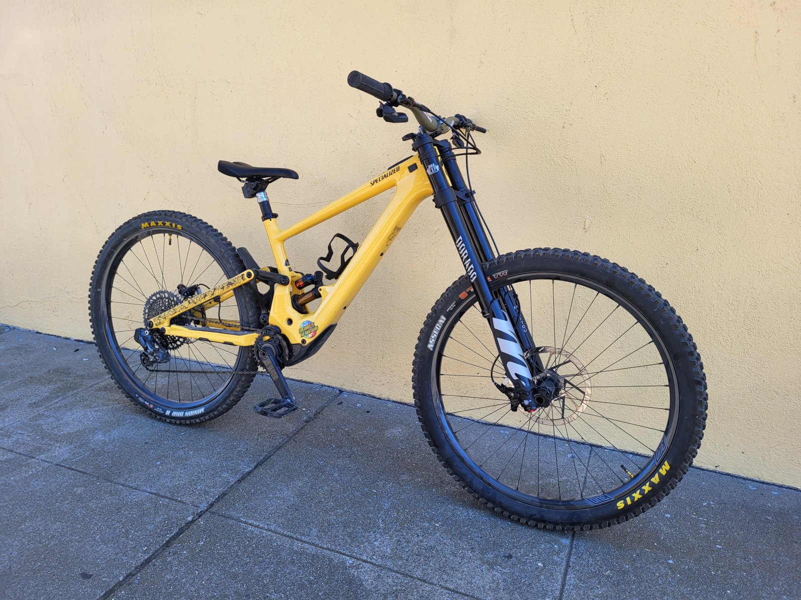

I swapped my cranks down from 170mm to 165mm since the bike does sit low. I think I prefer the original length but wanted to avoid the potential strikes in the low BB position. BTW if someone wants to buy the Carbon 170mm lightly used, DM me they're just collecting dust and won't be installed again.
