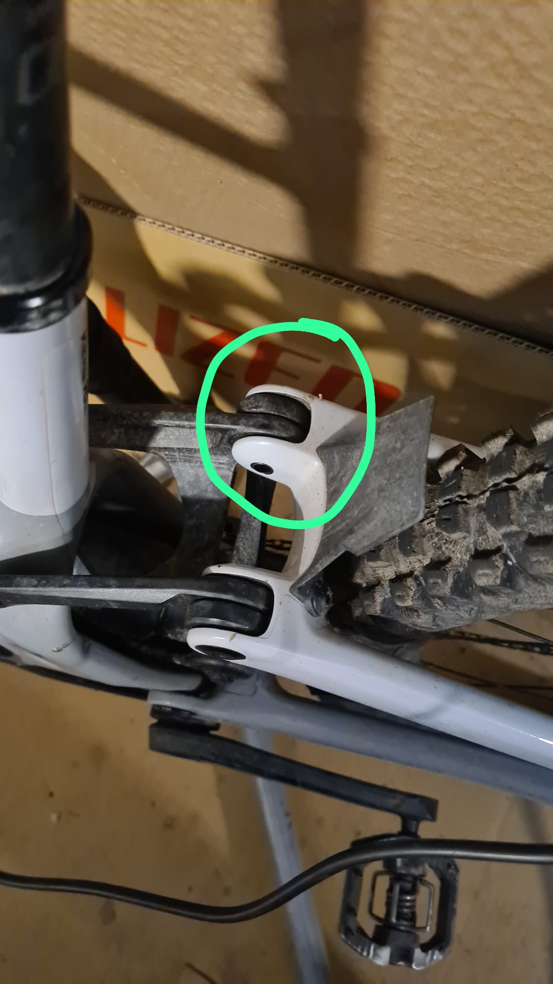

Hello,
Anyone with play on the upper link bolt? It turns but doesn't fix... Thanks
Kenevo SL
