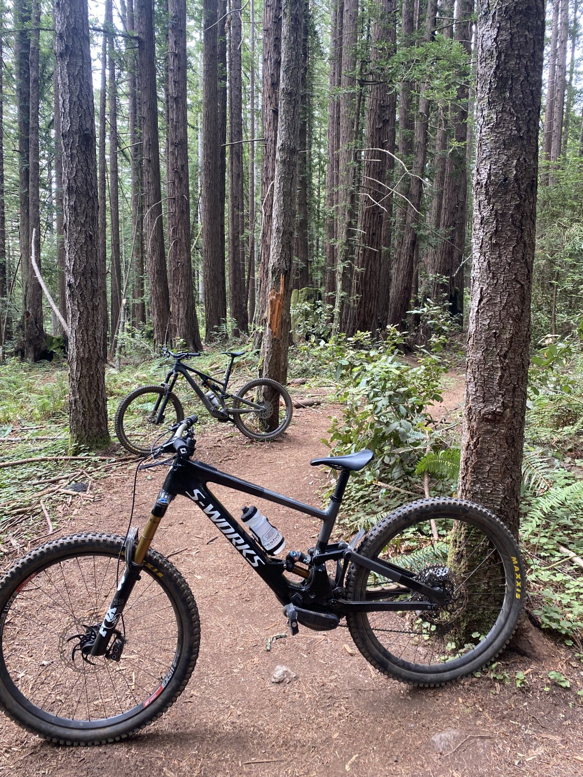

Got to ride my friends Kenevo today. Felt more similar to my Enduro than it did my ebike. Really fun bike that I could probably get used to. Not sold on the low power/range yet though. I like having 2 full sized batteries for my EP8 Commencal and can get 8k’ (2440m) elevation gain without even thinking about conserving.
Yeah it’s not going to be your “smash 8k vert as fast as possible “ bike. But man is it fun going down.
Agreed. Highly considering selling my Enduro + Commencal to get one as my only bike. I don’t like having more than one bike at once anyways.
