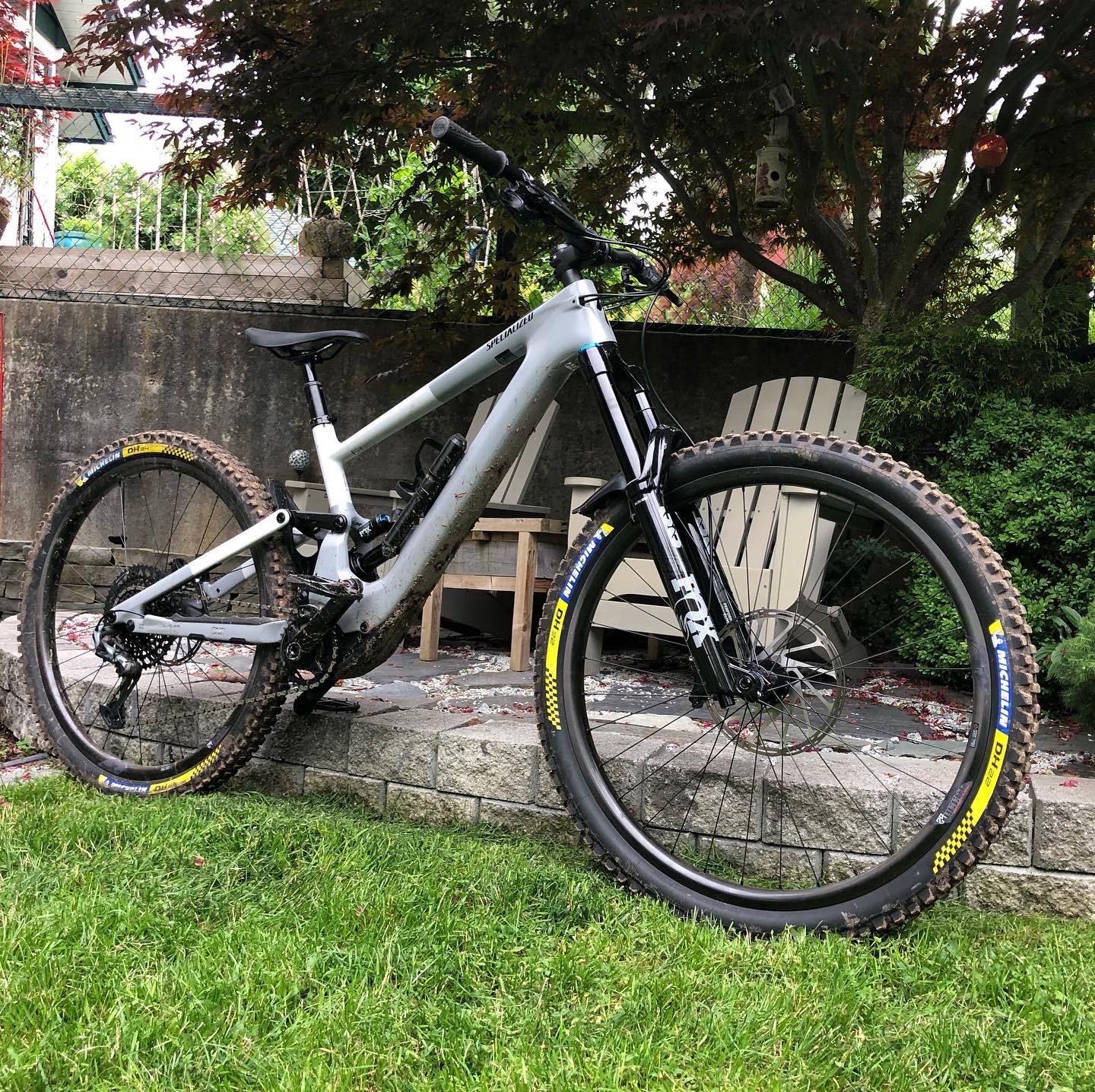

Got a couple of runs in tonight.
Still need to do proper bracket testing.
(Tomorrow, I hope)
I’m on a S3 - I’m 97kg / 215lbs ~
Shock: So with 2 bands in the shock - feels really good. Did a high speed flow/tech run with decent compressions throughout.
Shock felt amazing. Travel used was perfect.
PSI is 210. Big improvement from previous ride. (Had 220psi and no volume reducers. Shock seemed harsh)
Fork: 3 tokens and I came down to 110PSI - sitting at 18% sag.
Not using as much travel as I thought I would, even from some decent drops that would use max (without bottoming) travel on my ZEB.
This bike is at least 10 lbs lighter, so I guess it all makes sense.
Im going to try a bit less PSI - go to 20% sag and leave 3 token for my next testing session.
I’ll get into compression and rebound settings after the next ride.
Cheers

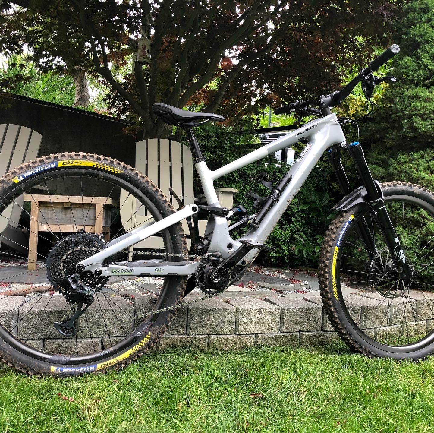

Picked up an S4 KSL and in the process of setting it up. Did a few rough measurements which might explain the pedal strikes some are mentioning here.
With the rear in low and the fork in the mid setting the BB height is approx 335mm. This is loowww.
I changed the rear to high which brought it up to approx 347mm then finally changed the fork to the steep option and ended up with a 350mm BB height.
Putting the fork in the steep setting also reduced the front centre by about 10mm.
I'll start here, see how it feels and adjust as necessary.
230psi in the shock for 18mm shock sag but will check the wheel travel sag to confirm actual %.
100psi in the fork with one token.
:cool:Stoked to have found one! So looking forward to the first ride
First off, congrats on scoring the new bike.
I love the KSL so far.
I’m about to head out to the garage and change the low to high.
I’m going to leave the mid setting on the head angle and see how it rides tomorrow.
I do really like the flow trails with the low setting. Berms have been fun! But tech climbs have been noticeable with strikes.
I also still want try a mixed wheel setup - even if just for a day on flow trails ;)
Enjoy the new bike!

Put a RideWrap kit on. Relatively painless process, took about 90mins and I'm really happy with the end result. Found it easier to handle than Invisiframe and the RideWrap coverage is better too. Bike is good to go!
Fork at 100psi with 1 token feels supple but definitely less mid stroke than my Mezzer set up. First trail ride will reveal what needs to happen with that.
The shock has 230psi and today I had a friend help with measuring (hopefully it's more accurate than bending down and resetting the o ring) and I got a wheel travel sag figure of 50mm which is 29%. Good starting point.
FYI the o ring had moved 15mm on the shock so either I moved it slightly when I measured it initially myself (I got 18mm) and/or the geo changes have had that effect.
I'm 88kg (197lbs)btw.
I need to get ride wrap before I scratch this frame.
I have liked the 38 so far vs. the Mezzer. It's noticeably more supple off the top and a bit more progressive. I miss the linearity of the Mezzer ( i had it setup ~ 1.5 ratio IRT/Main if i recall), and the soft HBO feel, but I can't say the 38 is lacking too much midstroke. It could just be how I preferred my mezzer to feel, but I may still swap that over to get some back to back impressions. How were you running your mezzer pressure-wise, and on what bike?
