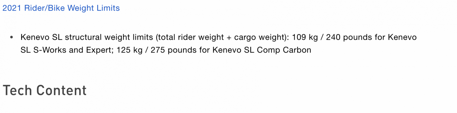

Interesting note.. found this when searching for the KSL manual:
Kenevo SL Comp Carbon - so at some point a lower cost entry point + it seems like it may have a different carbon layup OR some carbon + aluminum chainstay arrangement. not sure how else they up the total weight.
BTW - 240lbs all-up is not that much considering the bike weights north of 40lbs... EDIT : I misread - cargo weight does not equal bike weight.
Perhaps the limiting factor is the wheels rather than frame?
Specialized warranty wheels for life of original owner, so they would have done the maths on overweight dentists destroying carbon wheels vs very overweight doctors replacing the alloy wheels on the " lower spec" ksl, realized only carpenters can afford to do that and tossed the problem over to legal hq ?
CjP
PRIME TIME
Jan 1, 2019
1,671
2,394
Everywhere
Na my Expert came with metal rims.
Probably all the Fox performance gear can handle before it explodes.
