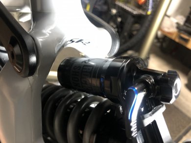

Got the RockShox SDU Coil in the mail yesterday. Going to install it soon and see what it's like.
I also have my 27.5 rear wheel ready to go.. but I'm really not convinced it's a good idea. The bike is so good and I feel a mixed wheel setup would not make this bike feel any better. + I have yet to buzz my ass on the rear wheel -> The main reason why I'd want a mixed wheel setup.
(Like I had on my Norco Sight VLT 29)
I mean someone should try a mullet and write about it for #broscience , but I tend to agree. I think the positive nature of the rear end suspension dynamics will change and probably not for the better.
but definitely try the coil first and then add the mullet to be able to quantify the differences if you can

Sad news. A RockShox Super Deluxe Coil does not fit the KSL.
The reservoir is just a few mm too long for the top of the shock tunnel during deep compression.
Lucky I added RideWrap there.
I also tried it the other way around but the LSC knob hits the linkage plate.
Oh well. Now we know.
