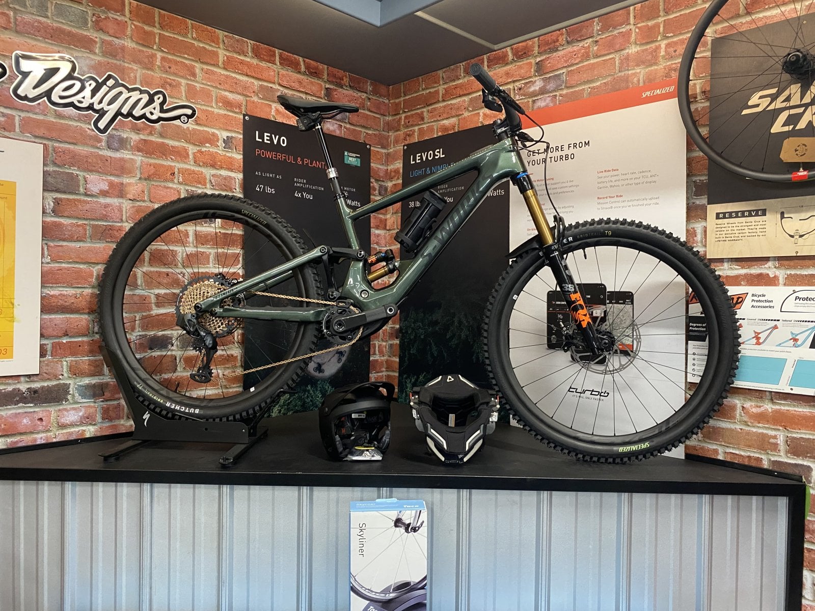

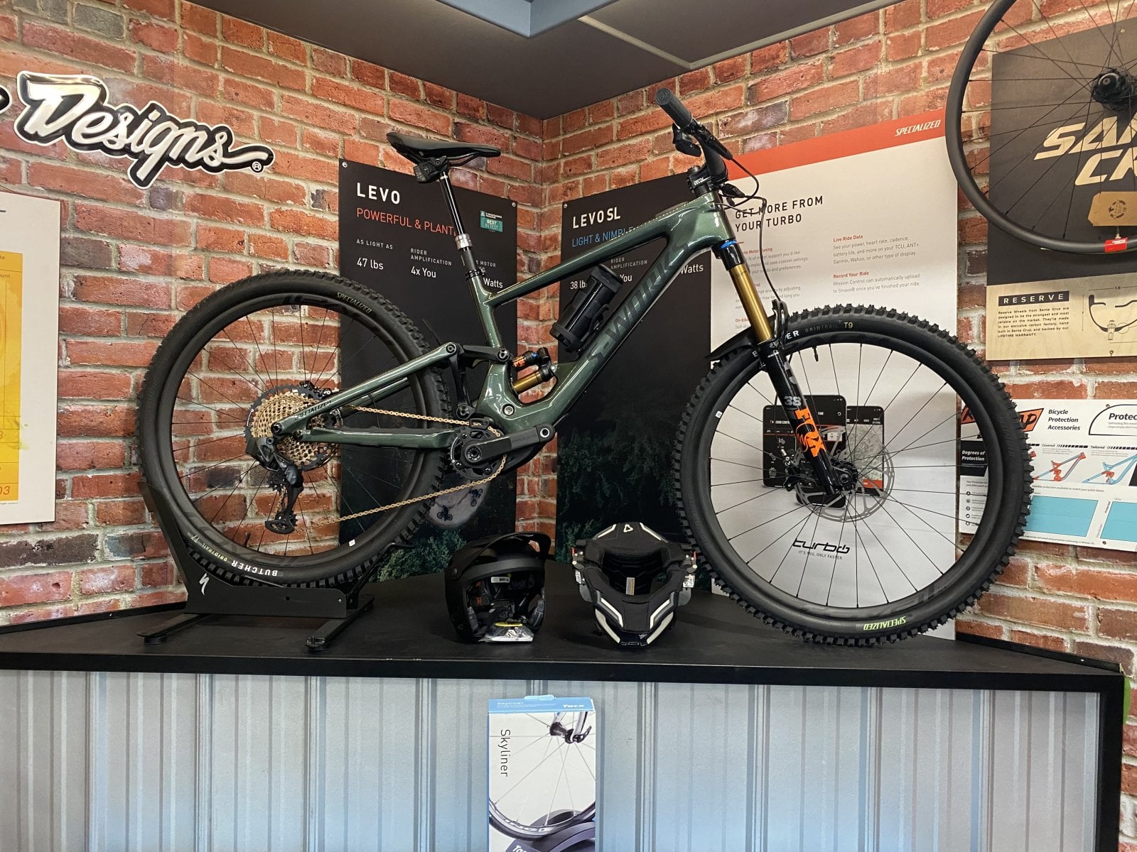

How are those tires ? Should you consider going bigger ?
I am used to a bit wider tires not much but running 2.5 and 2.4 at the moment on the analog.
The tires look about 2.4 ish. A tad bit less rounded than a 2.5 would look I think. It really depends on your terrain and preferences imo. After two rides, I can say these tires roll slow on pavement (ride to the trail) , grip really well, brake well, and feel robust. Granted this was all with stock wheels and tubes still, but these tires feel like what I would want at a bike park or where it’s steep and loose
Swapping to my carbon wheelset with cushcore xc inserts, 2.5 tioga edge front , and 2.4 versus rear I lost about 900 grams of rolling weight. I haven’t ridden those outside the yard yet on this bike, but wow it’s definitely a noticeable difference of bike liveliness. I will see how they do on the trail, but given my experience on the SL, I imagine it will be fun

Random thought re. seat post insertion: Looks from the user manual diagram that Spesh has reamed the seat tube to limit insertion depth. I’m guessing could be related to cracking issues with enduro shock tunnels, which may have been triggered by dropping in the post and having the pointy mechanism smash into the roof of the shock tunnel and potentially starting a hairline crack from the inside. Just conjecture, but could explain this weird crack that a lot of folks saw.
ANYWAY... if you’re needing an extra few mm of insertion depth on your Kenevo SL you might try using a smaller diameter post with an adapter shim to potentially bypass the ream limit.
My frame hasn’t arrived yet, so no idea if it works. Just thought I’d throw it out there in case it’s a problem solver for some.
I did some measuring and I can push the seat post in about 21mm further than I have it set currently with the stock 170mm manic. That would put me right between a 200-210 one up when considering the overall length. This is on the S4, and I am 6’1 with about a 33” inseam
