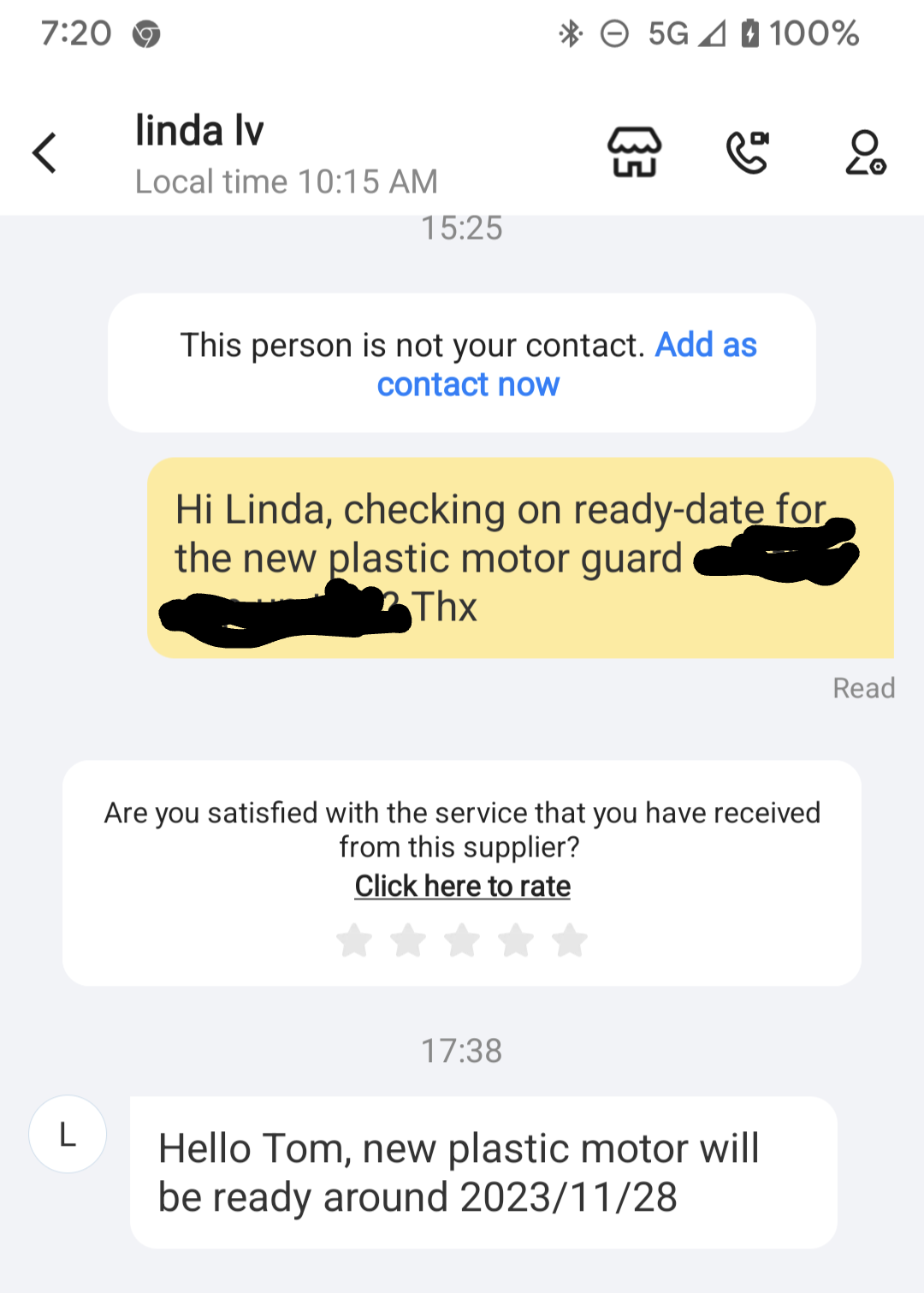

FYI: For peeps waiting for Gen 3 plastic motor guards

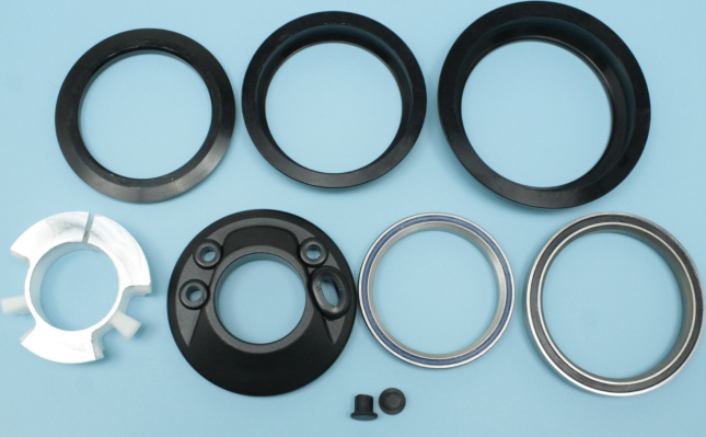

A company that responds very quickly to customer input. Headset, battery case, motor cover, UDH hanger and what else?
Frame cable routing instead of through the headset, new frame mounting position to support a coil shock, a place to store a multi tool in the top tube instead of a push button. They can omit the hole on the top tube all together if 25 frames are ordered.

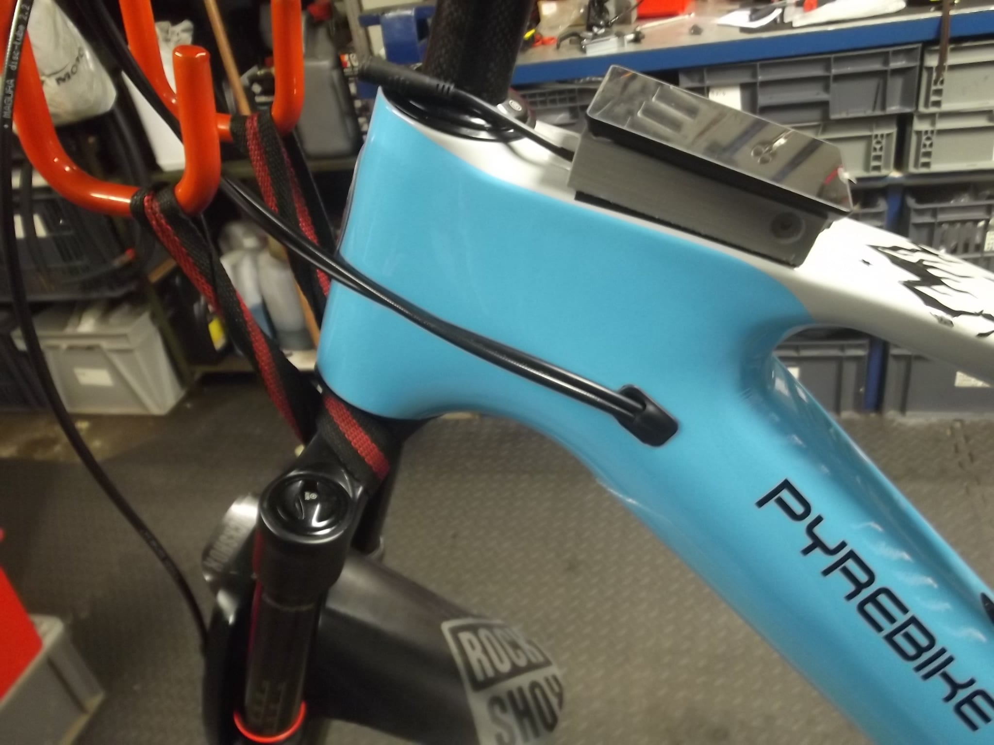

Headset cable routing is a crazy dumb marketing design for the dentist riders. The ONLY benefit is cosmetics. In an eMTB it is suicide. Water gets through the mostly ineffective seals and ruins your bearings and then drips down and destroys your battery. Not to mention how much fun it is to replace a worn cable housing or brake hose.
patdam
Jan 17, 2019
945
608
france
For me the most important problem is the constraints on cables,. Exemple, you fall down and handelbar turn at 180°. Headset cable routing is good on road bicycle, who never turn more than 90°, but not for E-MTB, where battery leaving lower space for cables movement

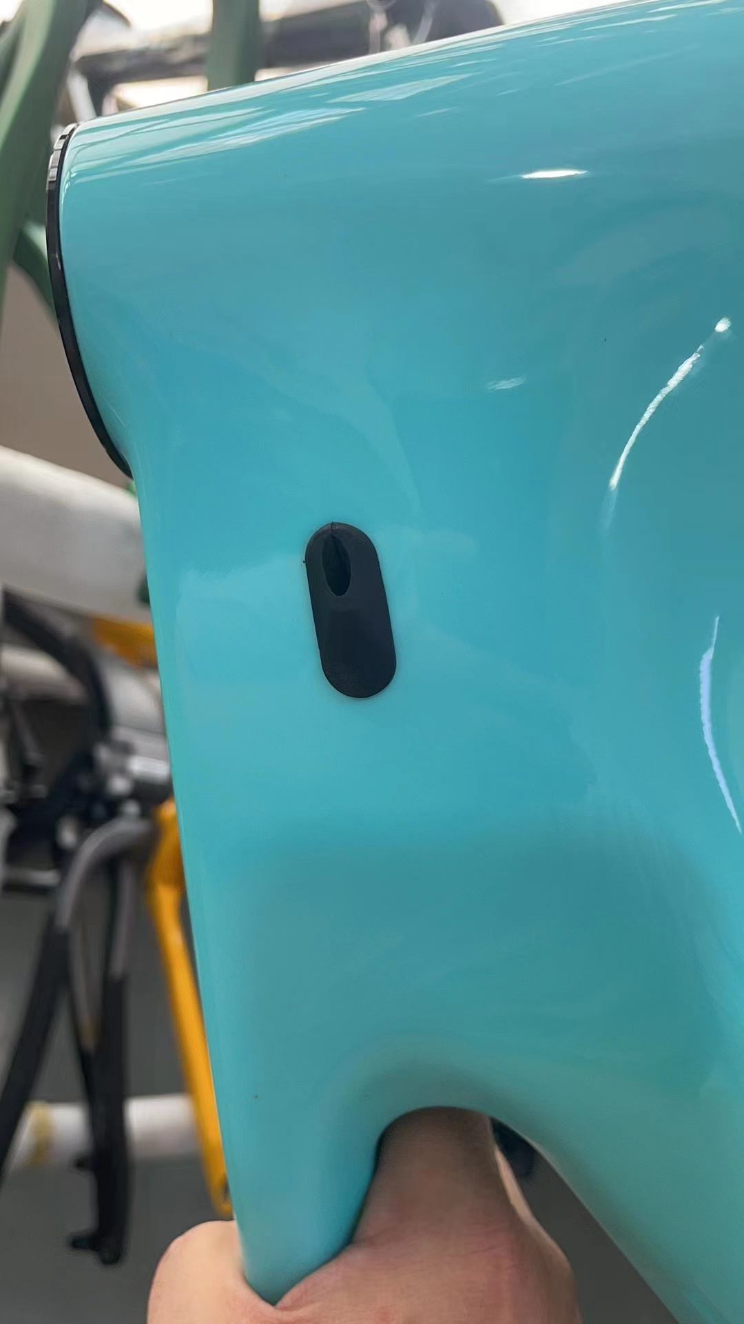

New design headset cable routing vs frame cable routing. What would you choose if you had to order new frame now ?
Good question🤔
The cable grommets (at first) did make me question how many cables could be routed through each side of the headtube. But I have seen examples of CEF50's with headtube cable routing on the forum. And no one has expressed any issues.
If I had to build another one, yes. I probably would go headtube cable routing.
But being honest, I've had no drama or problems with headtube cable routing👍🏿

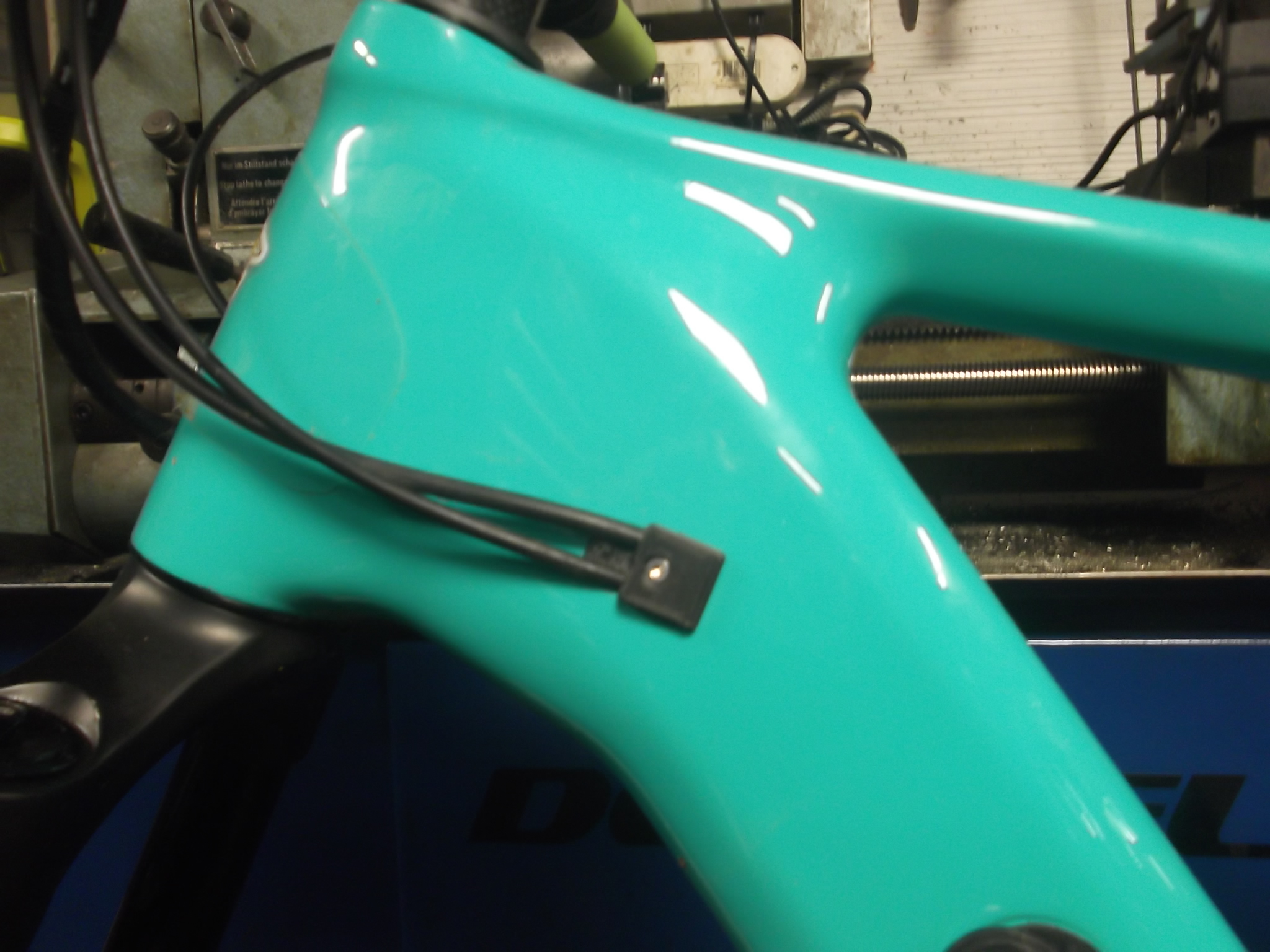

Curious. Your cable grommets and cable routing is from the top of the downtube. But I was of the belief it would be around the headtube area.
Did you make those cable holes yourself or was that how the frame arrived?
i have request holes to SZZS, i have communicate the dimensions and showed those used on my LCES1075. They have sent the frame with the exact items to pass the cables. I appreciate a lot their reactivity and effiency.
