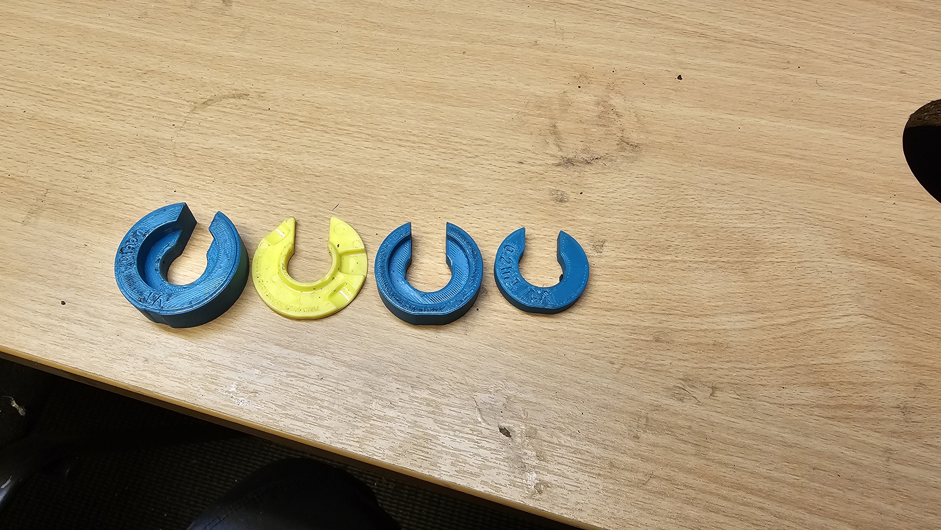

PSI used to achieve 30% sag for the CEF50 will vary from rider to rider. And subject to how much bottom-out support they require, a rider will use a bigger or smaller volume spacer👍🏿

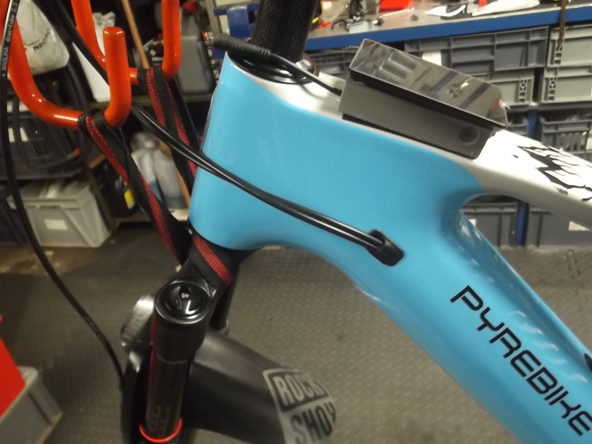

Not tested for the moment, butThat i constat with my XL with 150 fork and 2x 29", i have 63.5 for fork angle, 1305 wheelbase. those value are extrem for me and i can not doing what i wanted, with more front travel and 27.5 rear. Because that will reduced fork angle and increase wheelbase.
The only possibility whould be to use 27.5 front, but i prefer keeping 29. Does somebody use 170 front ? on which kind of tracks (fast rolling track, slow single track, technical, engaged) ?
I constat also that the seat angle is a lot of more than other bikes used until now and needs to modified a lot my position. have you reduced seat/handelbar length and handelbar height, or increase BB/handelbar length ? Compared to your usual values.

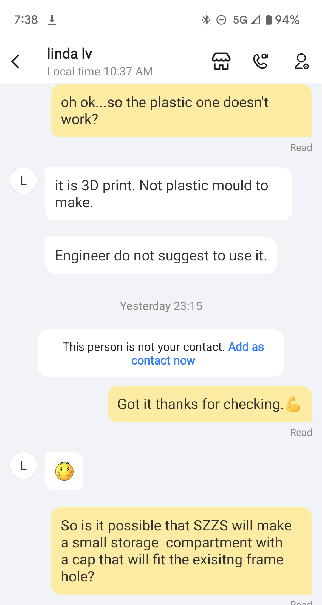

All right. Putting it out there for the pop-up tool to replace the top tube cap.
I asked Linda to consider aquiring it from one of their clients that markets the CEF50 under their brand name and that makes the pop-up tool compartment.
She finally got a sample. She said the SZZS engineer thought that it was not well made plastic and that it had to retro-fitted with extra screw holes. So, they won't be ordering any.
Personally, I'd be fine with just a empty storage compartment for soft items. Anything to utilize the hole practically.
Yes, I know peeps have varying opinions, but I'm pushing hard for them to make something other than just a cap that's not really water-tight. 😒
And yep, I thought about just sealing the cap off with glue on the new warranty frame. Initially, I was going to carbon-patch it before I painted it, until I saw the pop-up multi-tool a few months ago.
Anyway, if you're up for specifically for a small storage compartment let Linda or Jean know. If enough ask, they just might respond affirmatively.👊

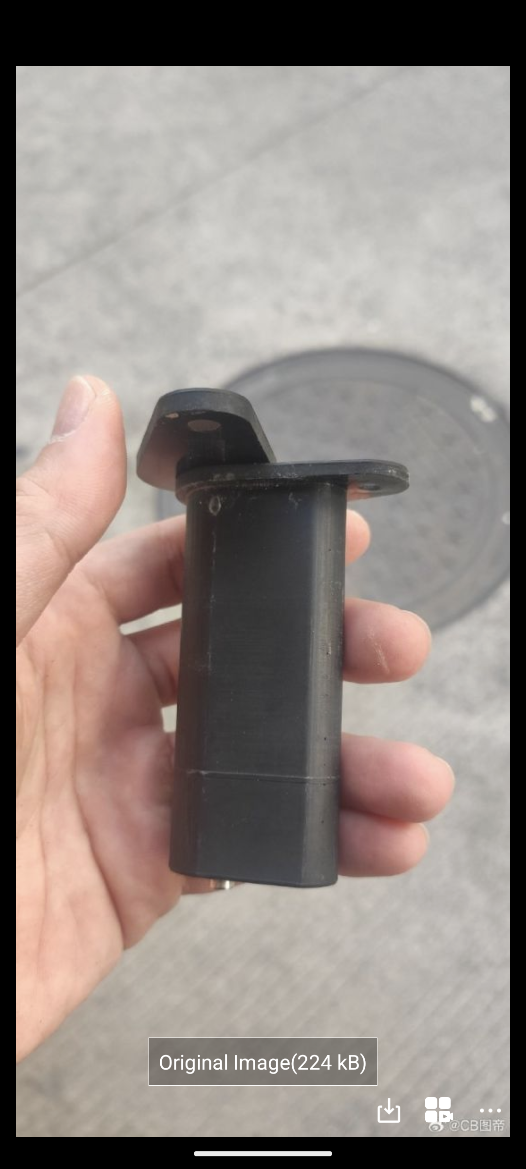

Jean said they were in the sample making process. Once confirmed mass production will start and will notify once avaliable.
Great! 💪
Did Jean say what they were making exactly...Linda was unclear.
A similar pop-up tool compartment, or an empty, small storage hidey-hole? Either one works but thinking simple is quicker and less trouble mechanically.

Great! 💪
Jean sent the photo of the pop up tool image. This was 2 weeks ago not sure if you have been talking with Linda more recently. I can inquire again to confirm the pop up tool compartment will be avaliable.
Yeah, I sent a pic from our thread in late October to Linda....Jean seems to be the most accurate contact from my experience. Unfortunately Linda isn't always up to date or 100% clear. So, whatever recent updates Jean has is good.👊

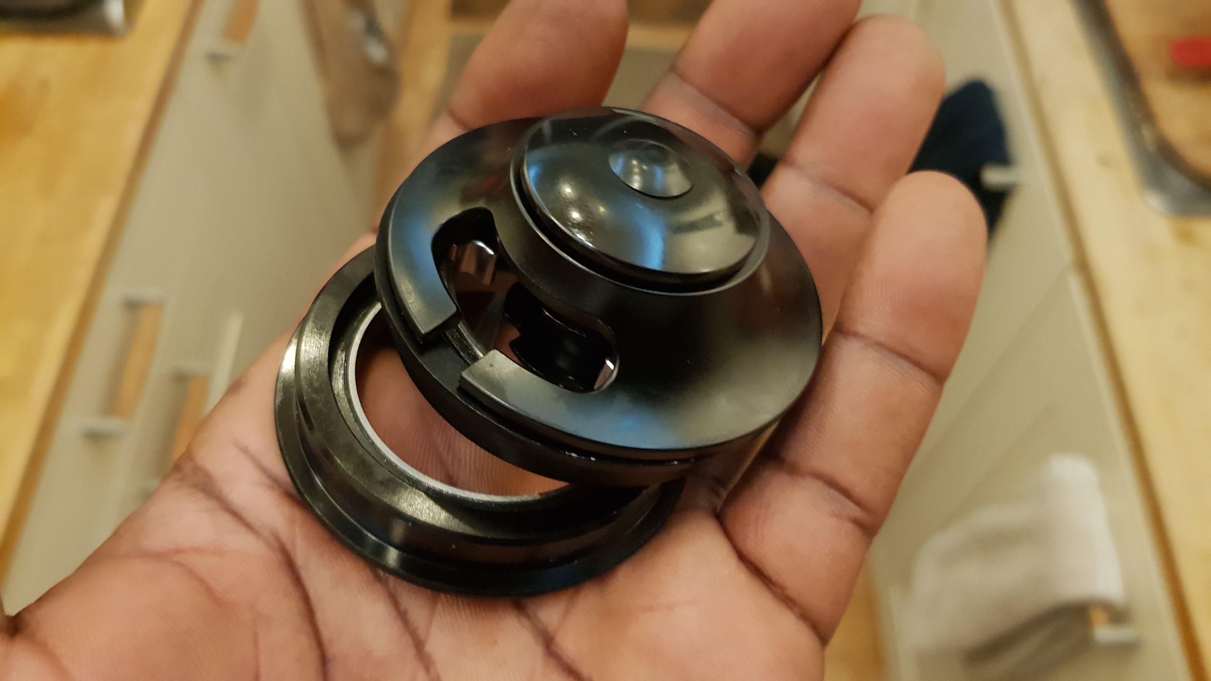

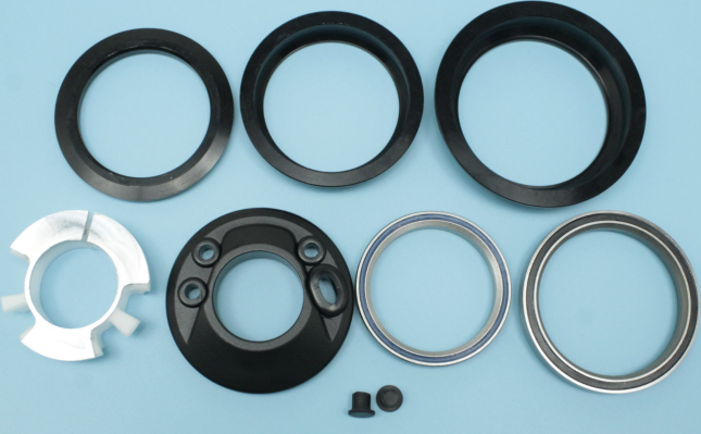

I seem to be having excessive headset creaking I've taken it apart and regressed the bearings but after a few rides it persists. I even reinstalled the bottom cup as I thought it may be the culprit but after a few rides I get the same creaking again. Any suggestions? I'm using the nukeproof headset and the stock bottom bearings.
kaylee.s
Jul 6, 2023
46
64
Redondo Beach, CA
My lightcarbon lce930 is doing the same thing. No solution yet.
Pinkee
Jul 5, 2023
15
I have the same issue. My e10 is rock solid, but my CEF creaks like a 200 year old house.
I have even gone as far as gluing in the cups, but still the same.
Neeko DeVinchi
Dec 31, 2020
1,042
1,387
I too haven't had any creeking in the headset.
This headset will be arriving for next week. So I'll let you know how I get along with it.
Truth be told, I haven't had issues with this headset either. Granted, I'm aware that some members have expressed concern for the cables being damaged if not routed in a specific way.
My best guess would be that it might be either the bearings, the bearing upper race or, the crown race.
But I'll study both (along with the Nukeproof headset) to see if it's an easy fix for all of you👍🏿
