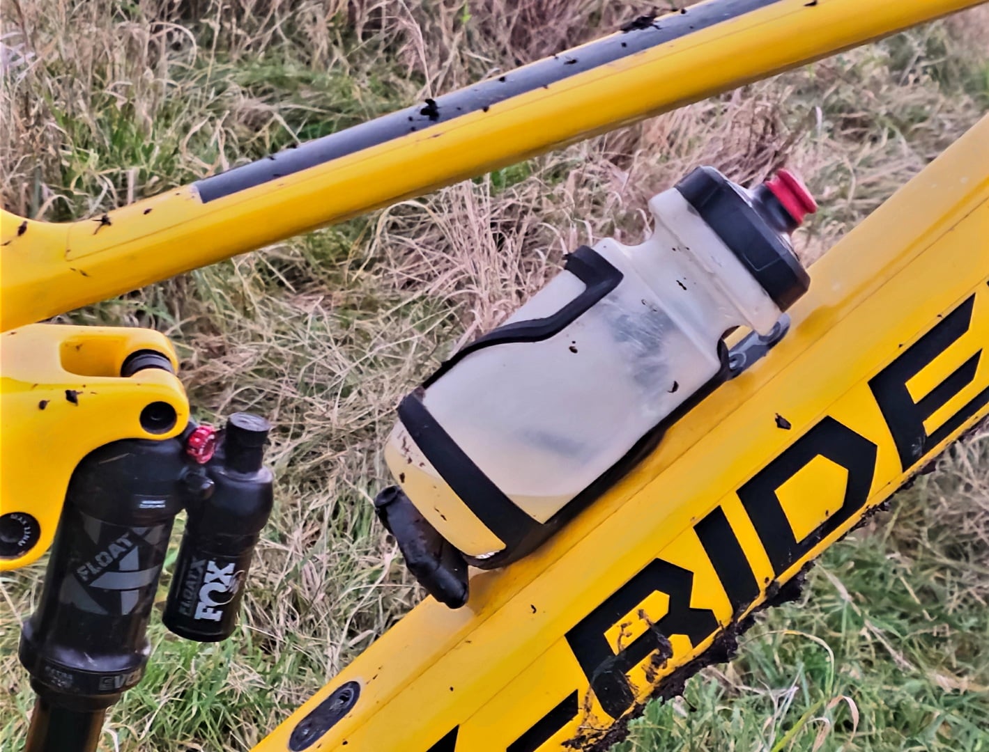

It does seem odd that a company that is said to own the ebike motor market puts so little resources into developing their high end market. Sure they make most of their money off low end motors at very high volume but they can't invest more in our market?
Still we are a DIY group right?

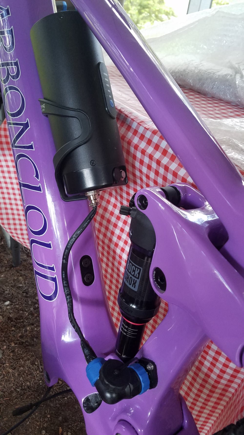

Your wish is my command...
TCFlowClyde
Feb 26, 2022
1,371
895
Mesa, AZ
I guess I missed the memo here. You did this in July then? It must have been too damn hot then in order to take in new info. 🫣

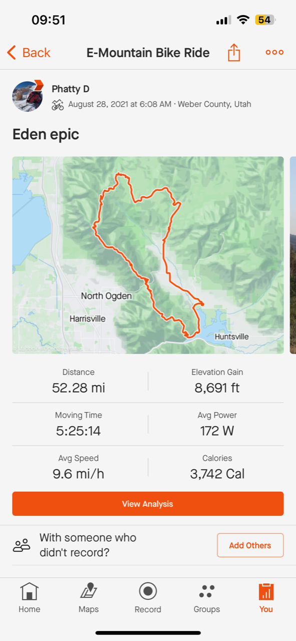

Just in case if anyone was interested in the performance of the Bafang M820 system👍🏿
@Neeko DeVinchi
Yes, my motor is just as loud. every time I jump back on the m600 with silent gear I realize just how loud the m820 is. I dont think thats go pro amplifying the noise, its just that loud.
Was that a 60-65 RPM on your cadence? Interesting to me as I find that motor seems to do so much better up around 75-90. I will downshift to spin at that cadence vs letting the motor work that much harder. I run a 34t chainring vs your 32t so maybe thats the difference. Good video, ill have to break out the go pro and film some stuff.

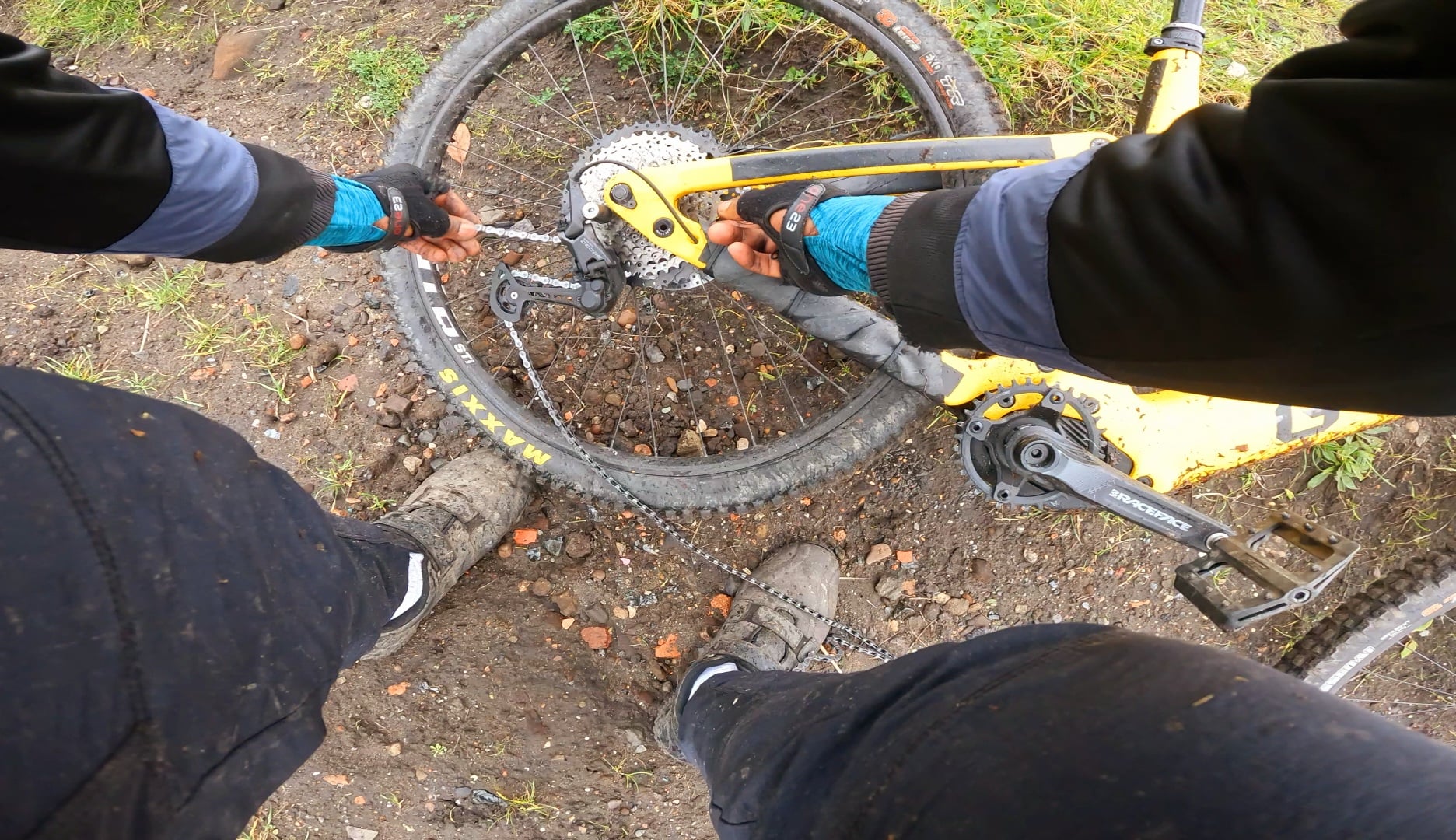

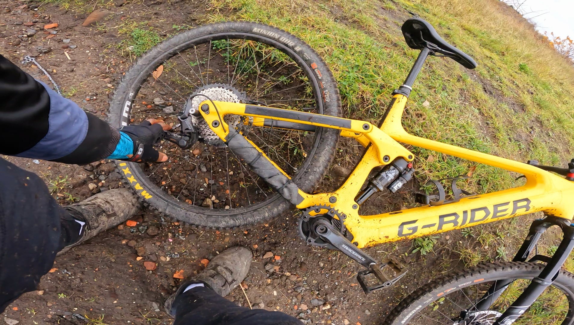

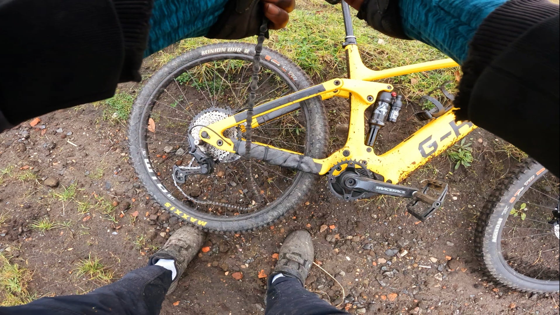

I had the same thought in terms of upping my cadence. I did reattempt a steeper climb a couple of days ago. Until,
I snapped the friggin chain😅.
Yeah, 75nm of torque. I should have seen it coming.
To add insult to injury, I forgot my multi tool with a spare quick link and chain breaker.
Oh well!!😁
As for the noise, yes. It's audible. And I wouldn't sugar-coat my opinion of the noise from the M820 with the classic"you'll get use to it" response. But i wouldn't mind getting another copy of the M820 to mess around with and cracking one open. In fact, i have no choice as I've literally made arrangements for two further frames which use the M820 to be sent my way (thankfully, these frames have XL frame sizes). By the time I've cracked one open, I'm sure I'll fathom how to get the M820 whisper quiet. So I'll gladly share my experiences👍🏿

Yeah low cadence big power is hard on those chains!! Ebikes should have a built in chainbreaker tool. hopefully the walk wasnt too long for you.
I swapped the chain out once I got back. But it was too dark to reattempt the climb that same day.
I may look into those one up edc tools for the CEF50 along with future builds👍🏿
12s? Seems like there are quite a few reports of 12s being more prone too breakage than say 11s.
TCFlowClyde
Feb 26, 2022
1,371
895
Mesa, AZ
The only 12 spd that seems e-durable is all Sram eagle. I use the XX1...cause I wanted all black links.😎 The others E-KMC/Shimano XT not so much good luck.
TCFlowClyde
Feb 26, 2022
1,371
895
Mesa, AZ
But it seems like 12s is not durable for standard MTB either.
Yes agreed. On my big fattie M620 160 Nm, I have an Sram EX1 that uses a special 9 spd chain for and 8 spd cassette with a trigger pod that shifts only up and down one at a time. I think it's a precursor to the new Transmission wireless?
Anyway, it's time for a lightweight internally geared hub or geared motor, so the mtb community can finally ditch the rear mech for good. 💪
Way better for shifting under load and in higher power modes to avoid the "crunch" and "clanking" sounds when shifting up the gear range.
