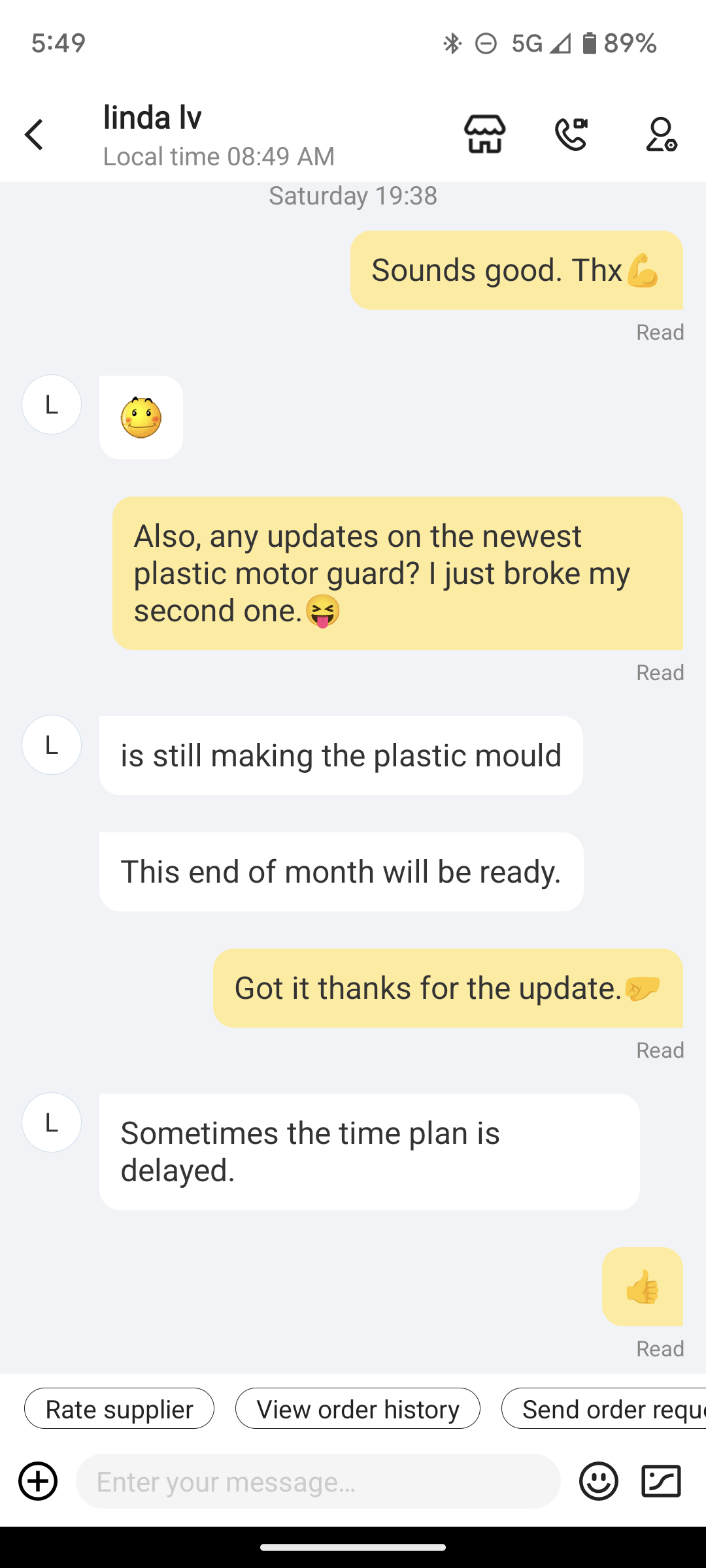

Sooo...just the 3rd ride in mostly flatter conditions. I broke a side piece off the modified motor guard dropping into a steep sandy wash...was a fun feature!🤟
Good news is that carbon reinforced tab mod I made held. Arguably, this was a major weak spot of the Gen 2 motor guard.
Unfortunately, the piece was lost on the trail before I noticed it when hoisting onto my bike rack. Otherwise, it would have been easier to glue it back on and just cover the whole plate in carbon. I still might cut out some spare plastic and graft it in...😔
Linda at SZZS says the 3rd Gen motor guard "should" be ready by the end of this month.

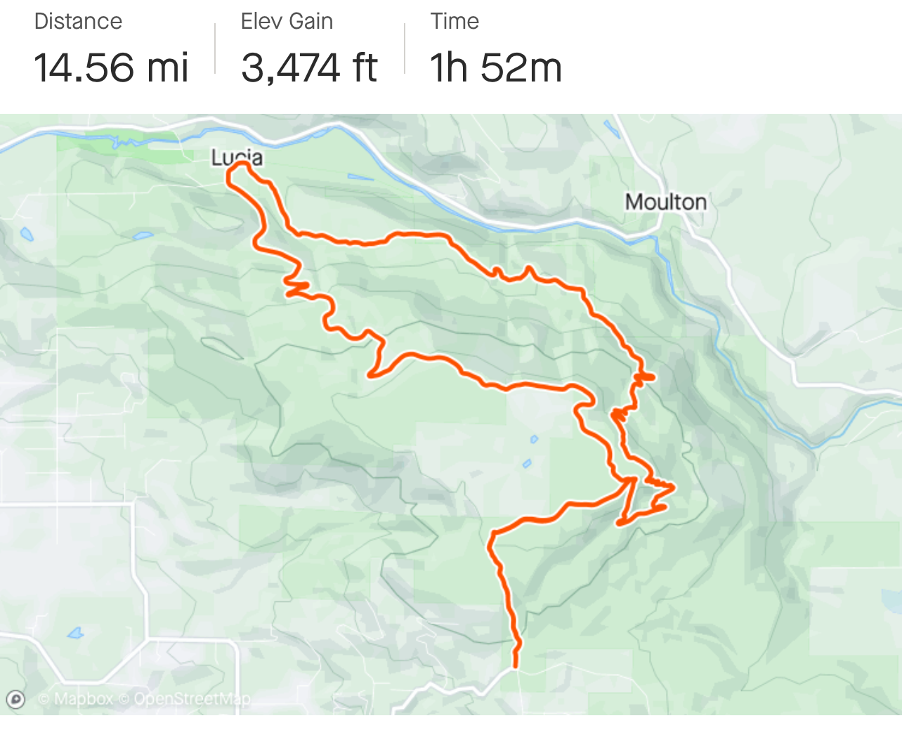

This ride below was going between sport and sport plus and I was still left with about 44% battery at the end of the ride. This would’ve normally been 35%-ish, I only know that because the day before I did a similar ride and I ended up round 30%.

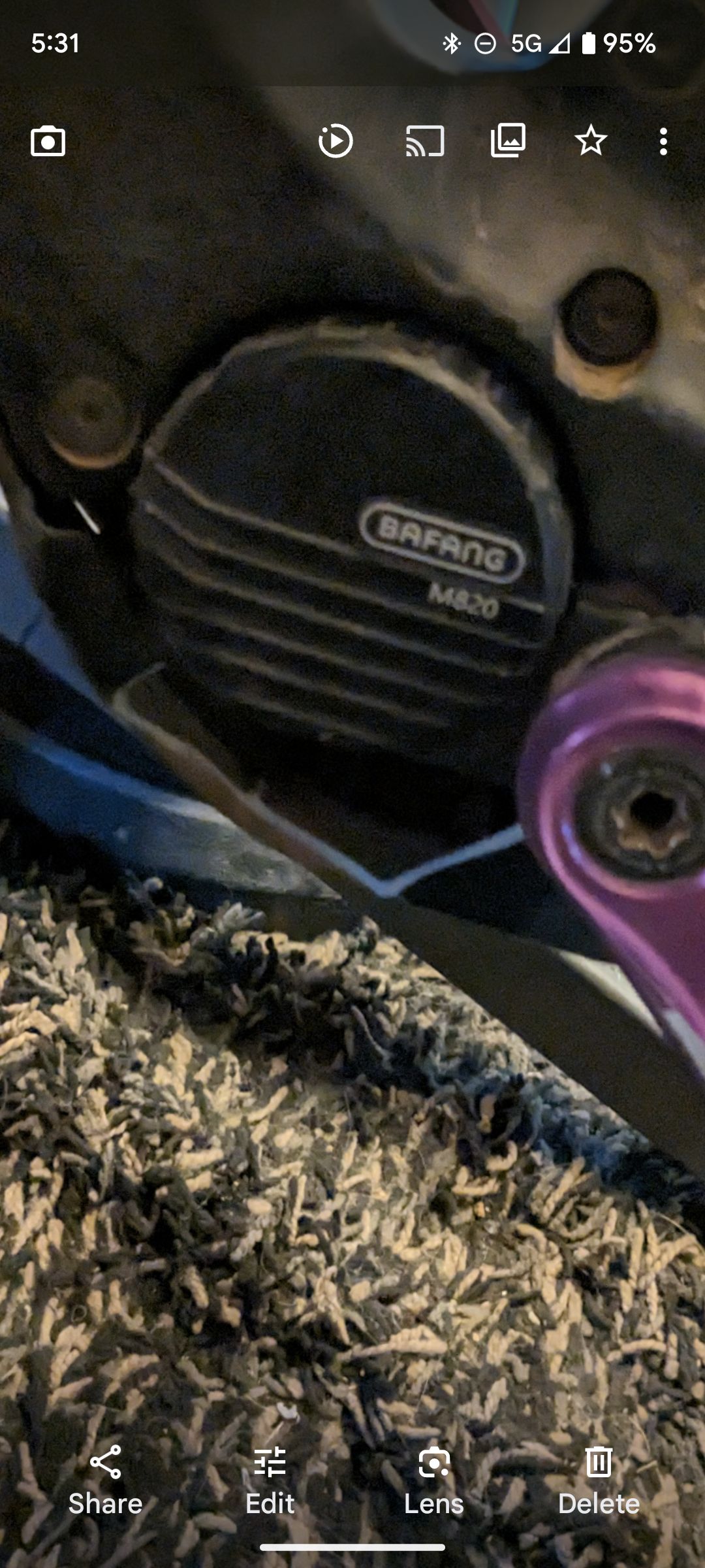

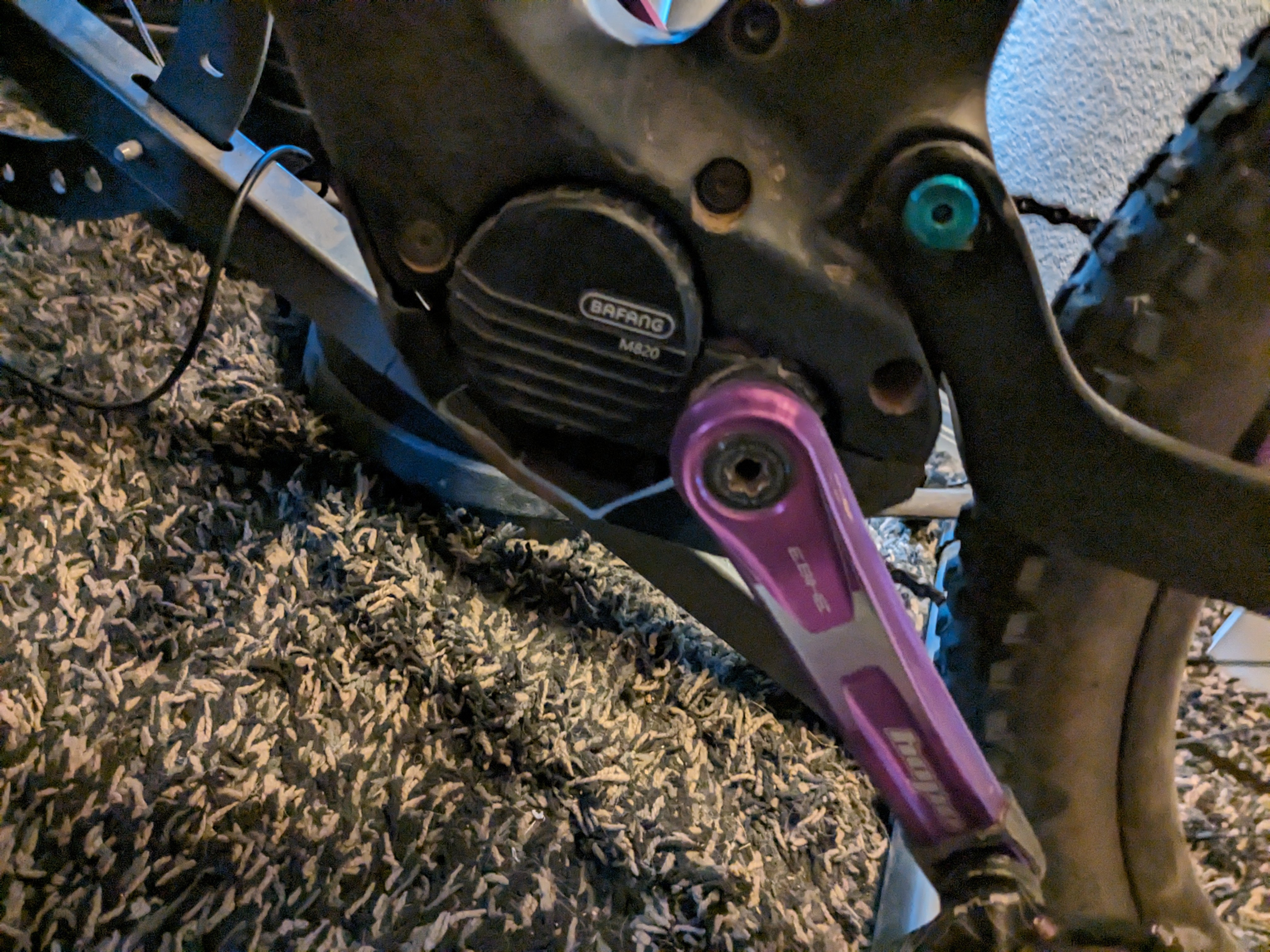

Since it’s winter time now, and I’ve been riding in more wet weather situations I’ve noticed a new squeak that seems to be coming from the motor. It seems to be only when the motors actually engaged regardless of whether I’m peddling or not, like with overrun. Are any of you experiencing any squeaky sounds coming from the motor and no where lube should be applied?
