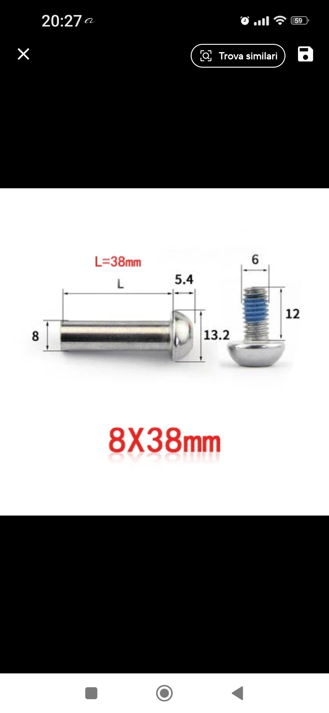

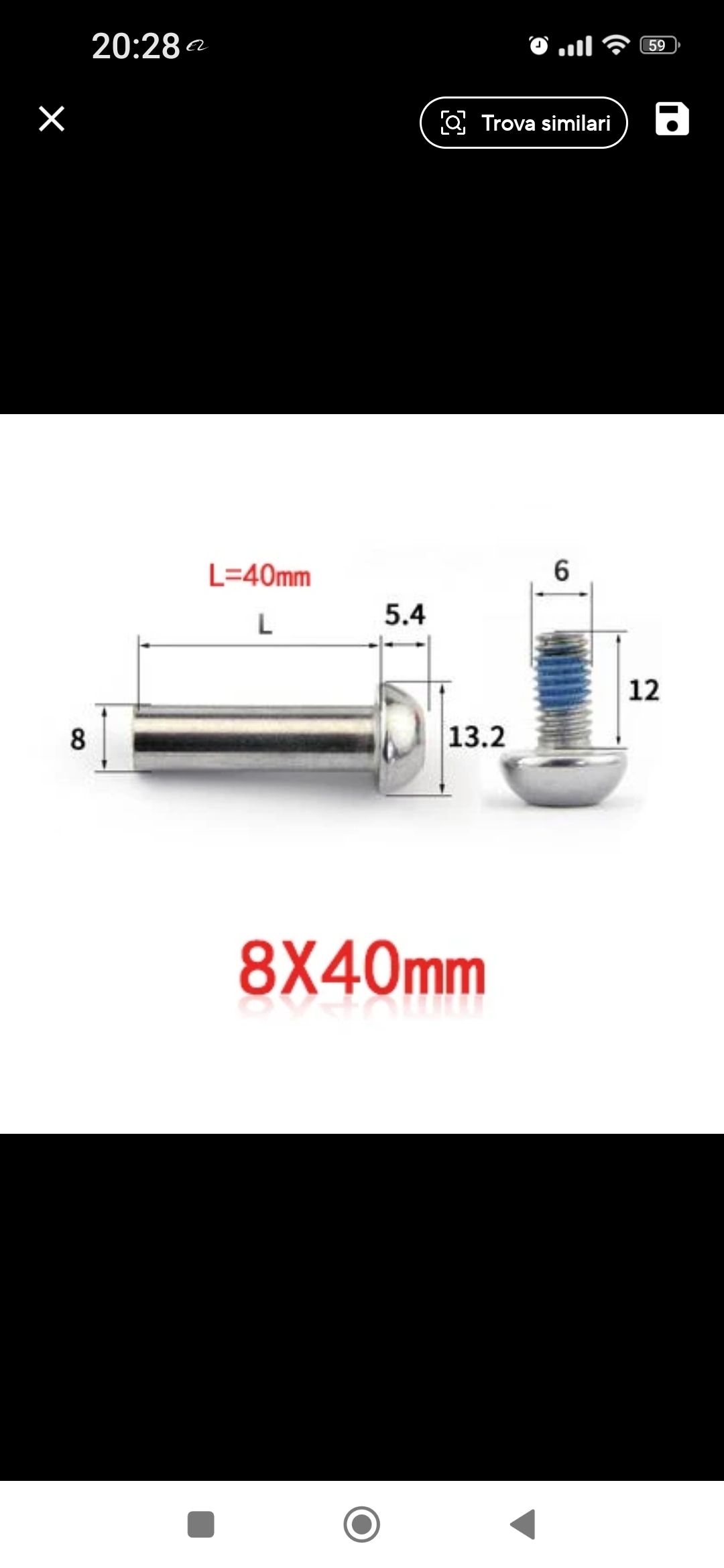

Ger@nio63
Sep 6, 2024
94
56
Italy
ciao ho trovato questo articolo per l'ammortizzatore la differenza è di 1 mm cosa ne pensi può essere compatibile❓
la casa originale misura 39mm

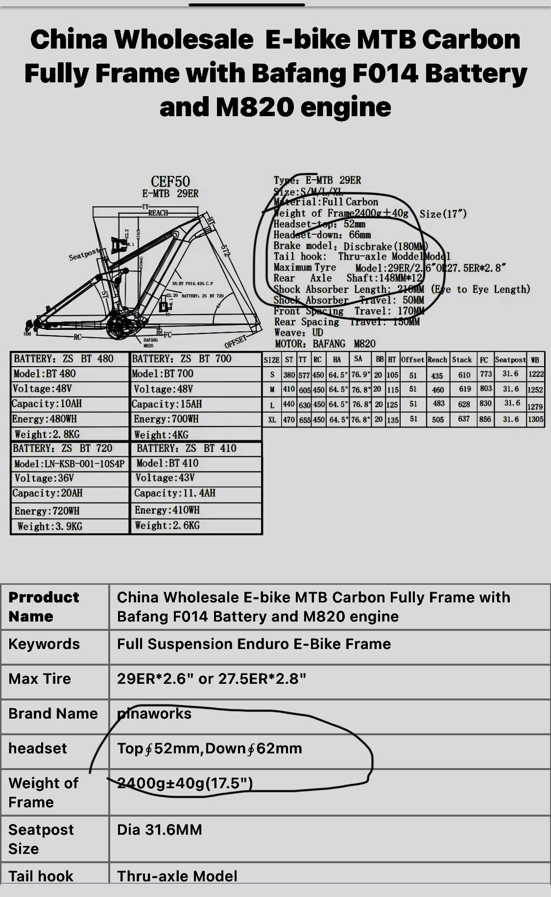

I’m a bit confused about factory data’s and your experience: they do specify numbers from 52 to 62 or 52 to 66. Since I will defo upgrade this critical component, I wanna make sure with you guys what do I need to order prior to receiving the frame!
mike_kelly
Aug 11, 2022
1,008
861
US
The confusion comes from measuring the bearing size or the inside diameter of the headtubes.
The correct size is ZS56/ZS66 using the standard industry nomenclature.
The correct information is in the specifications thread.

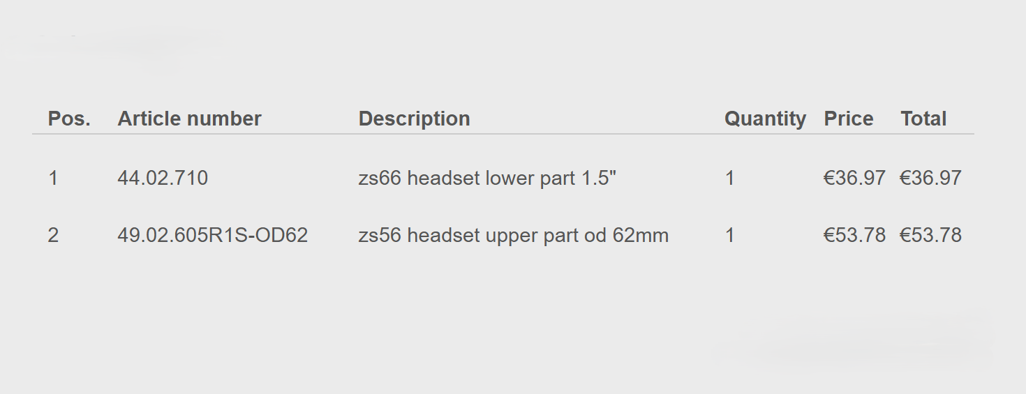

PaulH
Apr 23, 2024
37
30
Dallas, Texas USA
These (both top and bottom) are exactly what I ordered last summer for my CEF50 and they work perfectly though I did gently tap out the stock bottom bearing cup to use the one that came from Acros. The nomenclature is confusing.

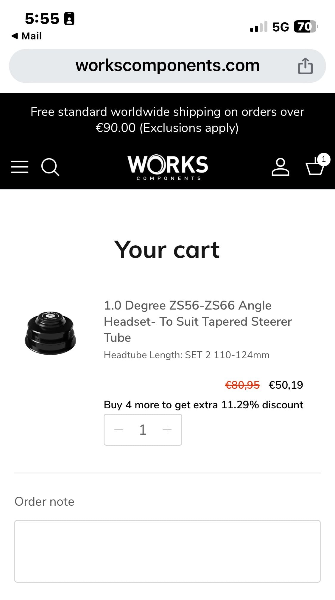

Finally went for the 1* option to slacken things a bit with WorksComponent, I’ve used them on all my previous projects and they are great.
