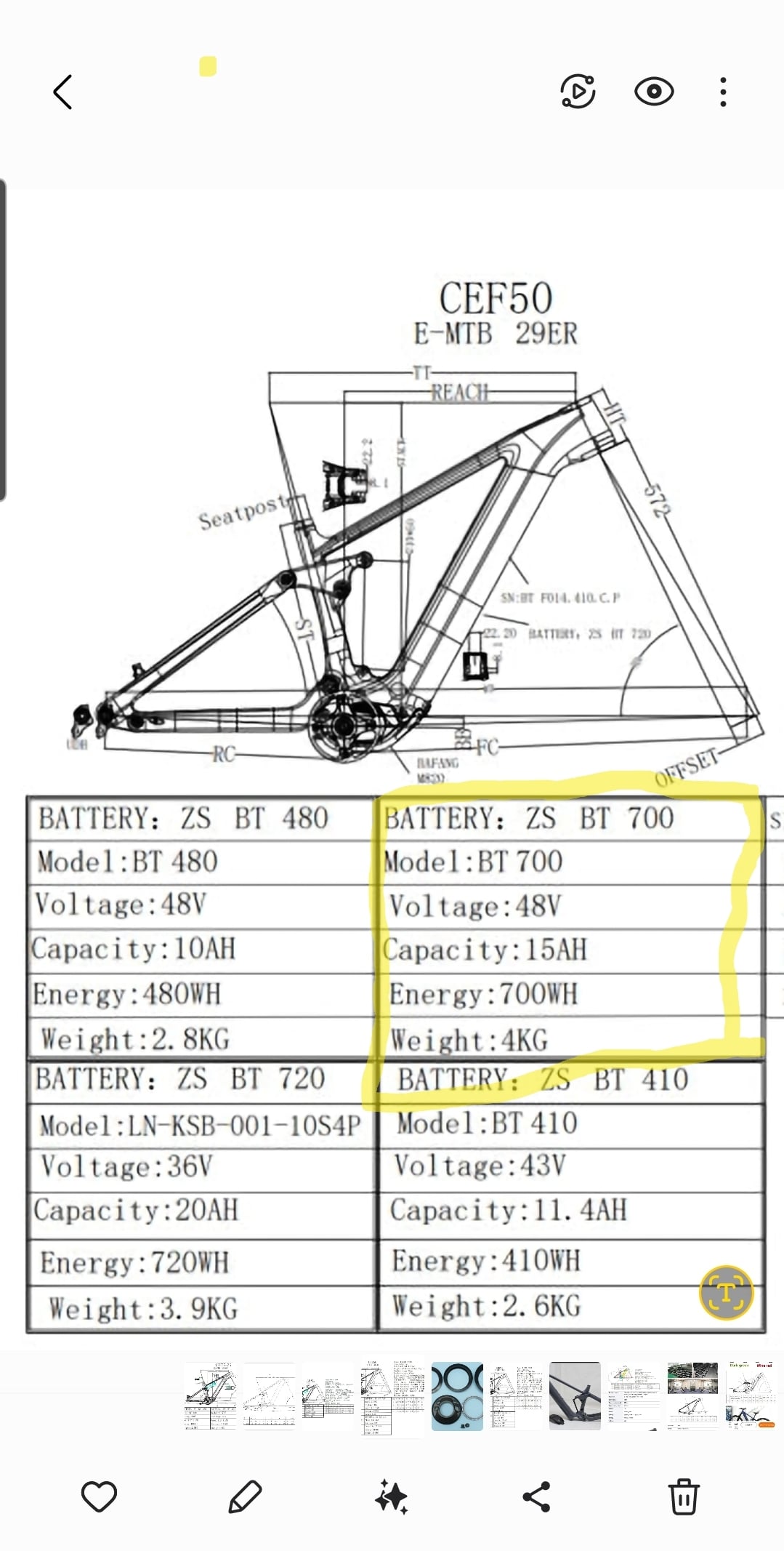

You can not connect an external battery to that port. It is only for charging and can't handle more than 2amps.The battery is 48v and 700wh, I want to put an extender on the bottle holder, has anyone put it there?

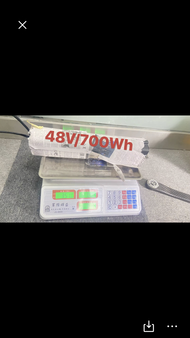

48v 700whBateria de 720 Wh?
Hi, is the 700wh battery the one that comes with the frame? Do you know its weight? Are you getting a lot of autonomy from it?48v 700wh
I have already chosen it, it is 700wh and 48v, everything comes with the frame, I think, battery, motor and frame, it is made of jeanNo battery comes with the frame. You choose which battery you want.
Yes, it is the battery that comes with the 48V 700Wh 4kg frame. Regarding autonomy, it depends on the type of ride. I ride XCM autonomy above 100km with 1500m of elevation, 10% single and 30% off and 70% eco.Hi, is the 700wh battery the one that comes with the frame? Do you know its weight? Are you getting a lot of autonomy from it?

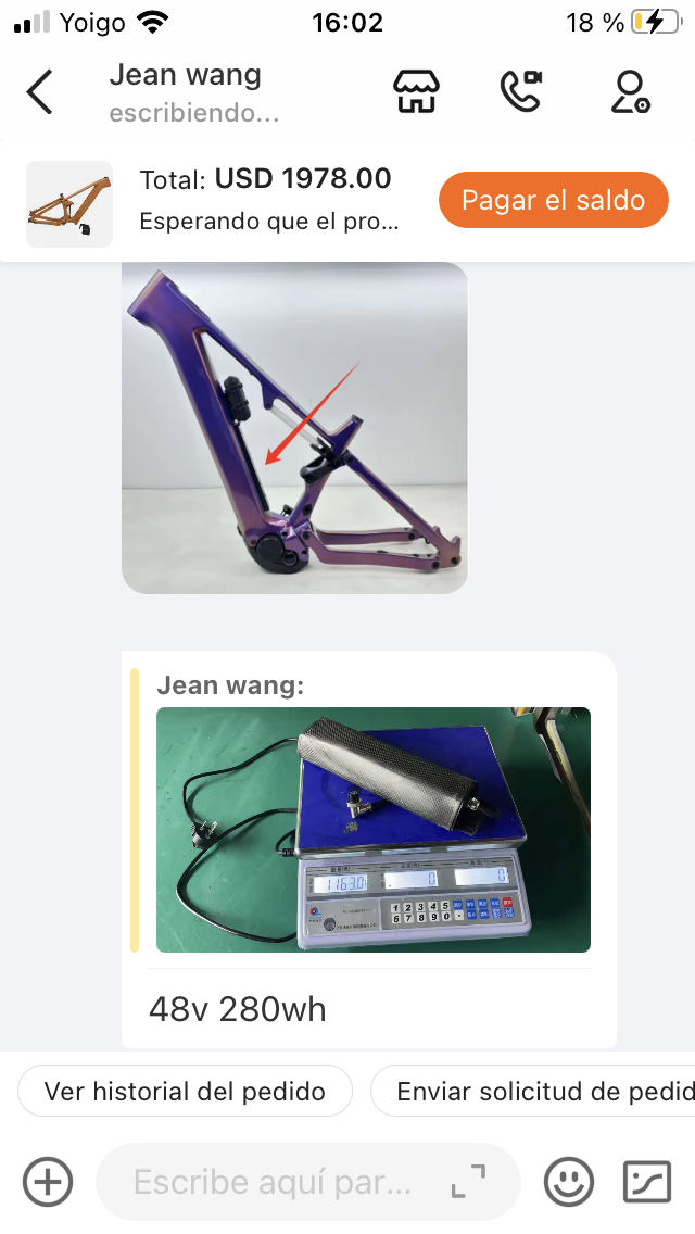

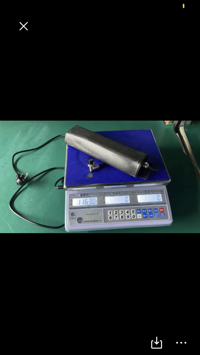

It has a smaller 480wh battery carbon case with 1.95kg.I'm going to try to leave it at 18 kilos![]()
I like it with more battery, I do marathons and long runsIt has a smaller 480wh battery carbon case with 1.95kg.
