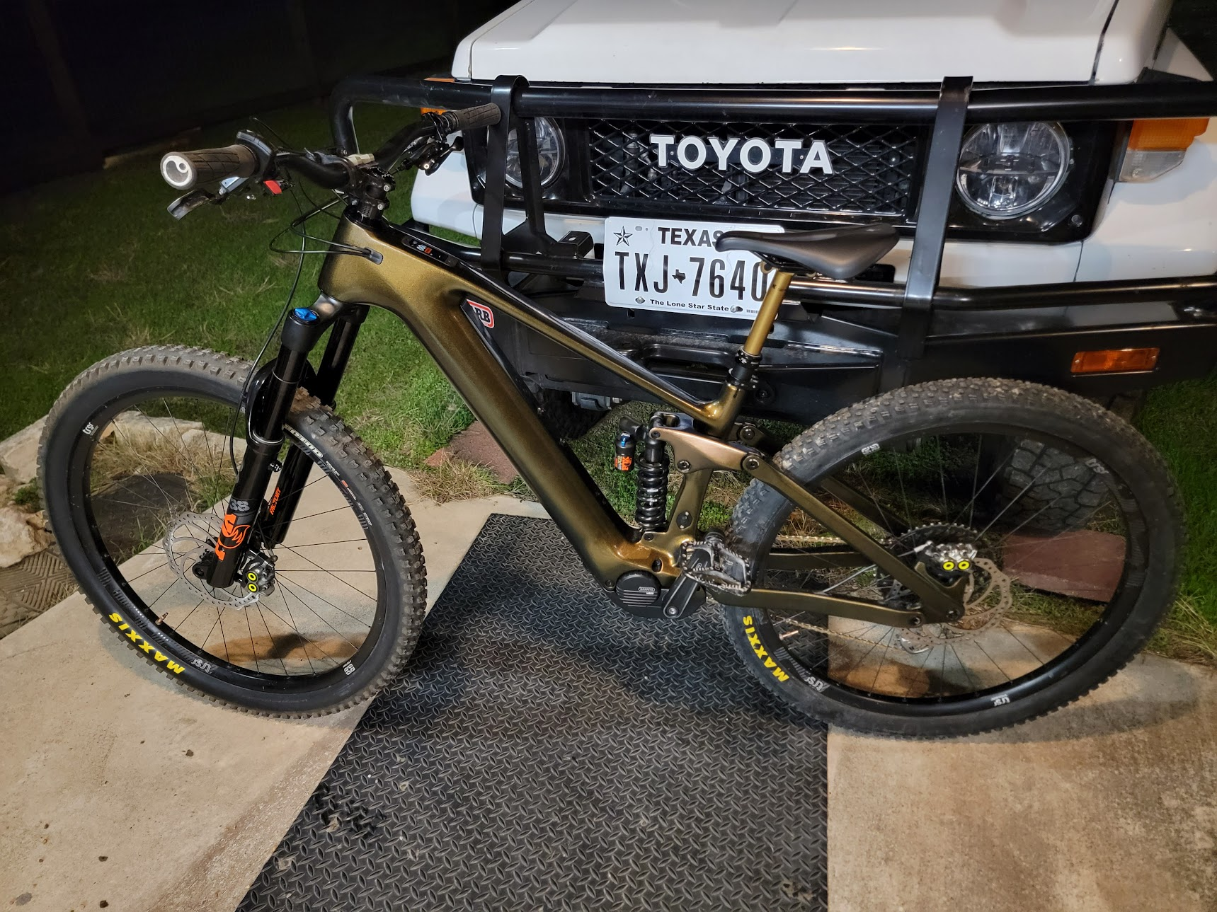

Hi guys

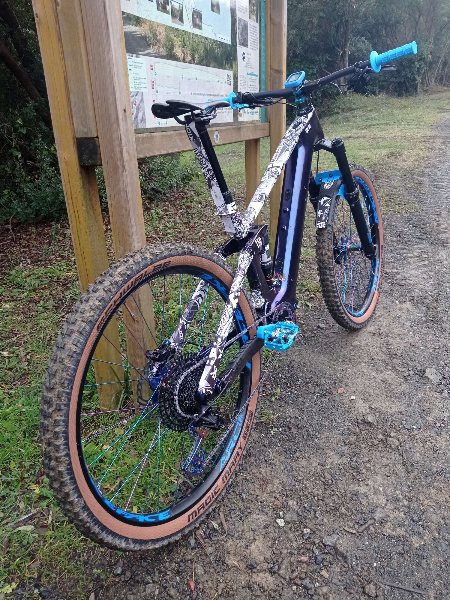

I made some changes to the bike, I mounted a 216x63 shock absorber with a 7mm reducer internally, obtaining a stroke of 56.6x 3=169.8. I traveled 150 km doing various laps on Enduro terrain with various small, non-exaggerated jumps and had no problem 👍😁 of course I tried with a compressed shock absorber and there was about 2mm of free space left in the rocker arm good sensation on descents I like how the whole rear stay works this in format 29 front rear height BB 36.5 angle HT 64.5 ZEB 170 total weight 20.68 see attached photos💥 View attachment 153535 View attachment 153536 View attachment 153537 View attachment 153538
Good weight.👊 Interesting shock reducer mod to get 170 mm rear.👍

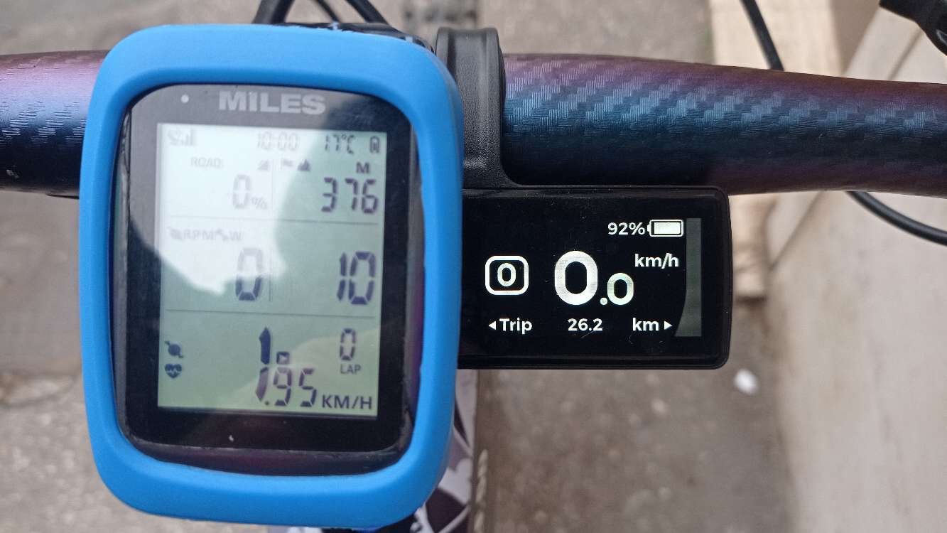

Hi guys
today I did my first bike test ride � premise for me this is my first E-bike I was pleasantly impressed when tackling the climbs I'm used to high pedaling frequencies and I felt good I didn't have any sensation of the wall when I went over the top the 25 km was nice, the frame was smooth too, the geometry and everything else, I had a great time, nice bike, I'm satisfied with the choice I made � I covered 26 km with a difference in altitude of 376 mt absurd consumption only 8% I was amazed well��
View attachment 152097 View attachment 152098 View attachment 152099 View attachment 152100

I took the Medium size I'm 173 tall 720wh battery the firmware is Eroad that's why it consumed little now with Emtb firmware the consumption is different now it pushes well uphill🚴💥

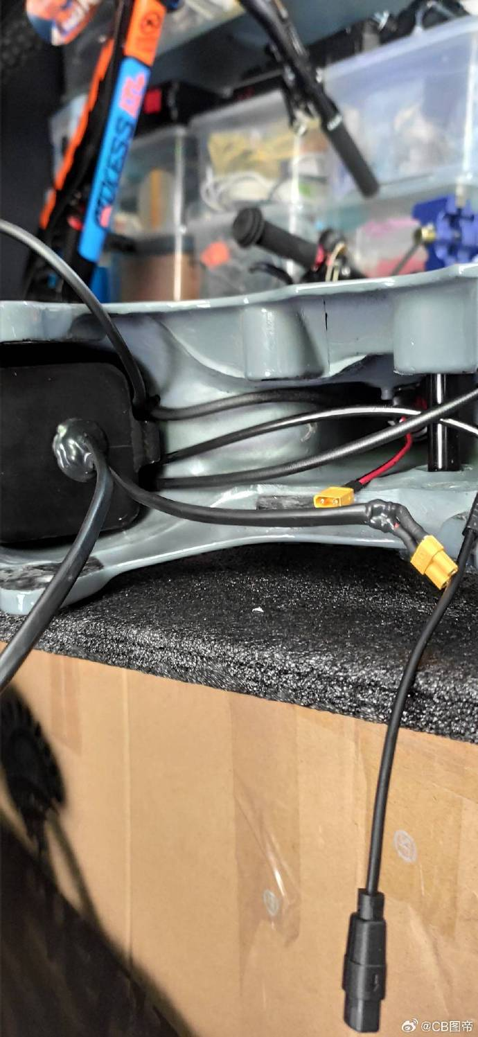

Did anybody have problems with battery? Here are 2 videos showing my problem:
- YouTube
My problem:
Upon receiving the bike, I fully charged the battery to 100%. I then rode approximately 100km. During this time, I experienced frequent power losses from the motor, with the support cutting out intermittently. After depleting the battery to 20%, I recharged it.
Today, I went for another ride. The motor again experienced intermittent power loss. After a few kilometers, the battery level dropped to 83%, and then the motor completely lost power, with the battery level showing 0%. I had to stop and turn off the motor. When I turned it back on, the battery showed over 90%, but I could only travel about 100 meters before the motor lost power again, and the battery dropped to 0%.

Are you using the stock 720Wh battery that comes from SZZS?

That sucks hopefully something simple and not a nightmare like a bad battery cell. 😜
Maybe first recheck all your connections that cables and wiring aren't loose leading to intermittent discharging? That will probably mean pulling down the motor and removing the battery to even diagnose it more effectively.
And then video all that as well in order to document and send to SZZS with the intent that you might have to eventually make a warranty claim on the battery. Fortunately, if so, they "should" have them in stock in order to swap it out asap. The sooner the better to alert them of the problem, so they know your bike is brand new and outta the box.
Unless someone else has a better idea on trouble-shooting a new battery?

Hello, I had a similar problem and sometimes when I turned it on it gave error 30. The solution was simple and laborious because I had to disassemble the motor, I disconnected the cables and sprayed contact cleaner, waited for it to dry well, reconnected it and had no more problems.
