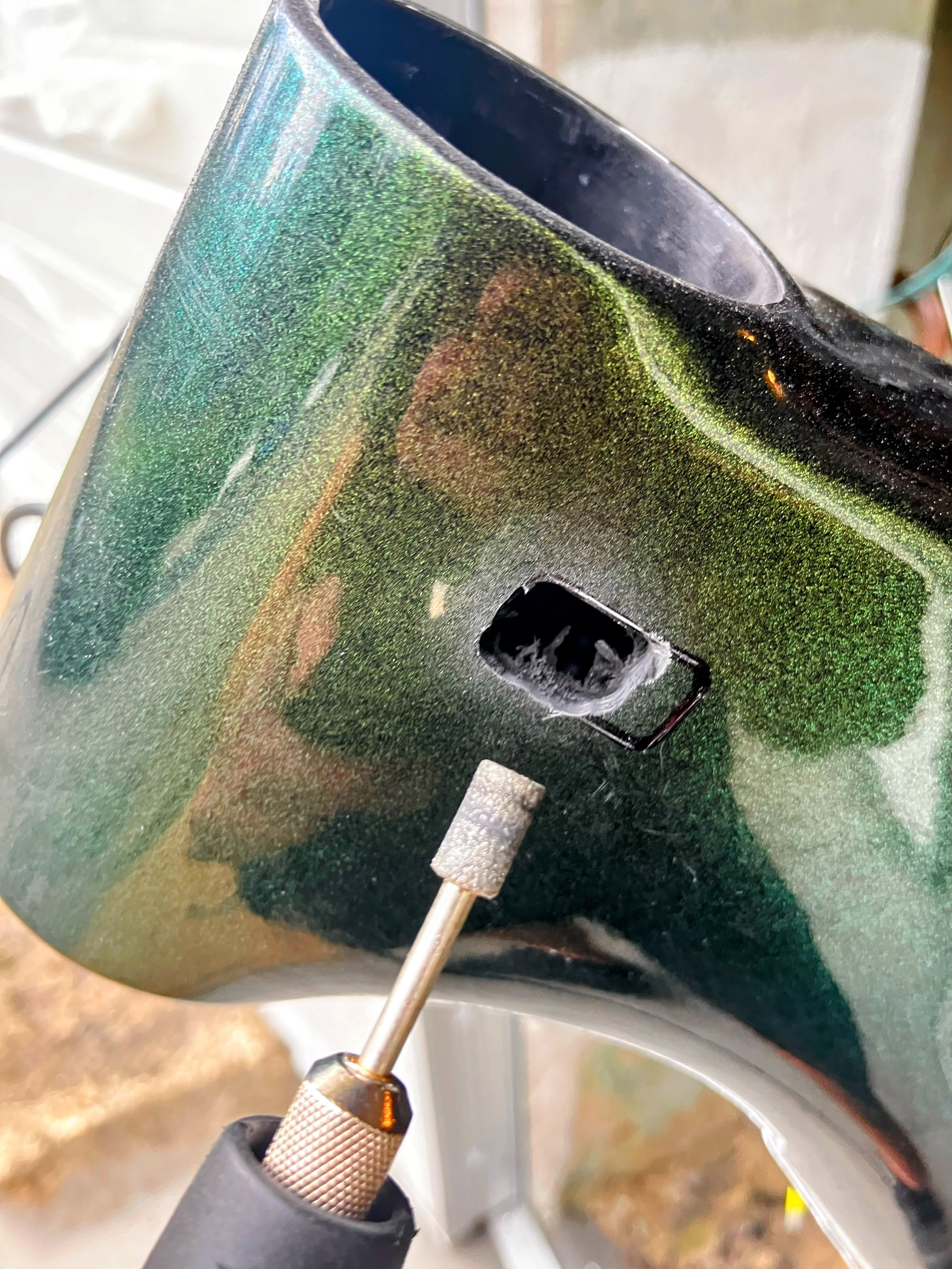

Non-ICR headset, internal frame cable guide conversion for the SZZS-specific CEF50
TCFlowClyde
Feb 26, 2022
1,371
895
Mesa, AZ
Acros now has the ZS66/40 lower bearing set in stock (they were out for a while) and ready for order so I was going to order that from Germany for the CEF50 but now they also have the non-IRC headset also available (ZS56/28.6) but has two options in a drop-down box when ordering (OD 63mm or OD 62mm). No other upper headset has this option that I have seen.
Which of the two would be correct the CEF 50 the 63 or 62mm OD? I was planning on getting the Hope for the upper but just ordering the one lower bearing from Acros the shipping cost is a lot but the same to get the upper a long with it. I acknowledge the Hope has greater bling factor but Acros is German. Plus it just feels better to get both from the same manufacturer for some reason and be done with it.
Thoughts?
Yeah, I've never seen the 63/62 mm option. And since my top cup is installed I can't easily measure headtube OD.
4 possibilities.
1. Ask SZZS the headtub ODs. (Might take a while).
2. Buy both 63 and 62 mm (more costly for return shipping so probably eat the cost or eBay it.)
3. Order the Hope in black to match.
4. Or maybe go to Hope Tech website and download the headset specs to compare OD fitment. Whatever Hope specs are they'll tell you if 63 or 62 fits.

Great tips! And just as a follow-up the CEF50 head tube upper OD is 62mm. The option from Acros for 63mm apparently is to account for wear in some frames.

I'm planning to perform non-ICR conversion this weekend. My biggest worry is that the bearing cups of my new headset (upper nukeproof, lower acros) will come loose just like the current SZZT's cups which were factory glued in. Did you encounter this problem, should I be prepared to glue them with Loctite 603 just like SZZT did?
TCFlowClyde
Feb 26, 2022
1,371
895
Mesa, AZ
I didn't encounter any issues...the upper cup bearing assembly was a snug fit for my Hope ZS56 bearing/cup assembly. I tapped it with a 2x4 pine wood block. My frame should be from the same mould but never was headset pre-glued as an early first batch customer. So, hoping specs will be equivalent for subsequent batches.🤞
Worst case...glue it if you have to and then request a warranty replacement frame that is not pre-glued? It still should be under the SZZS one year warranty. 💸

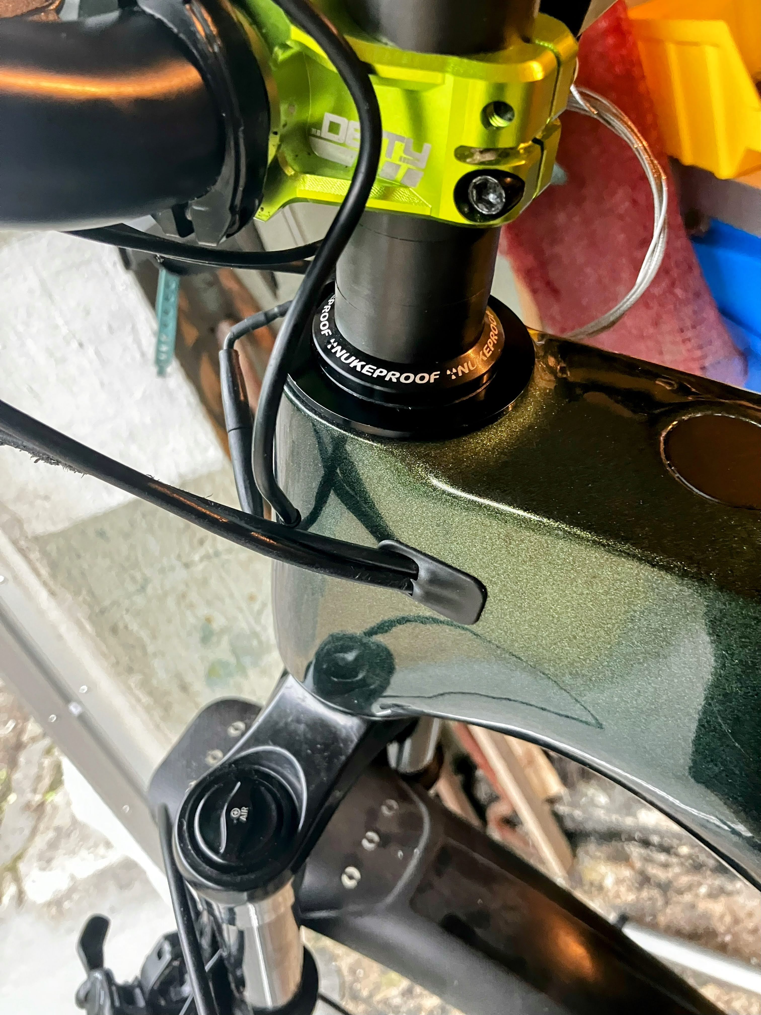

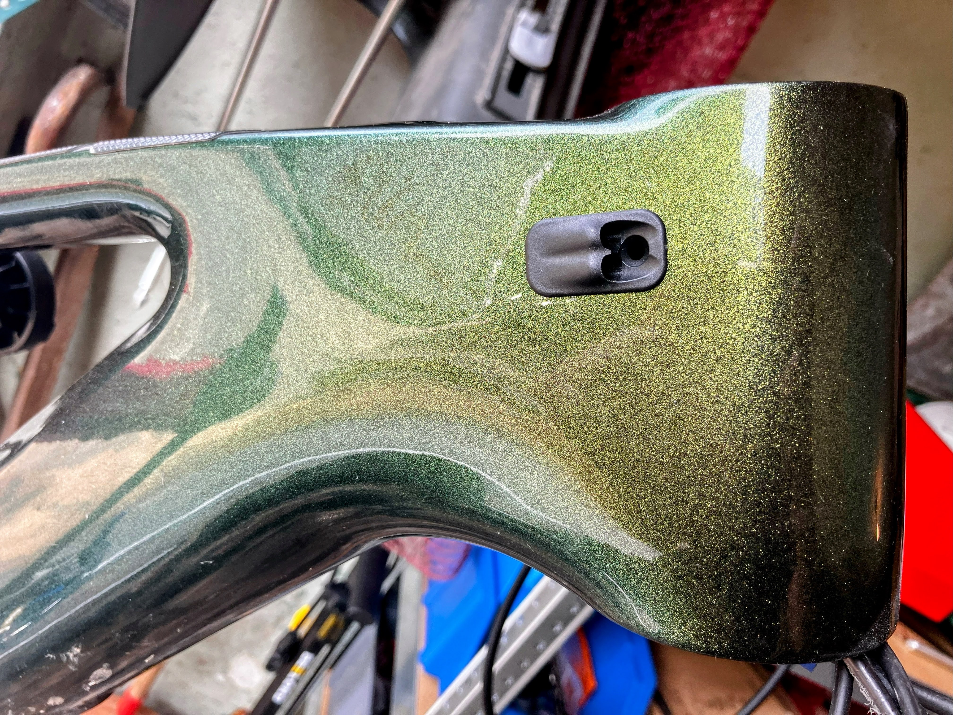

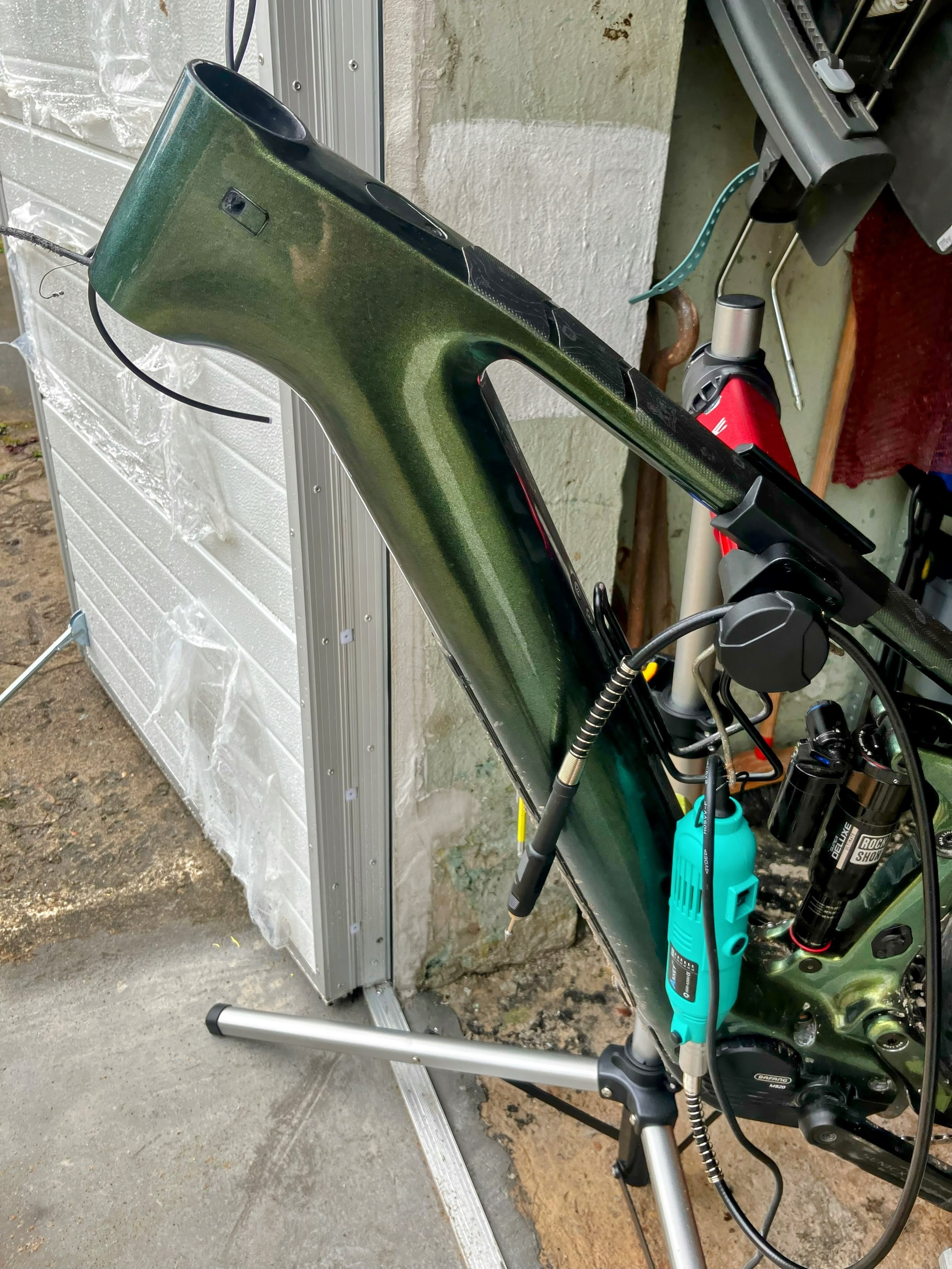

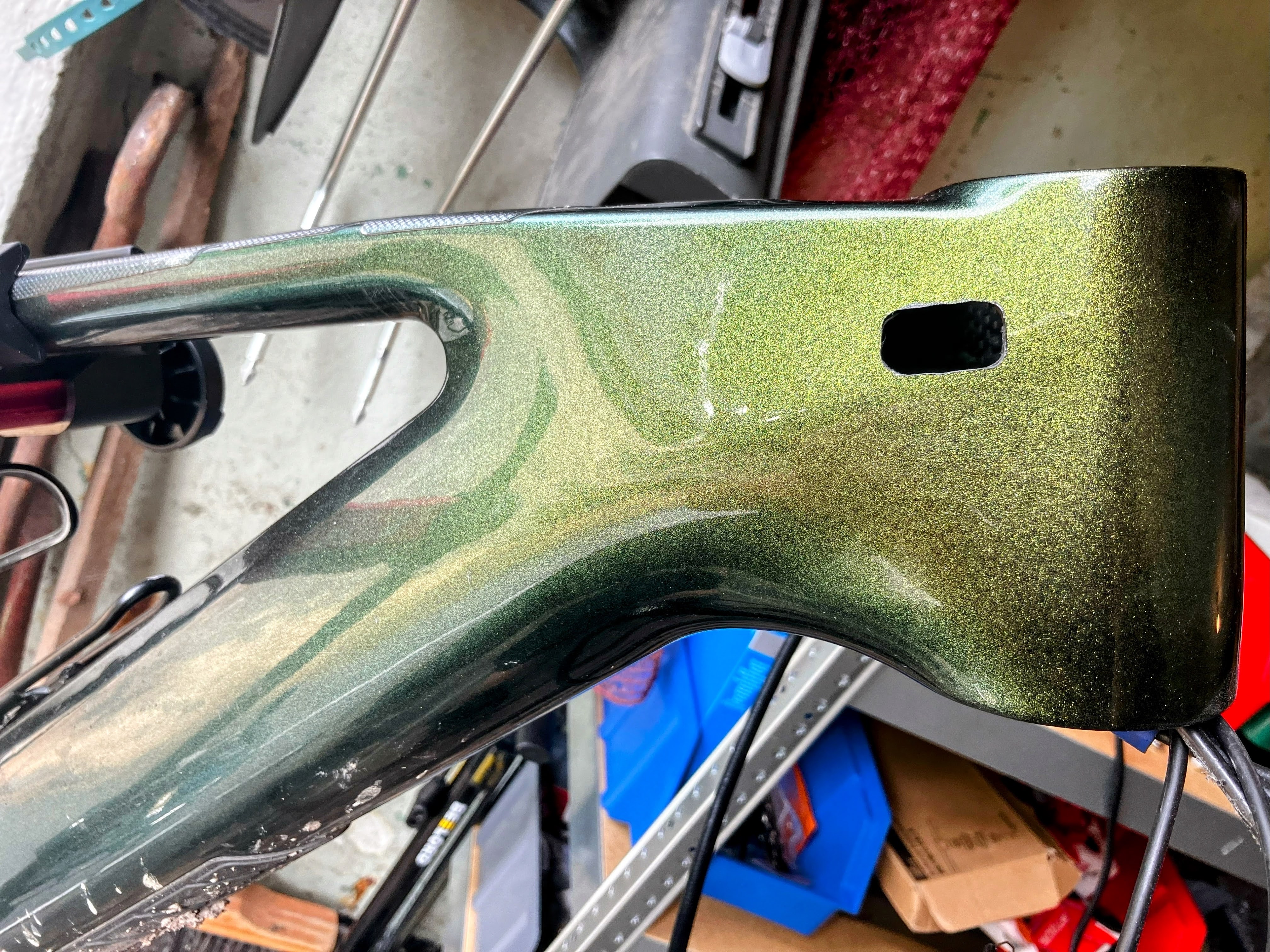

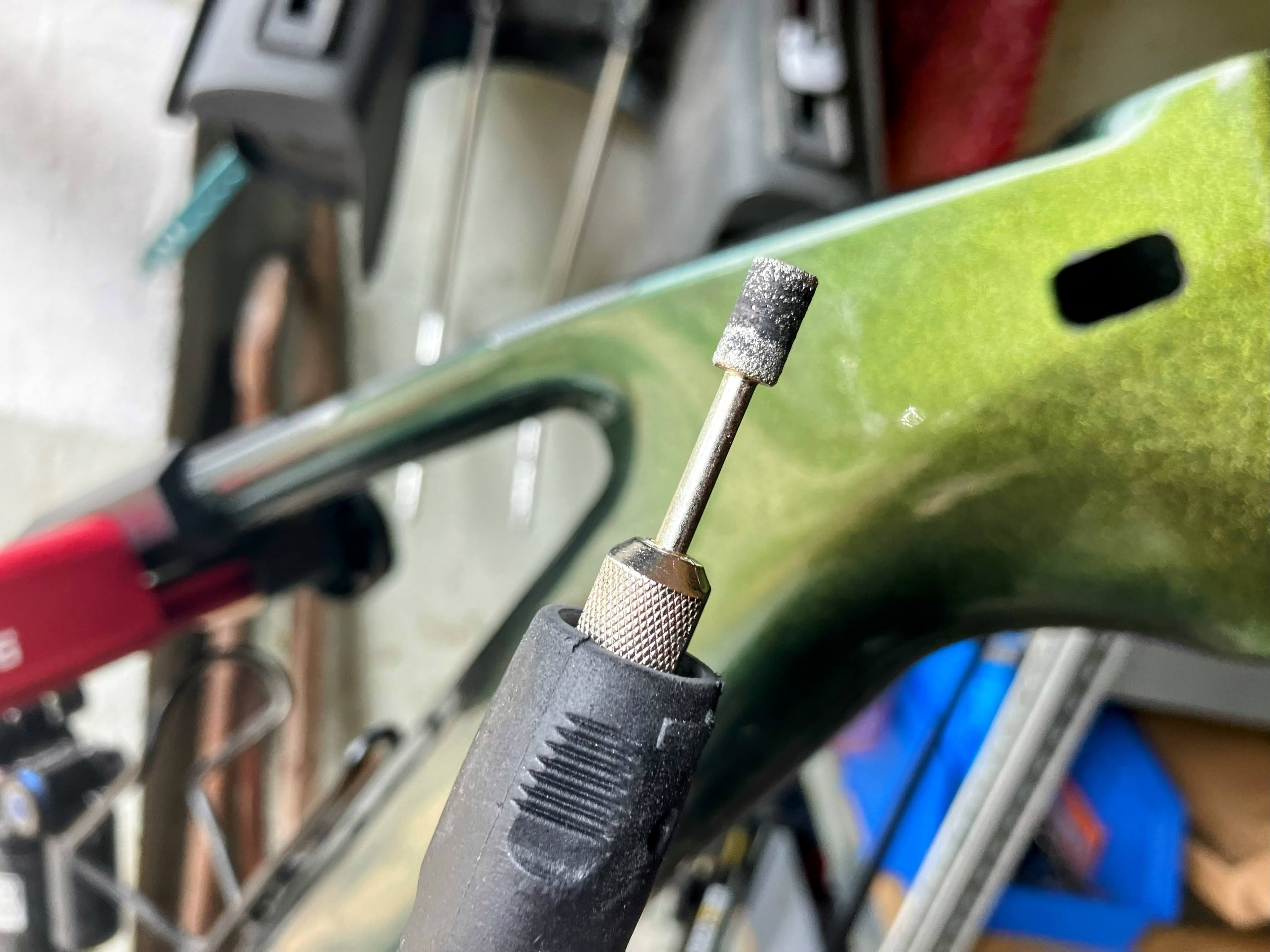

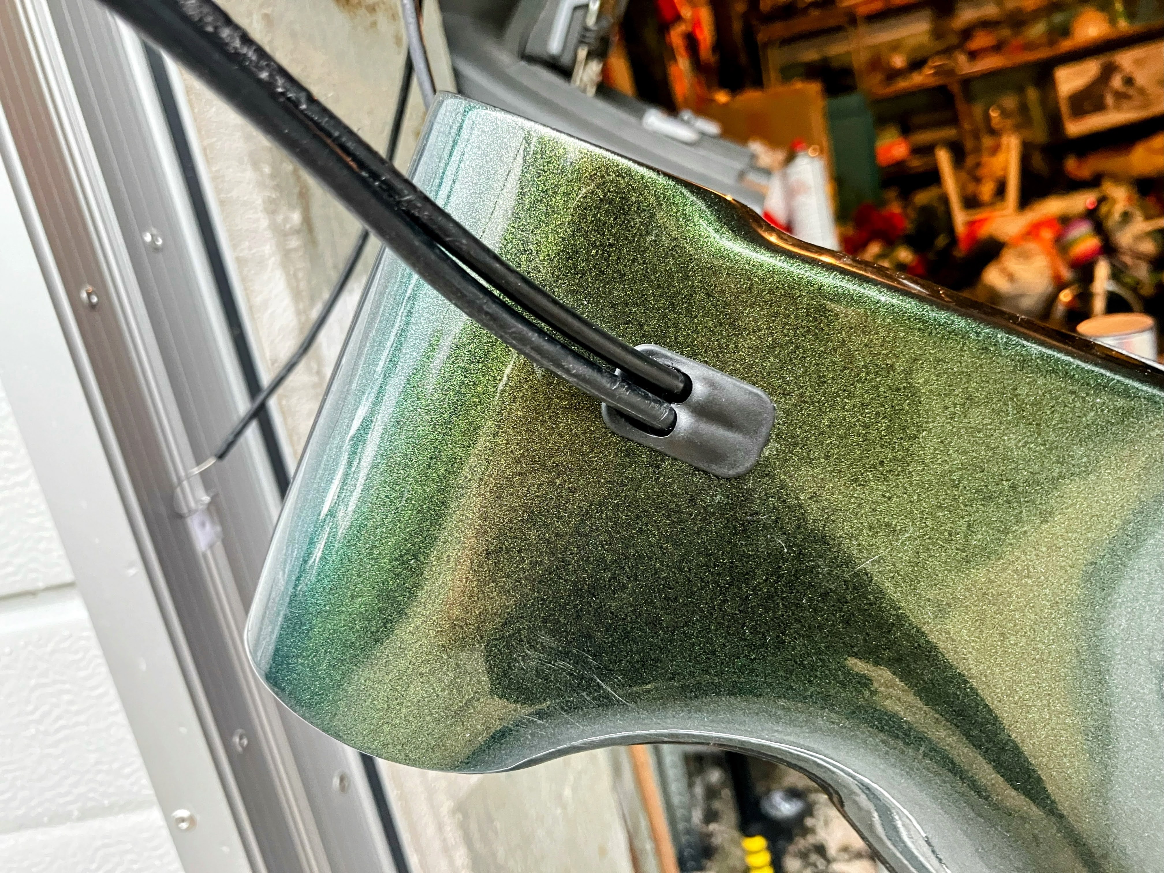

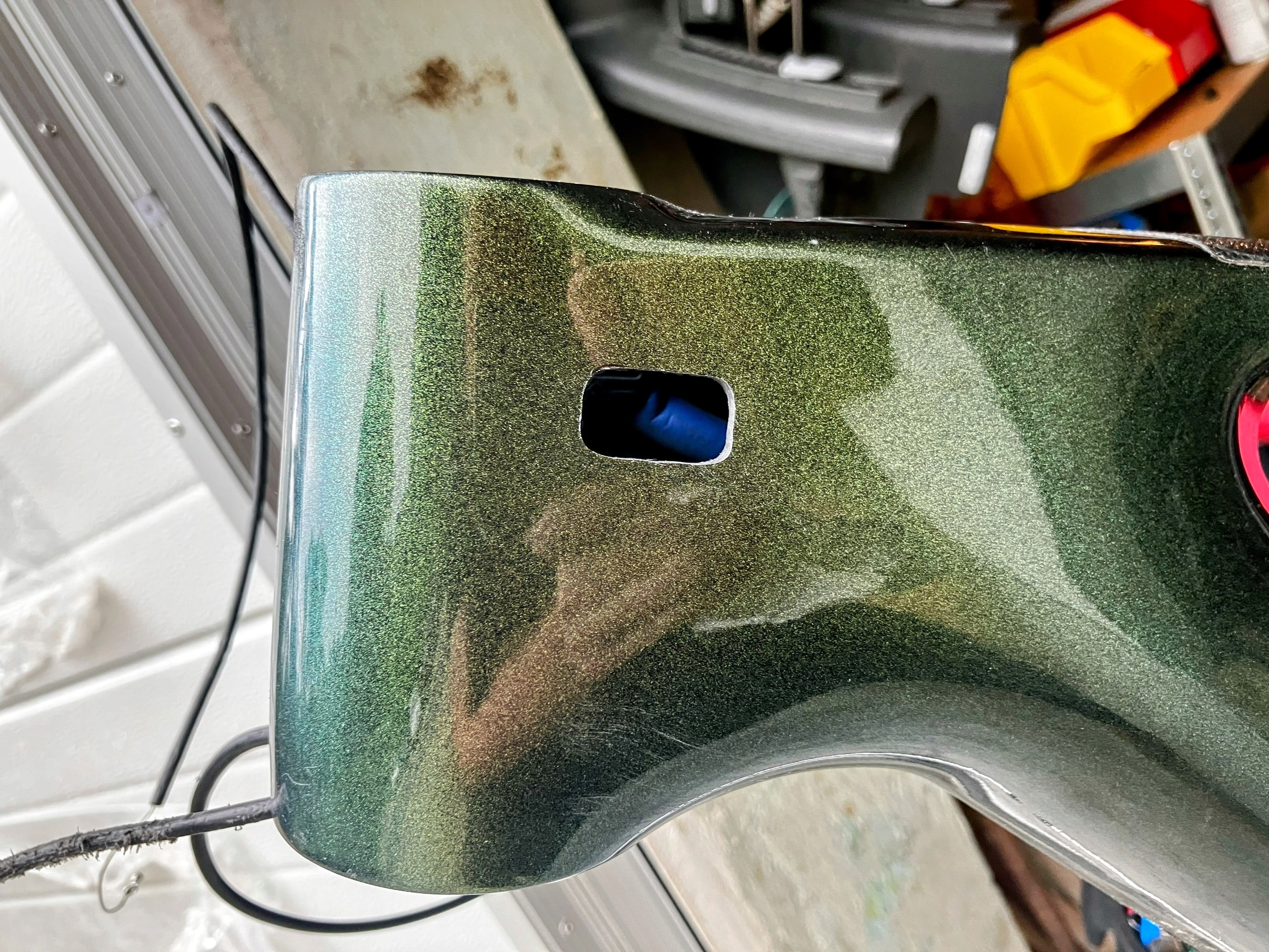

the good
  • carving holes in the frame went without issues
  • existing cable housings are long enough so that I don't have to replace them
  • so far no creaking or knocking on impact, even though I replaced only the upper headset assembly with Nukeproof
the bad
  • my worries about loose cups were valid, I can easily press and remove the new cups with my bare hands - I've ordered Loctite 603 to glue them in, also I'm thinking about some other ways to ensure tight fit - a piece of foil wrapped around the cup?
the ugly
  • I could not press the Acros crown race onto the steering tube, this definitely requires special tool like a piece of pipe; so far I've left the lower ZSST headset in place. I will install Acros later. Anyway, lower part of ZSST headset wasn't problematic, I just don't have much trust in its quality.

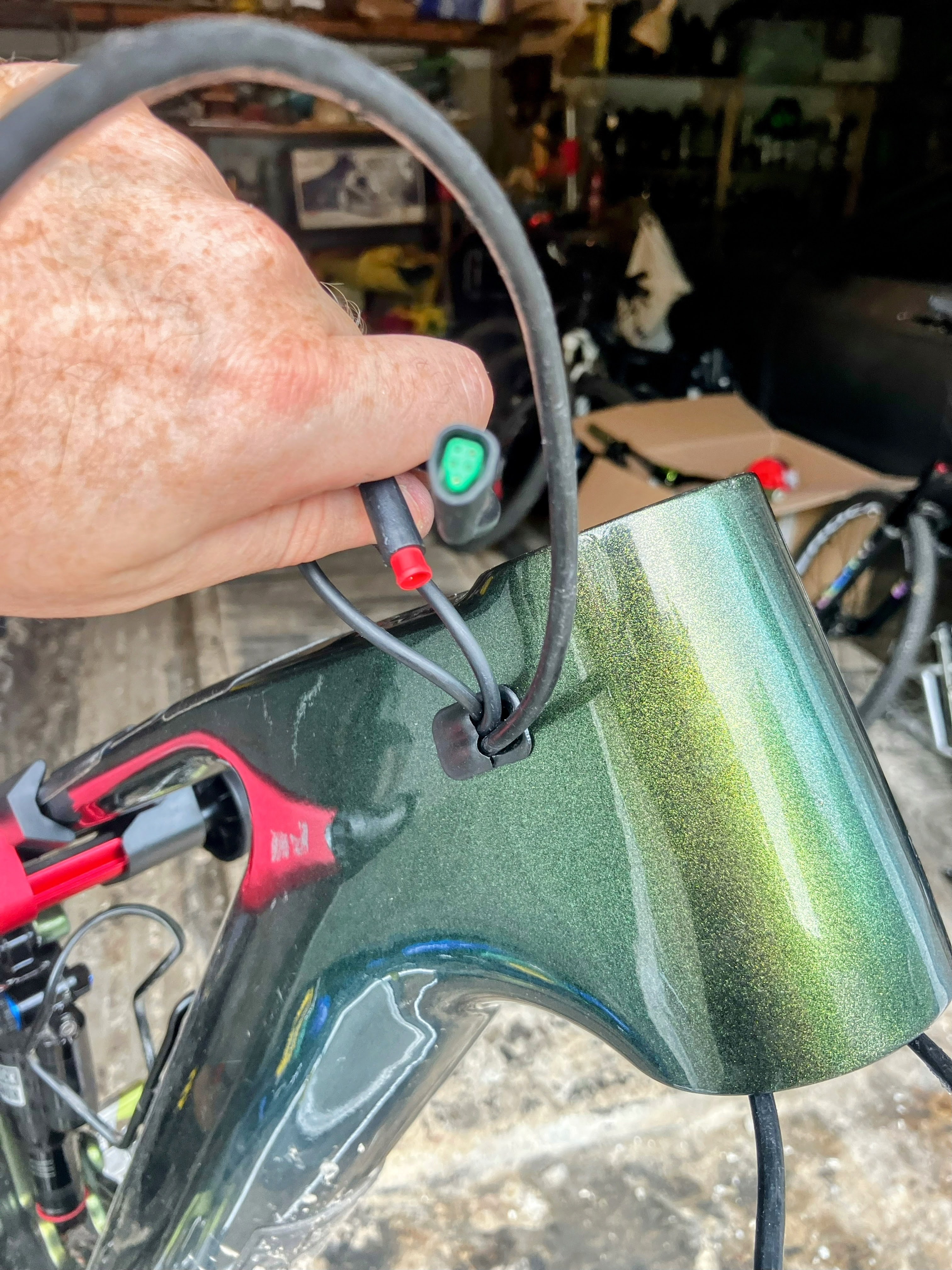

tip: I was able to squeeze the display cable through the cable guide hole without cutting guide side after grinding the hole a bit wider with 6mm burr. this way the guide cover will not flex under dropper cable pressure when turning handlebar to the right

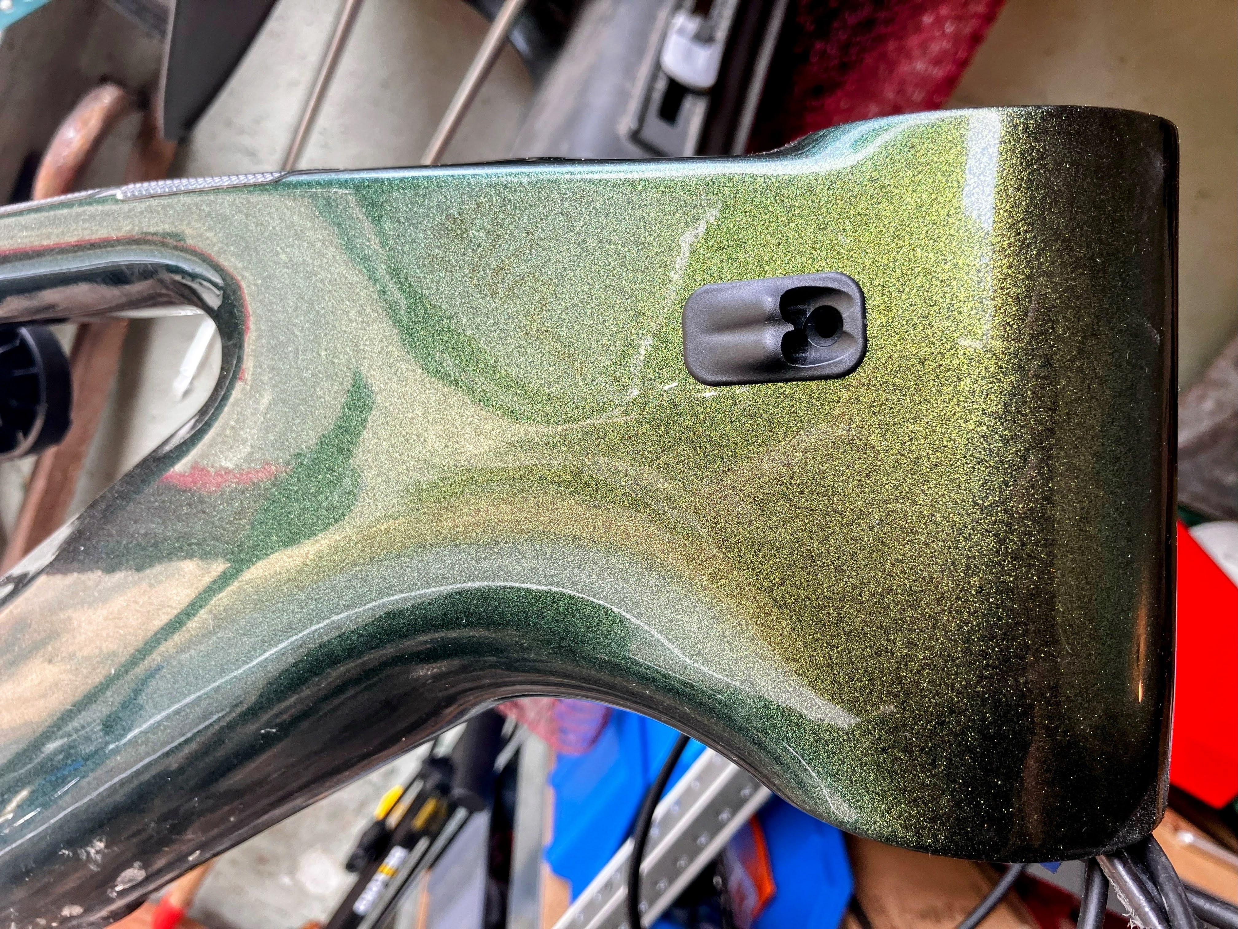

So eventually I finished my conversion by gluing both top and bottom assemblies into the headtube with Loctite 638. I couldn't find lots of resources covering use of cyanoacrylates with carbon fiber, except for one article by one Hambini, where he claims that glueing the bearing cups is now widely practiced in the bike industry as it allows for lower manufacturing tolerances and increase servicability (Engineering Analysis: Grease or Retaining Compound - Hambini Engineering). I'm not entirely convinced in the guy's expertise but at least he's giving some clues that this idea isn't entirely flawed.
So far, after 3 days of curing of glue it seems this worked well. I don't have to preload the ahead screw a lot, it's enough to stop at first resistance like with ordinary quality headset. Obviously, bottom Acros headset assembly no longer falls out, they just feel like they were properly pressed in.
The bike handling feels good, there is no vibration transferred from the ground on the bar, all moves quietly, smoothly and without much resistance. Finally, this is the feeling I would expect to have from day 0. Hopefully it will last...
