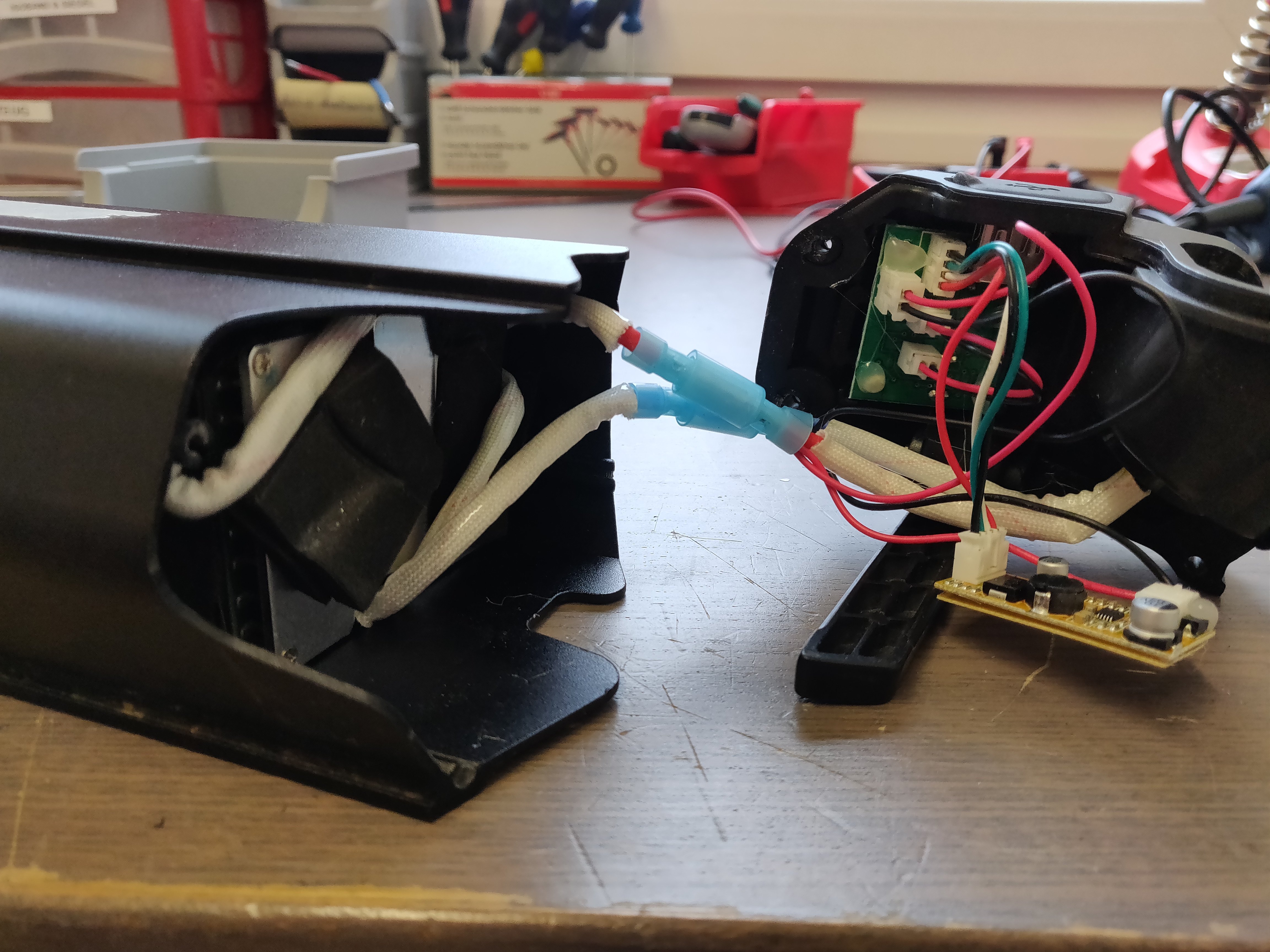

I used a pre-made bottle battery from Aliexpress. Good quality battery with it's own BMS inside so nothing to do. But to use ANY external you have to have a connector on the frame to get the power inside. That is decidedly DIY. It is not hard if you can use a soldering iron. The connector I found is not pretty and it is big but it works well, is water proof and I have been using the bottle batteries for months because my inside batteries were damaged in shipment originally. I would not like to use my bike now without the bottle battery as a range extender option.
With both batteries you need a diode to prevent the external battery from affecting the internal and vice-versa.
I won't create a step by step because dealing with large capacity LIthium batteries like these should not be attempted if you don't have experience. There is no way to "turn off the battery" when you are making one or hacking on up. So one short circuit and you could have a fire. It is not a big deal if you have done electrical/electronic work and used a soldering iron to wire connectors before but I don't want to be responsible for someone burning down their house.
Here again is my over view. Just get a local friend who has experience to help.
My connector fits right in the hole where the old connector went to ovoid drilling out the frame.

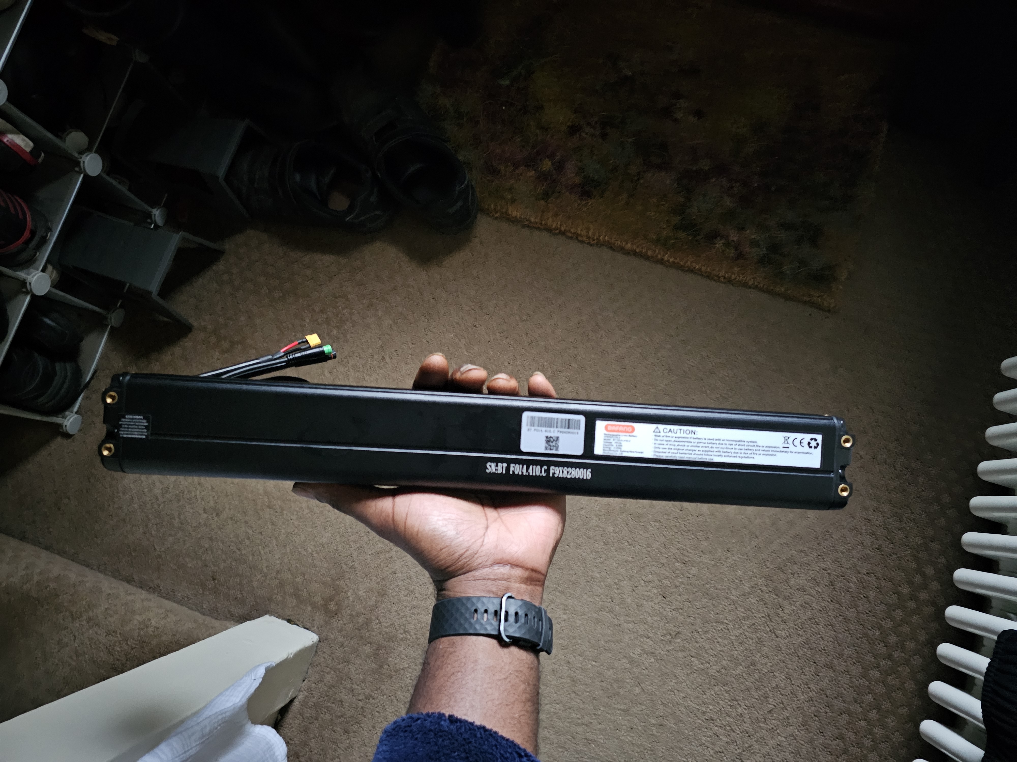

I've given this some thought.
The issues which I fave is that more and more ebike riders are expressing concern for ebike battery fires.
Even I've had to take this onboard in terms of addressing the safety aspect. Which is why I opted to implement the entire Bafang M820 system. As apose to using the motor and a third party battery.
Then theirs the frame and how one could neatly implement a range extender without having cables protruding, without looking out of place (not looking like a DIY job).

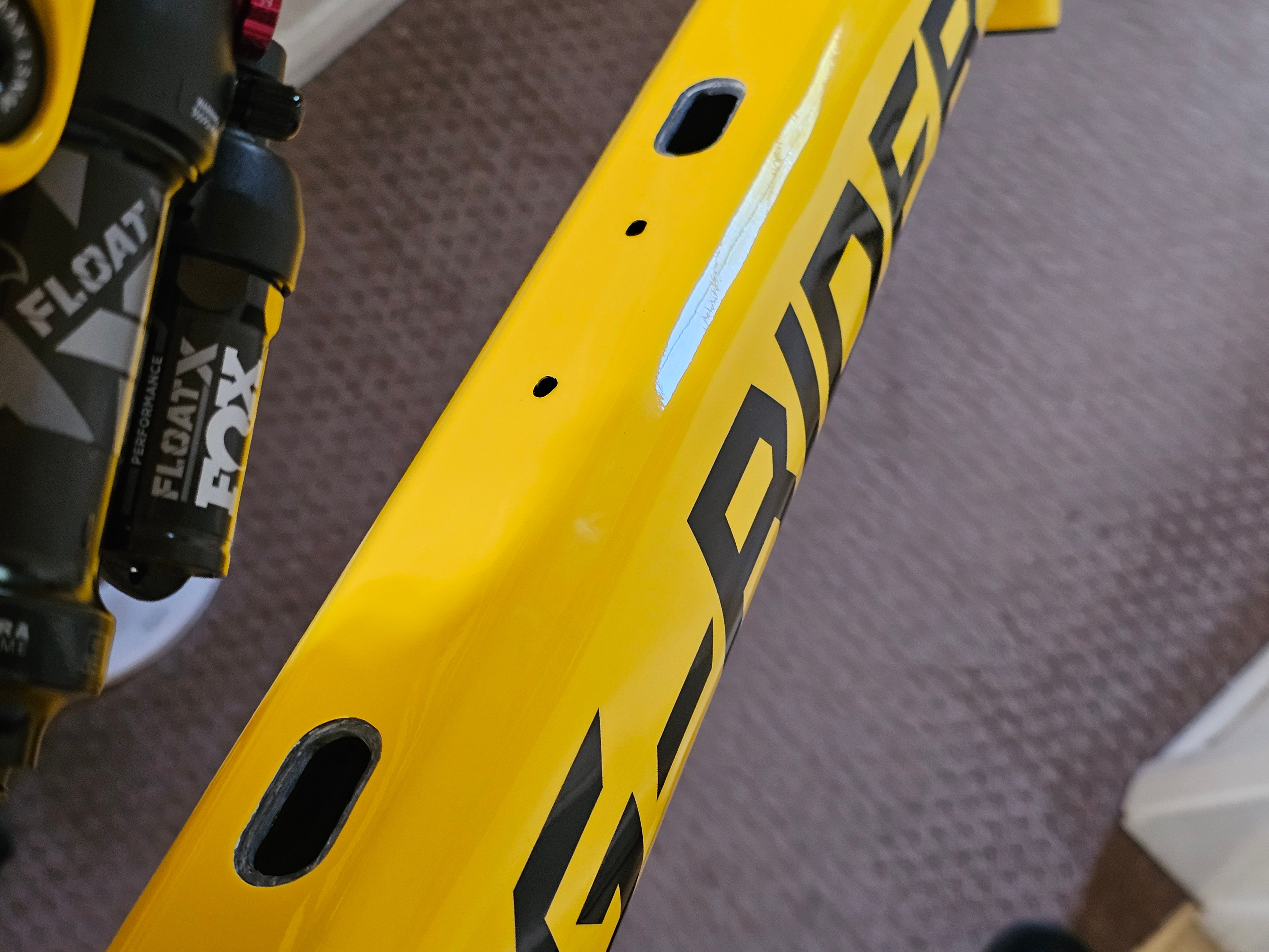

The holes on the to side of the downtube are designed to hold the battery mount in place (as well as the attachment point for the bottle cage).
So the only logical point would be to use the charge port (again, for a neat non-diy looking purpose built range extender).
Which leaves me contemplating the following:-
1. Should Bafang impliment an official range extender battery which coincides with their plug-n-play ethos (which would include a new firmware update to allow the system to recognise more than one battery being used), Shenzhen Zhaosheng would probably make a revised version of the CEF50 or possibly design a new frame to better facilitate the new range extender. Or,
2. If Bafang opts not to implement a range extender, then a third party company (by default) would need to build a range extender of a higher voltage than the main battery. However, it wouldn't work like a typical range extender. Moreso, it would work like a portable battery charger which would fuel the main battery. But the issue for designing such a range extender battery would mean that discharge rate 'could' exceed the recharge rate. Which would then lead to overheating. And then theirs,
3. Safety. Bafang have made it clear that the choice of using 2amp chargers for their batteries (36v and 43v) was intentional, in an effort to maximise battery lifespan and reduce any malfunctions throughout the charging process. Coupled with the fact that the M820 uses a xt30 connector (to reduce the amps its able to pull from the motor. Any range extender designed would need a bms to 'STRICTLY' administer current at specific times, in an effort to not put unnecessary load on either the main battery, existing wire harness and the controller for the M820 motor.
Don't get me wrong, I think about this often. Which is why I'll keep my ears to the ground and report anything and everything I learn.
But as for simply retrofitting a random bottle battery to the battery (or retrofitting a xt30 splitter to the main wire harness and running a bottle battery separately), I think we can all do better imo.
We've all come along way from diy ebikes of old, where random wires and cables would protrude from frames (looking like a bodge). Personally, I don't want to spoil the look of my CEF50 with random cables.
Unless a range extender can be implement and its a clean and safe integration, then I'm not interested in ruining the look of my own.
Sorry if that's not what you wanted to hear @TCFlowClyde 👍🏿

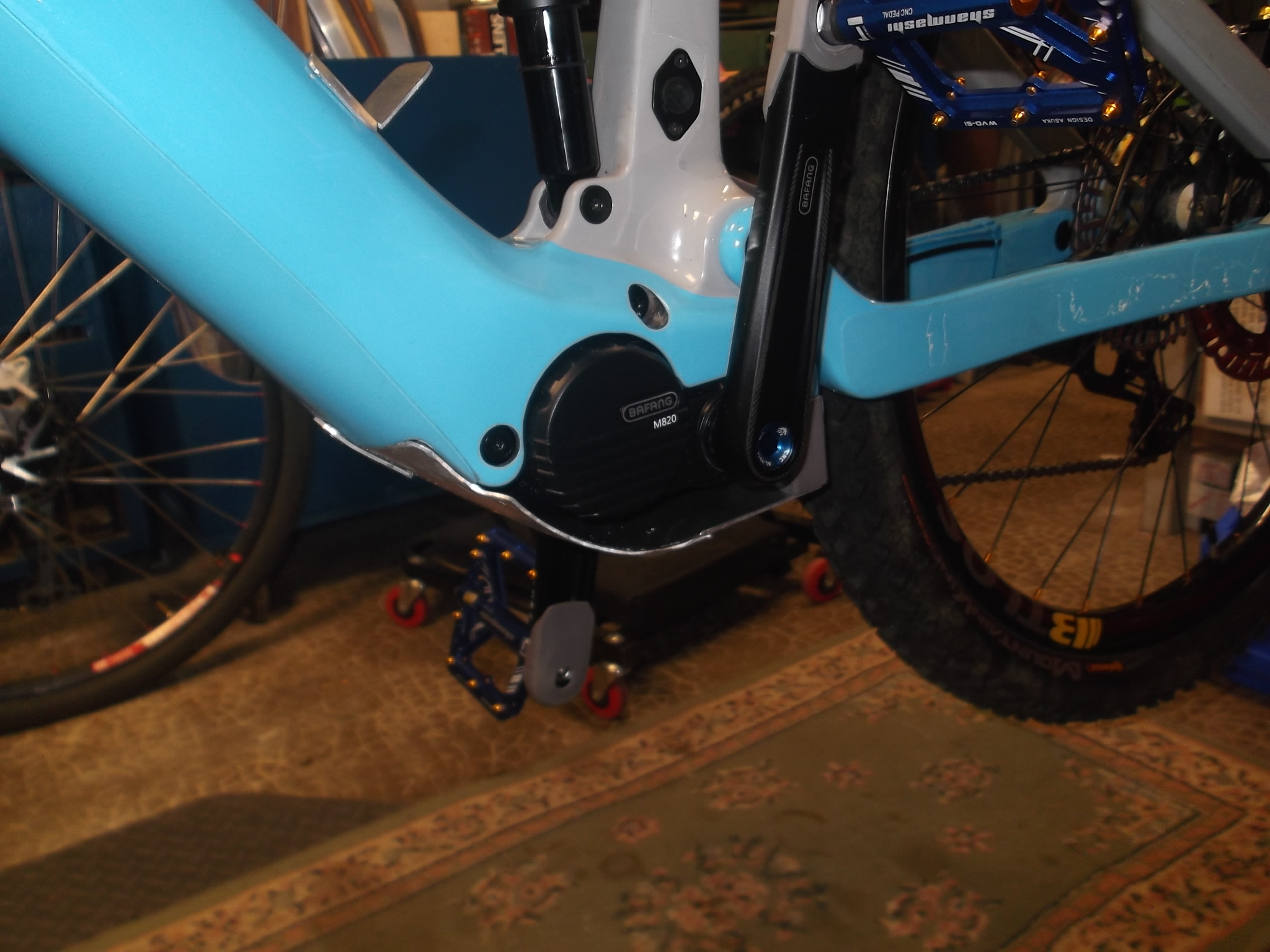

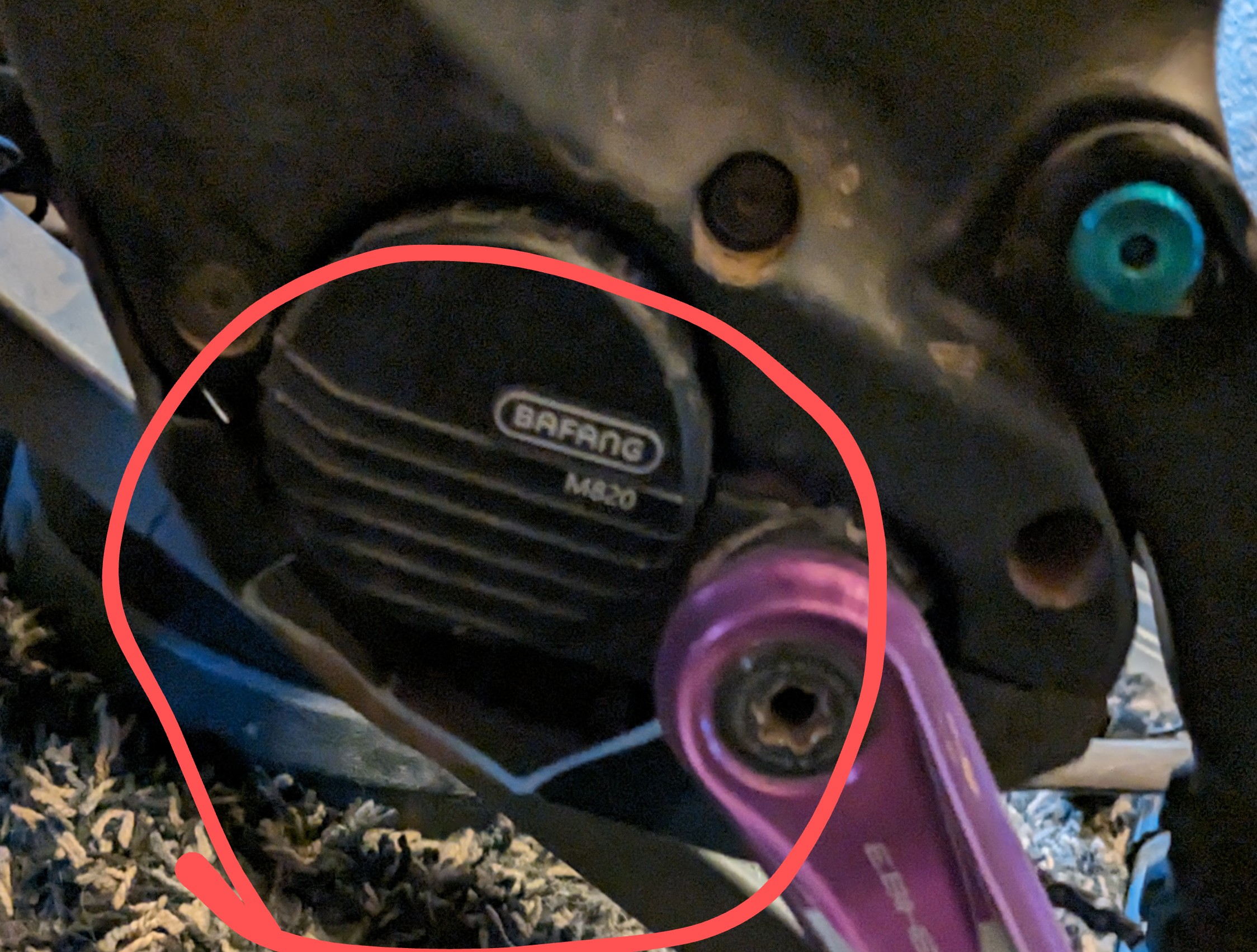

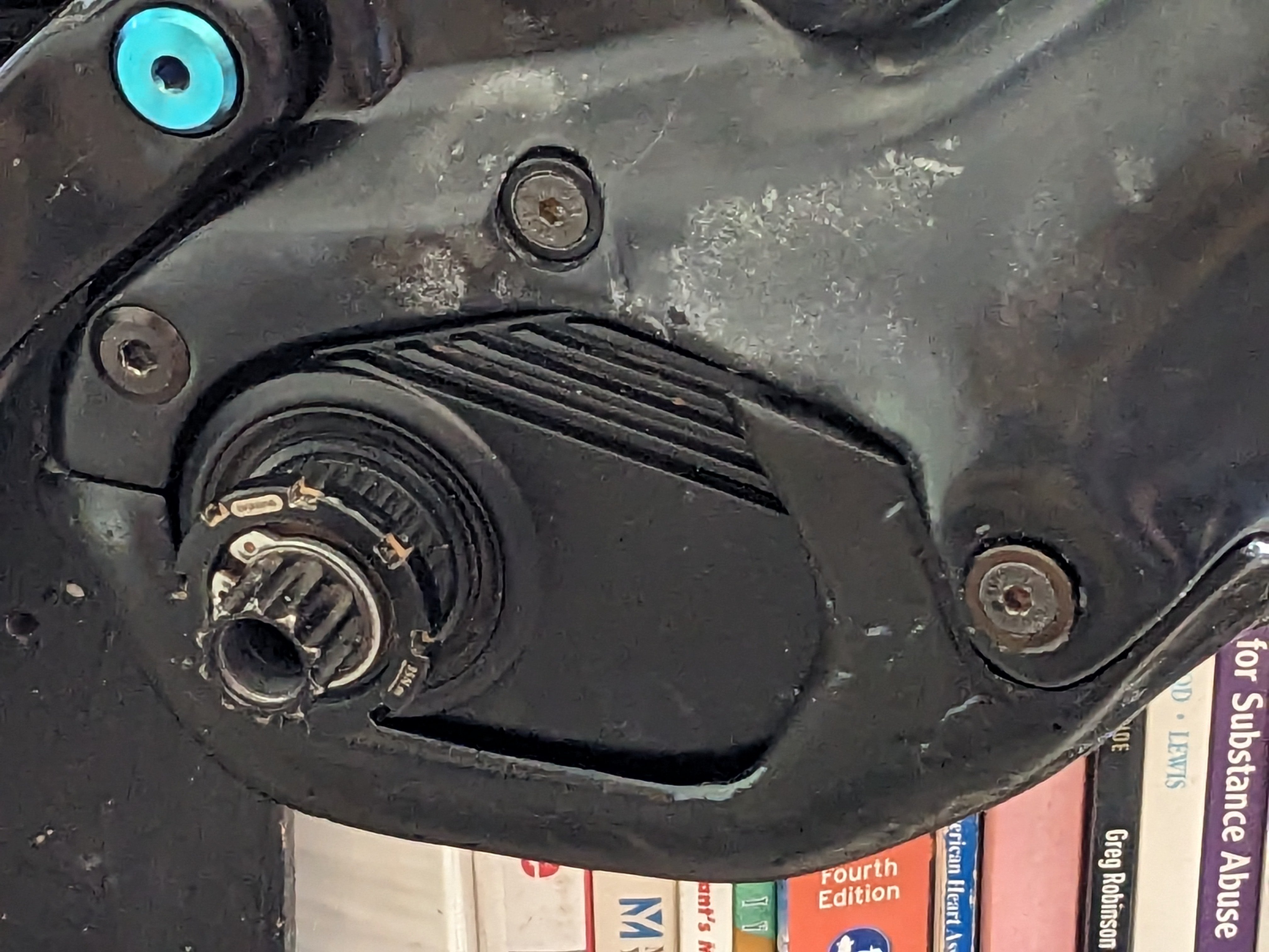

skid plate quickly builded, those delivered with the bike has broken as soon as i touched it. Somebody have received the new rev more solid from SZZS ?
TCFlowClyde
Feb 26, 2022
1,365
891
Mesa, AZ

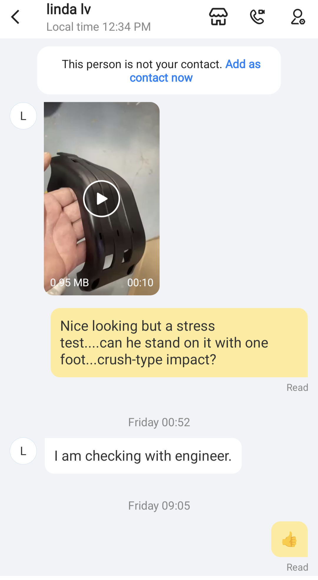

They're testing it somehow apparently...
Looks like they're ready at $15 USD plus shipping according to Linda.💸
ZSSZ is not doing warranty or FOC (free of charge) until after one year apparently due to the high cost of the mold as they're trying to recovery some loss for Gen 1 & Gen 2 failures. 😝
Linda said they were NOT able to stress test it! Their torsion machine wasn't working?🤯😱😒
THIRD time is a charm, or three strikes you're out!💥

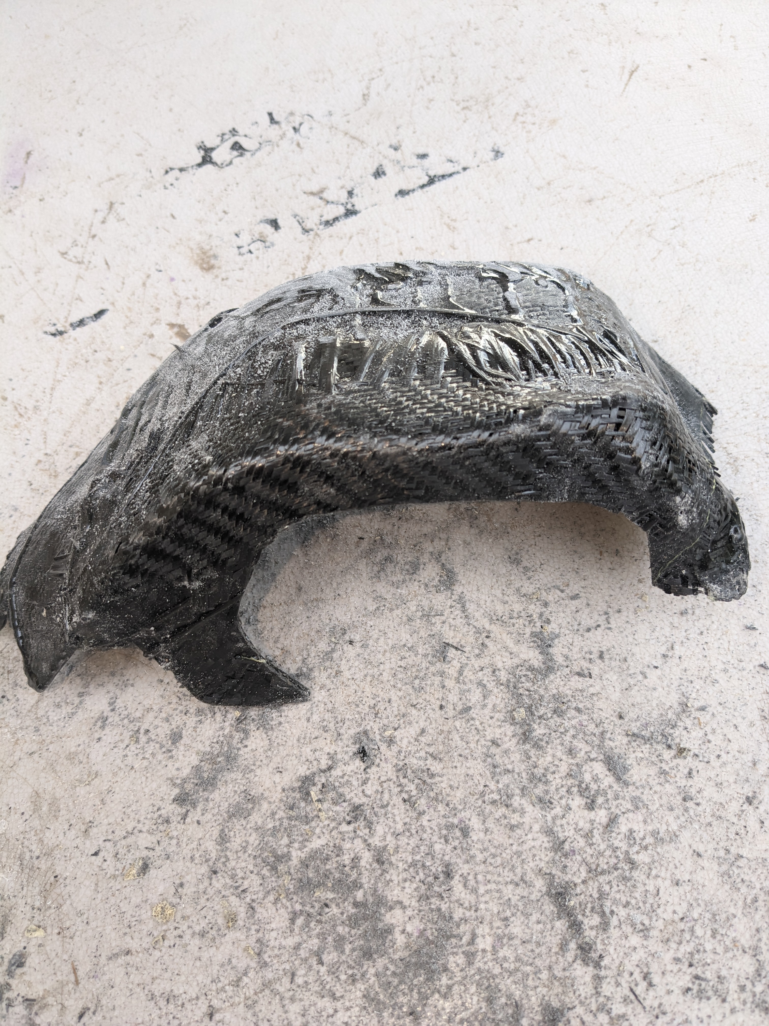

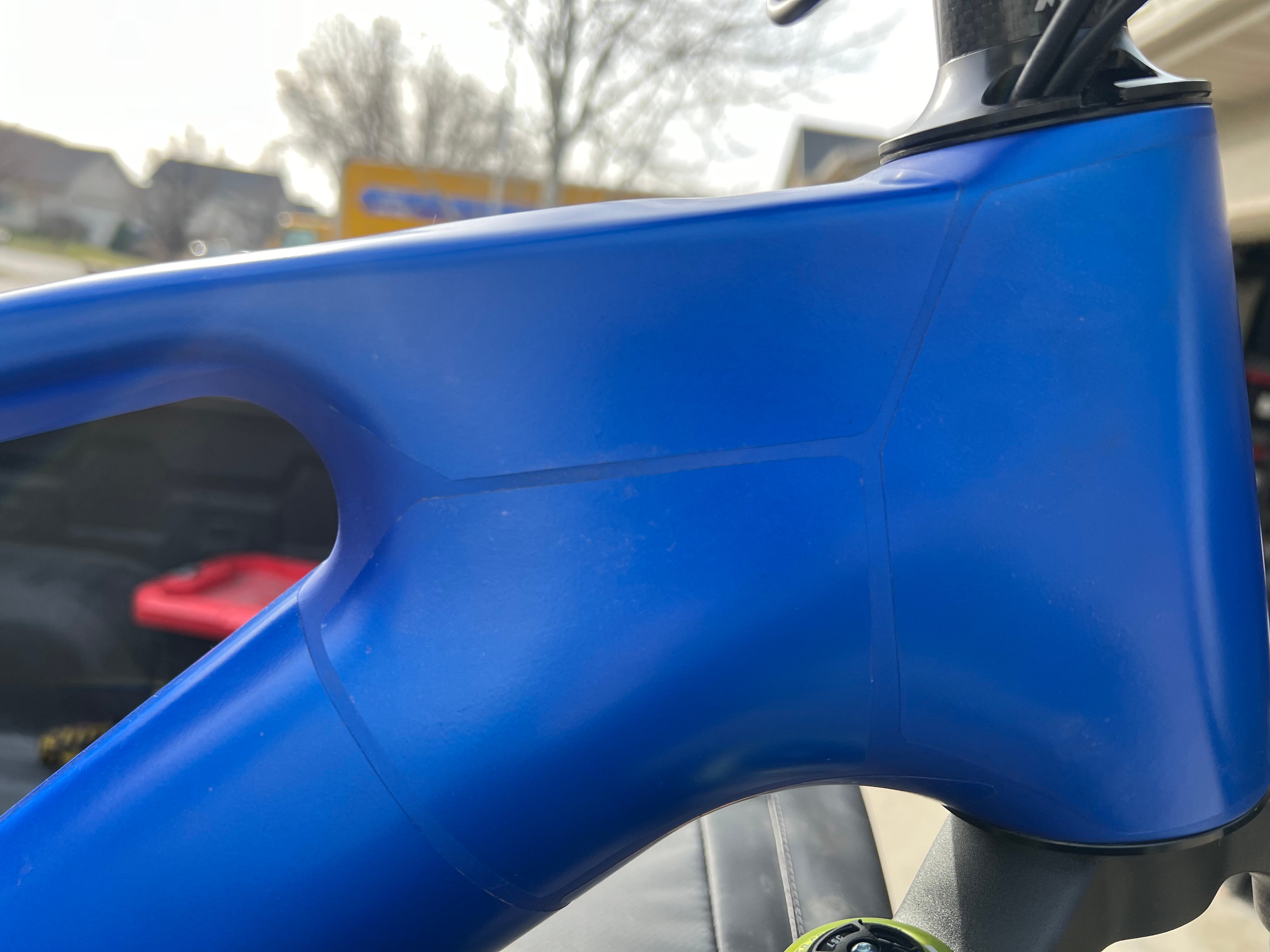

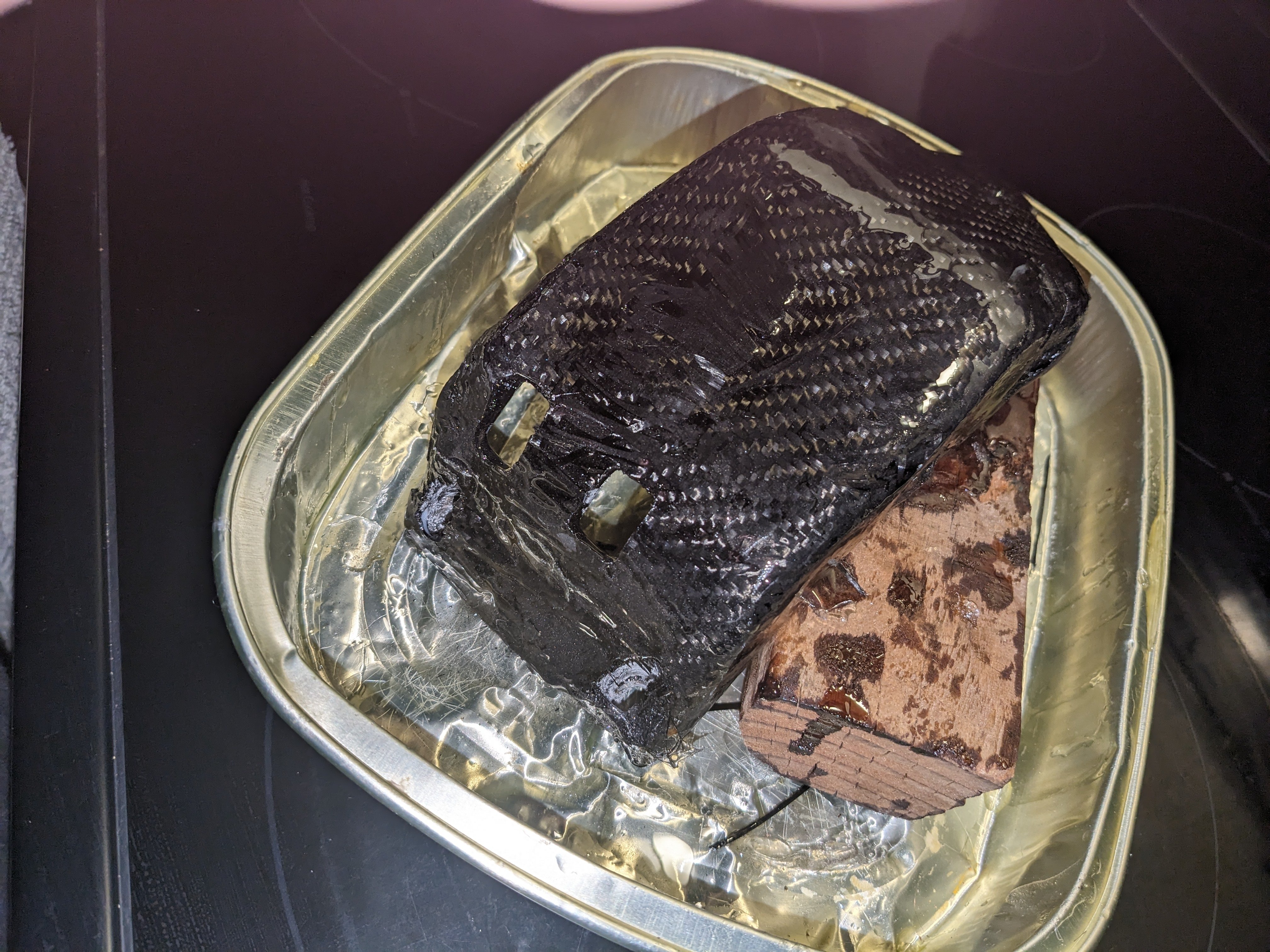

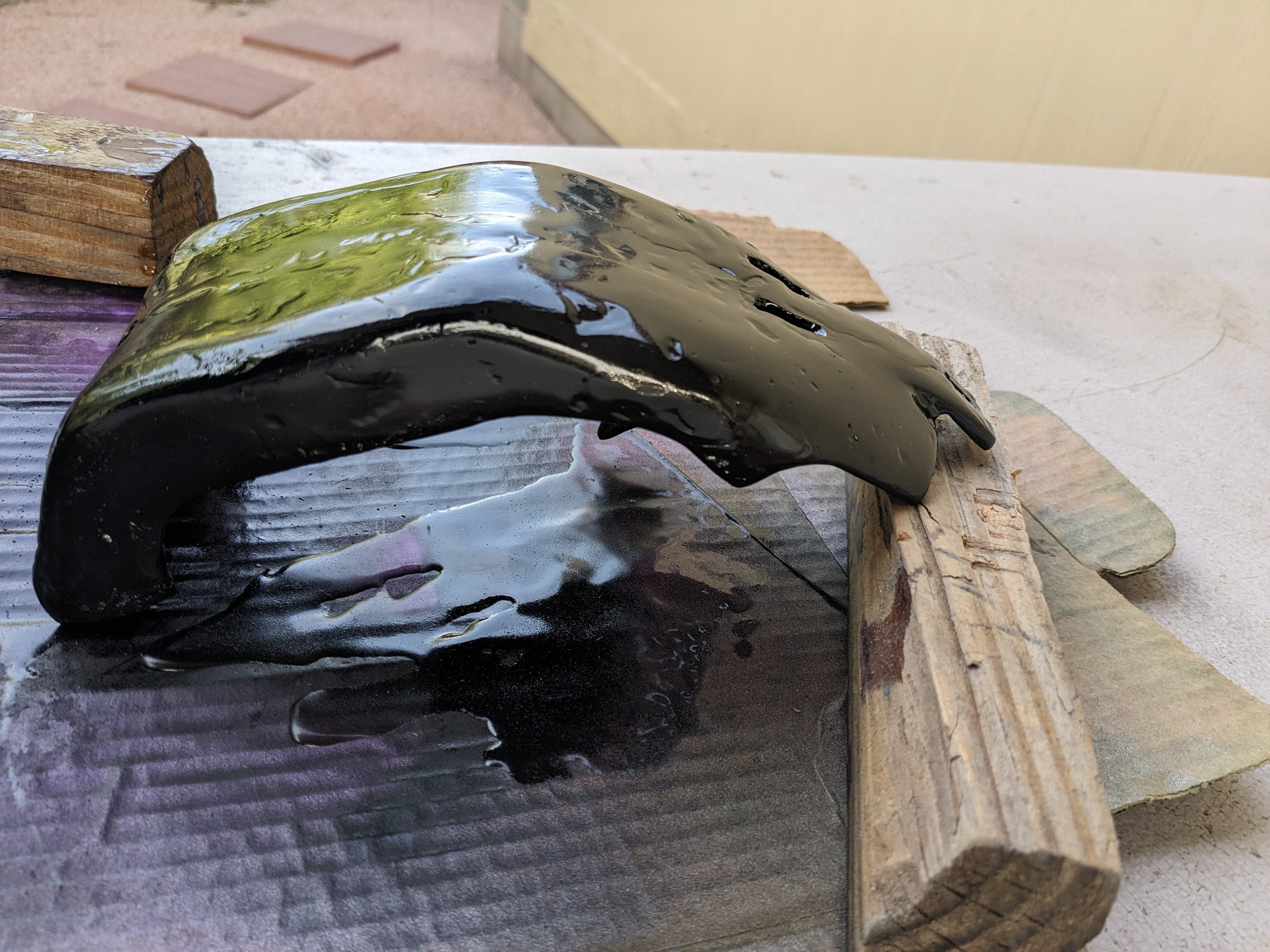

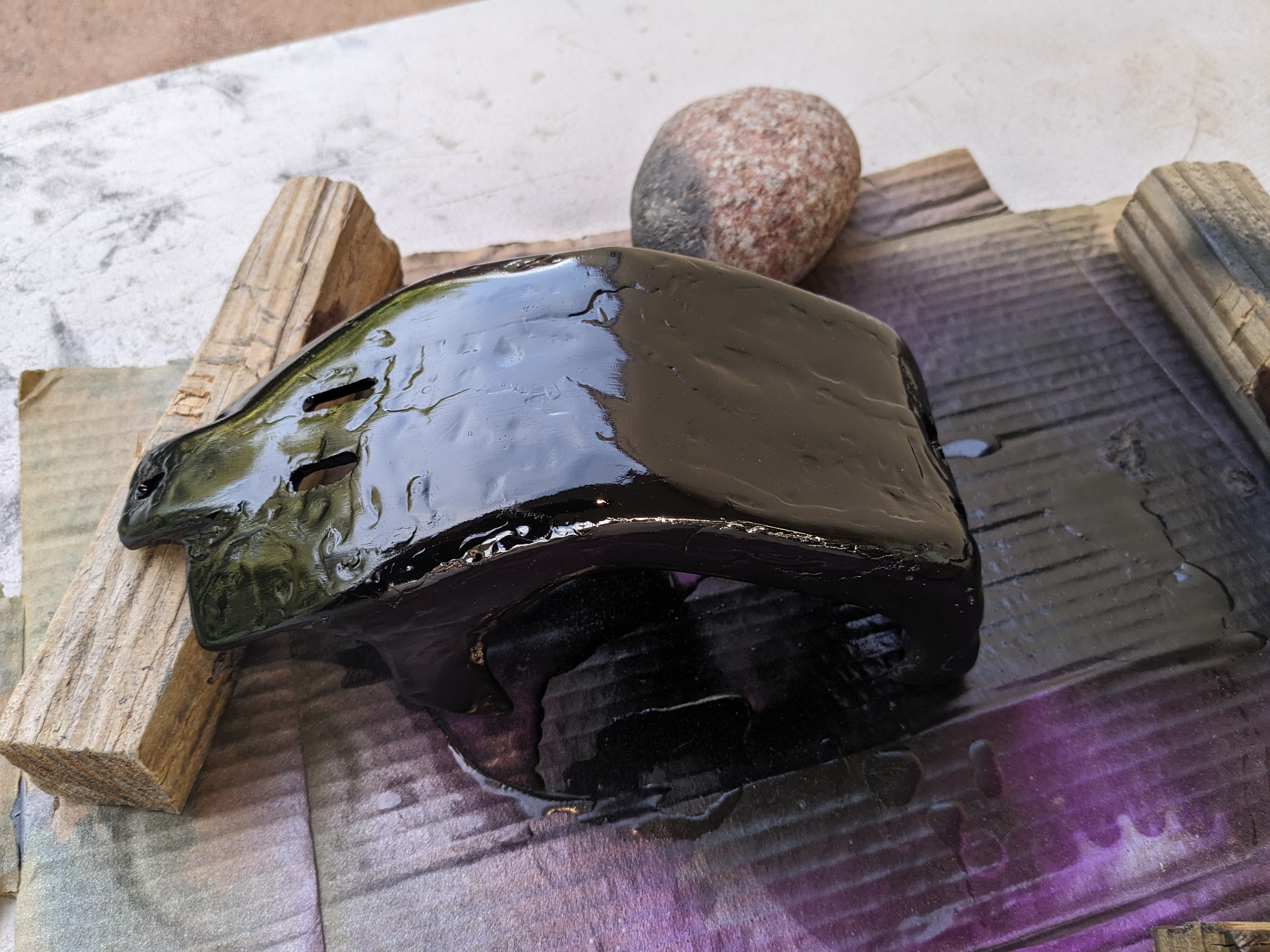

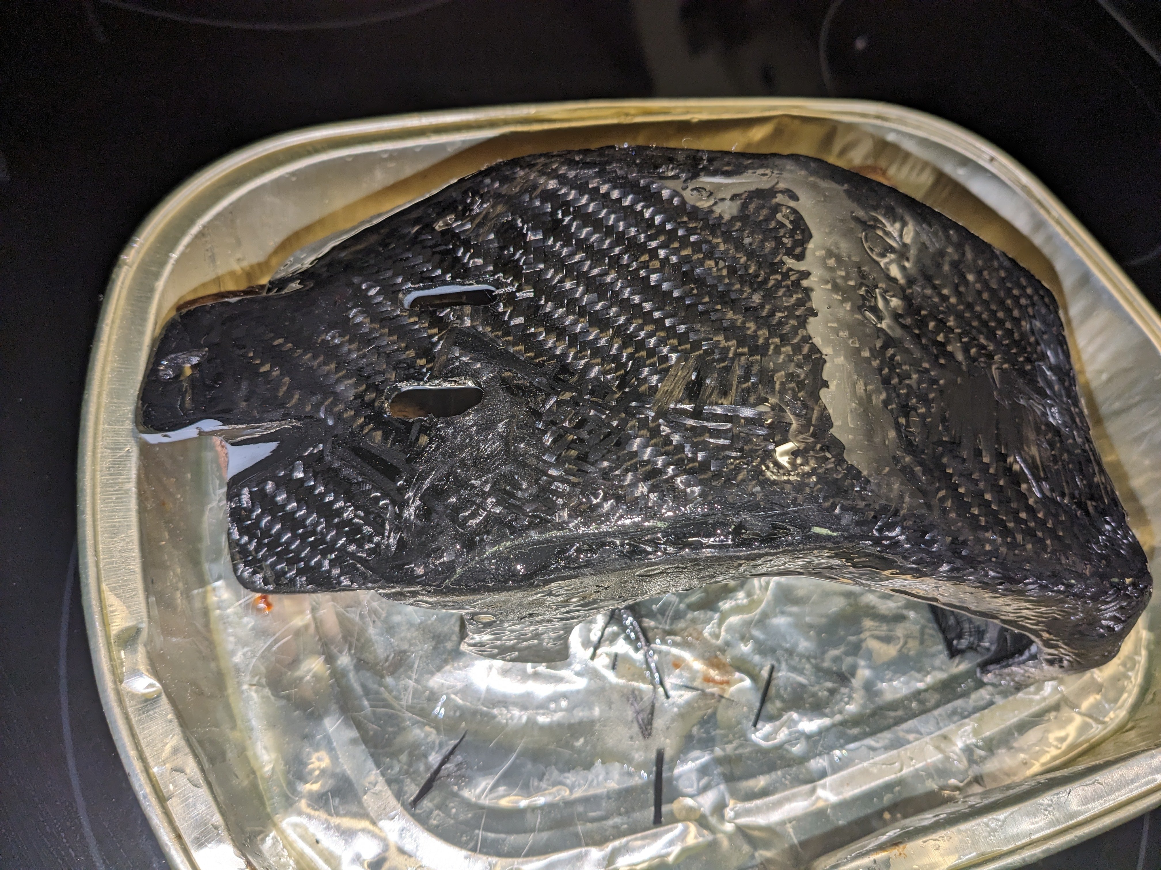

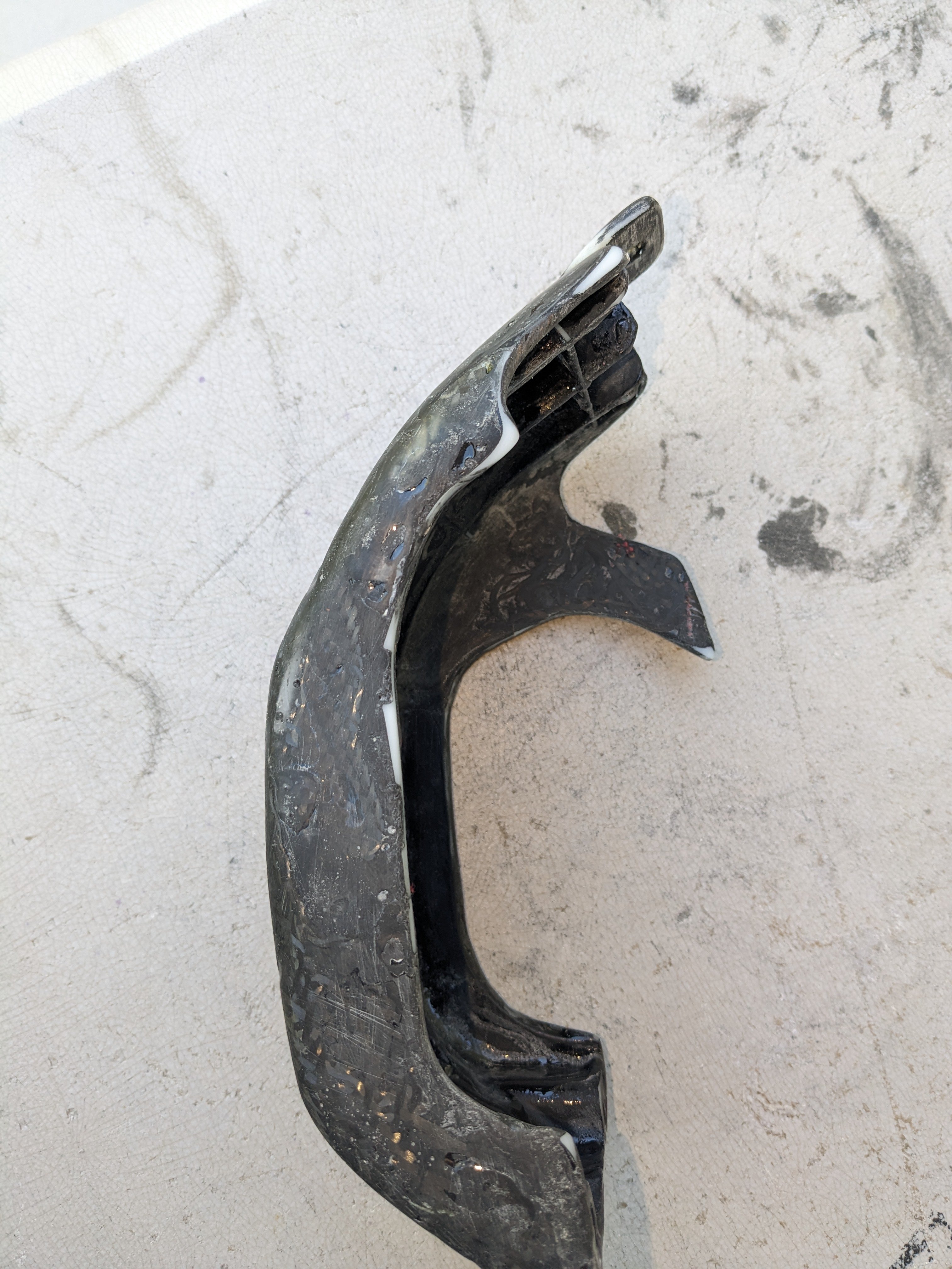

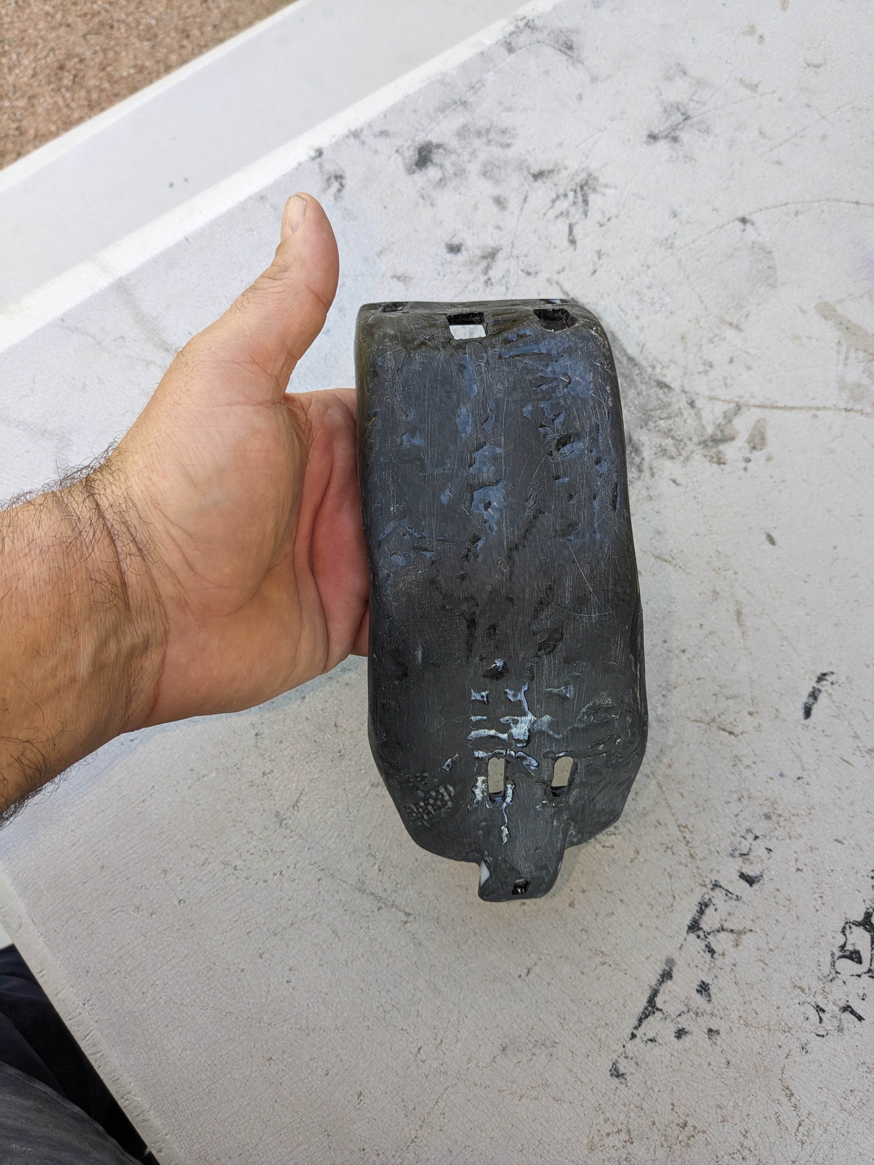

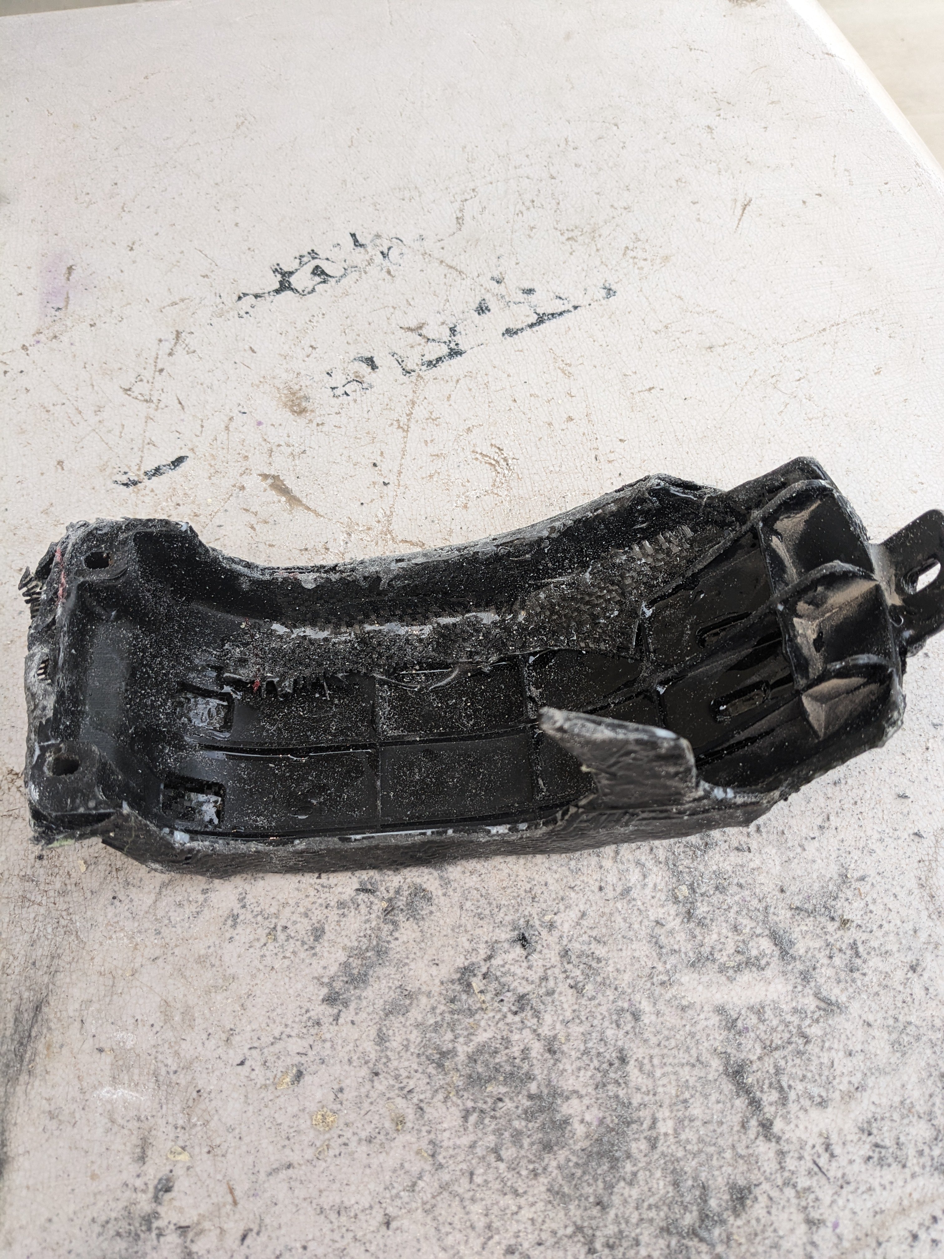

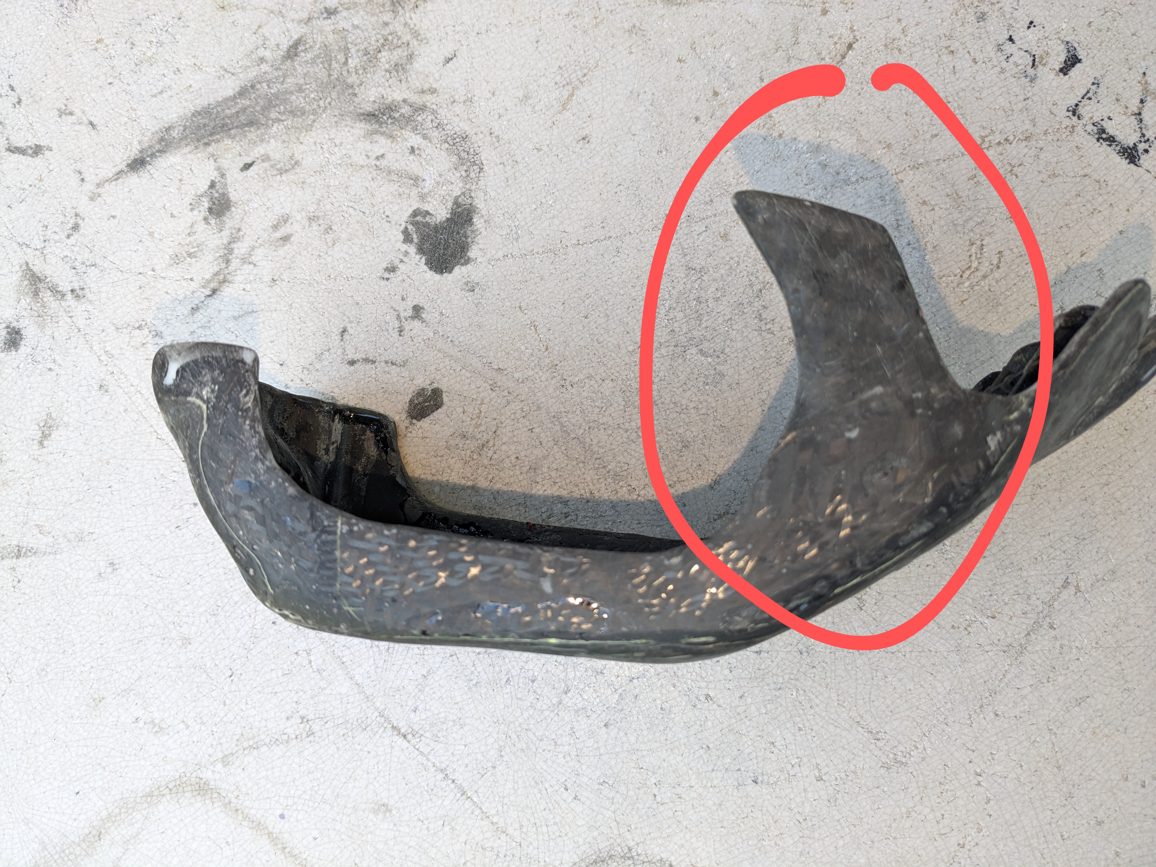

Here it is! My carbon sheathed-plastic motor-guard-monstrosity!
It's definitely sturdy but also heavier than the plastic original with armor stripping.
The process is definitely messy and plenty of hand sanding to shape the broken side farings. This one needed repairing and splicing of plastic from Gen 1 motor guard. Basically, rebuilt from two pieces. Then, the other I broke during the repair process testing flex....easy fix to reinforce.
It's got three layers of carbon fiber and lots of epoxy.
And lots of sanding....
And finally 2 layers of black glossy paint...
It's ugly and heavy but it should be protective as originally intended.
I would've been simpler and faster to have a complete plastic guard and just reinforce it fully with a carbon fiber outer shell.😝
Biggest challenge and setbacks: Re-building the curved side-fairing was a pain to glue with quick-set epoxy and probably tripled the project time.👊
Recommendations: have a backup plan if the new ZSSZ Gen 3 motor guard doesn't work. The carbon patch kit $50+ USD on Amazon and it won't take long to cover the plastic guard...if unbroken!😉

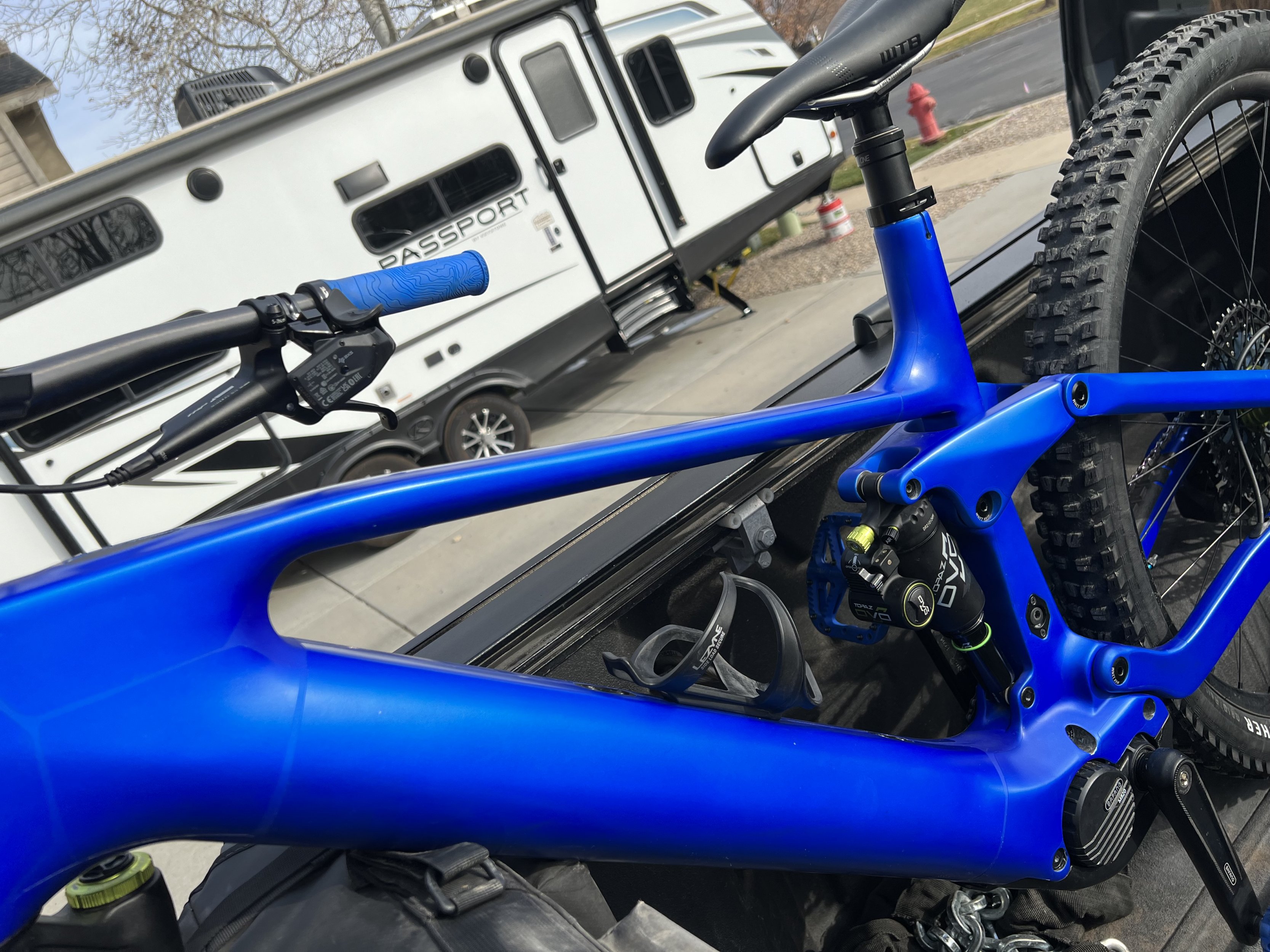

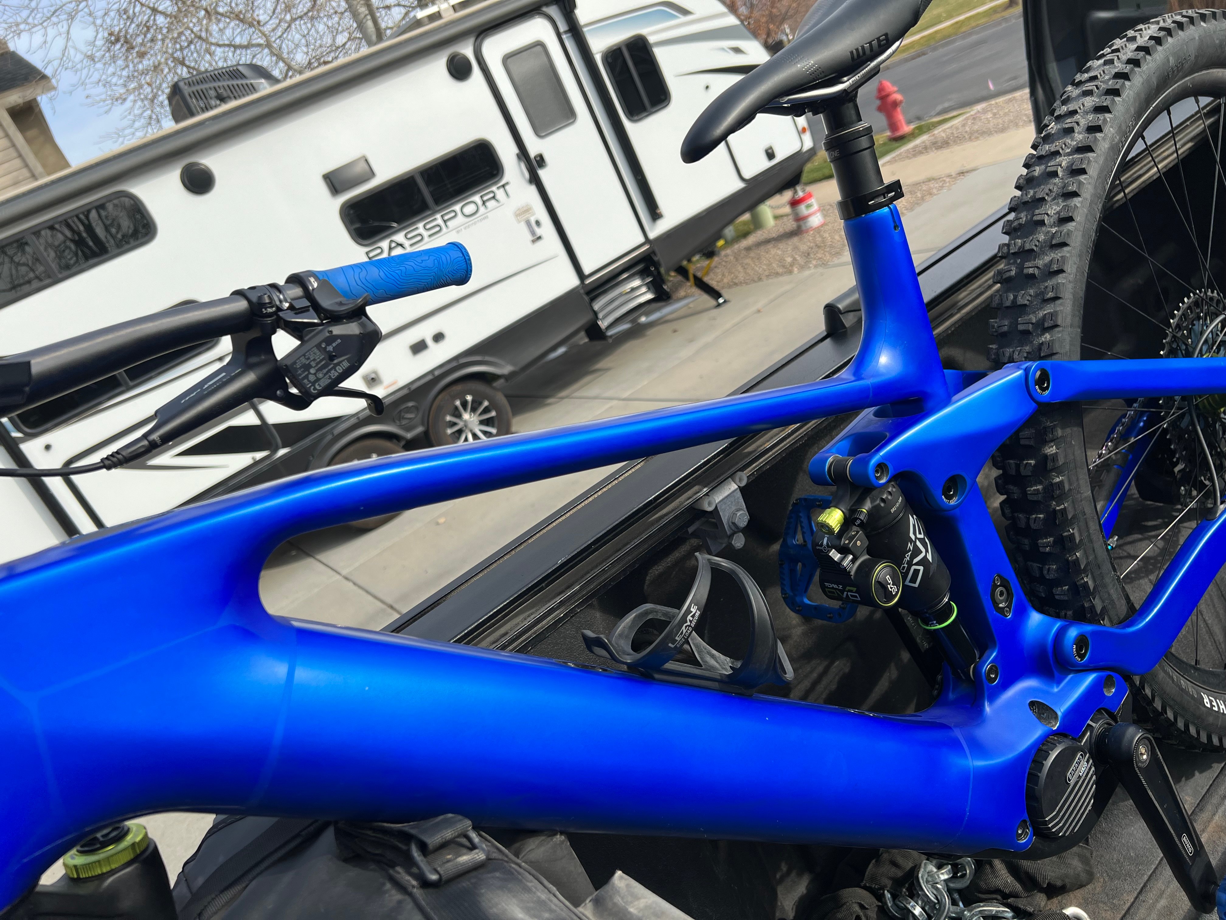

Got the bike wrapped recently… should have done it before I ride it but I was too excited. Anxious to replace the rear triangle with UDH…
Rode with pole violma and its Bosch motor today and 750wh battery. He smoked me everywhere uphill in emtb/auto and I was running sport and sport +
He ended with 40% and I ended with 63%. The shocking thing was just how good this bike handled downhill. I honestly thought the pole with its 190mm suspension would be way better but this little cef50 just rides so well. I beat him downhill several times and he is a better rider than me. Anyhow good to be back on the bike after having it gone getting wrapped for 2 weeks. I miss the power of the m600 ludi but this cef50 is light years ahead in handling and ride quality. Ran into bighorn sheep which was amazing.

View attachment 130857 View attachment 130858 View attachment 130859 View attachment 130860 View attachment 130861
Awesome! Cool to see the Big horn!
Did one take a charge at you and glance that stay when descending ?😱😁
