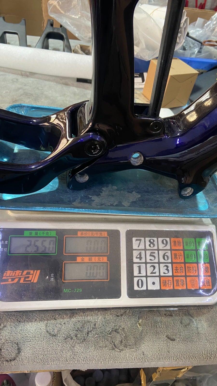

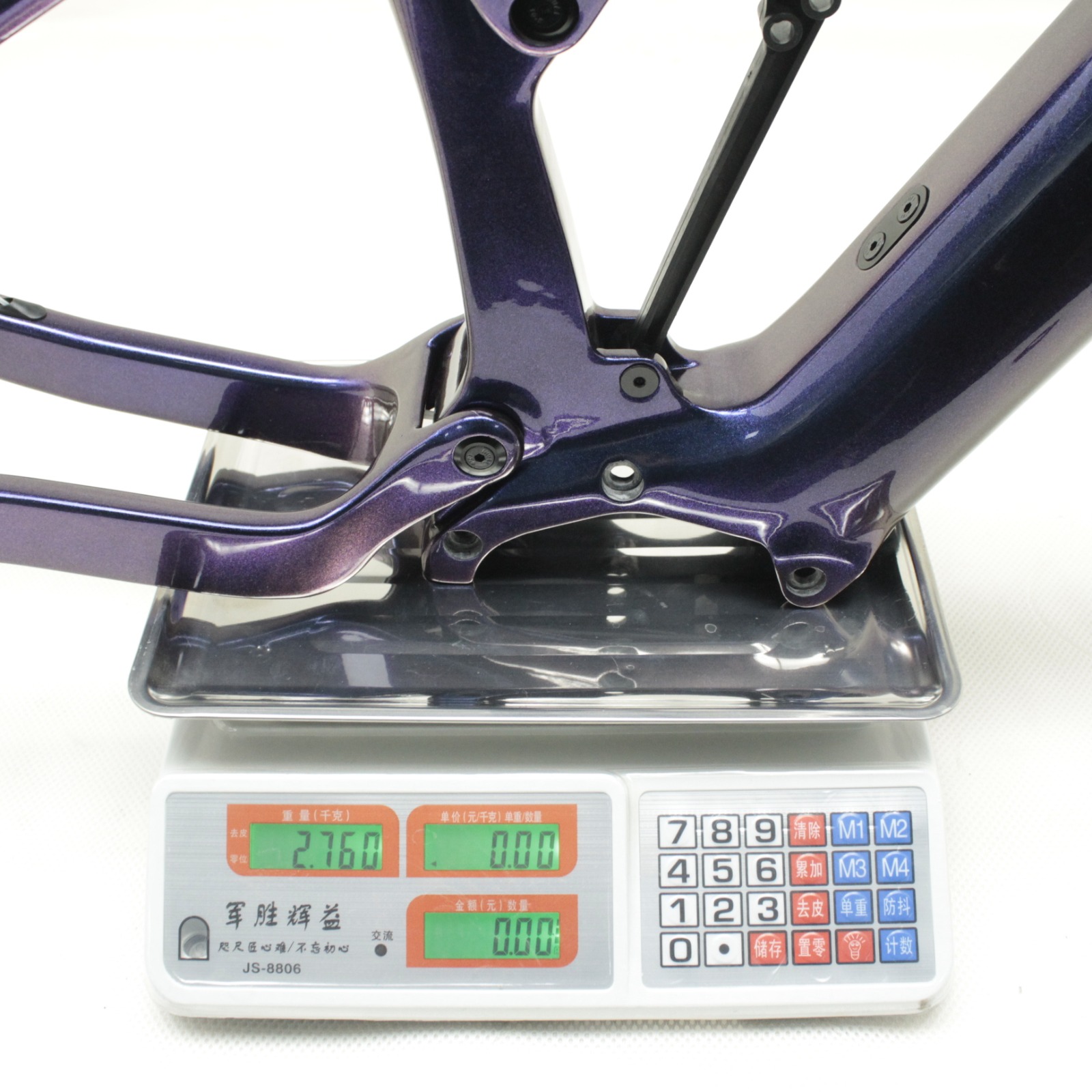

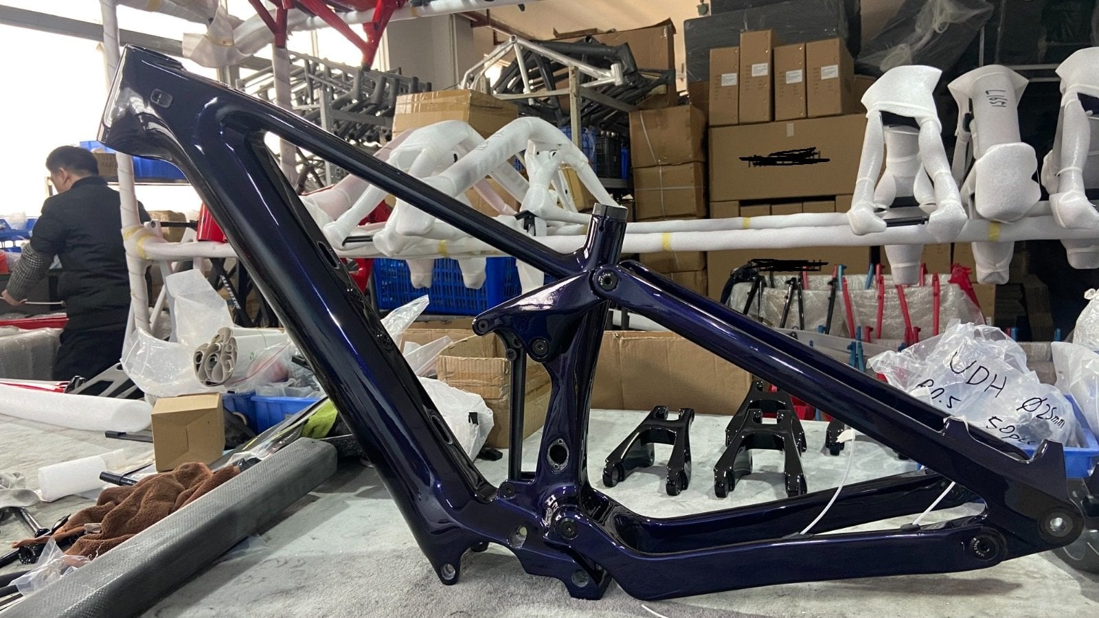

MY frame finally done, New Update CEF50 -V2 with Update Coil shock mount position and Chameleon color

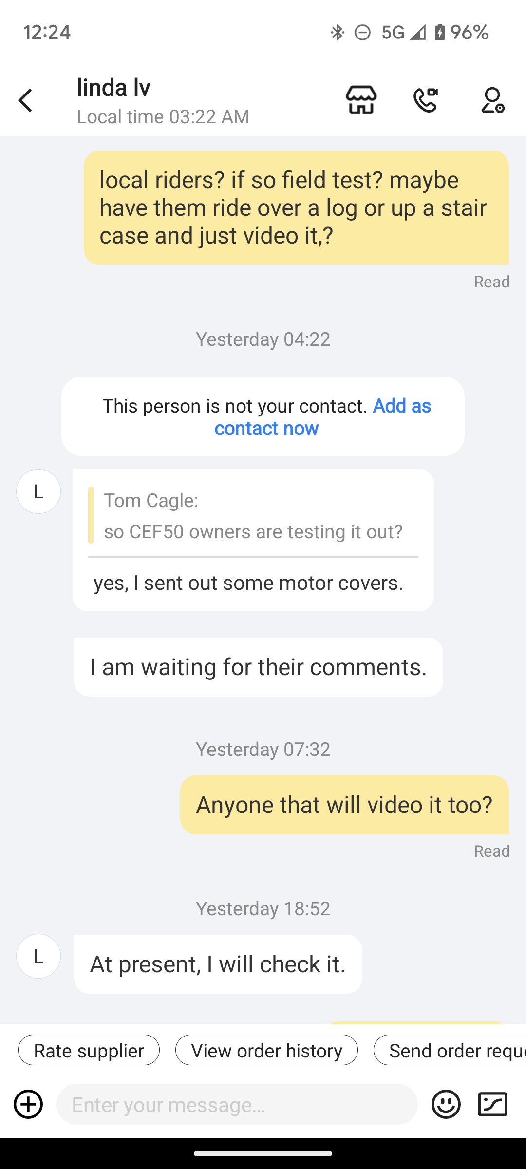

Just quick motor cover follow-up. Linda said they did send out some Gen 3 covers to select consumers to "field test it".
I'm hoping somebody will do a quick video rolling over a log and/or going up technical steps to show impact durability. Or just take a rubber mallet and give progressive harder blows to the cover guard while unmounted on the ground?
Does anyone have the newest one in this group to share feedback?
Here's the convo below:👇

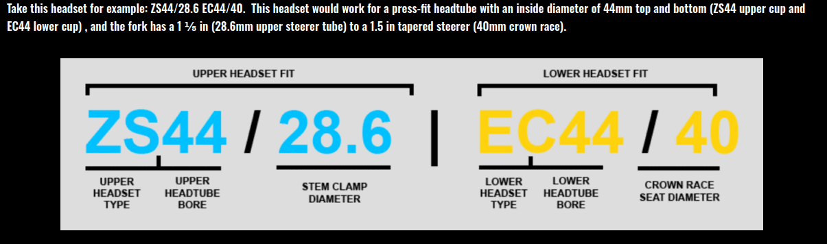

Checking to see if everyone has the same headset size as I do. My two bikes are definitely ZS56 top and ZS66 bottom. Someone indicated that their top bearing was 52 not 56. So I want to clarify the spec's and make sure everyone has the same headset size or maybe not?
Thanks
Thanks
ZS56 / ZS66 for me.
I have tried ACROS ZS56 to 1" 1/8, to replace upper integrated wiring. Bad choice, it still had always some play on pivot. now i use only the upper part of ACROS ZS56 +- 0.6° angle set, it seem that the play problem is solved with it.

Interesting. So the angleset to fits tighter than the standard top. Canecreek makes the 40 series Z56 also.
So anybody have a ZS52 top?

That is the confusion. Headset specs quote the internal bore of the headtube not the bearing size. So a ZS56 is a zero stack pressfit bearing cup for a 56mm bore headtube top.

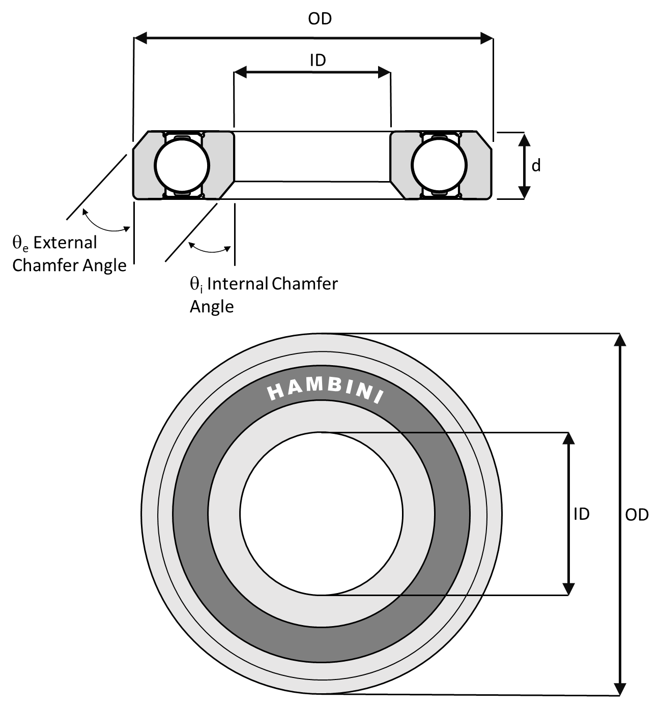

When you go shopping for bearings from a vendor other than who made your headset there are other traps.
You have the angle that the outer and inner bevel is cut to. You also have the height of the bearing "d". These have to match the cups and the top cover.
But when shopping, the retailers will know that it's a headset bearing vs. bottom bracket bearing with the likely 36 x 45°/or 45/45° degree angle where most upper and lower headset bearings are interchangeable if correct size is fitted.
The premium brands like Cane Creek do list all specs on their website: angles/ODxID with an reference number. I could've ordered from CC directly but got it JensonUSA for $30 cheaper on my Hellbender purchase.💸
Same with Enduro Bearings for older SZZS cap. They list the specs and reference # on their website and then I went to JensonUSA with 20% discount and got the right match fortunately.👍
Sure, be nice if it was easier, but not impossible, just requires decent Internet research skills and group forums like this to independently confirm compatibility and ideally purchasing links.💪

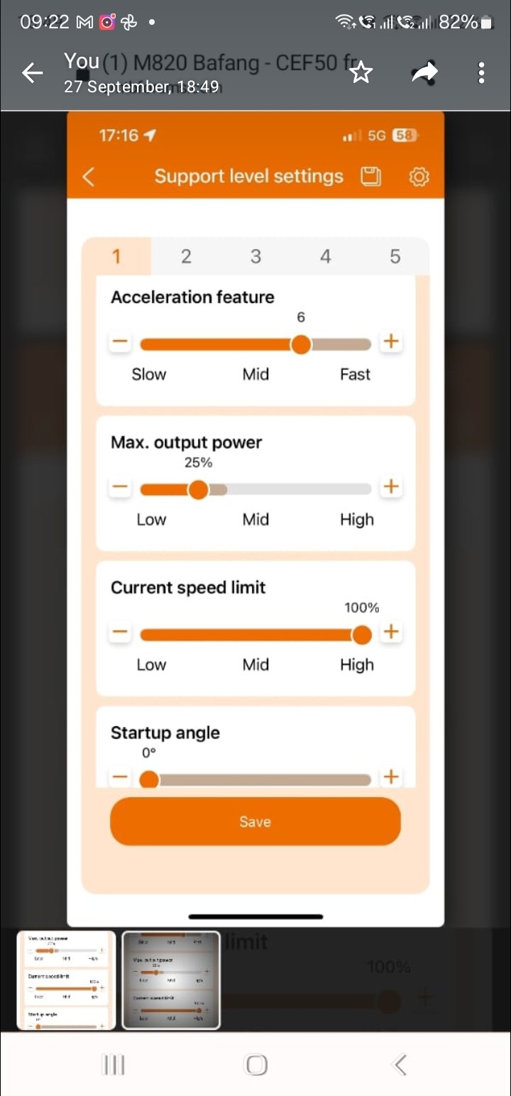

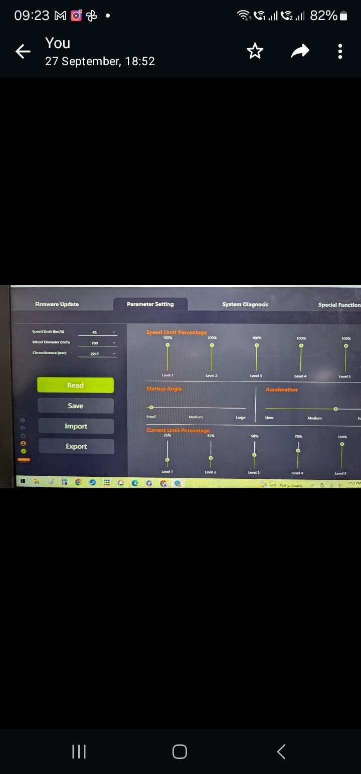

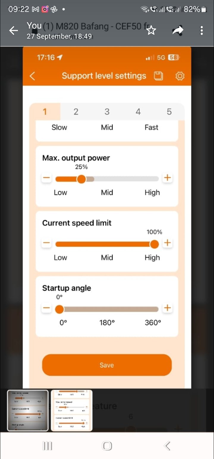

My experience is that the M820 is very smooth. If you read back in the thread someone commented that the start angle could be adjusted so that there is no delay. I have not really noticed it as a problem. I notice no delay in the change of assist levels. I did not want an electric motorcycle. I first started with a bike with a BBSHD and it only had a cadence sensor. So it could jerk around. If you just rotated the pedals a bit in the boost mode you would take off. I loved the Orbea because it was more like "a tailwind" and so is the M820 to me. But I am a user who does not want a full eMTB experience so take my comments with a "grain of salt". I want to feel like I am riding a MTB, just with a little help. Others may be Enduro riders that want a big boost back up to the top. Maybe someone who owns a full power Bafang like TC will comment about the comparison.

You're right to say that. I drove the M820 for several months and it was boring for me. I missed the M600 engine. Now I'm riding the M560. It's more fun for me to ride on the M560 and I'm having fun.
