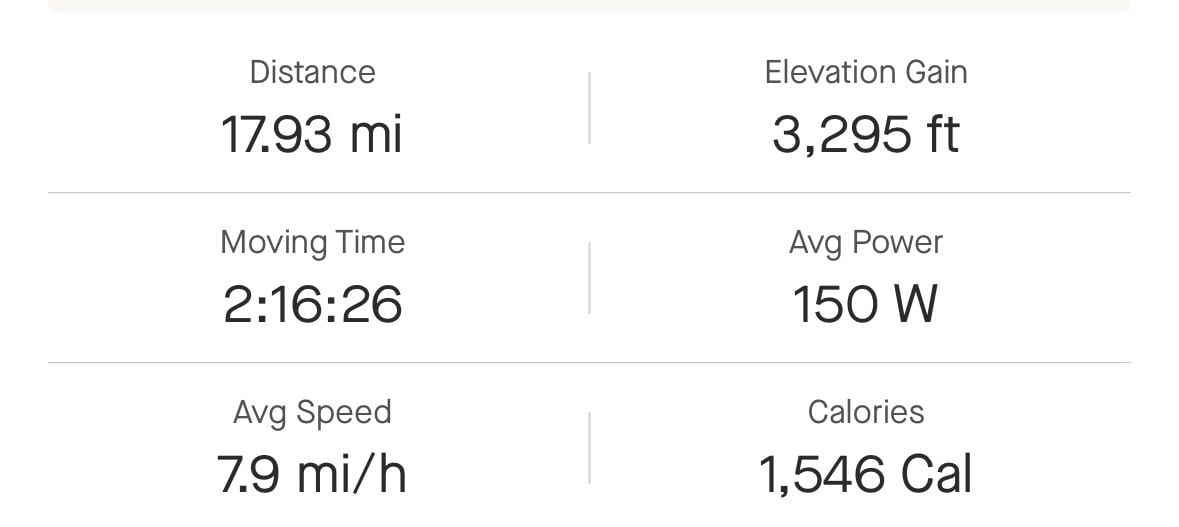

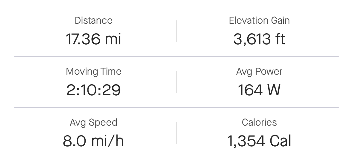

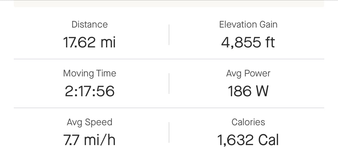

Yes, that’s correct, the drain is consistent with ep8 where I would have consumed around 70% over 5000 feet of climbing around 10 to 25% grade. On my M820 I would not be able to do anywhere near that. I am running in trail plus using about 48 of torque. I weigh 185 pounds and I’m contributing anywhere between 200 and 500 W of my own energy depending on the effort and steepness of the climb. My overall estimated contribution of my own power on an average ride is 180-190 watts over around 2:15 mins of moving time.
View attachment 131433 View attachment 131434
The top one is the M820 the bottom one is EP8. The top one I’m always concerned about range the bottom one I never think about it. There’s something about running a higher cadence that allows me to output, more energy, more consistently, and the numbers show that. That all comes from the EP eight ability to have more support From a torque perspective/peak output, power perspective.
Does the voltage (48 versus 36) have an effect on how much output power there is available? View attachment 131438
I added this last one as a comparison on my kenevo SL with the 1.1 motor. You can see I’m putting in less of my own effort the lower the power output of the motor. I should also disclose that this is with two range extenders totaling 720 W a total capacity. I am left with about 30% after everything’s all said and done. I’m not sure if that’s the same for everybody but if something about a higher output motor that causes me to feel like I want to put more into it.
Nice comparison result, i am curious how does CEF50 geometry in term of downhill compare to your Kenevo SL. My initial choice was Trek EXE or Kenevo SL but end up getting CEF50 because bike industry price are at peak point and its heading down now soon.
the cef50 BB height its a little high, i am thinking of using offset bushing to lower it by 10mm.

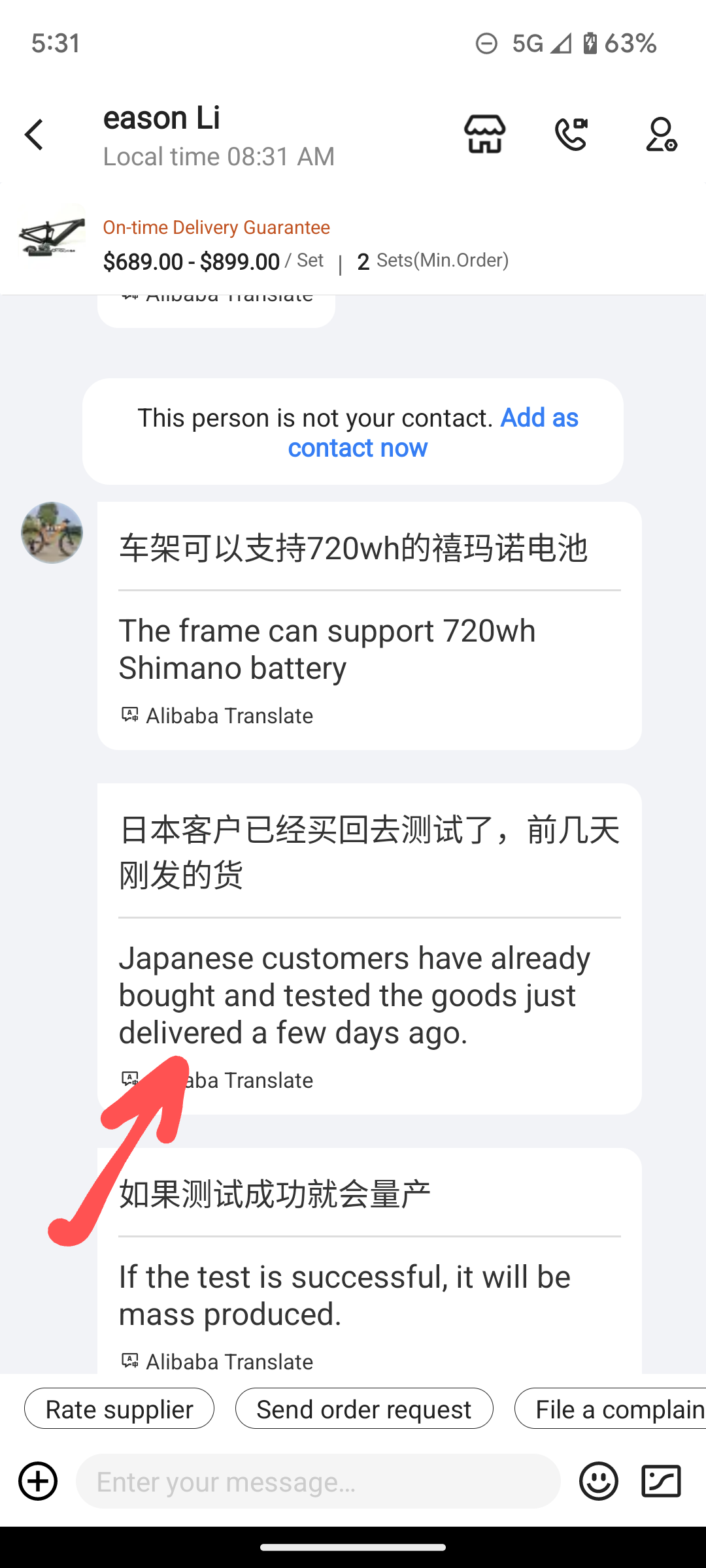

Any update from Linda on this? I’d heard that they’re waiting on batteries.
Not from Linda. All my info was from Eason Li at SZZS.
Eason was saying that the 720 Wh was being used in Japan. I don't know If that meant simply configure their battery with the EP8. I assume that as long as the connectors are compatible with the motor, a third party battery should be good to go!
Here's what he told me last week:👇
I didn't inquire further due to lack of interest. Also, why Mike started the CEF52 thread to direct traffic over there.
