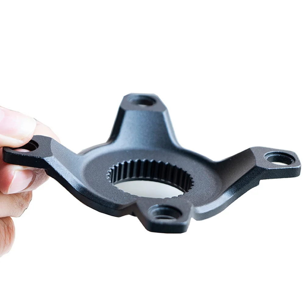

Anyone know the weight for m820 crank spider
Just found this amazing item on AliExpress. Check it out! Please help me choose!
MYR62.50 44%OFF | For-Bafang Motor Four-claw Base M420 M500 M510 M620 M820 Motor Plate Tooth Aluminum Alloy Conversion Brand New
on my side, I've bought a m510 spider on Aliexpress and the offset seems completely wrong. I did not installed it but when compared to the original 34t chainring, it seems completely different
they are dedicated to fat bike
14,184
21,098
The Vitus m510 crank is about 270g if that helps.

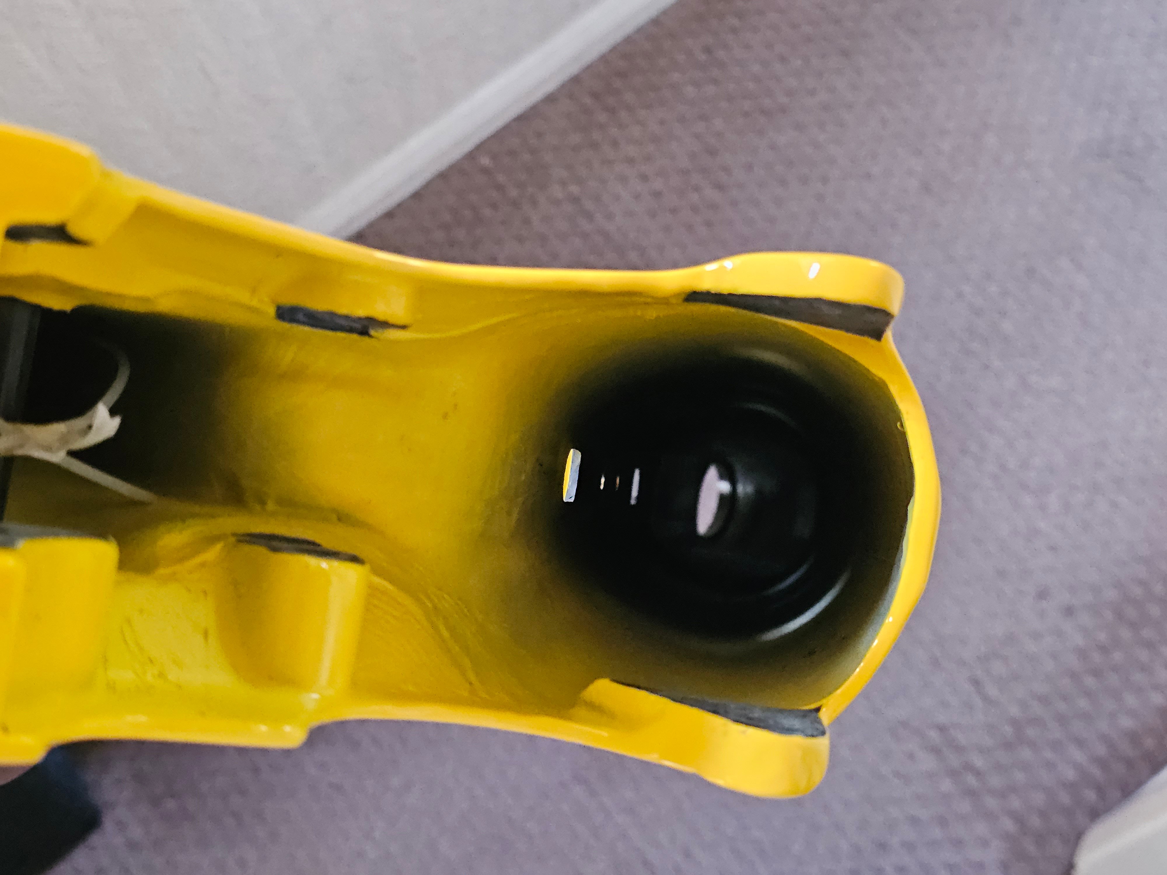

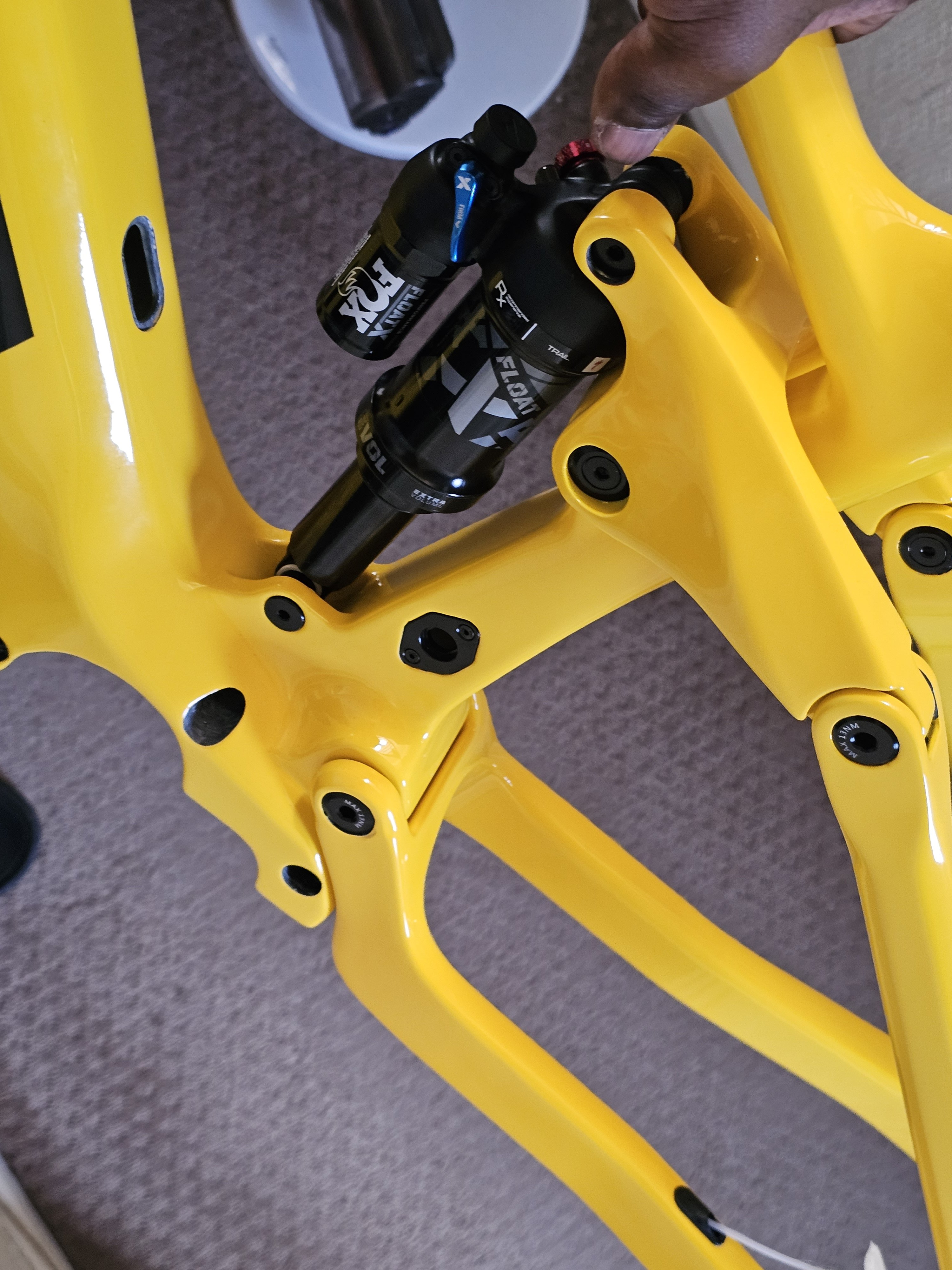

Neeko DeVinchi
Dec 31, 2020
1,042
1,387

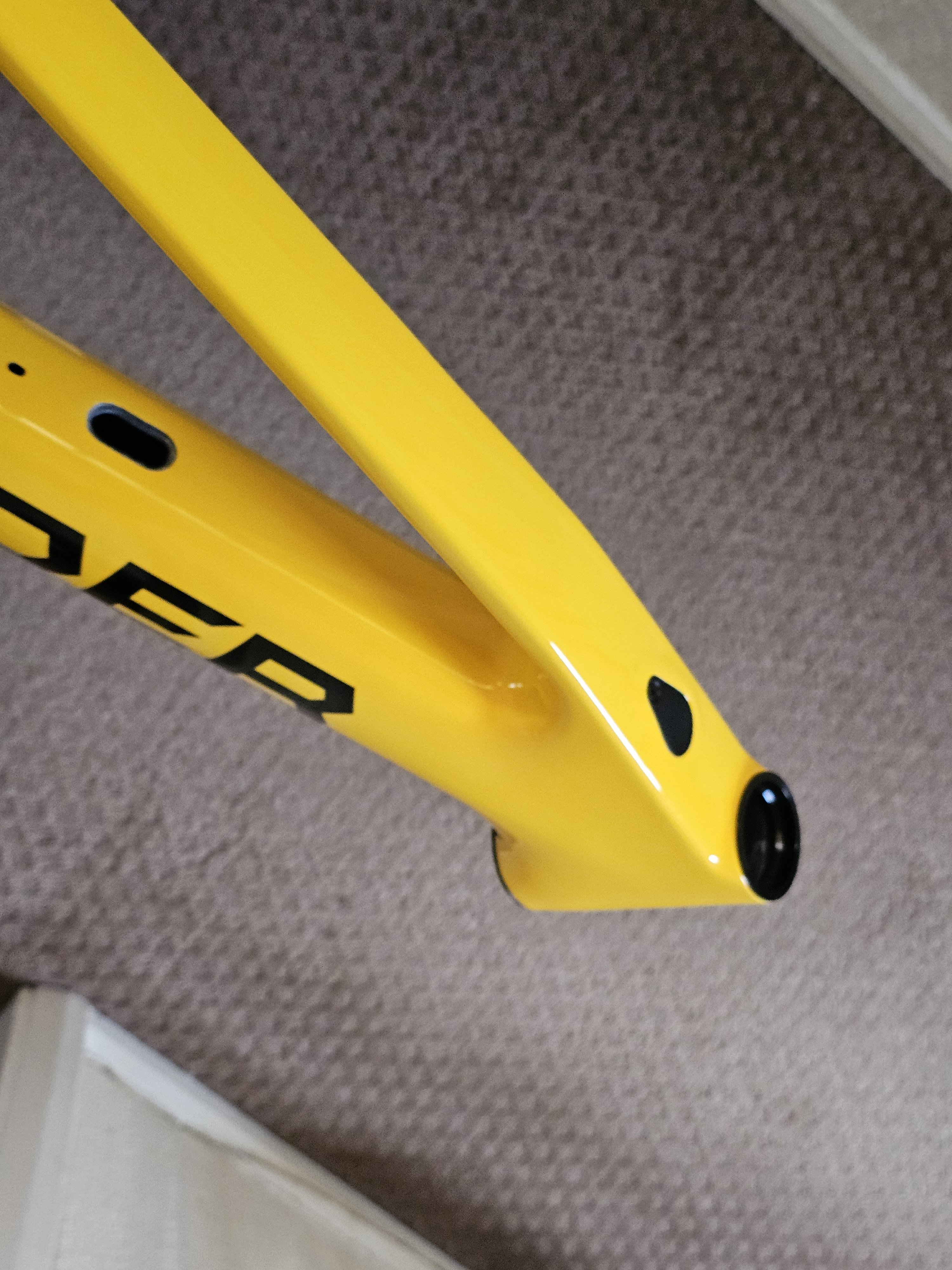

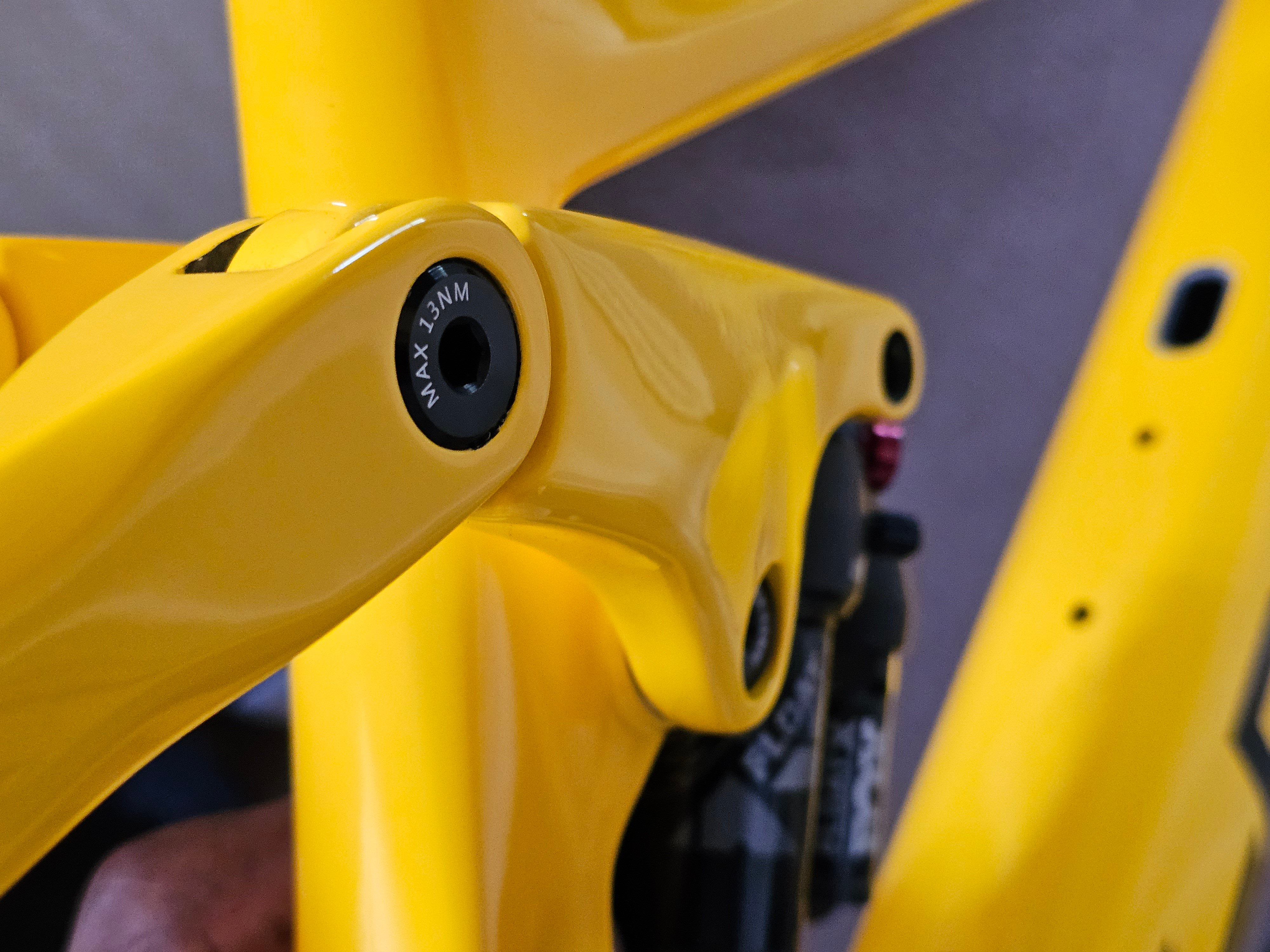

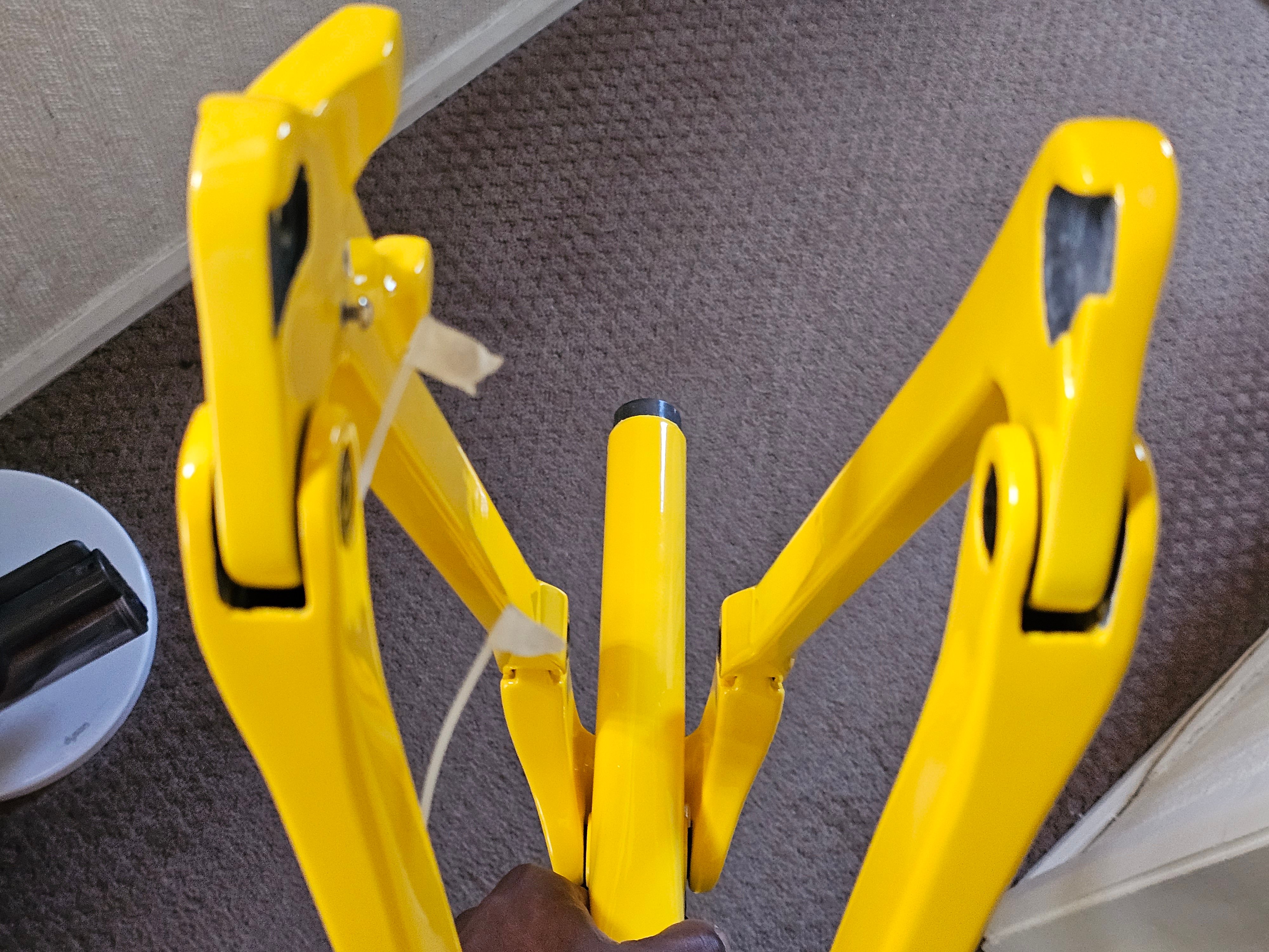

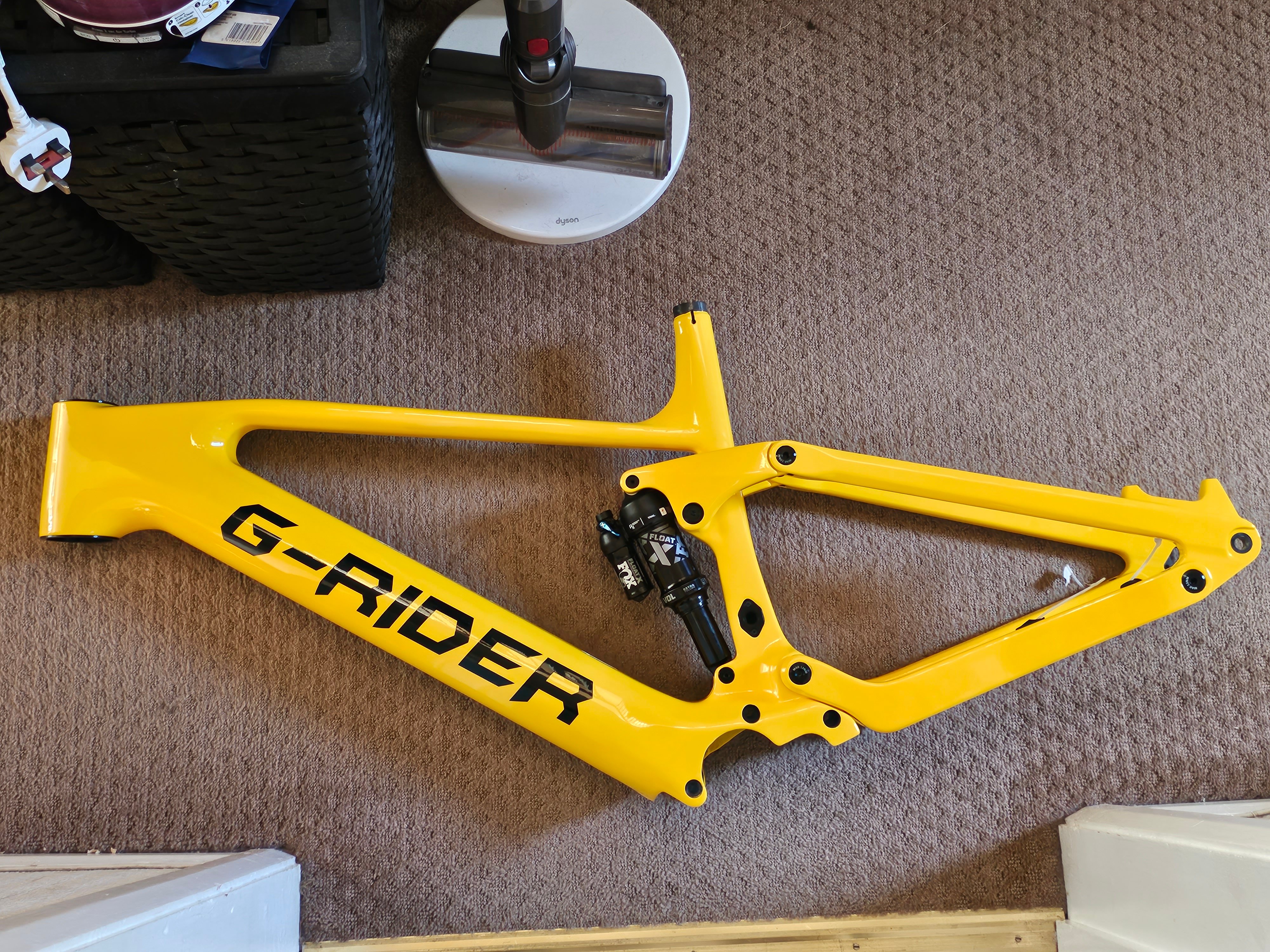

Guys, I've been so impressed with this thread,
you've all inspired me to get one👍🏿
Gotta be honest, I've not really spent much time on super light/mid assist emtbs.

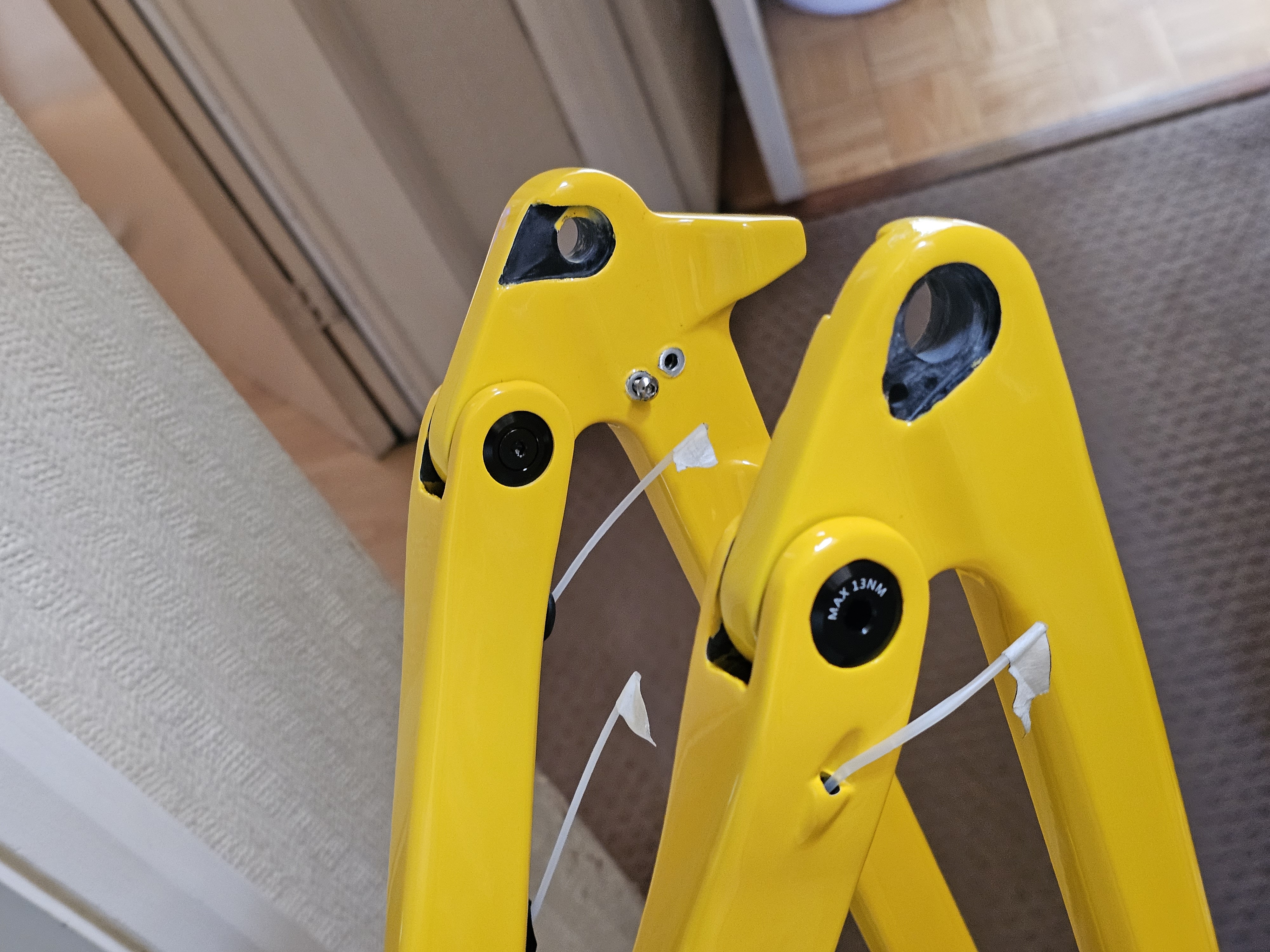

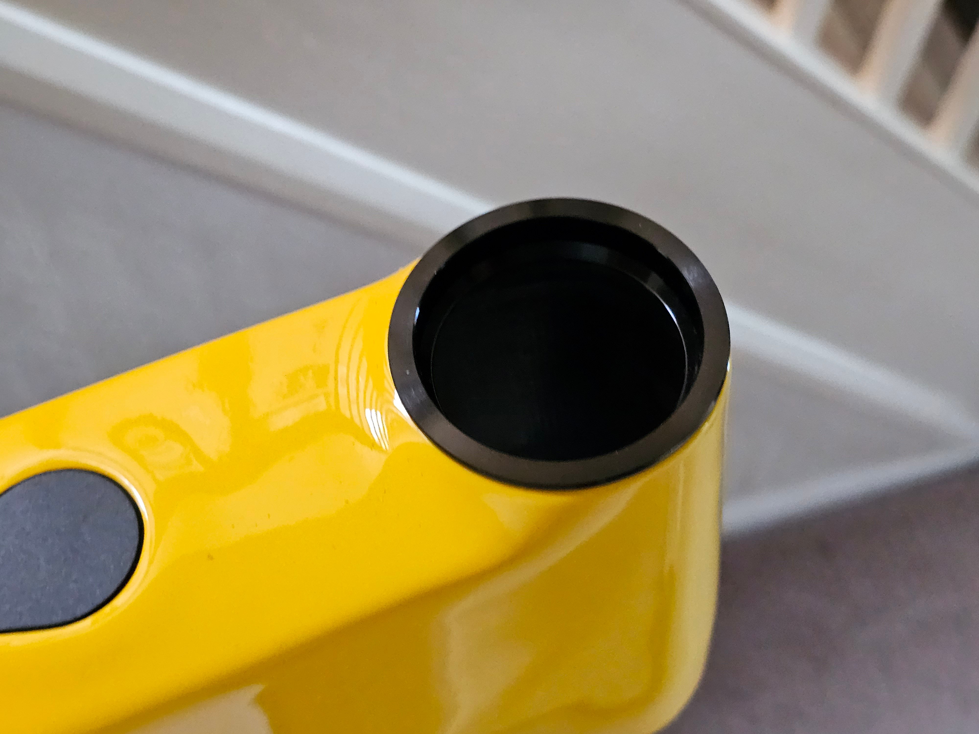

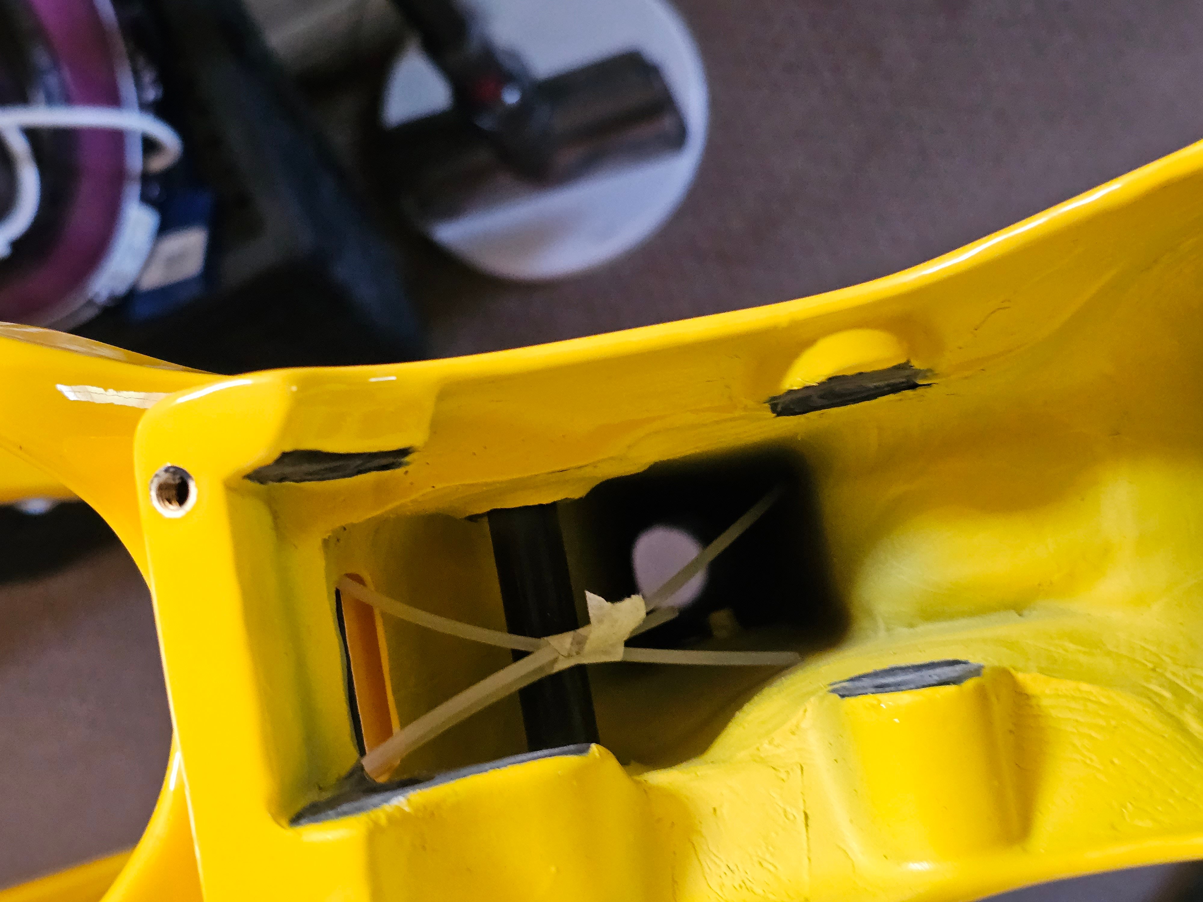

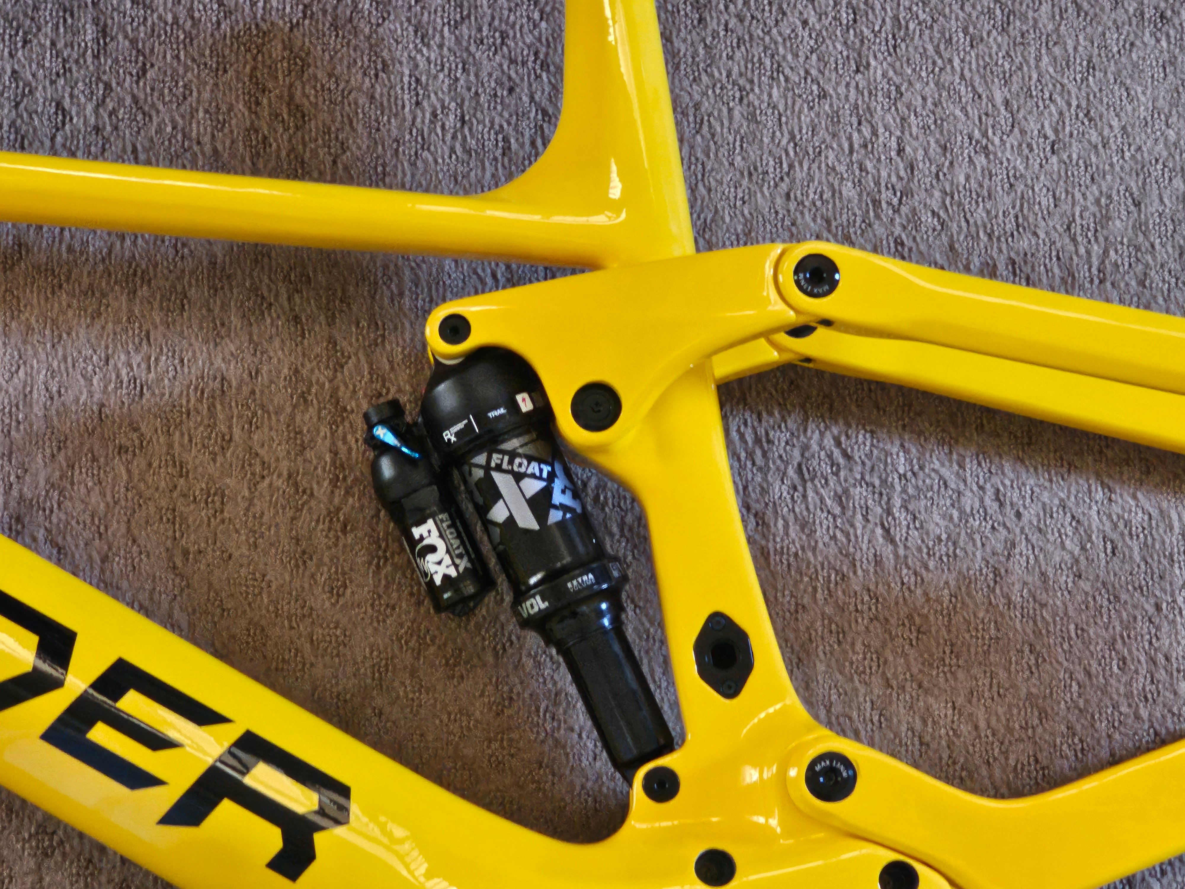

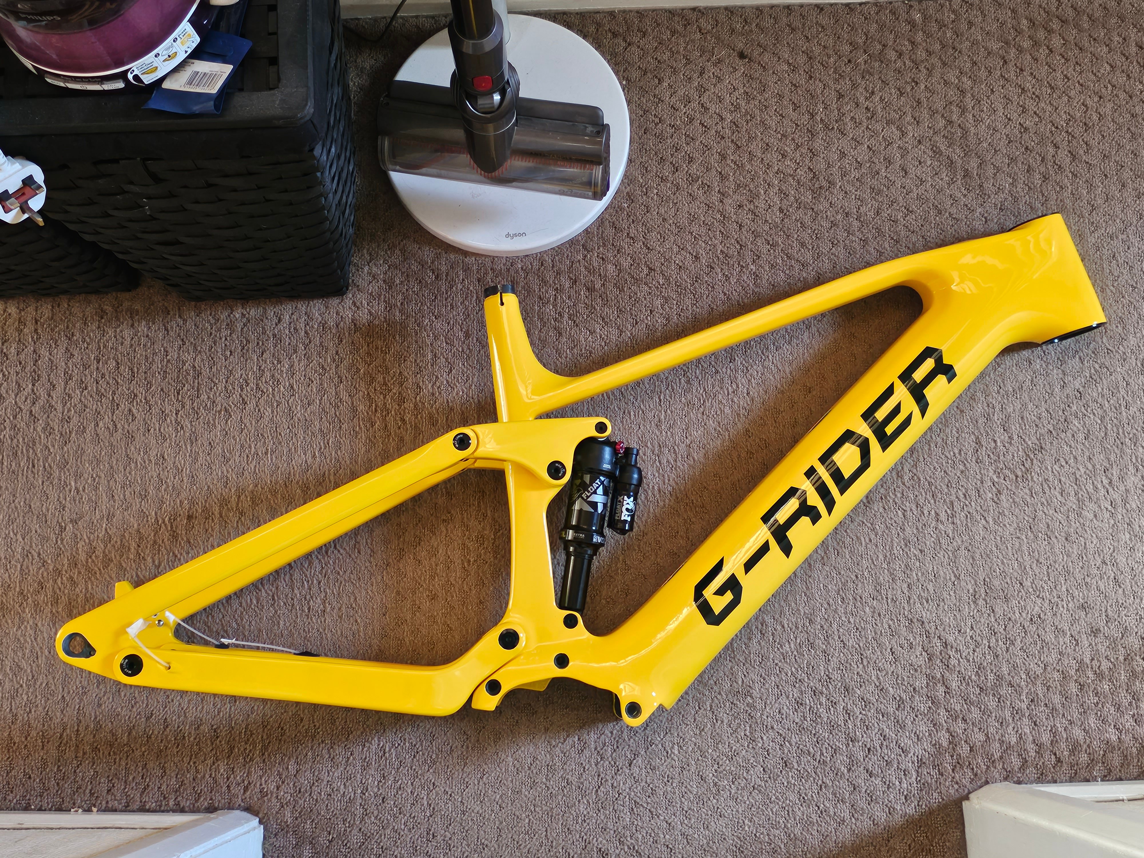

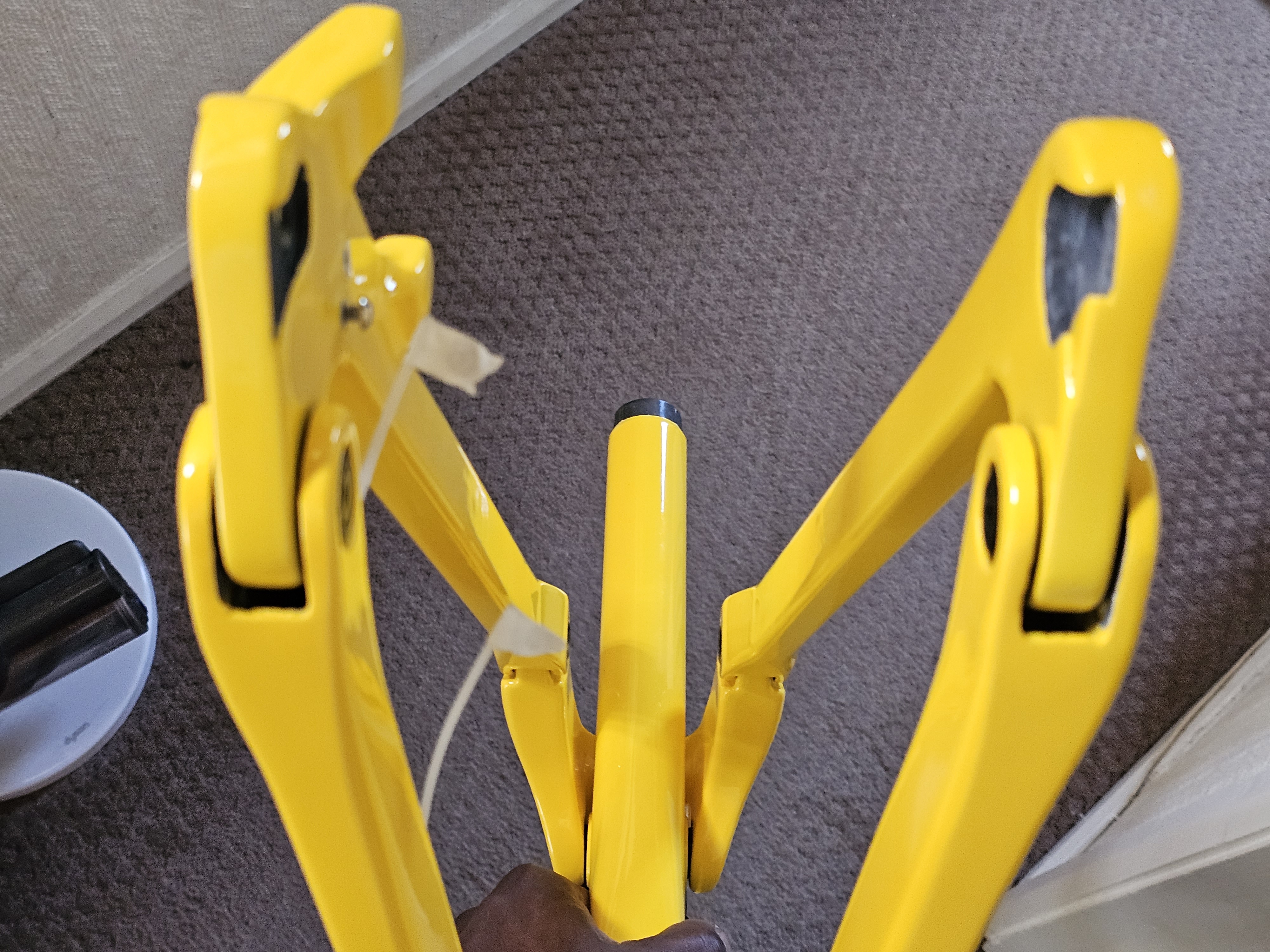

So this will be a treat. Not sure if it's been mentioned before. But I was surprised to find that the main rocker link is also made out of carbon aswell.
To play it safe, I'll opt to run an air shock
Lol. They even went as far as install the headset cups. Bless!!😄
Cable routing seems simple. And I should be able to run a lighter battery compared to the 43v Bafang proprietary battery.
Dropper insertion seems generous on this XL. But the charge port could pose a potential problem. But I'll grab a 210 one up dropper this weekend.
Still can't get over the fact that the rocker link is carbon as well!!!😮
The lack of a seat stay bridge does have me questioning the torsional stiffness in the rear. But I'll reserve judgement for now.
But considering that this frame is made out of a stronger grade of Carbon compared to other frames I've built up,
Initial impressions are pretty good.
Like I said, thanks to everyone who's contributed to this frame on this thread. Seriously, it's taken a lot of the "guess work" out of the equation👍🏿

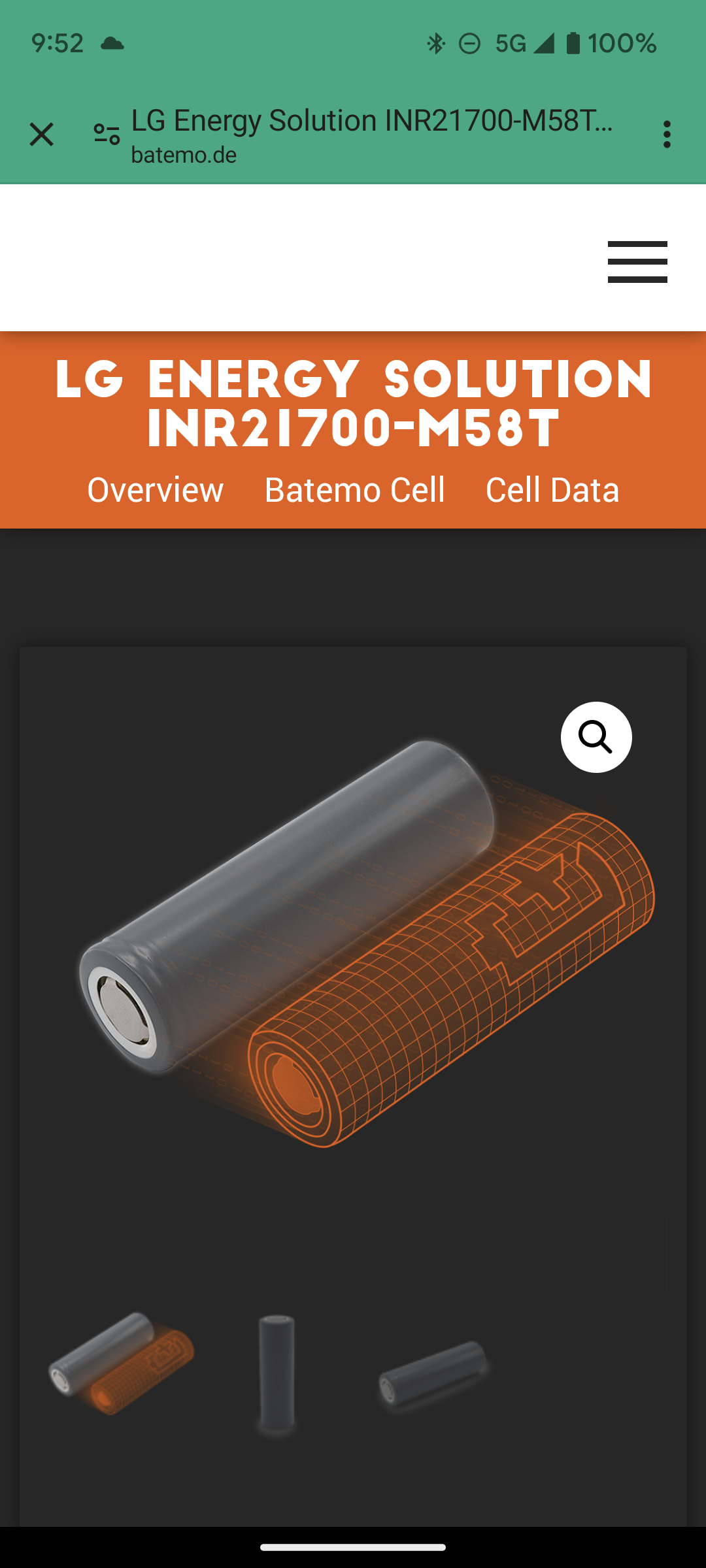

Does anyone with our CEF50 frame and big 720Wh battery know what type of 21700 cells that are being used?
SZZS and Linda are on holiday which is too long to satisfy my curiosity before I lose interest.😁
For better context, watch the short vid below on "new" cell chemistry before chiming in por favor....
Apparently m58t
TCFlowClyde
Feb 26, 2022
1,371
895
Mesa, AZ
Apparently m58t
Sorry is it an LG/Samsung/Panasonic and what amp/capacity?
The vid guy says the 21700 5.8 A cell yielding 16% more juice overall and is newer chemistry. 🤔
Yet, I see a Samsung 8.6A out there. Wondering how our new our 21700 cells battery would stack up (given same motor Voltage and battery configuration) and if it's a little hype on his end.
I know it's always risky asking this type of question, but someone has to be brave enough to ask the "dumb" questions...just for improved learning.👊
