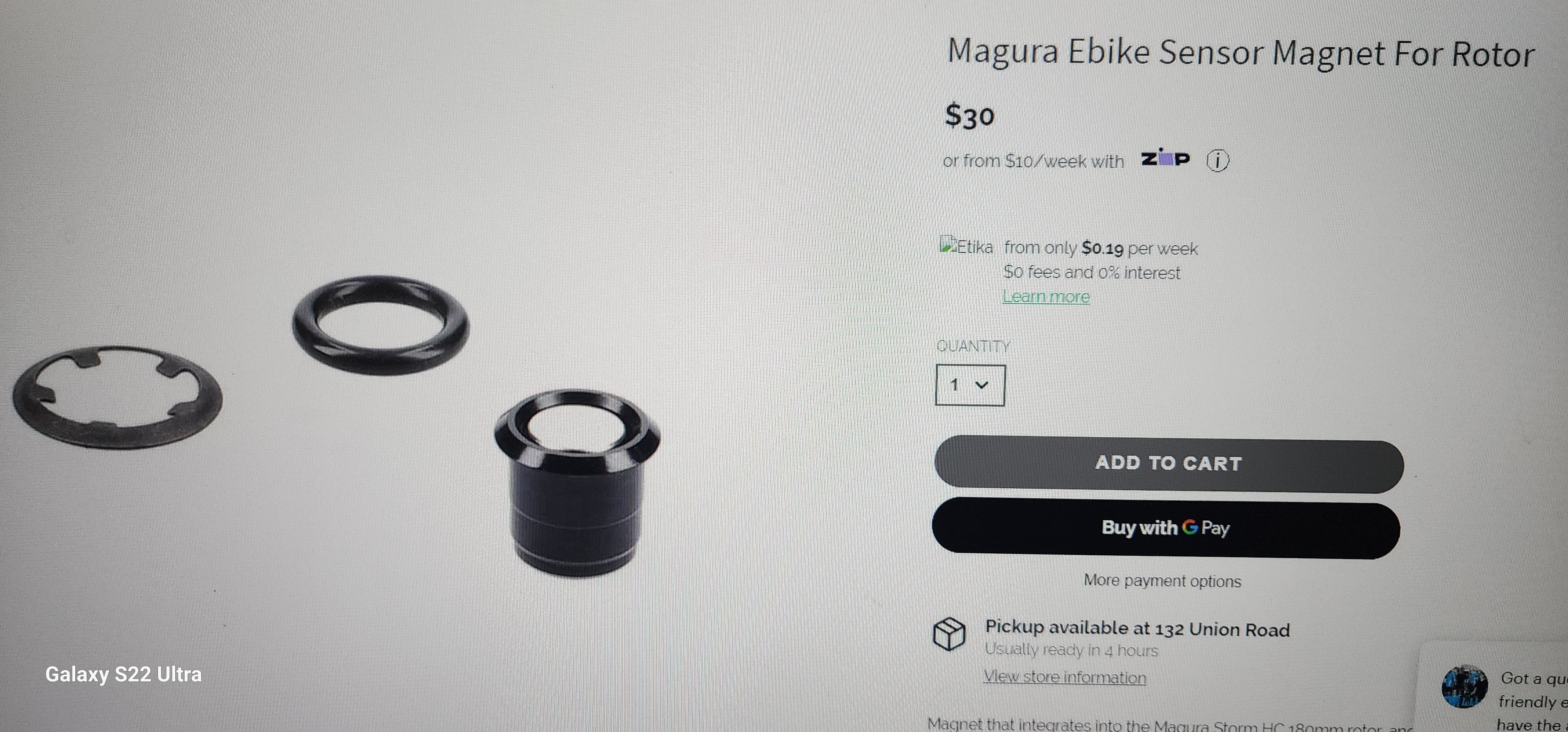

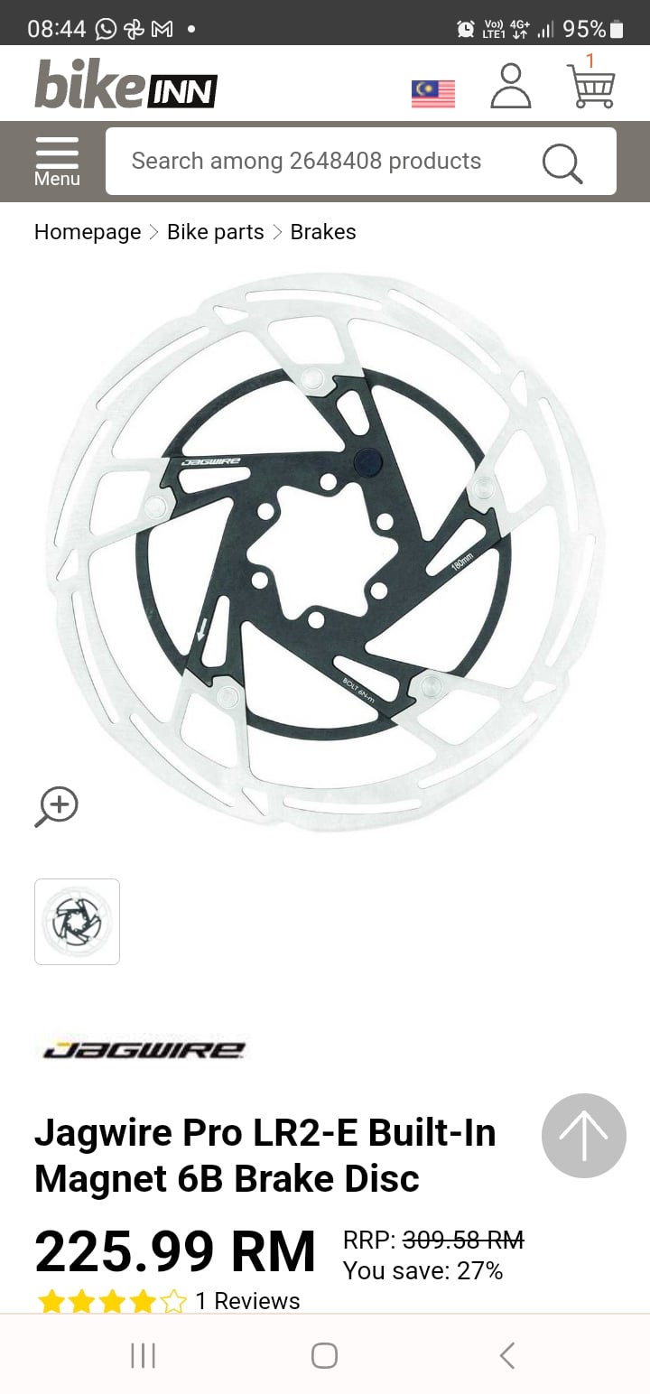

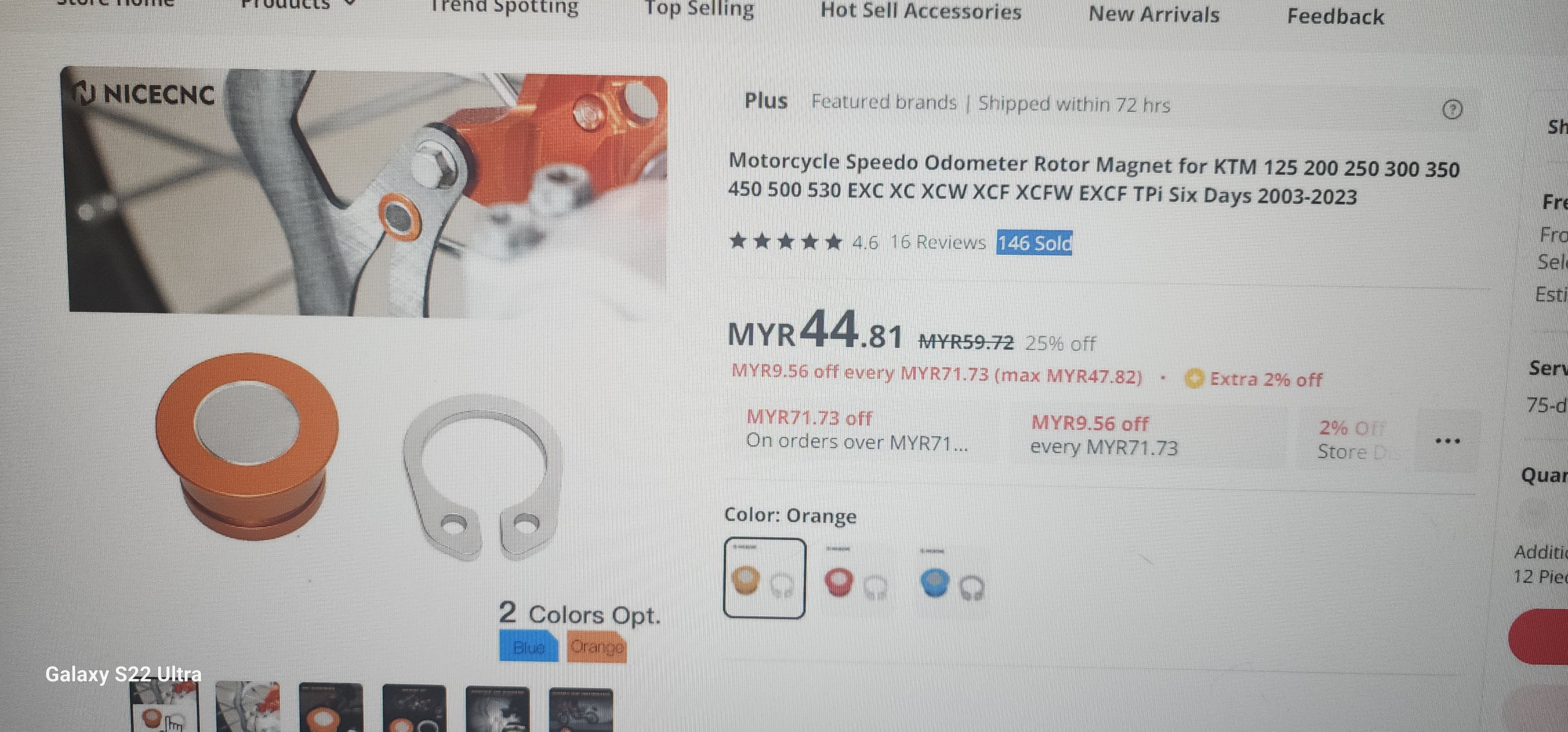

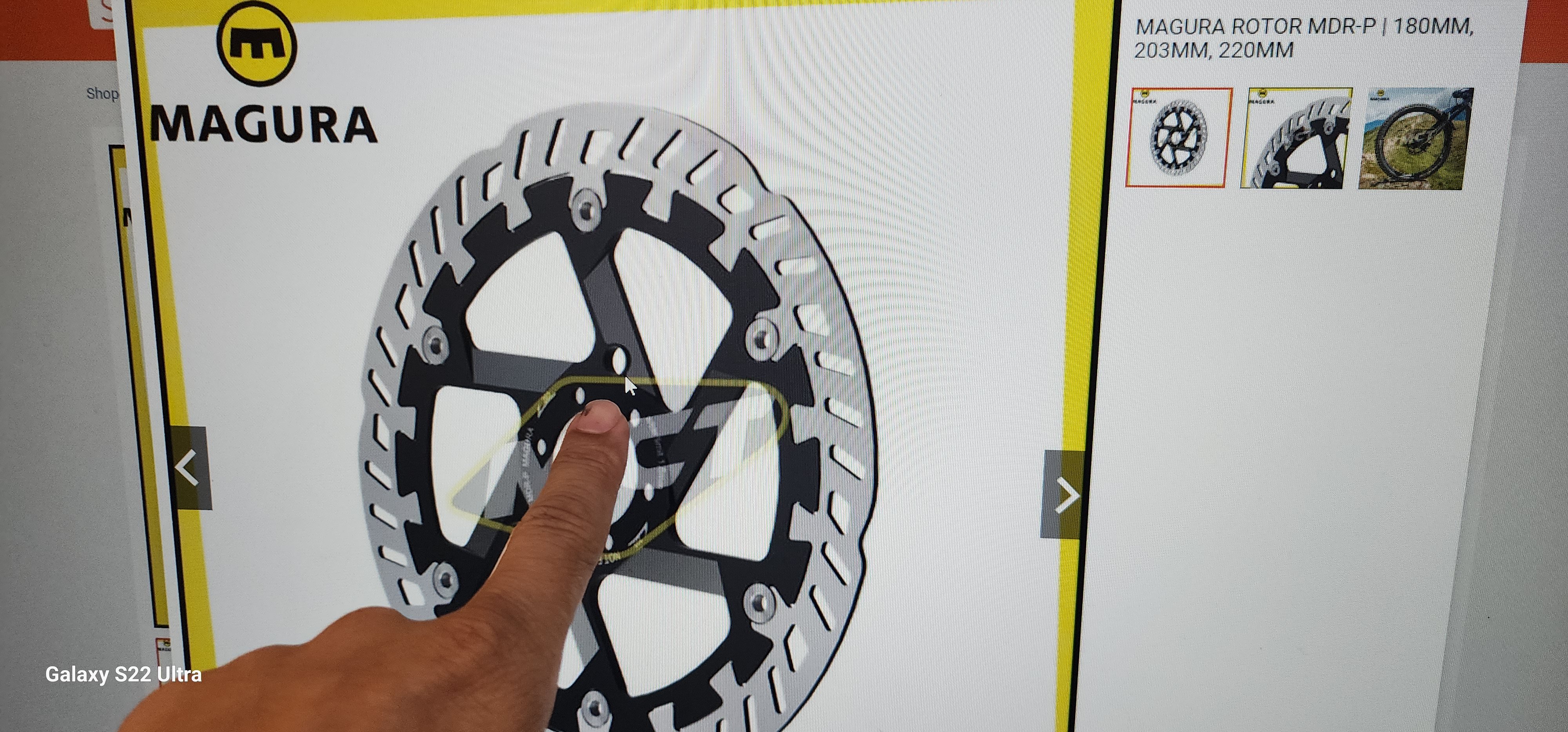

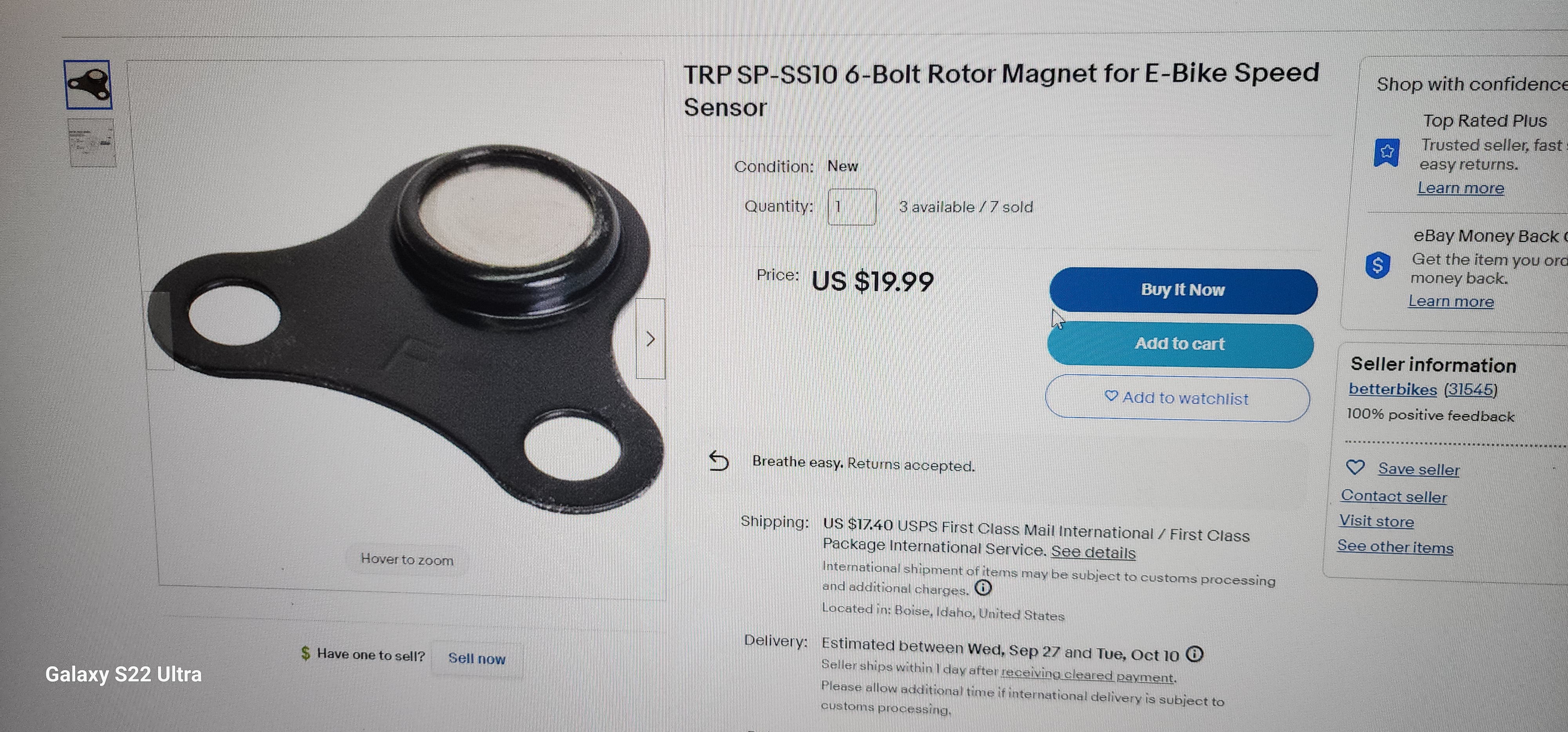

These should be universal.Hey guys! I know this is from like 40 pages back, but I'm trying to install my magnet speed sensor, but I have center lock rotors. Any suggestions?

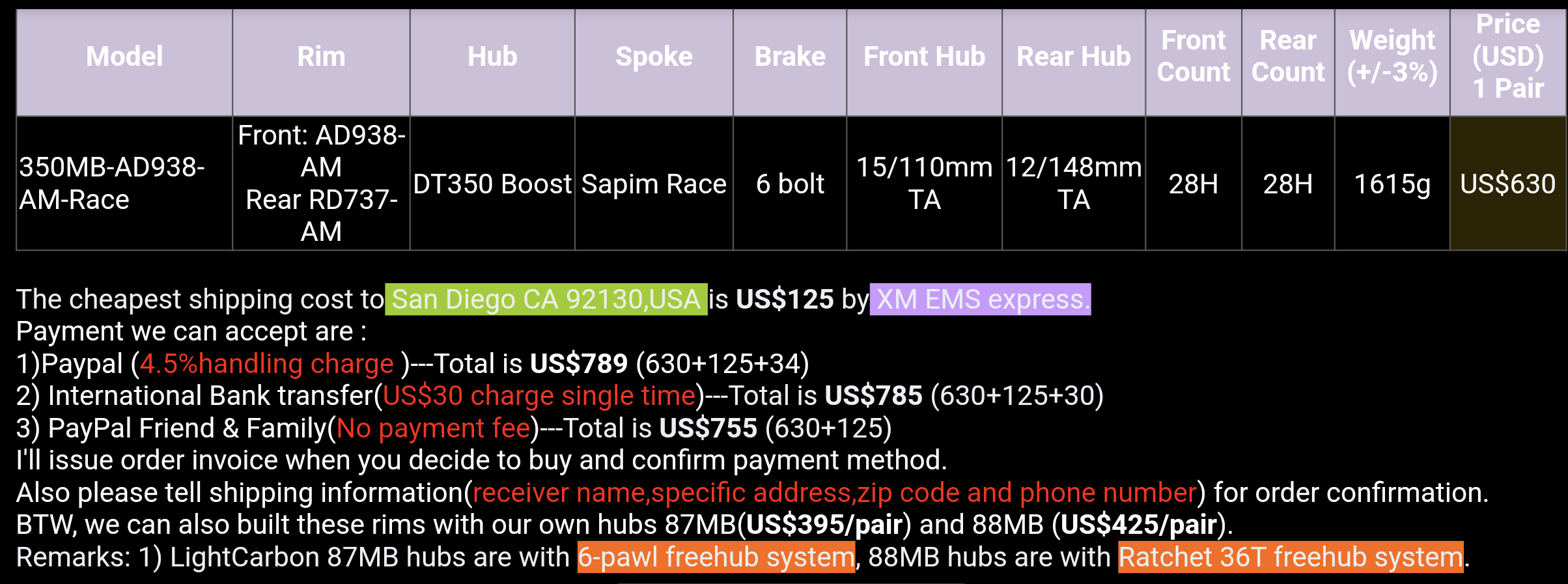

$630 for 38mm mullet with dt350s is actually pretty good price. Did you contact Jim through pm for the custom (mullet) order, or through the website?

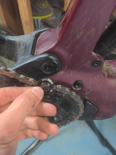

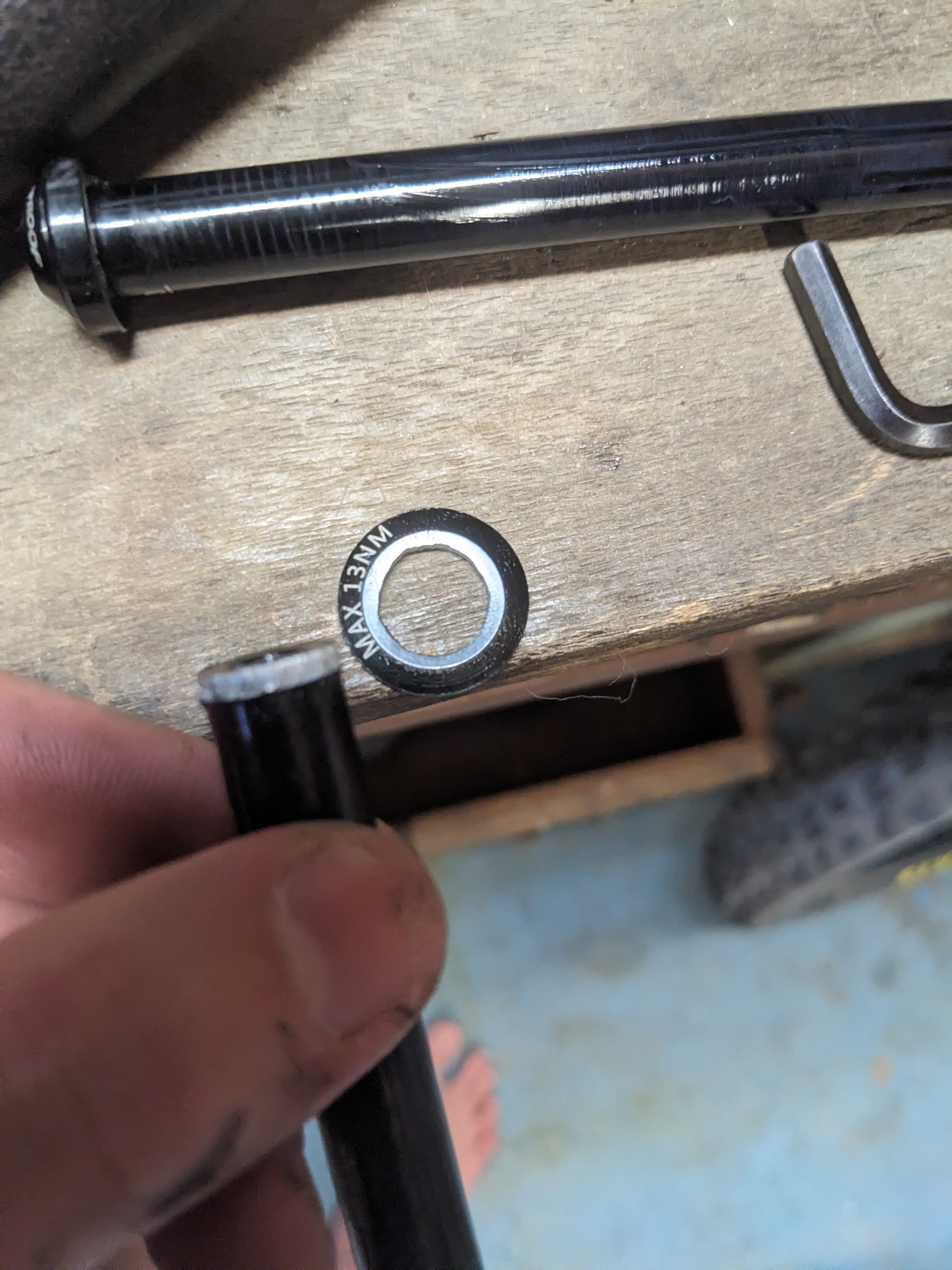

When re greasing the linkage today the end of this bolt snapped, I recommend being careful tightening them this was with a torque wrench at 12NM.
This is my only problem so far after 100km of riding. The bike feels amazing, this is my first ebike so I don't have much to compare it to other than my stumpjumper. It rides chunky stuff super well and gives you a lot of confidence on descents. I have also hit some decent sized jumps on this bike and it jumps great, super stable in the air and still very nimble to whip. My only complaint is the headset cable routing if you're going to get this frame do yourself a favour and get it with cable routing holes and maybe think about asking for some extra bolts.

The same thing happened to me. I have to figure out a solution to this. Let me know if you come up with one before I do

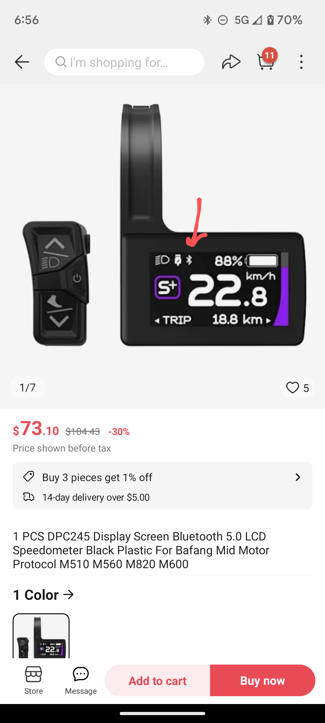

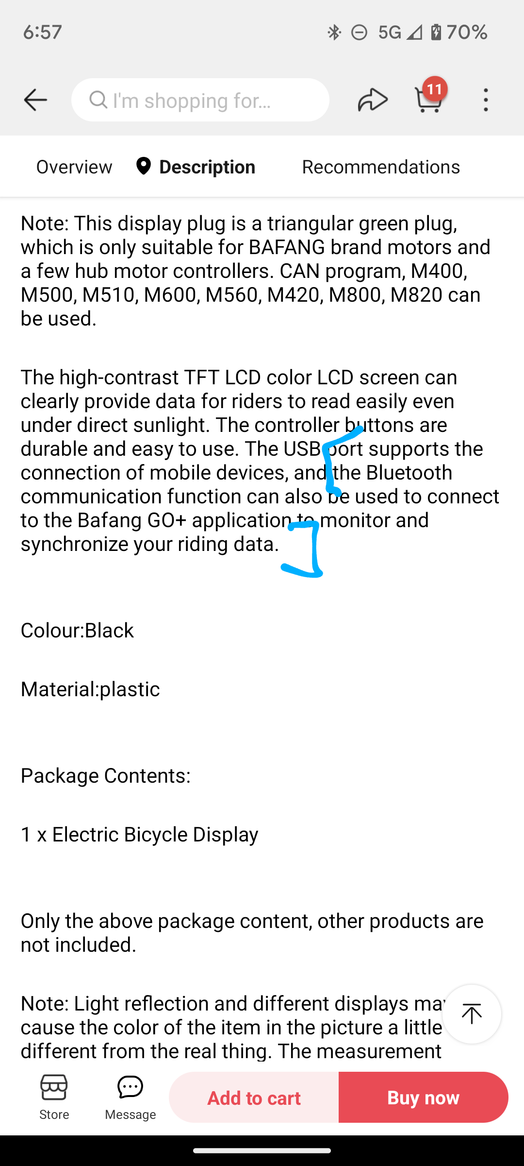

I have one on order, was dispatched yesterday. Remember you need the 245 v3 with Bluetooth 5.1 for Go+. The V2 has Bluetooth 5.0 which will connect to, but not work with, Go+ ! Anna Shens group seem to be the only people with the V3 in stock. Will write up about what it actually enables once I have it.Sorry to rehash the Bluetooth/GO+ for tuning characteristics.
Anyone have this DPC 245 display below?
Just curious to get some real-time feedback from those that have it. I'm good with my factory setup but wondering if it's worth the investment long-term.View attachment 125453 View attachment 125454
Is that Anna at Greenbikekit on AliExpress?I have one on order, was dispatched yesterday. Remember you need the 245 v3 with Bluetooth 5.1 for Go+. The V2 has Bluetooth 5.0 which will connect to, but not work with, Go+ ! Anna Shens group seem to be the only people with the V3 in stock. Will write up about what it actually enables once I have it.
It was Anna via Alibaba - can't remember the company. I suspect they sell via several outlets !Is that Anna at Greenbikekit on AliExpress?
I'd decided I was happy with most of my settings (M510 not 820) but startup angle would be nice to change. Was curious about go+ though and the idea of having a spare display and switch seemed worth it for future troubleshooting !Yeah, wise to wait before dropping another $100 unnecessarily.![]()
