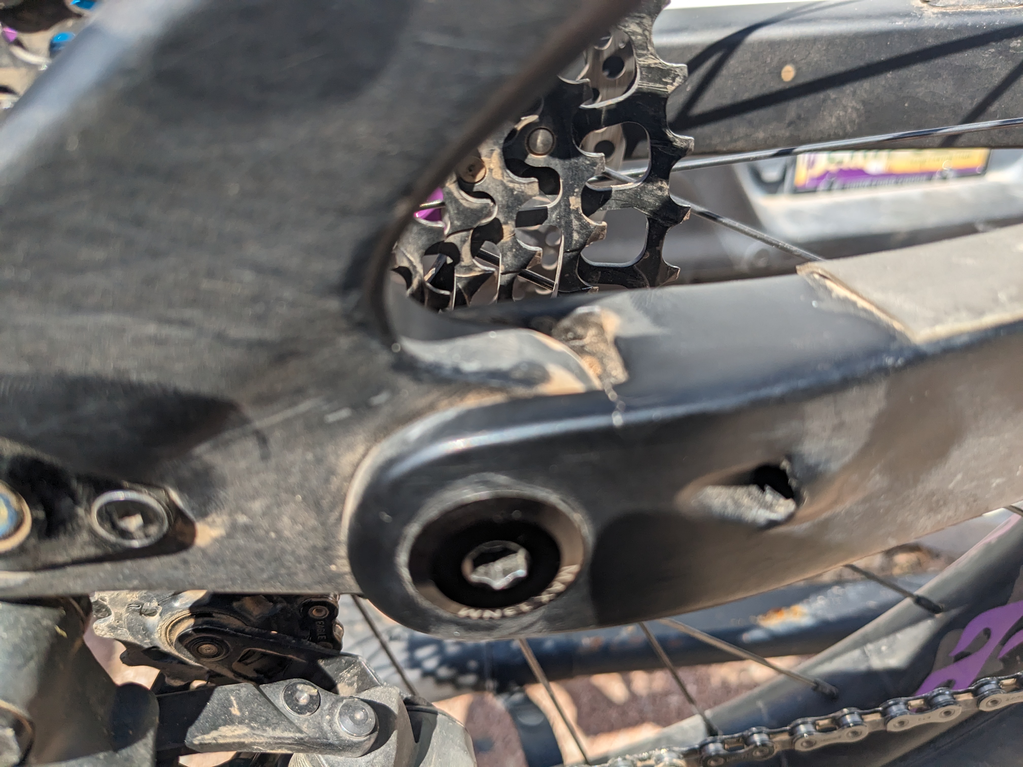

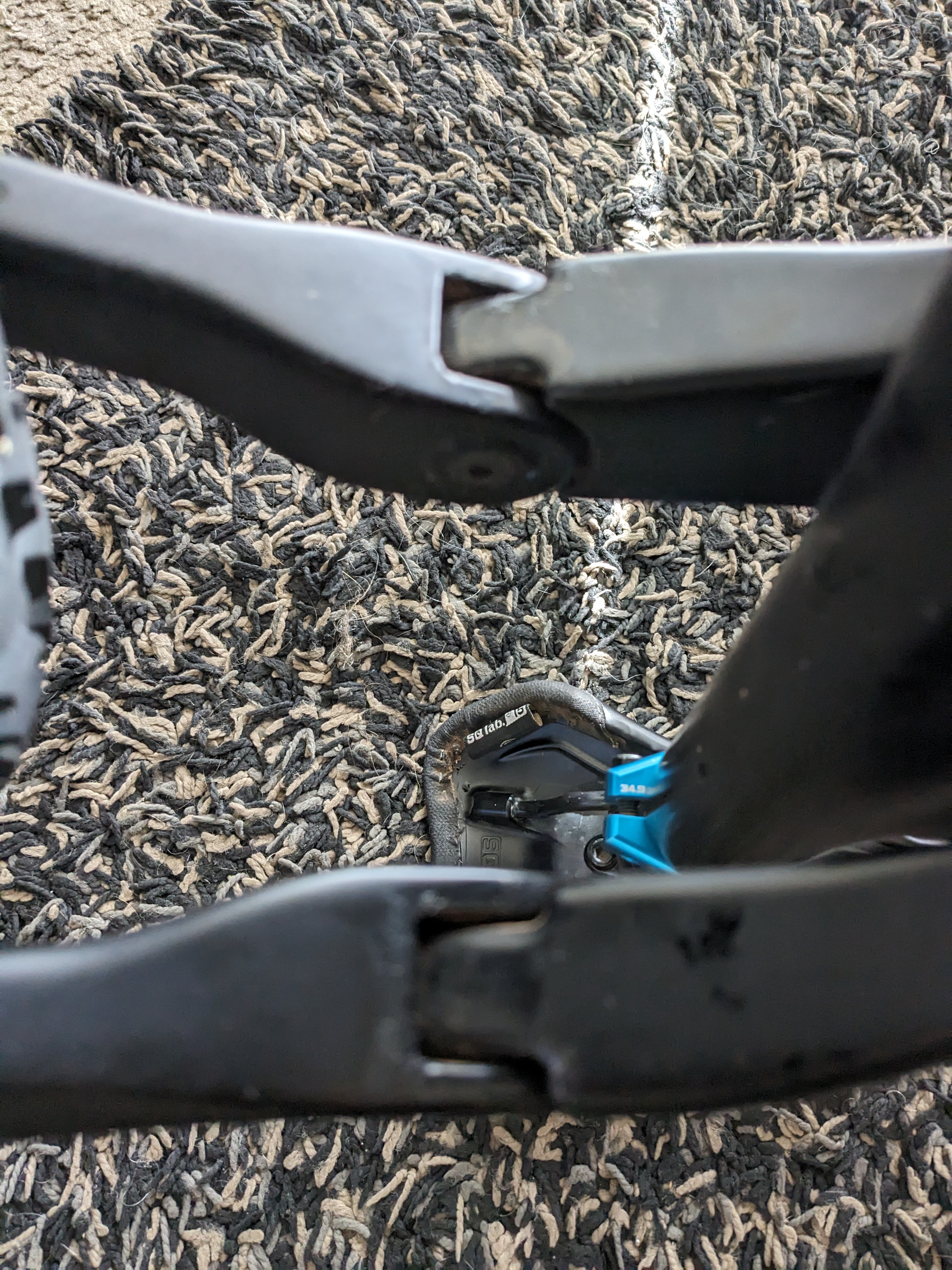

So the good news is...I made it home with the DS chainstay cracked (just partially)...so lucky it didn't break in half on trail jumps. I lost the inboard bolt and washer too and must have come off before I was loading up my bike on my hitch rack. So yeah!👍 But now I get to wait and warranty it. Probably a month. I might just patch it with my carbon kit so I can ride until the new chain stay arrives. I wonder if I overtorqued the inbound side bolt.😝🤔
I don't think this is a warranty case. You have increased the stroke of the rear suspension. But if you change the part under warranty, then I will love this company even more. I bought a CEF49 frame and an M560 motor. I really like talking to Jean. She always responds to messages on time. Other companies communicate very poorly and may not respond for several weeks.

Don't tell anyone I overstroked it.🤫 Plus, it's experimental. I still believe the 55 stroke is fine...at least with the MegNeg. Besides I don't think it mattered as much as the swingarm bolts for my weight.😁
I think I am going full custom Ti bolts for the whole triangle/swingarm. I'm a heavy rider and will probably benefit the most with heavy-duty upgrades at the pivots. 💪
Did you recall what you were doing when it happened. Was there a big pop when it happened?
TCFlowClyde
Feb 26, 2022
1,390
912
Mesa, AZ
No. I didn't feel or hear until I got back to the trailhead and loaded up on my rack. Then I jiggled the rear triangle on the rack and heard squeaking and then noticed the crack (I think it's only a hairline fracture and will pull it apart soon to get a good look at the damage🤞) and the missing inboard mating bolt and washer.
Honestly, I think I overtightened them ( left my torque wrench at home), because they were loose a few rides prior. I should've re-tightened it when I got back from my recent camping trip. Laziness on my part.😝

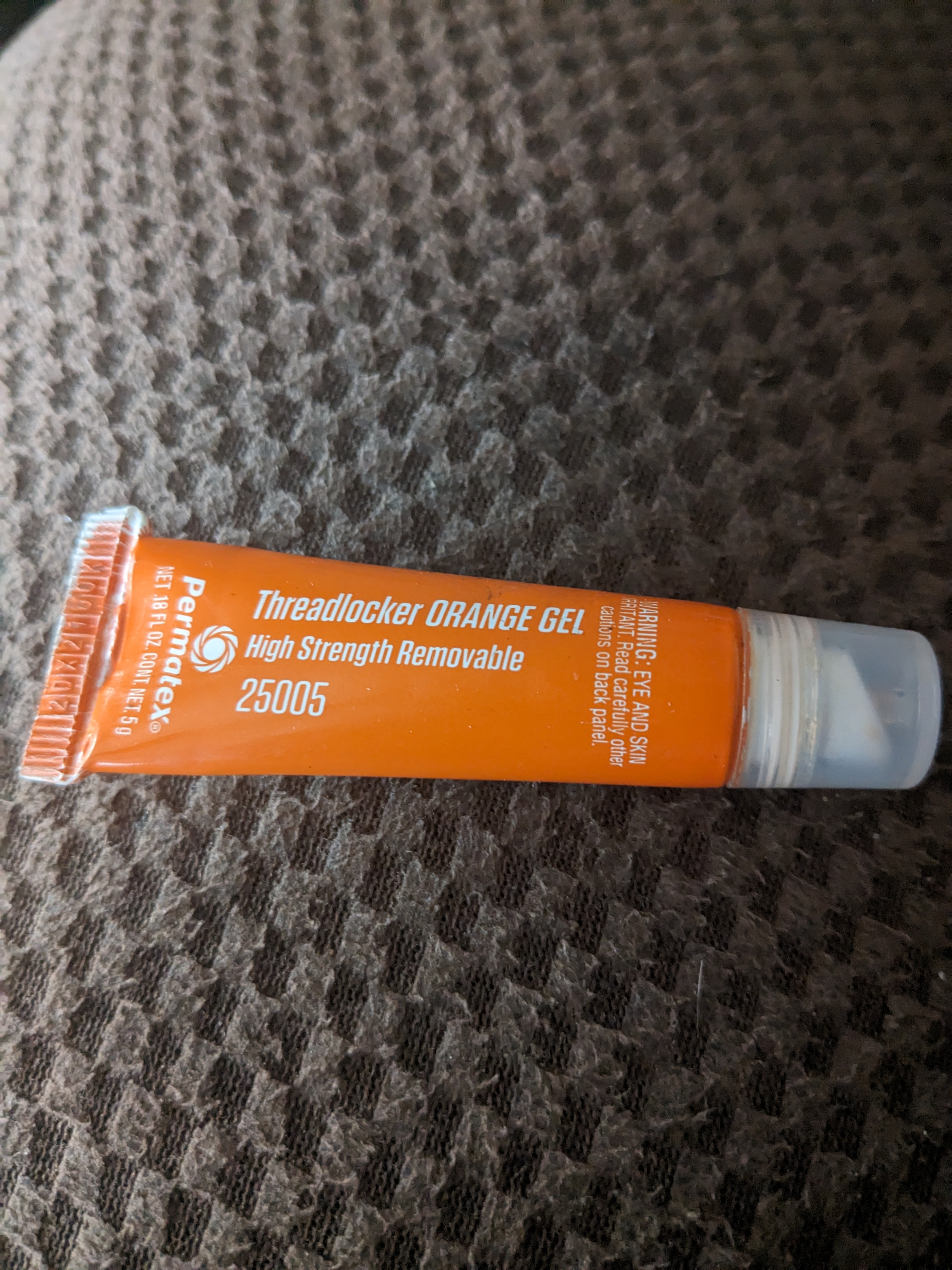

I'm now using a new orange gel thread locker 3x more lock-down power than blue, but still half of red apparently.
Also, kinda what I get for being sloppy on tailwhips when landing baby jumps.😁
i just don't trust the OEM mating bolts now, it's non-standard and think that might be my specific main issue, along with heavy rider load. So, going custom Ti the whole lot of 'em on the rear triangle. It should be more durable in the long run for my needs.💪

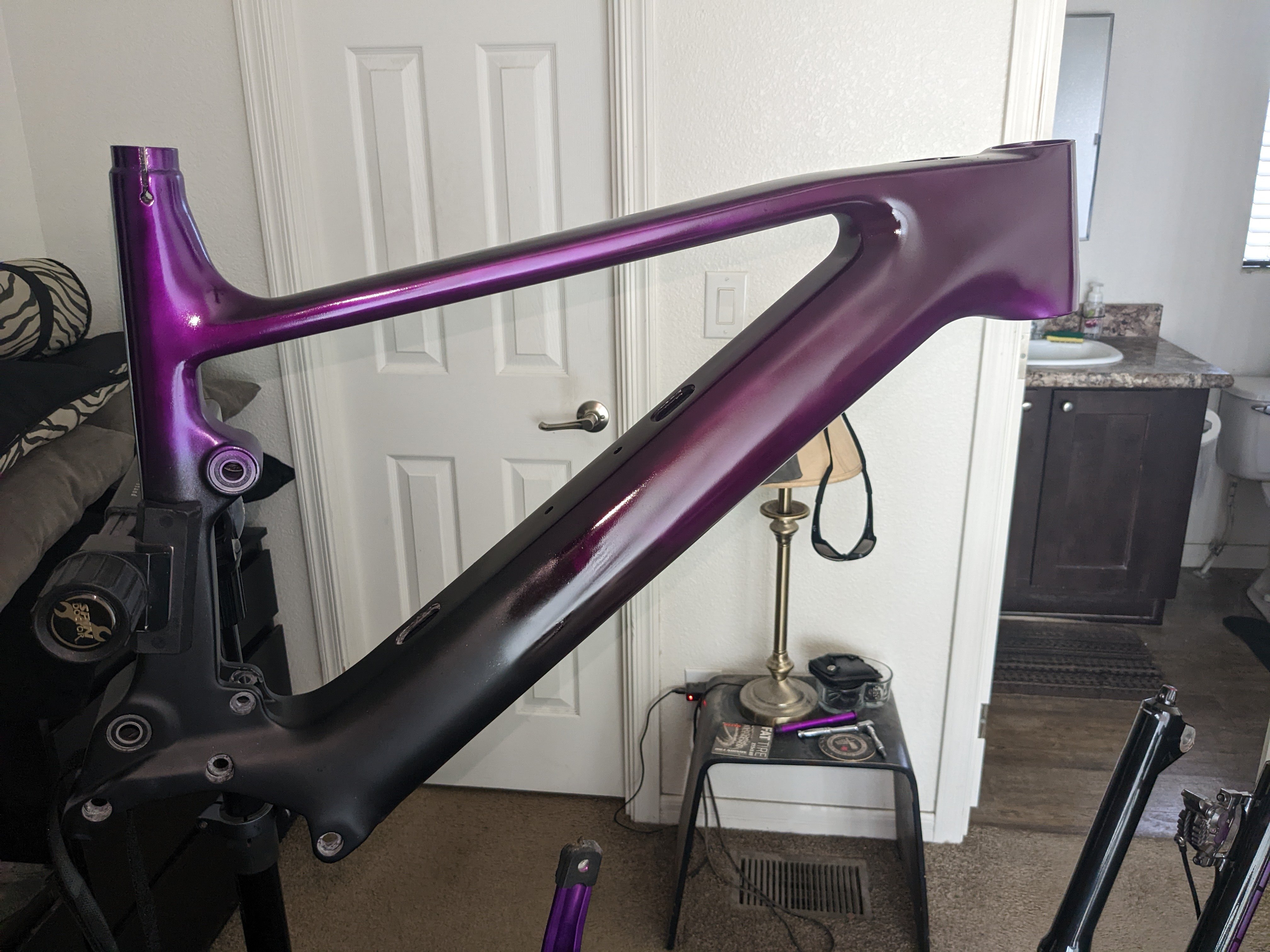

Just got back from a week' s long riding trip. The trail-system (Phil's World, Cortez, CO, USA) has some fairly flowy tech with scary, rock slab drops on some lines that I survived...barely!🤙
Before I left, I painted the rocker arm/linkage area with a thick coat of black paint pen. No marring, pitting, or chaffing after a week of hard riding. 👍
Seems like the 55 mm stroke works with my 210x55 RS MegNeg.💪
I just painted my warranty front triangle before my trip. I'm now ready to disassemble my rear linkage and paint it. I'll inspect it further for any cracks, weakness etc. and report on it if something is questionable.🤞

Yap at the moment coil shock may not work but linda told me they are redesign it to make it work on coil. Sorry typing error, i am getting 210x55 not 200.
I'm satisfied that the 210 x 55 works...at least for me.😇
No paint flaking in the past 5+ weeks since the touch up paint with the correct custom Ti pivot bolt and the main pivot bolt issue The OEM bolt was 10 mm too short and the mating screw (2 of them) kept sheering off causing paint flaking at swingarm joints it appears) as I was able to ride it back lamed to my truck. 😄
I interpret that as no friction points with my Megneg 210x55 mm!🤟
