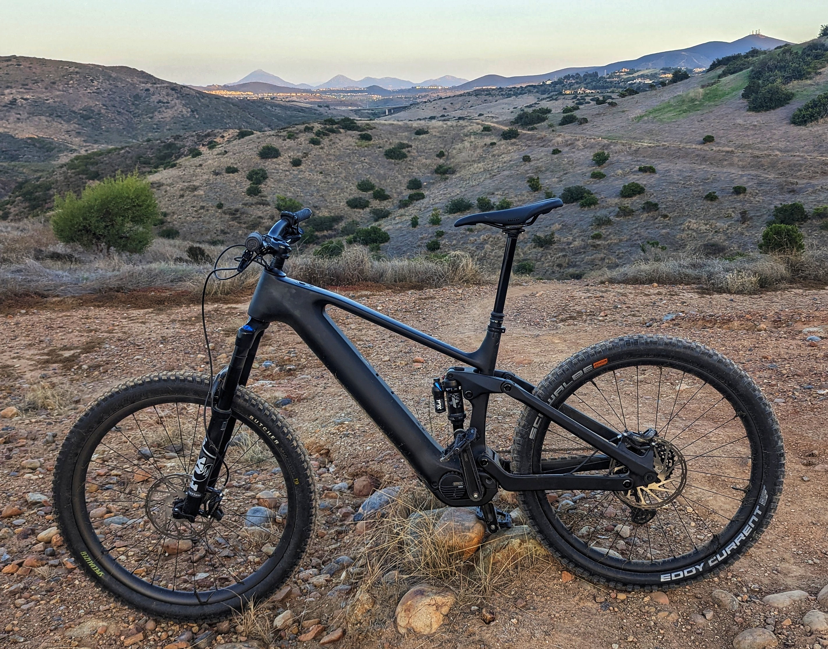

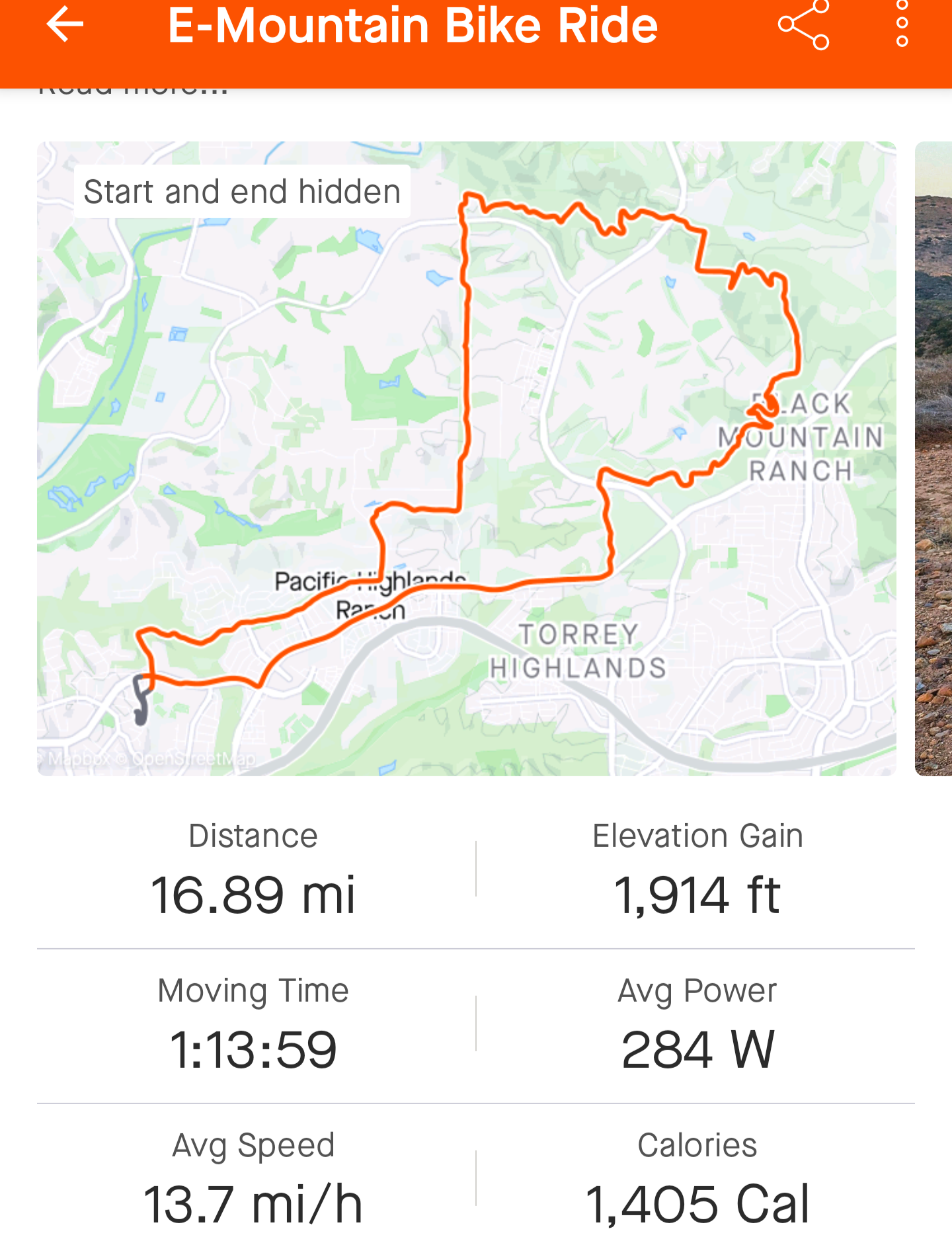

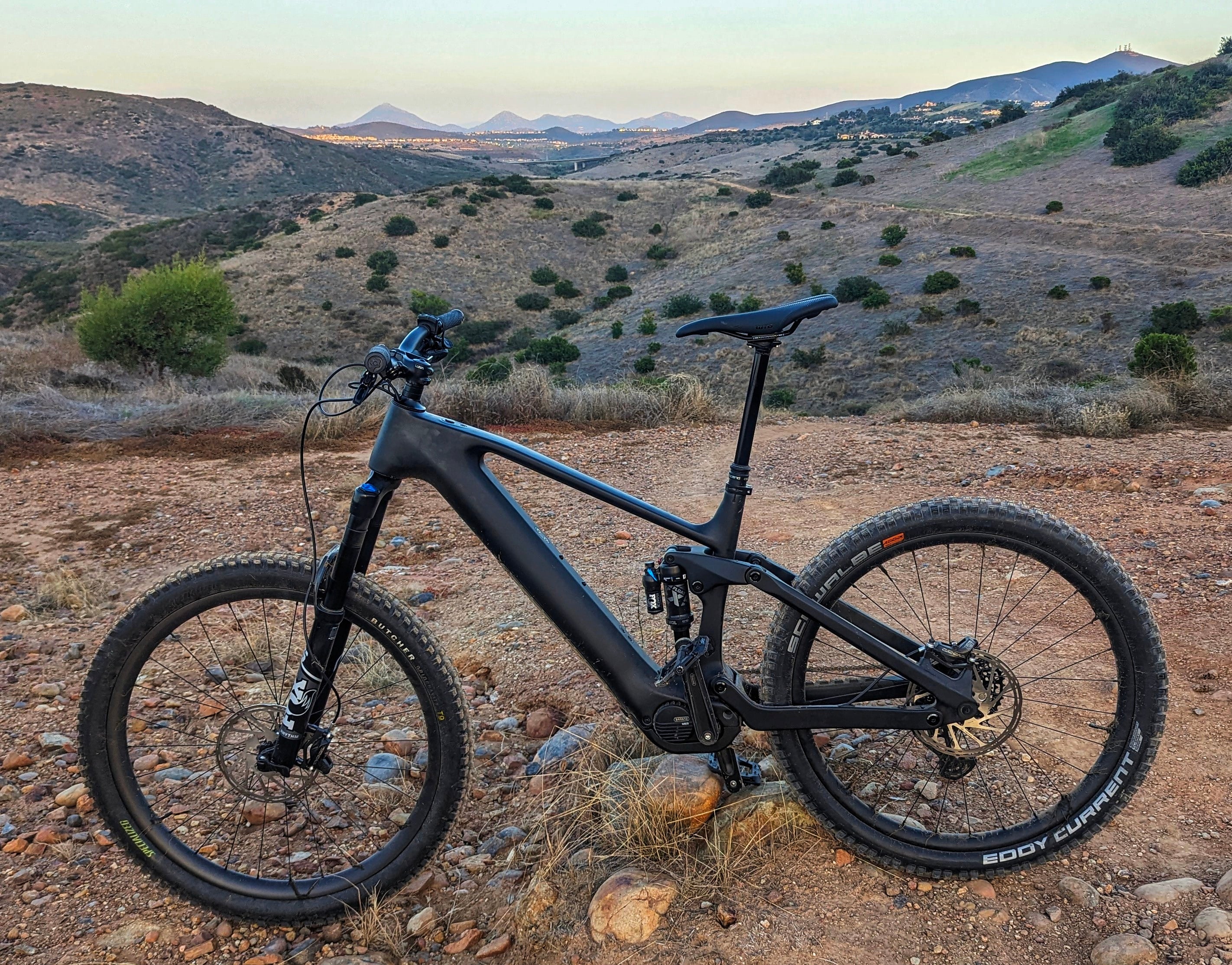

My m820 CEF 50 size L build 720w battery. Fox 36, Rhythm Fox float X (new from Levo takeoff). Lightcarbon carbon enduro wheels 29/27.5 with DT Swiss hubs, SRAM Code R brakes with 203mm rotors(new takeoffs), SRAM AXS GX, 11 speed SRAM GX cassette, Nukeproof carbon bar, 200m TranzX dropper. Scwalbe Eddy Current rear and Spez Butcher Grid Gravity front tires setup tubeless. 22kg final weight, target was 20kg
1st ride notes:
17miles, 2k climbing with 71% battery left.
Fox suspension is awesome. Plows thru the chunky gnar like hot butter and on my typical jumps feels great. Feels lighter than my levo, more flickable. Love the low seat tube height as I can really slam the seat on the steeps. Geometry feels similar to my levo.
Negatives, motor whines under load big time, have to have high cadence or it's not going anywhere on the steeps, rode in S+ equal to 4 and had to hit boost on super steeps. I went for 11 speed on this build for a beefier chain then a 12 speed chain as I never used over 10 in other bikes but with this "light" motor you will use the 12th gear. There is a clunk in the motor on downhills. Probably similar to ep8? There is no kick when you engage like Bosch or brose. Think the tuning is for a commuter bike. Need to see if we can play with it. I did my normal test track and I had to use alot more legs to do it. On the tarmac it's fine, that's why I think it's tuned for commuter riding.
Carbon rims and dt Swiss hubs are epic. Rolls fast. Sram code r brakes are good but need to re step up. AXS shifting different then cable shifters dynamics, need to re learn as I'm not smooth yet.
Net net, super fun pointed downhill, more work going up with wrong tuning on motor for technical eMTBing.
1st ride notes:

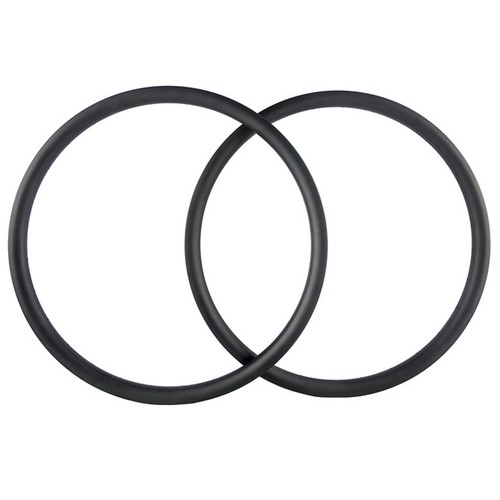

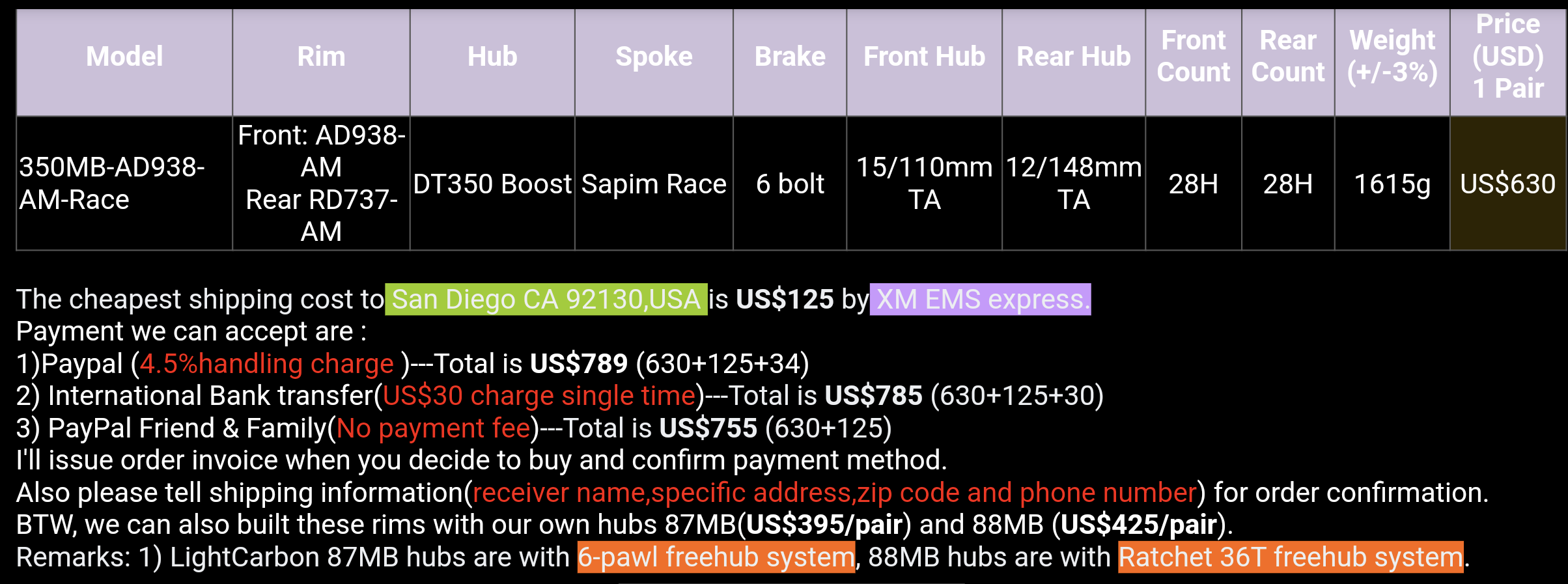

Keen to hear more about the rims. About to pull the trigger on Jim's rims but haven't found anybody else that has bought them.
Which spec did you get? (Rim and spoke type).
calvintys
Sep 12, 2023
278
276
Malaysia
Base on my experience any Chinese carbon rim will stronger then any branded alloy wheel. I try before hammer a branded alloy rim n its dent so easily without much afford BUT cheap carbon rim, u need to hit it hard in order to crack it.

I have built 4 sets of wheels by this vendor. Very happy with the product and service. You must specify the number of holes or you will get 28h by default.
