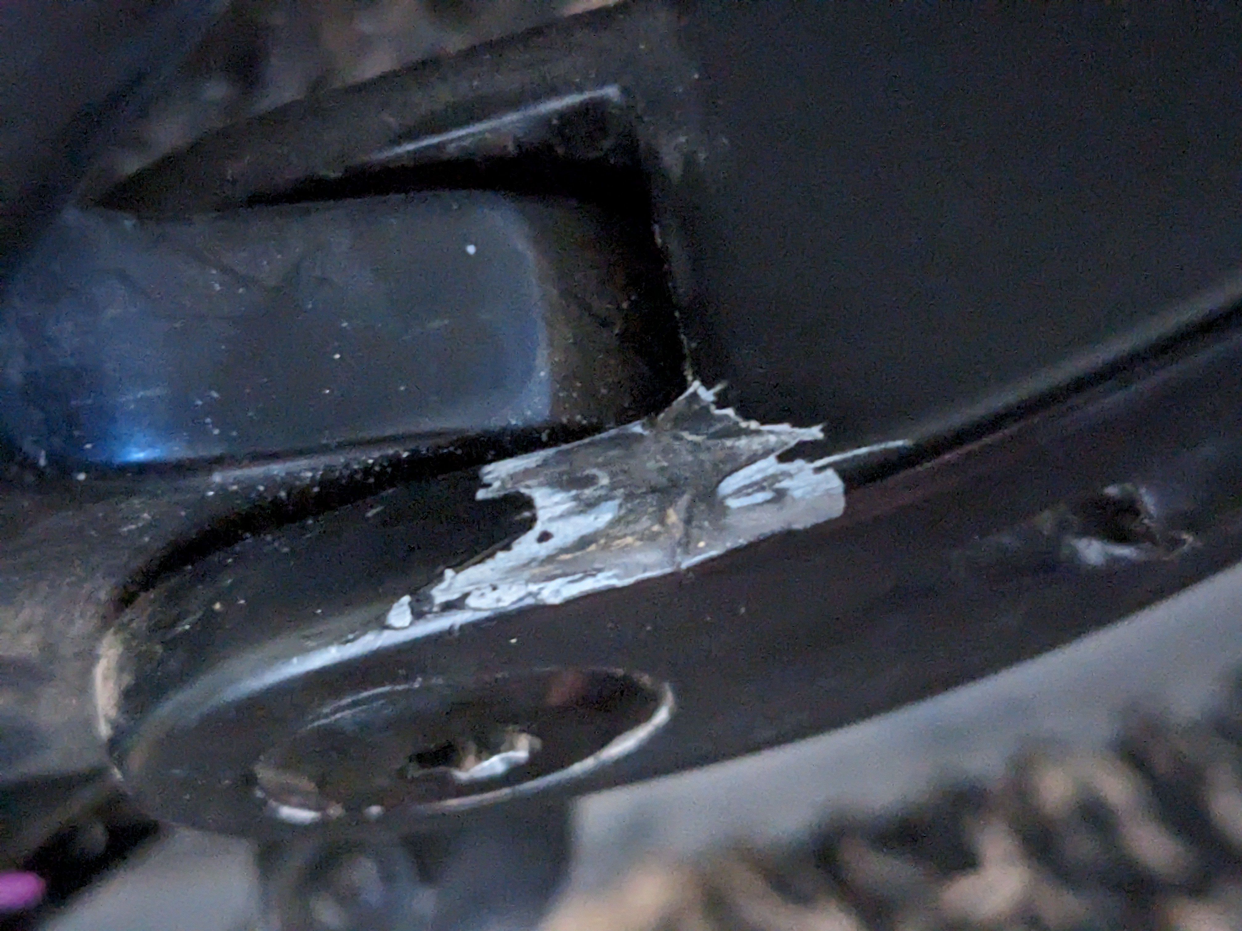

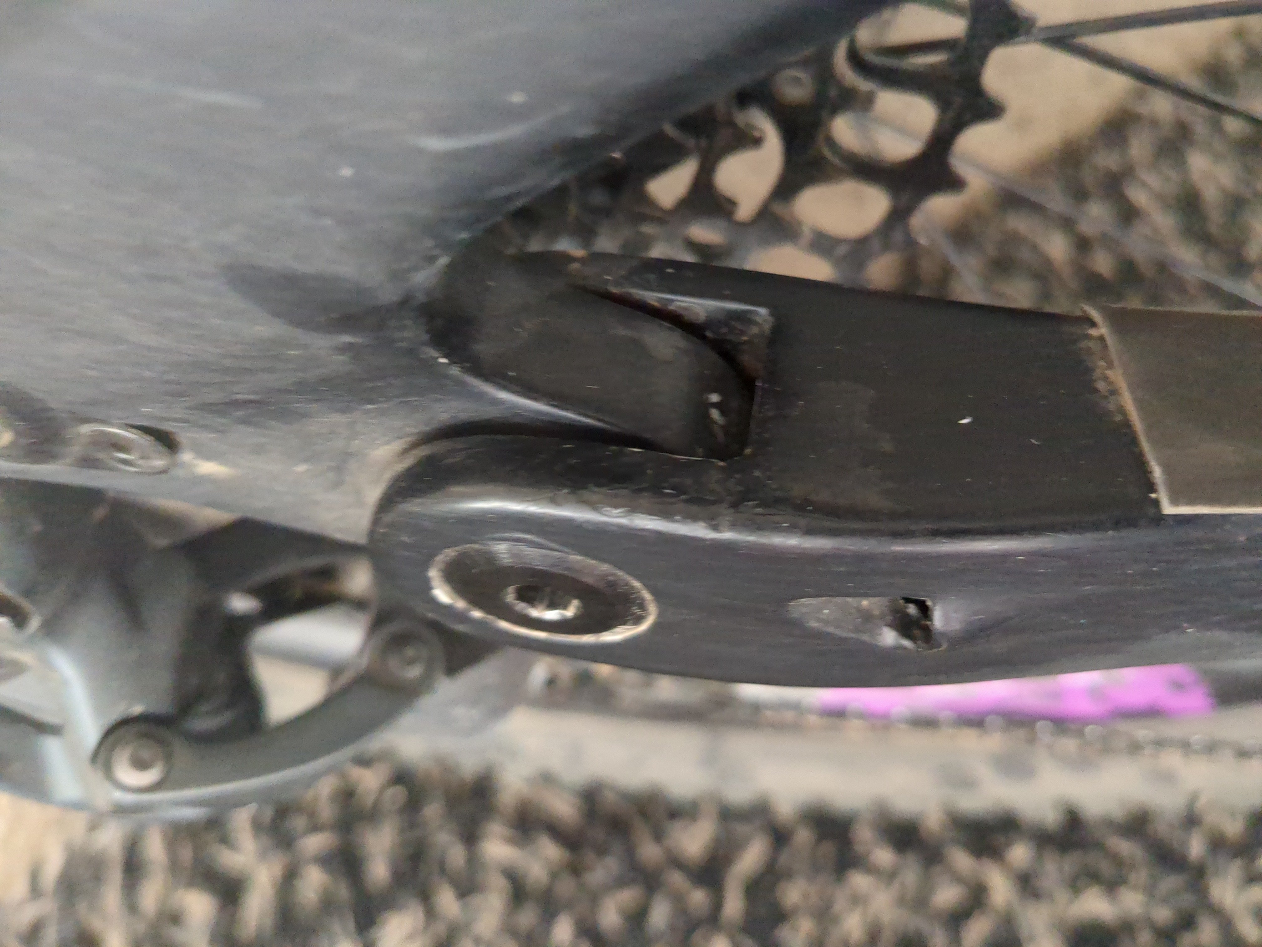

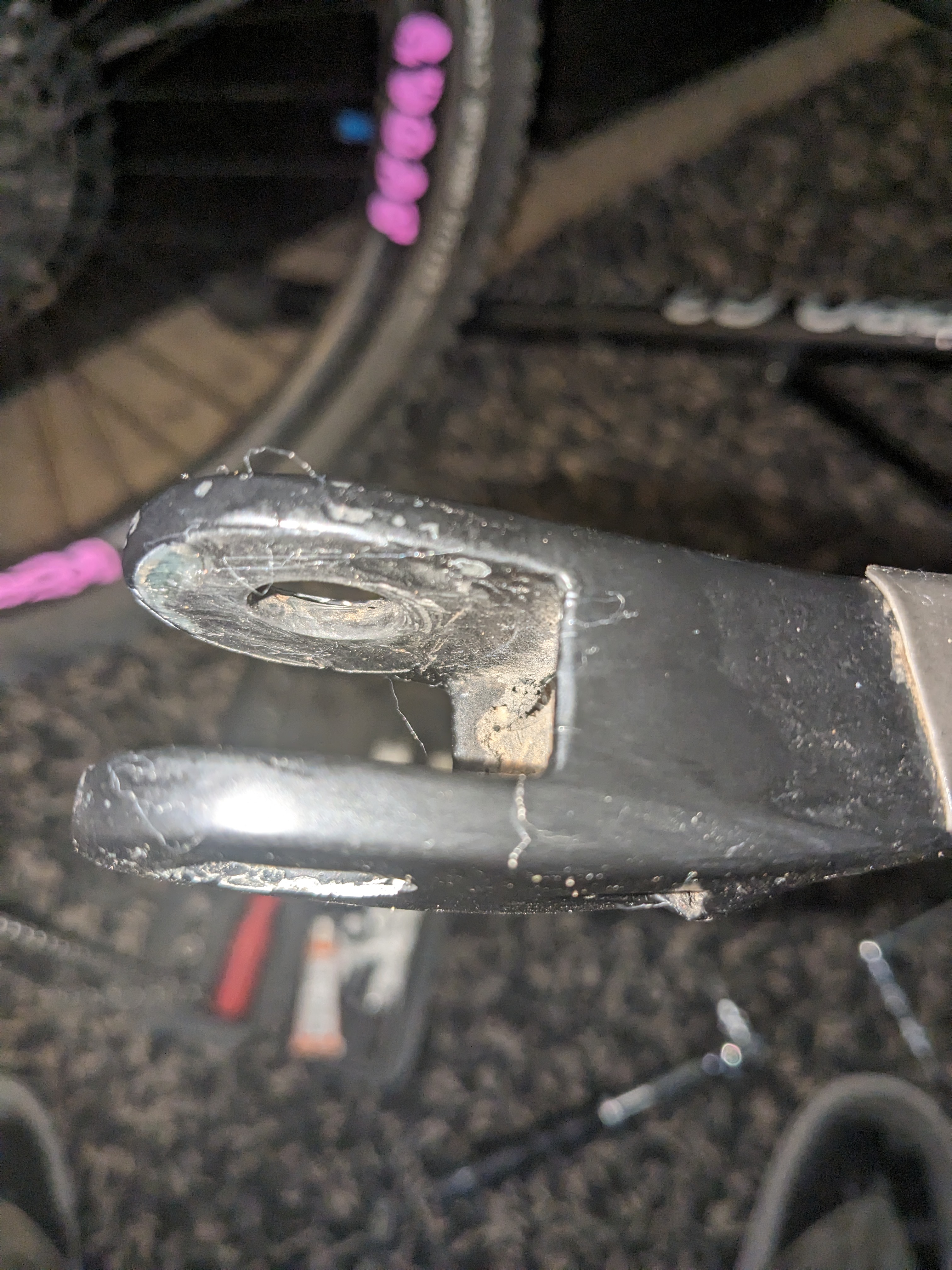

For what it's worth...Quick warranty followup on "cracked" chainstay at the drop out.
First off, after a a few weeks of convincing, SZZS did agree to warranty the CEF50 chainstay with a replacement for just shipping $24 USD. 🤛
So, the Quality Control person asked me to shave off a few layers of paint and carbon to probe the crack depth. After, it looked superficial. They suspected that it might have been a thin air pocket in carbon layup.
Maybe...🤔
But since then (4 weeks) of riding it (XC trails) with the new paint, it has NOT started cracking again. So, it could indeed be just a minor manufacturing flaw.
Either way, it's cheaper to replace it rather than speculate that the old chainstay might hold under future, greater distress. 💪
Hopefully, the warranty replacement is only a few more weeks away. Because I'd like to finally paint the stays to pair it with my warranty front triangle...finally the weather is cool enough to DIY spray the clear paint and clear coat.🤟
Maybe...🤔
Better to be safe than sorry. Not to mention, the frame's covered for 2 years. If I were in your shoes, I'd do the same thing👍🏿

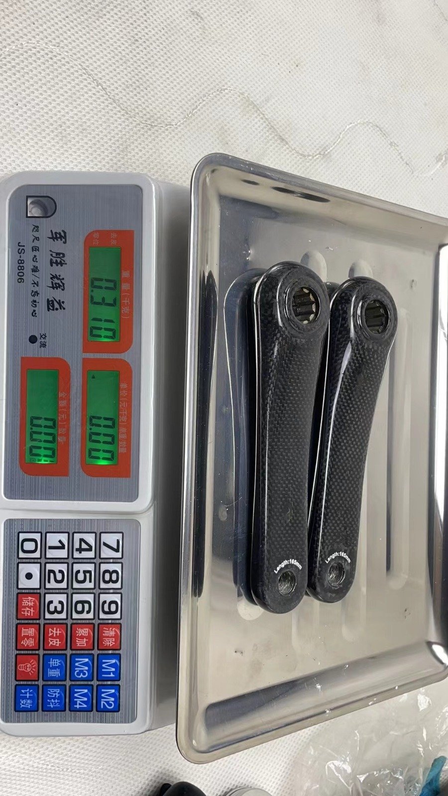

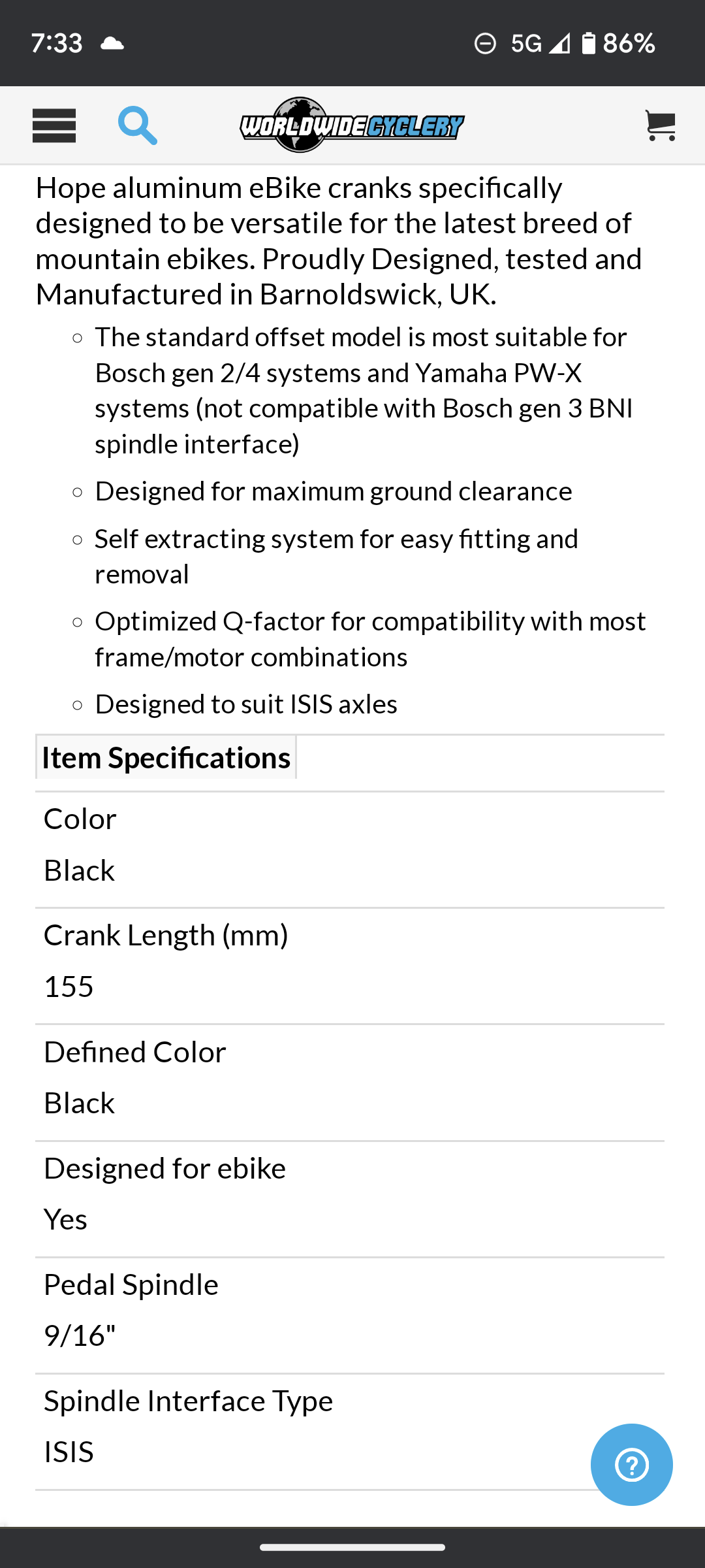

I use these ISIS interface cranks.
The offset is "standard", but I'm sure there is space for a more narrow, Q-factor offset.

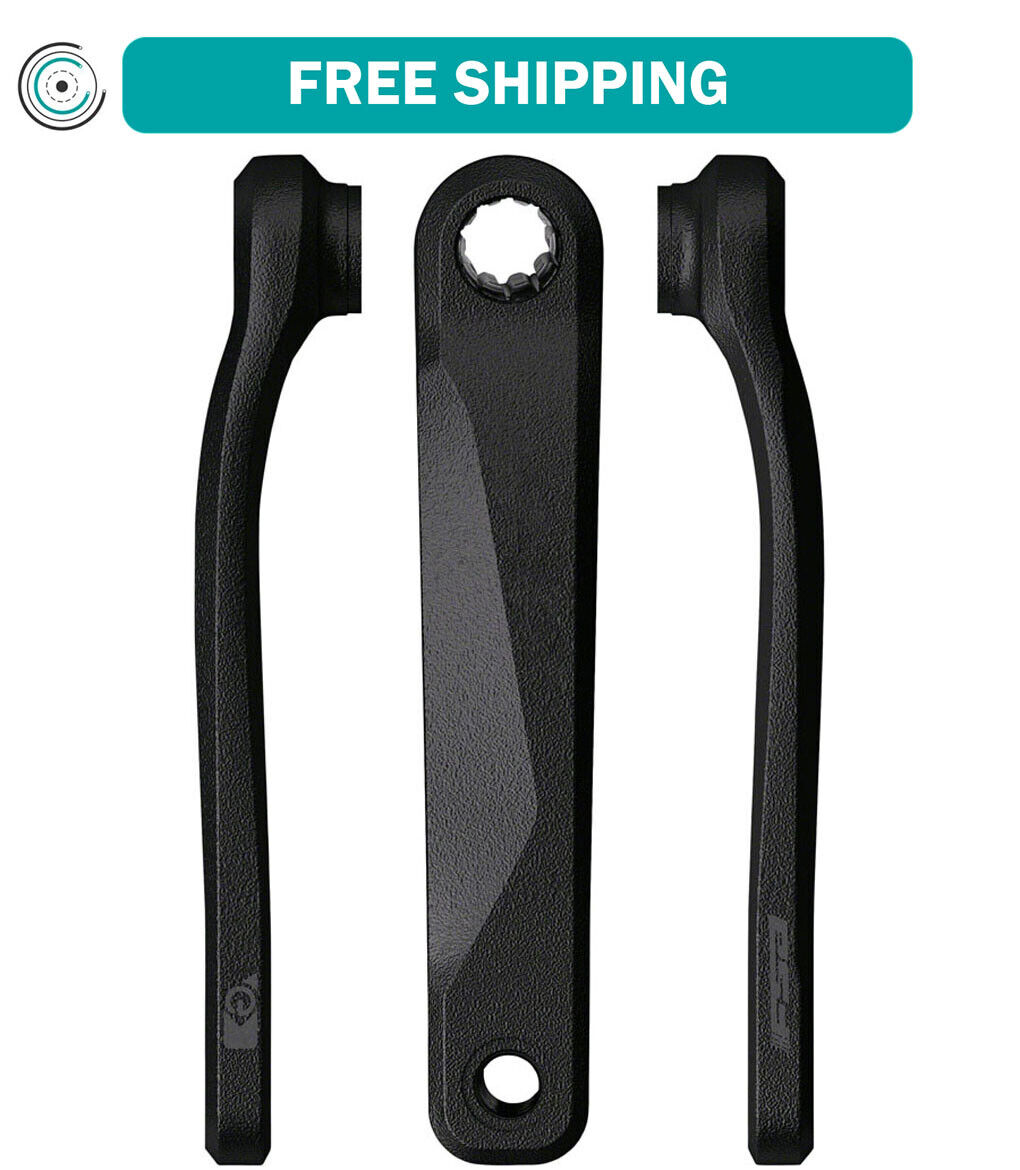

I am now using the FSA
Full Speed Ahead CK-220 Bosch Gen 4 Ebike Crank Arm Set - 155mm, ISIS, Black​
They fit perfectly and I could get them in 155. I really like the Miranda but no 155 currently available.
Nice. How much?
The 155 mm crank length really seems to help minimize pedal strikes. I run a generous sag in my rear travel and would consider 150s, but with the exception that when I'm in eco-mode with a spent battery...less leverage to crank efficiently to get home. So, the 155s seem to be the happy medium.💪
Plus, save some grams with shorter cranks and even shorter dropper length needed as well. I run a 150 mm dropper now. On my analogs, I ran a 175mm dropper/170 crank arms.
Shorter, less metal = 👇g.
Slightly cheaper dropper too!💸
