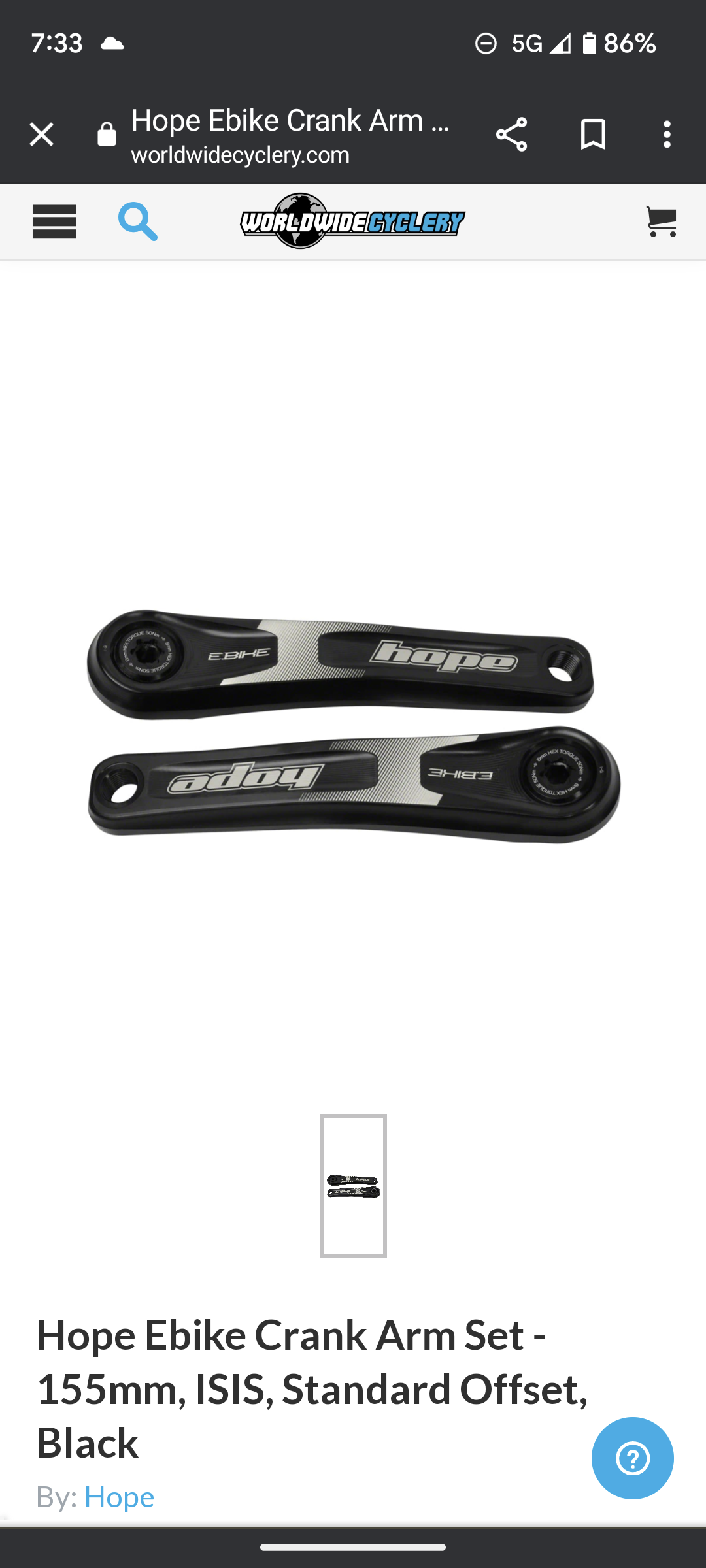

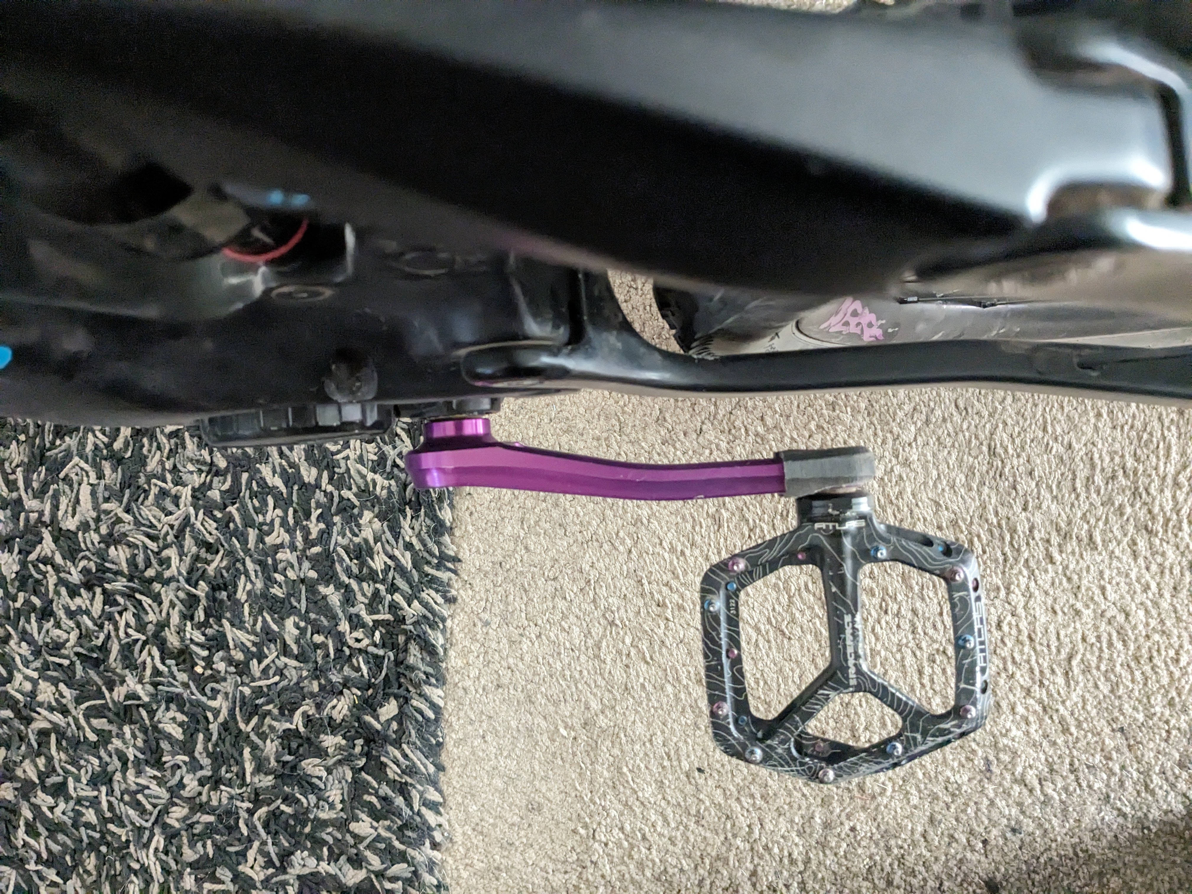

The 155 mm crank length really seems to help minimize pedal strikes. I run a generous sag in my rear travel and would consider 150s, but with the exception that when I'm in eco-mode with a spent battery...less leverage to crank efficiently to get home. So, the 155s seem to be the happy medium.💪
Plus, save some grams with shorter cranks and even shorter dropper length needed as well. I run a 150 mm dropper now. On my analogs, I ran a 175mm dropper/170 crank arms.
Shorter, less metal = 👇g.
Slightly cheaper dropper too!💸
With shorter crank I would say you need/are able to use longer dropper post for maximum clearance.

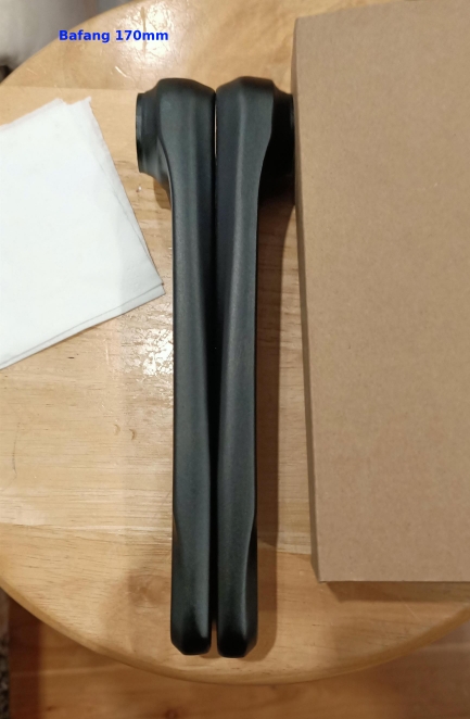

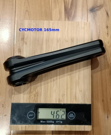

I got these cycmotor 165mm ISIS crankset
They fit perfect.
These look to have the same Q factor as the original Bafang cranks that came with the bike. Very "straight"
Unfortunately only comes in 165mm or 175mm

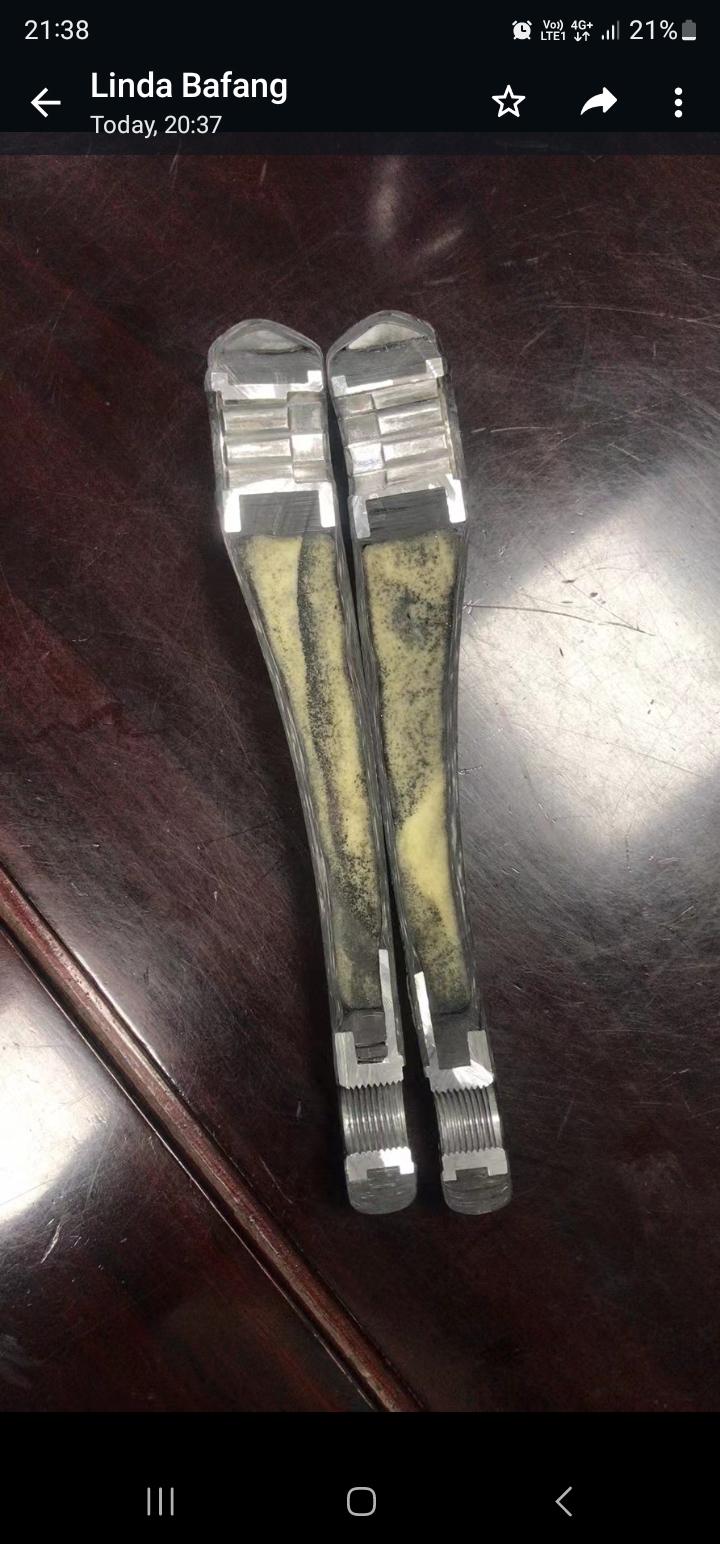

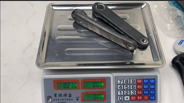

Please contact linda +86 19313711220 , carbon crank size available its 150,155,160,165,170
OK. it's linda lv from
Shenzhen Zhaosheng Carbon Fiber Technology Co
they will have the exact price next week normally. I wait my frame to the end of the month. i will see after the exact length needed. They work also on other crank arms more lighter (in develloping) destinated to XCor road use

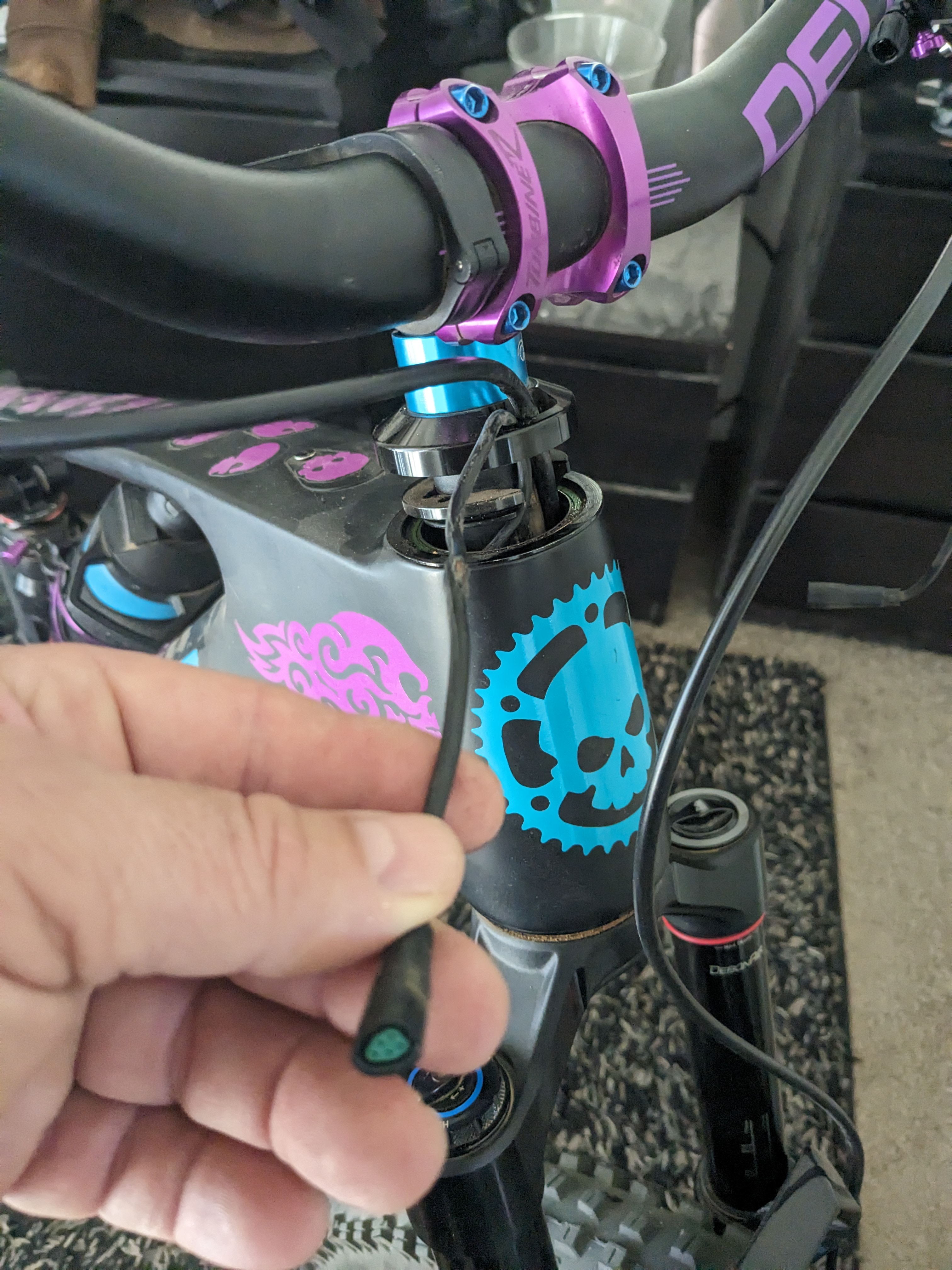

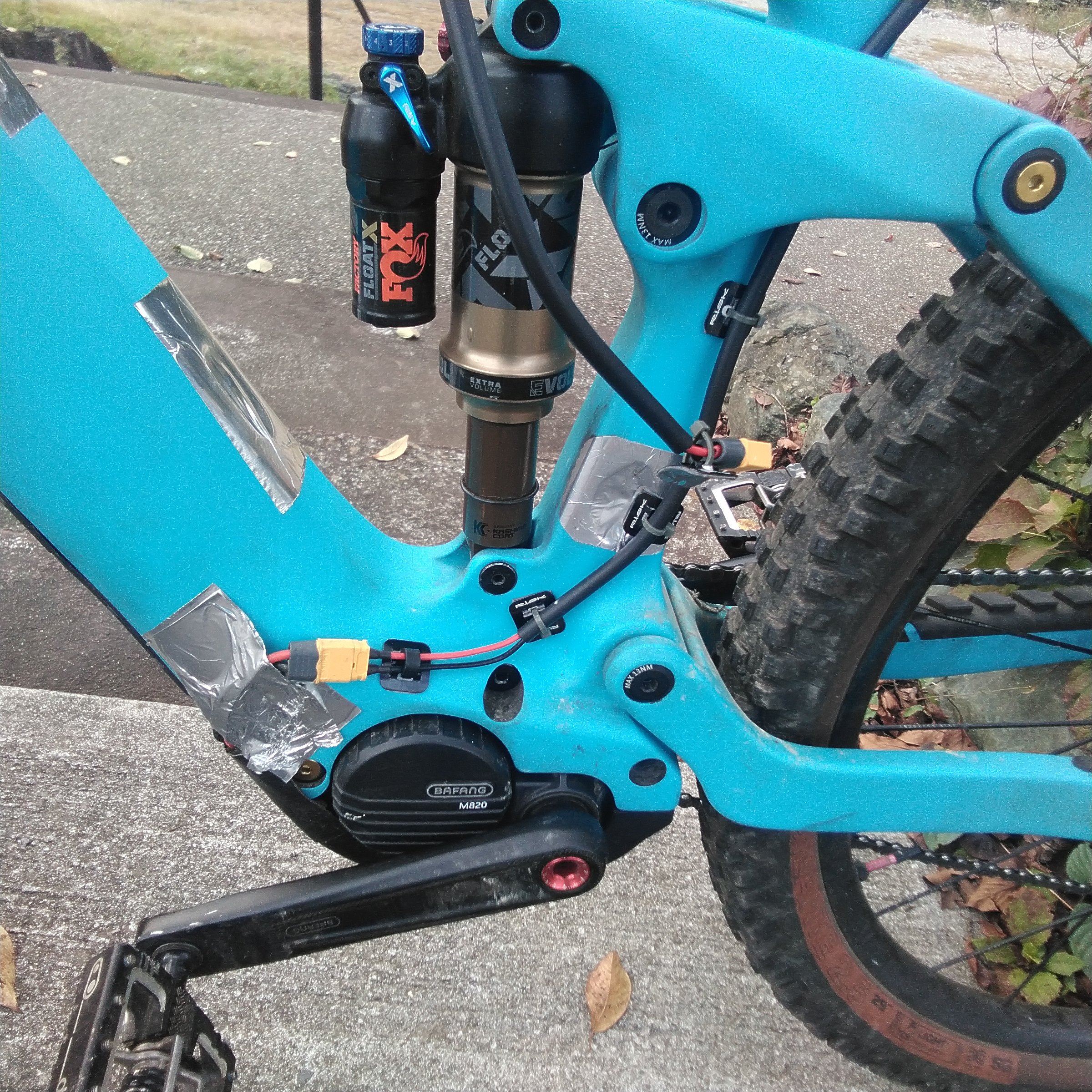

The connections mostly, after the first time I made sure there was plenty of slack either side. Then it happened again and I used cable ties to secure those plugs. I went riding today and this time it was the yellow battery connection so I've used a rubber band to keep tension on it. It's a pretty renegade solution but I just did a 30km ride and it seems to be solid. I thought about using some type silicone glue but I think it's a last resort. Hopefully this works.
Well, at least it’s the cable connection side and not internal to the motor. So that’s at least positive.

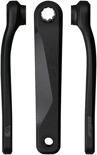

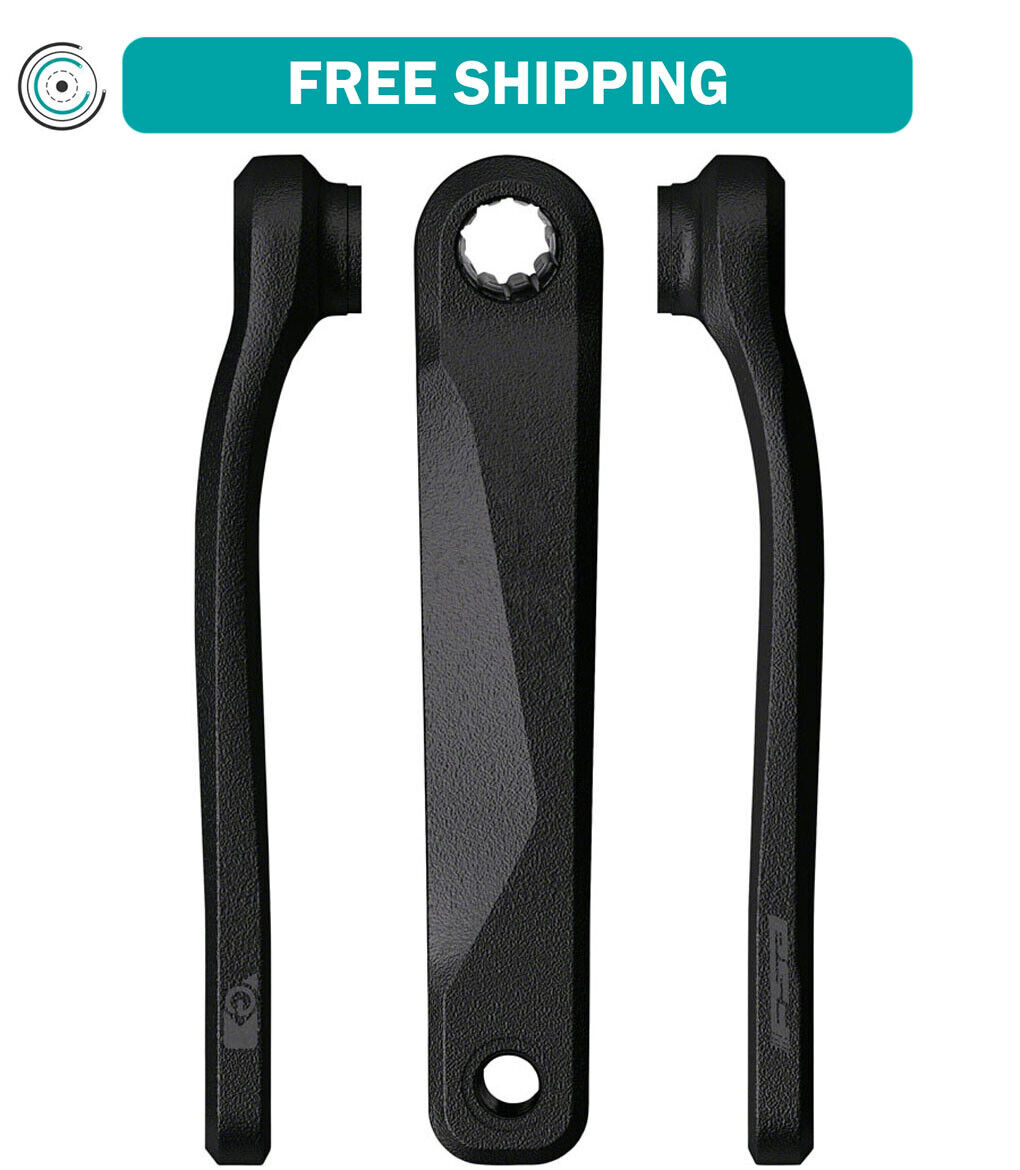

The FSA CK-220 are 420g on my scale and the Bafang are 450g. The Miranda carbon are 315g for comparison. The big difference is that you can not get the Bafang in 155mm. I got mine on eBay.

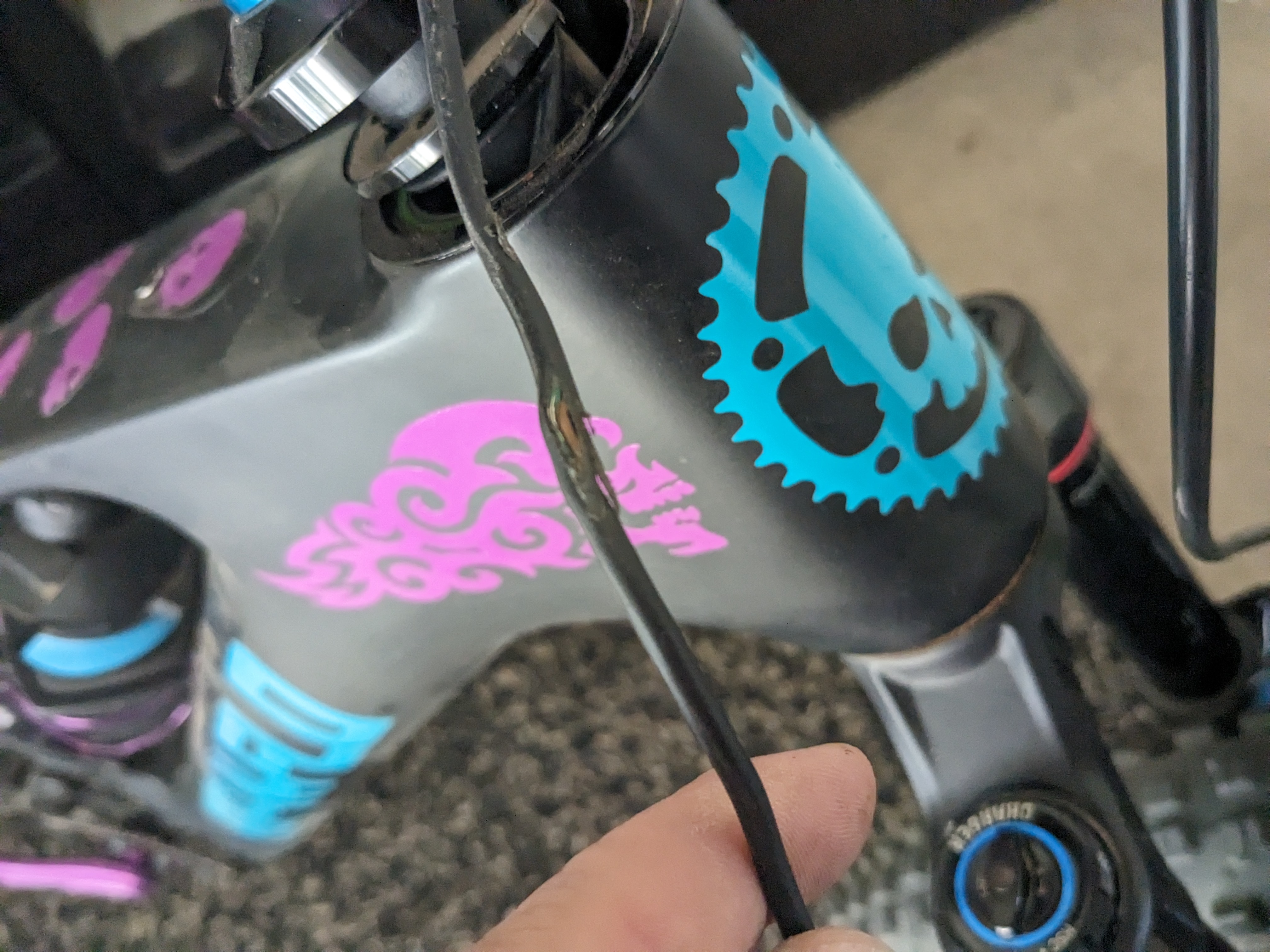

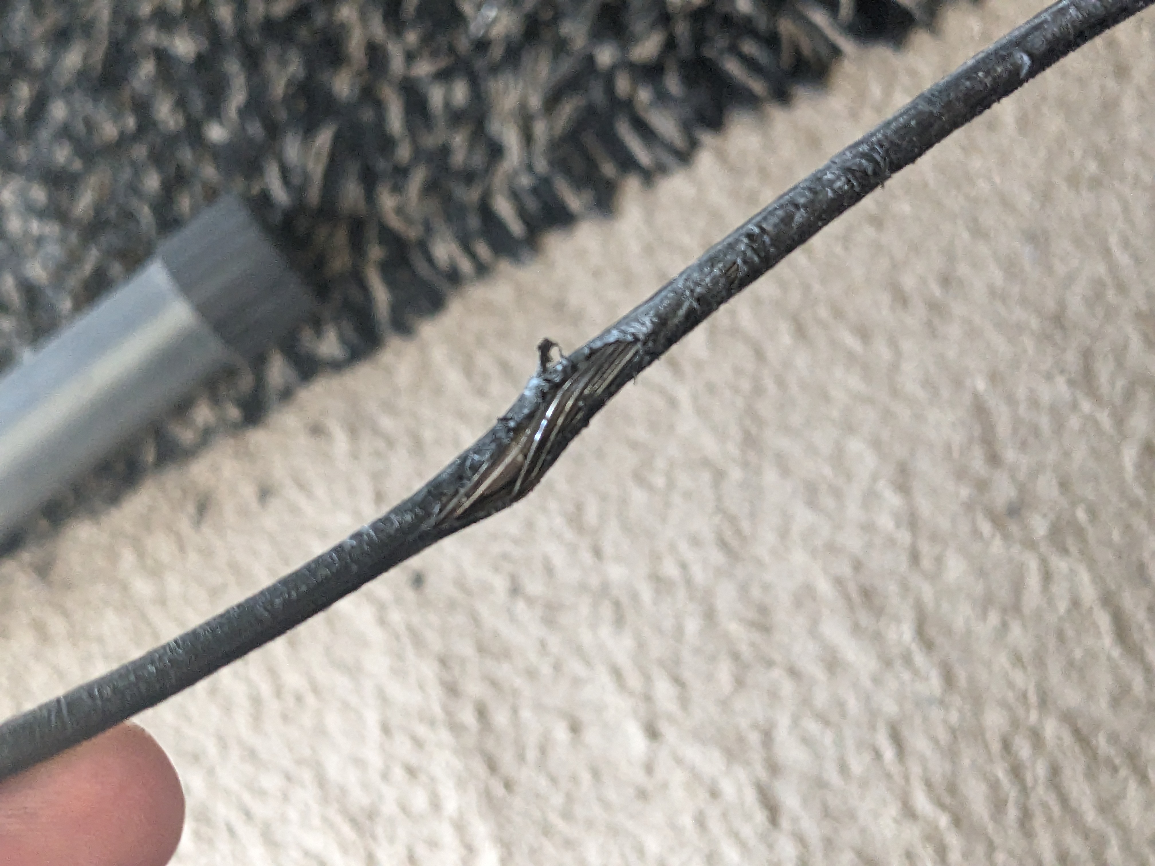

Damn...after only 4 months, the stock ICR cap got my display cable too. Discovered it when I was replacing my shredded dropper post cable.😝
Dropper post cable.👇
Almost frayed the wire coating...⚡
The SZZS replacement headset top cap upgrade can't come soon enough. I requested a warranty replacement.
Fortunately, my brake hose was still in good shape, as I strategically squeezed it in the middle of my three cable bunching.💪

It looks like it will happen the same thing soon on my lce930…
I’ve changed the dropper cable already because it was starting to be quite bad

Does something like this make sense to keep it all together. I noticed it’s in my canyon.
100ft - 1/4 inch PET Expandable Braided Sleeving – Black – Alex Tech Braided Cable Sleeve Amazon.com
