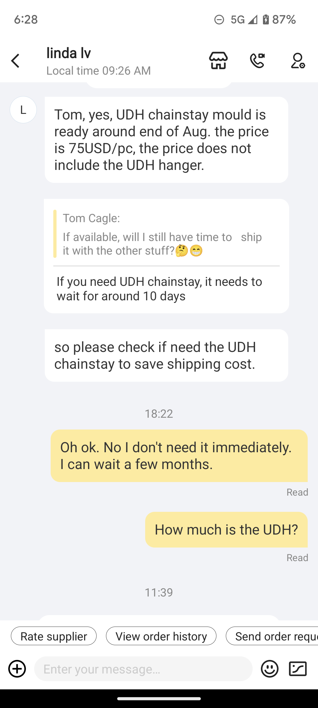

Has anyone gotten the UDH-stay for the CEF50 yet?🤔
Just in from Linda:
The UDH is $12 USD.

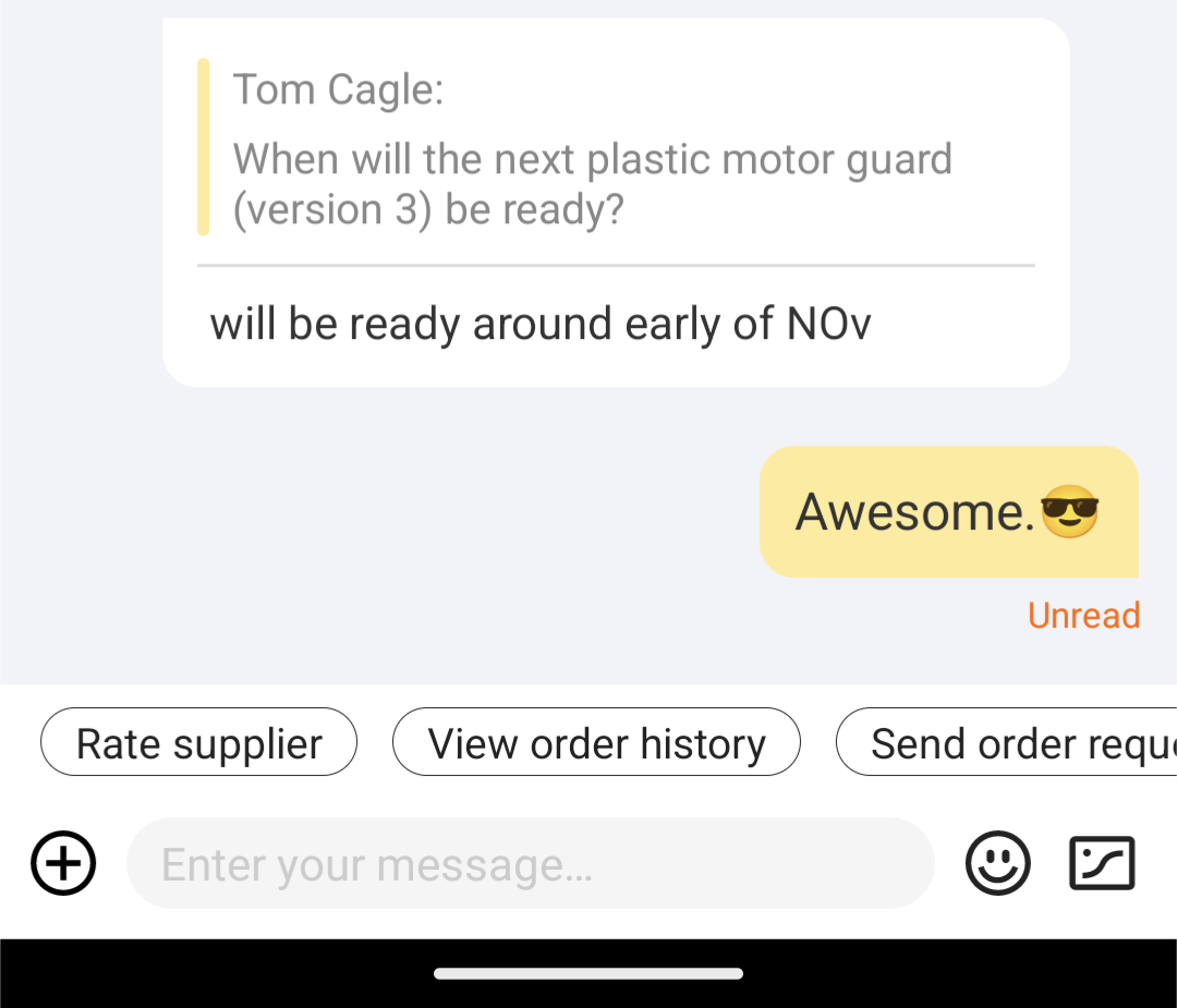

Has anyone found a solution for the motor cover yet? Mine finally broke yesterday.
That sucks. 😝
I just put a layer of carbon fiber on the motor guard tab today. Then sanding tomorrow. So, we'll see how well that works. 🤔
But Linda just gave the update of the version 3 of new plastic motor cover. Remember she's not always accurate in projecting time-frames...Jus' say'n.😎

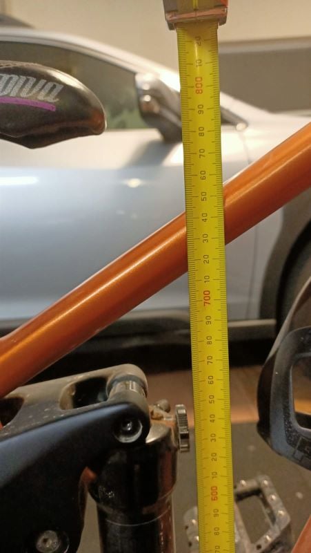

Guys, I was thinking building a cef50 for my wife.
Do you know what’s the top tube height in size Small just in front of the seat?
spokémon
Apr 4, 2023
191
100
My wife is 152cm. I built her a small size frame with 29" wheelset.
But the standover wasn't comfortable for her, so I built her a 27.5 front/rear wheelset. She is now much happier.
The photo measured from the ground. 160mm 29" fork on 27.5x2.6 , 27.5x2.3 rear. (These tires is what I just had spare. I will fit wider tyres once these wear out)
BB height measured about 330mm. Looking to fit 160mm or 155mm carbon crankset once SZZS starts production.
Currently 165mm crankset, only 1 pedal strike so far on rocky terrain.
Mellow rider. Mainly blue trails, in the "No Fly Zone"

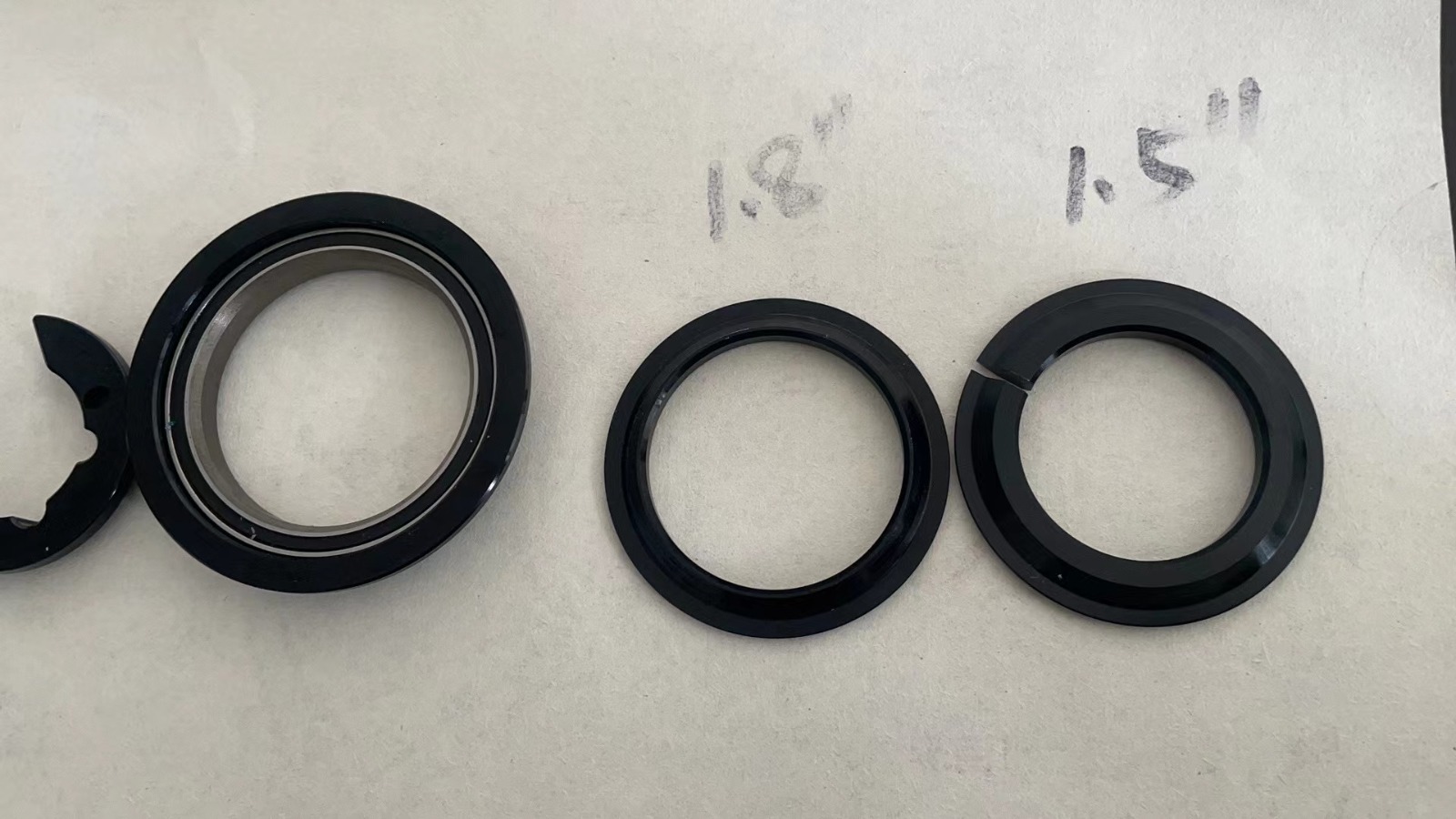

Malaysia
Gottya👍🏿
Well, if the CEF50 can support a 1.8 supertapered steerer fork, might as well build mine to use one😁.
It's nice to know that we're beginning to get diy frameset kits which can support newer standards of equipment. Usually, this is reserved for the "well-known" mainstream brands👍🏿
CEF50 come with those adapter for both 1.8 n 1.5

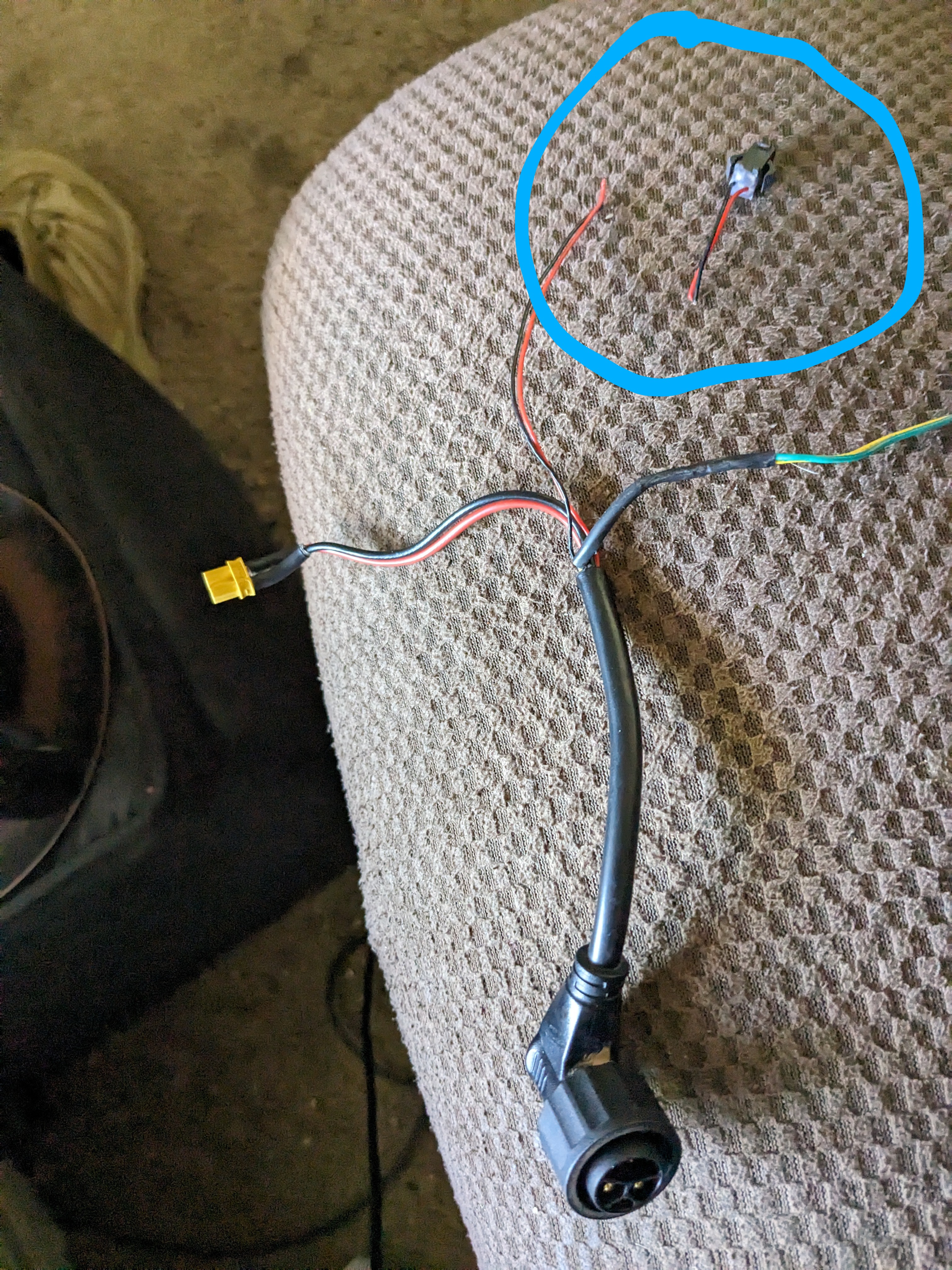

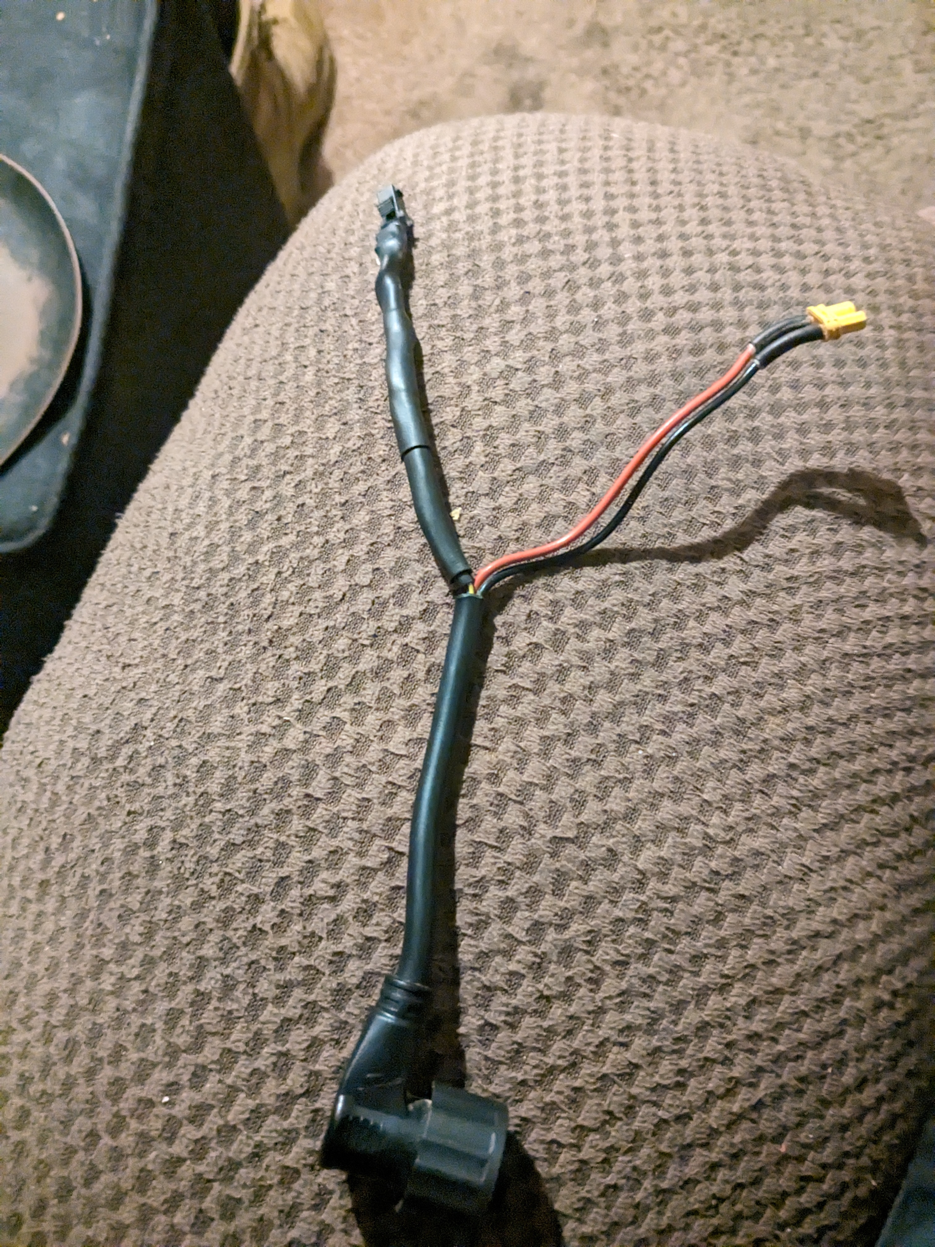

Quick follow up of my tiny, super delicate charging port wires. Carefully spliced it back and did individual shrink tubing, then piggyback with more shrink tubing to the defunct taillight wire harness to give it some more tear resistance. It's bulked up but has survived several rough rides and still recharges the battery.🤛
My only question, why are make those critical harness wires so damn delicate?😝🤯🤔
Before:😤
After:😉
