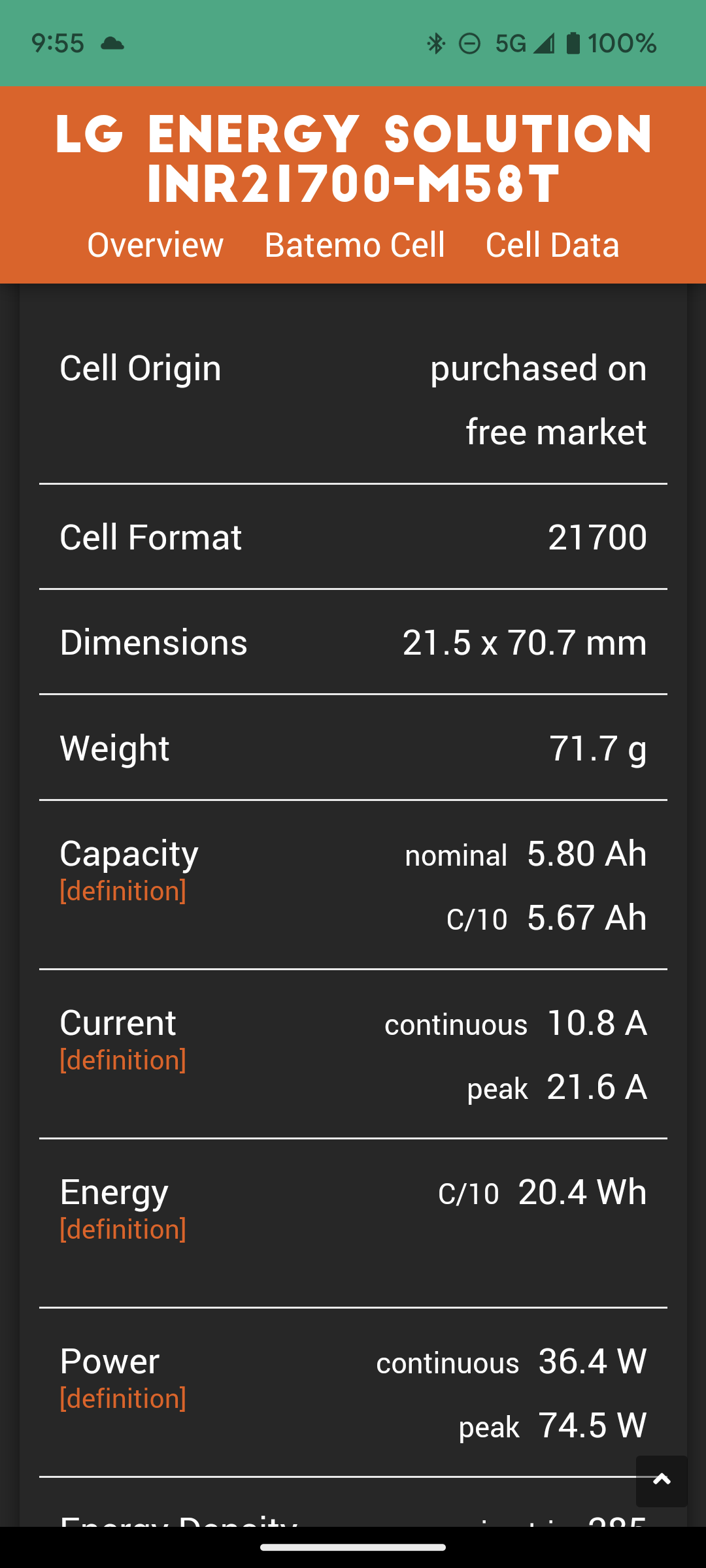

Sorry is it an LG/Samsung/Panasonic and what amp/capacity?
The vid guy says the 21700 5.8 A 21700 cell yielding 16% more juice overall and is newer chemistry. 🤔
Yet, I see a Samsung 8.6A out there. Wondering how our new our 21700 cells battery would stack up (given same motor Voltage and battery configuration) and if it's a little hype on his end.

When I disassembled the housing of the 720W battery, I was disappointed. The battery was packed with blue shrink wrap. I was sorry to tear the film, because the battery was made very well. The seller claims that the battery is assembled on Samsung. We can assume that the capacity is 5000mah

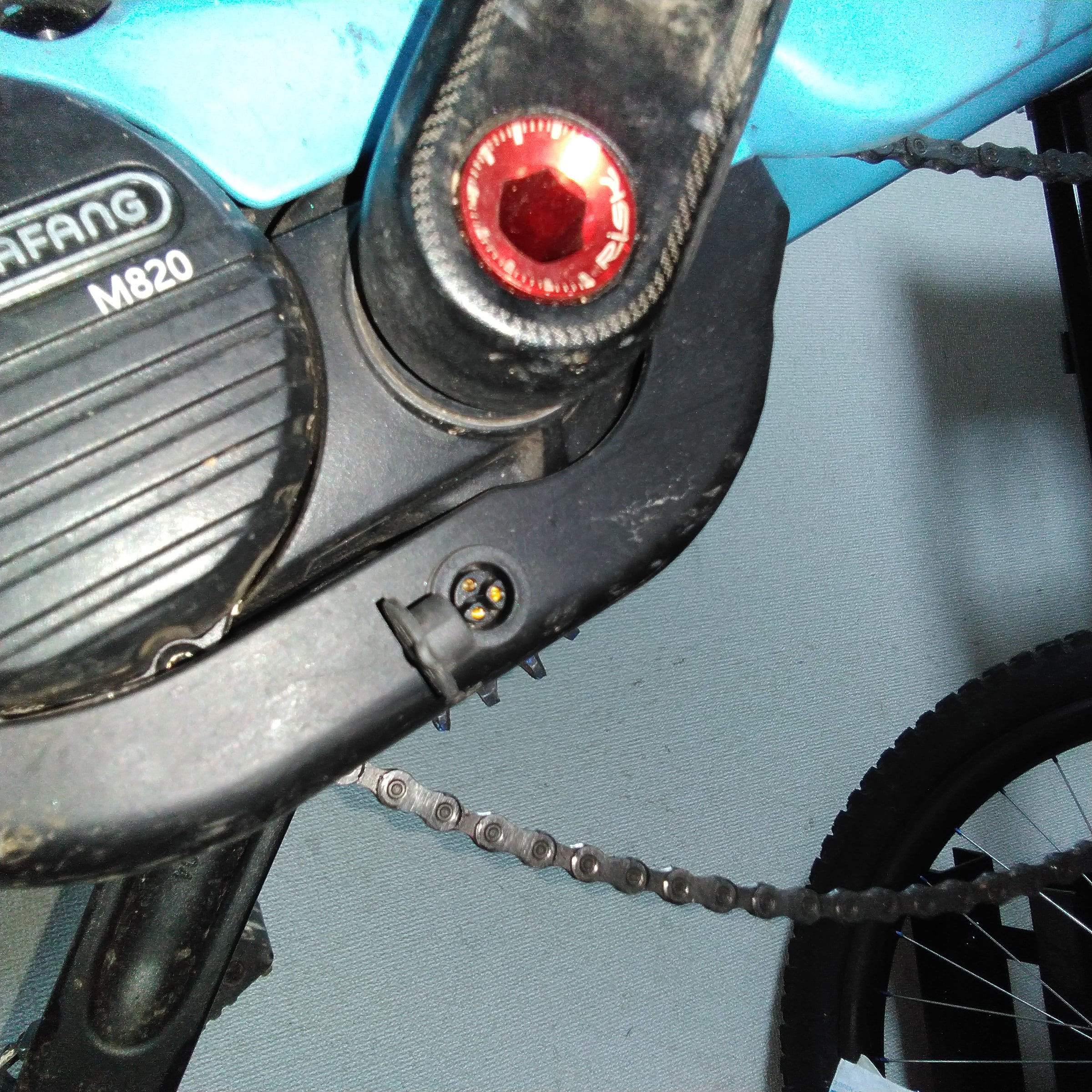

Your dropper won't get past the top screw on the charge port. That said, by my calculations for your XL frame, your seatpost insert length should be 324mm. Enough to swallow whole your 210 Oneup post.
I have an L size frame. I relocated the seat tube's charging post to the motor cover and shaved the inside of the frame to make it compatible with BIKEYORK 213mm.

Given how delicate the motor cover is and how many people have already broken them do you think that is a good idea?
I broke it once and repaired it, but there's just a charging socket, so it doesn't bother me. The cover was badly cracked and the pieces could not be recovered, so I lined the large gap with Gorilla tape and molded it with silicone on the surface.
