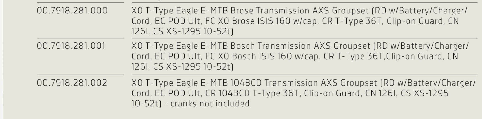

I’m still on the fence about picking the new AXS stuff up. According to SRAM I’ll need 2 chains in different lengths since I swap the high/low position depending on terrain. The tech I spoke with also said I’d have to go back through the set up anytime I changed the head angle. It’s not a deal breaker if you never change any of that stuff but I do a good bit.
I love the current GX AXS combined with an Shimano XT Cassette, HG+ Chainring, and HG+ chain. You can absolutely shift smoothly under load and now that the AXS GX kits are on sale it seems like a good way to go.
After watching a couple videos about the new stuff by Peak Torque I'm a bit skeptical. Certainly would like to see some more long field reports before I'd consider jumping from the Sram/Shimano hybrid setup. Upgrading from a mechanical system to AXS then maybe it would be worth considering.

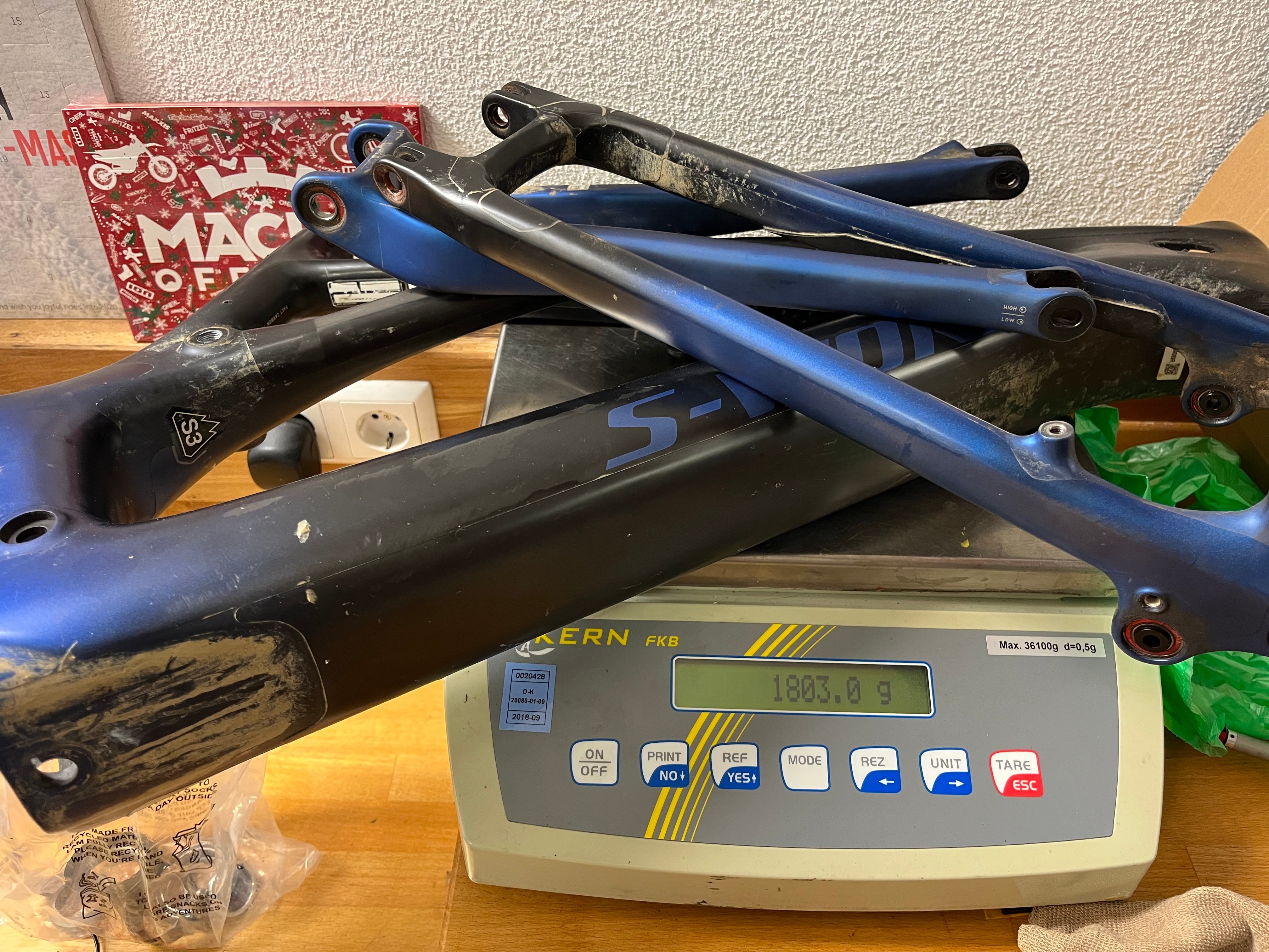

Do anyone knows if s-works frame are lighter than other carbon frames?
I bought the cheapest komplet bike, dark silver(2023mod), and are going to changes almost everything.
The seller is a nice guy, so i think i can change it, its almost the same price.
He gave me a very nice price on this bike, 700 battery, and old mcu, so i have to put some money in
for the s-work frame, but i do it if it is some weight different. This is the S2. I want to get as lightweight as possible.
But not at ALL COST!
Gen 3 carbon frames are all the same, gen 2 had different versions, fact 9 and 11 I think they were, with different weights.

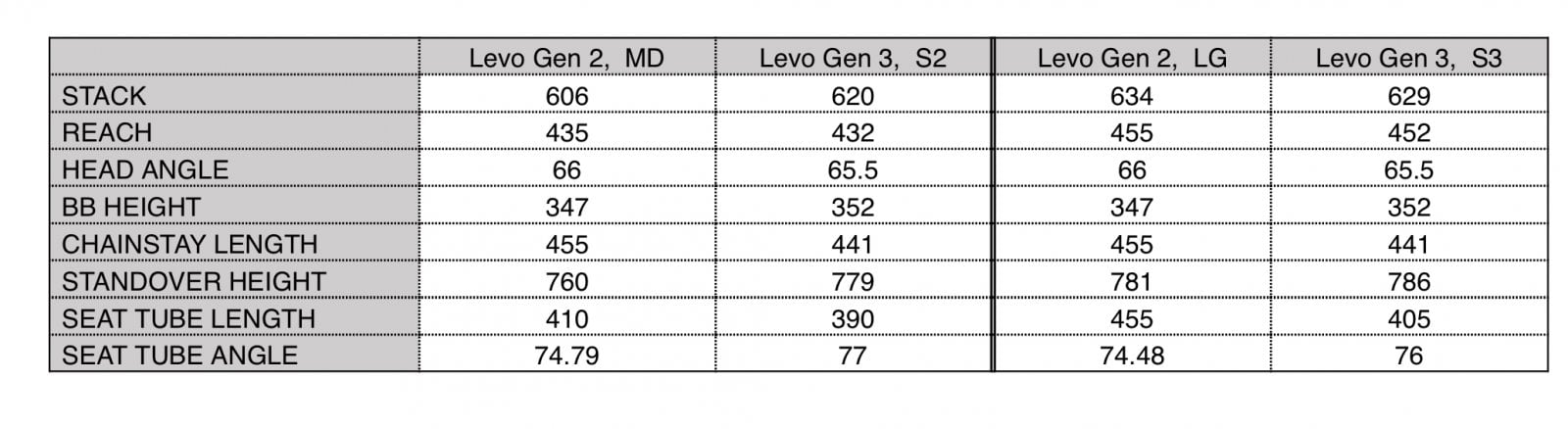

Size Guide :
Geometry comparisons to gen 2 bike in nearest match sizing, set with headset cup to +1 (steep)

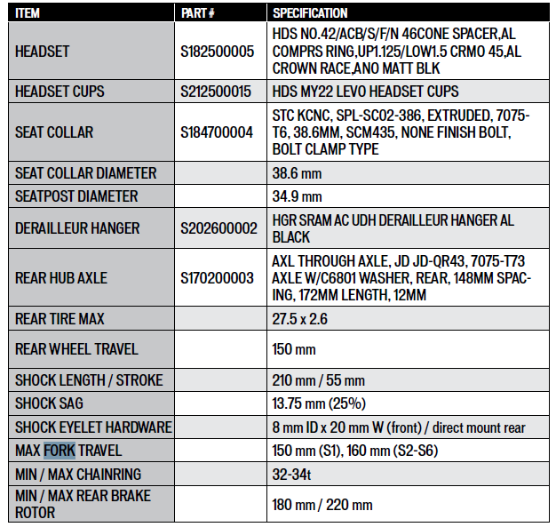

Max Seat post insertion S1-210, S2-220, S3-240, S4-255, S5-275, S6-295mm
Seat Tube : 34.9mm shimmed to 30.9mm on S-Works and Pro.
Rear shock : Custom Float X2
Part number: 979-63-010
Short ID: D9MP
Description: 2021, FLOAT X2, F-S, K, 2pos-Adj, Specialized, Levo F1, 210, 55, CL002, JCR010, Rezi CM, SBC S08 Dream Silver Satin/SBC W03 Metallic White, Neutral Logo, N/M

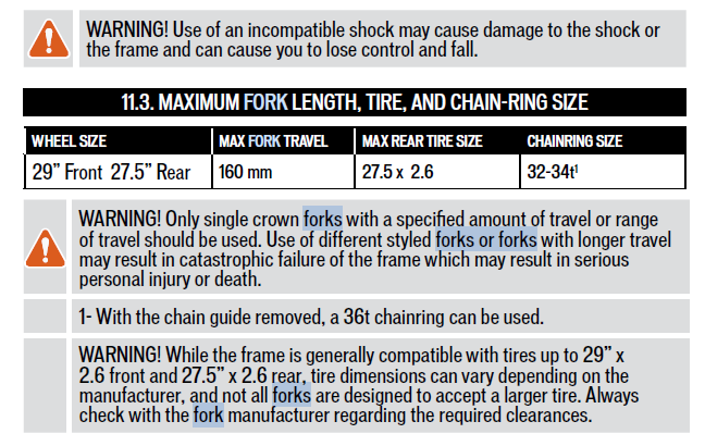

Pretty much anything else you might need to know in the Workbook :
FORK UPGRADE LIMITS and Chainring Sizes :
General Specification, quick find part numbers :
More info taken from @knut7 Youtube : EMTB Videos & Gen3 Review :
