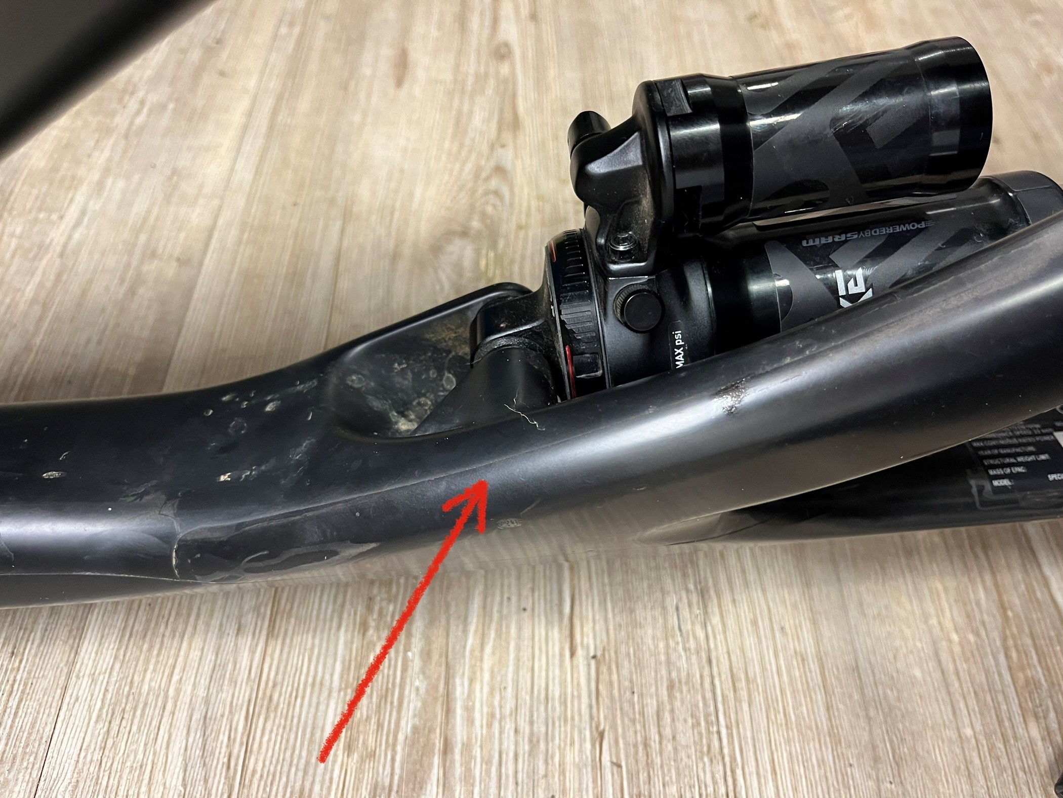

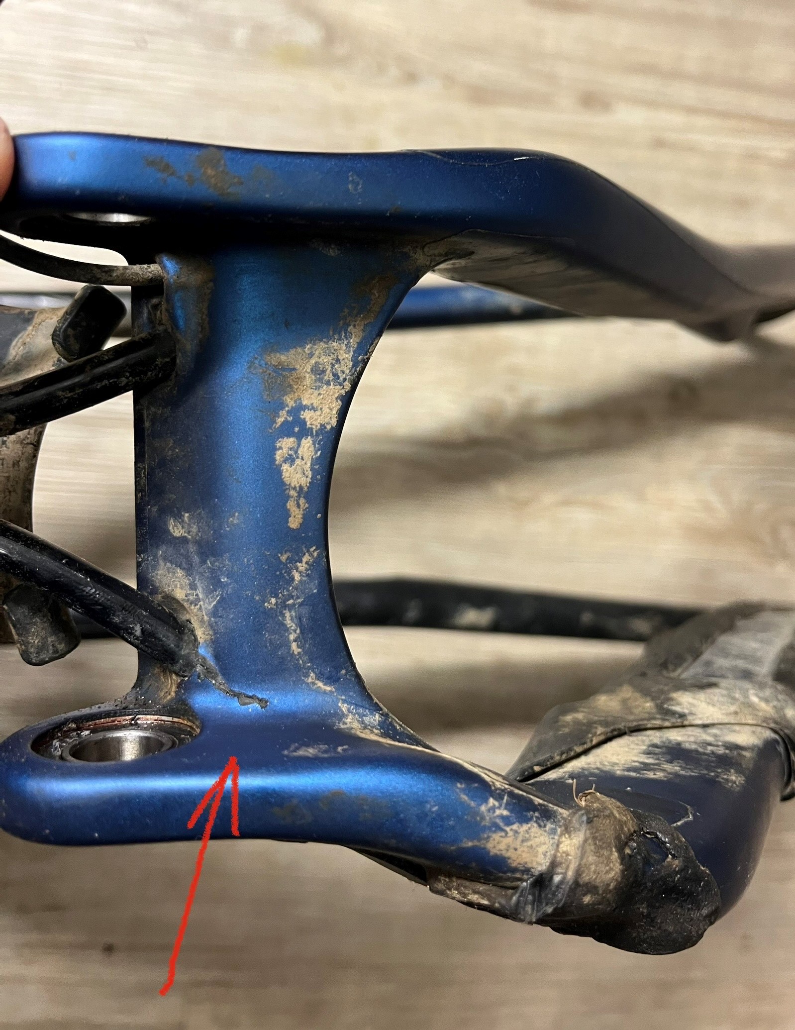

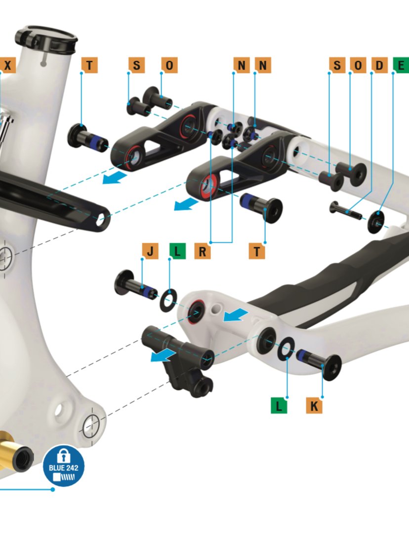

Hi there,
My 2022 S-Works has cracks in the reararm an front shockmount. I weight 78Kg and prefer Trail/enduro biking.
- after the frame has destroyed some airshocks due to the sideload ist has now destroyed itsself on the shockmount :( a visible crack in the carbon structure.
- the reararm has a crack, only visible from downside after Motor replacement.
Both cracks were found in a routine-check when cleaning&greasing the bolts/bearing seats.

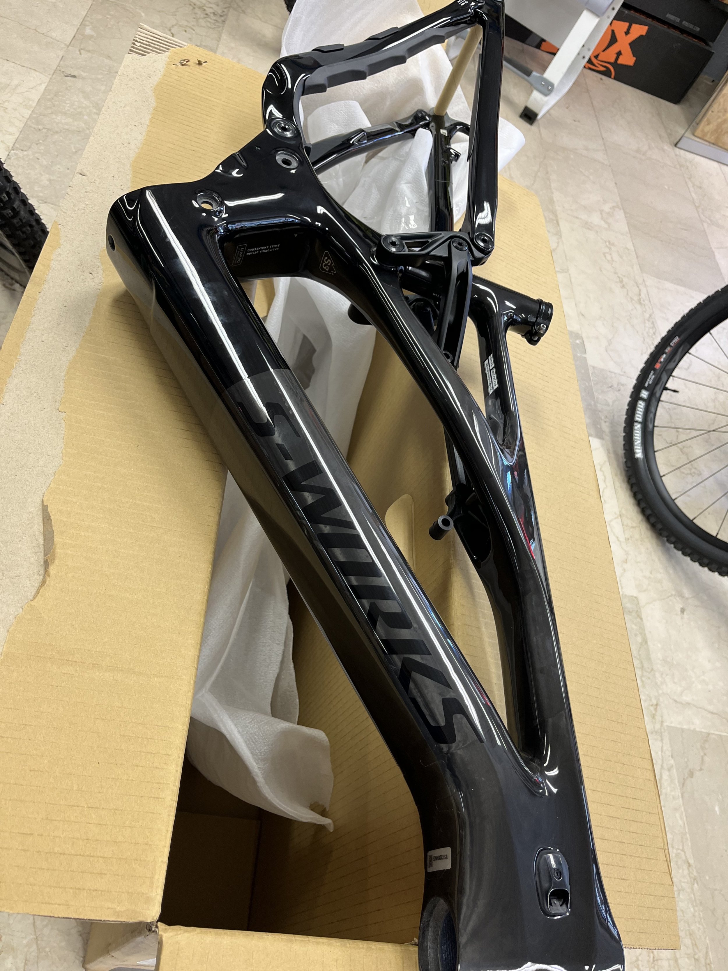

Speci made a good job with replacing it with a new S-Works frame. But i'm asking me if i should give the carbon frame a second try or use my alloy Levo.
Are there other experiences with cracks in this 2 positions ?

Ouch, this has always been my concern with Carbon frames, the small amount of weight saving compared to the alloy is what made me choose alloy over carbon, the extra weight is not noticeable on an ebike imo. I'm all for carbon and use it for my handle bars and wheels but I just worry about the frame delamination over time and cracks appearing like yours. It's great to see Specialized looked after you with a new frame though 👌

1.5Kg o_O this is not so less... But yes, you're right i'm now on an alloy Levo and very happy, nearly no difference in handling when over 20km/h. but perhaps i can't resist to build up the new black S-Works 2023 carbon warrantyframe one again :) But i think i will sell that lightweight diva.

Hi there,
Ouch.
Bought a frameset because of the sale here in Germany and finished the build this week.

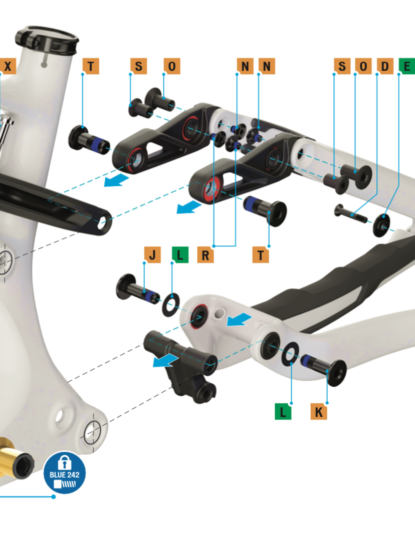

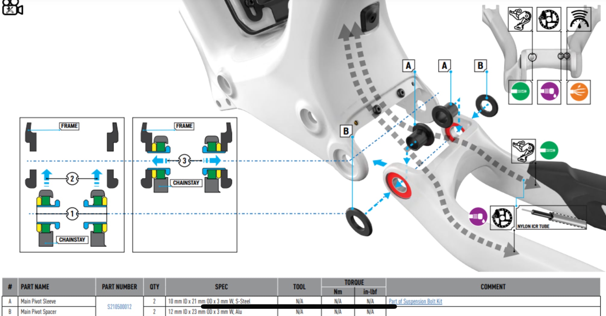

I have a question when I see your picture.
How is it possible to disconnect the chainstay from the main frame? I just wanted to greese the bearings but I cant disconnect the chainsay from the main frame. Seems that it is not enough if bolt J/K is out. Would be great if someone could help me out ;-)
Christox
Aug 12, 2020
88
80
Freiburg/ Germany
There's a bushing or sleeve in the bearing of the swingarm which also connects to the frame. The motor and the motorbracket has to get out before the bushing be punched out to the inner side when i remind me correctly.
Henrik
Oct 25, 2022
89
94
Ok thank you. Maintenance horror. Next time I will try it with loosening the motorbracket. Motor out, for maintenance the bearings on the chainstay is …
