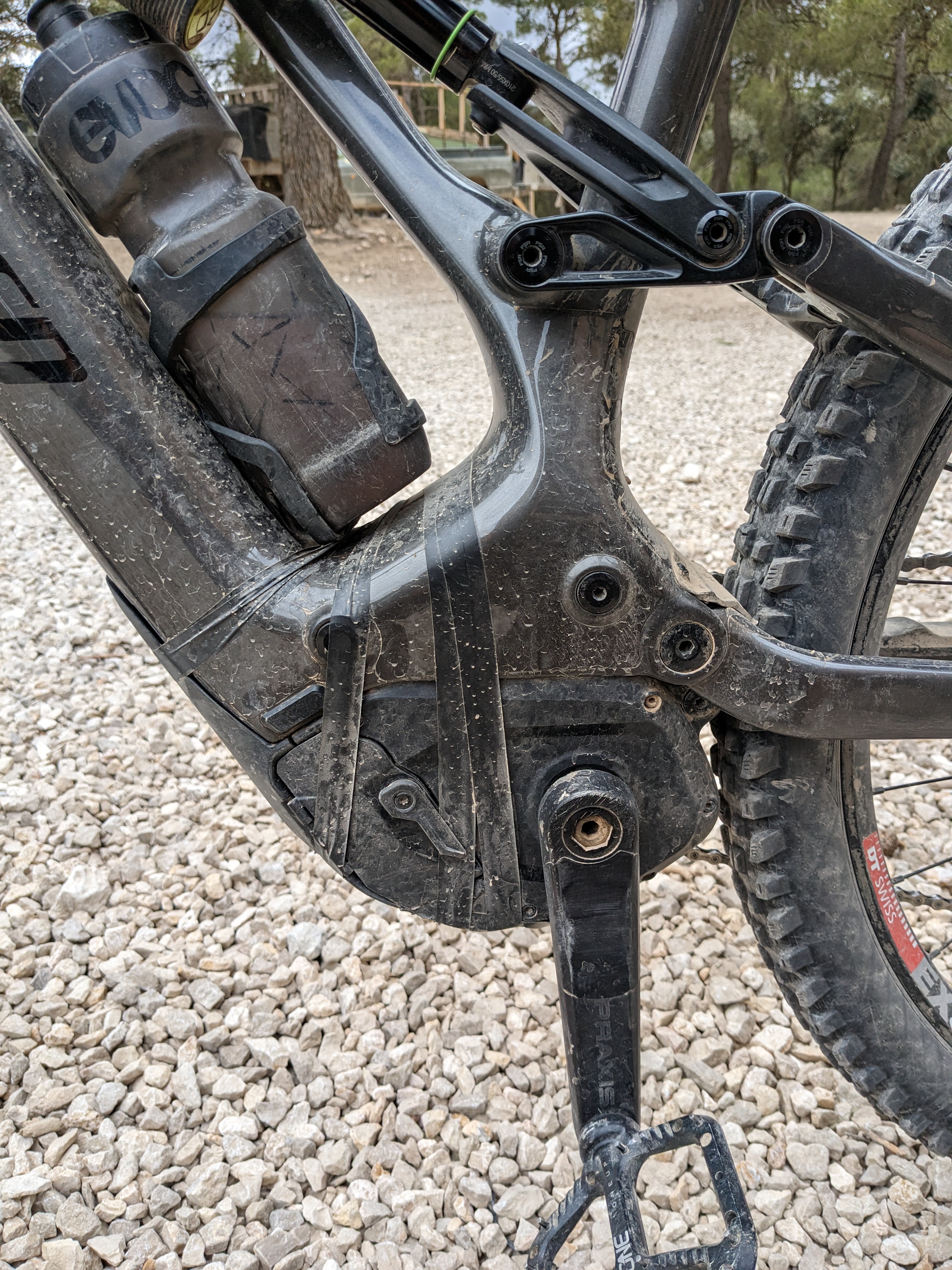

bcn
Ouch, this has always been my concern with Carbon frames, the small amount of weight saving compared to the alloy is what made me choose alloy over carbon, the extra weight is not noticeable on an ebike imo. I'm all for carbon and use it for my handle bars and wheels but I just worry about the frame delamination over time and cracks appearing like yours. It's great to see Specialized looked after you with a new frame though 👌

29er rear wheel on the GEN3 why ? The new rear design on the GEN3 is much better than the GEN2 which had a tendency to sit down. On the GEN3 there is an important anti-squat that helps the traction a lot. There is more traction on the GEN3 with a 27.50" wheel than with the 29" on the GEN2. The mullet makes the bike reactive and fun, for me putting a 29" wheel just doesn't make sense! ;)
for me, on some very technical trails i have here, make sense, as BB goes up by 1-2cm.
I hit plastic battery cover many times during last months, and it's 'in pieces', with a lot of tape on it (to keep it together)

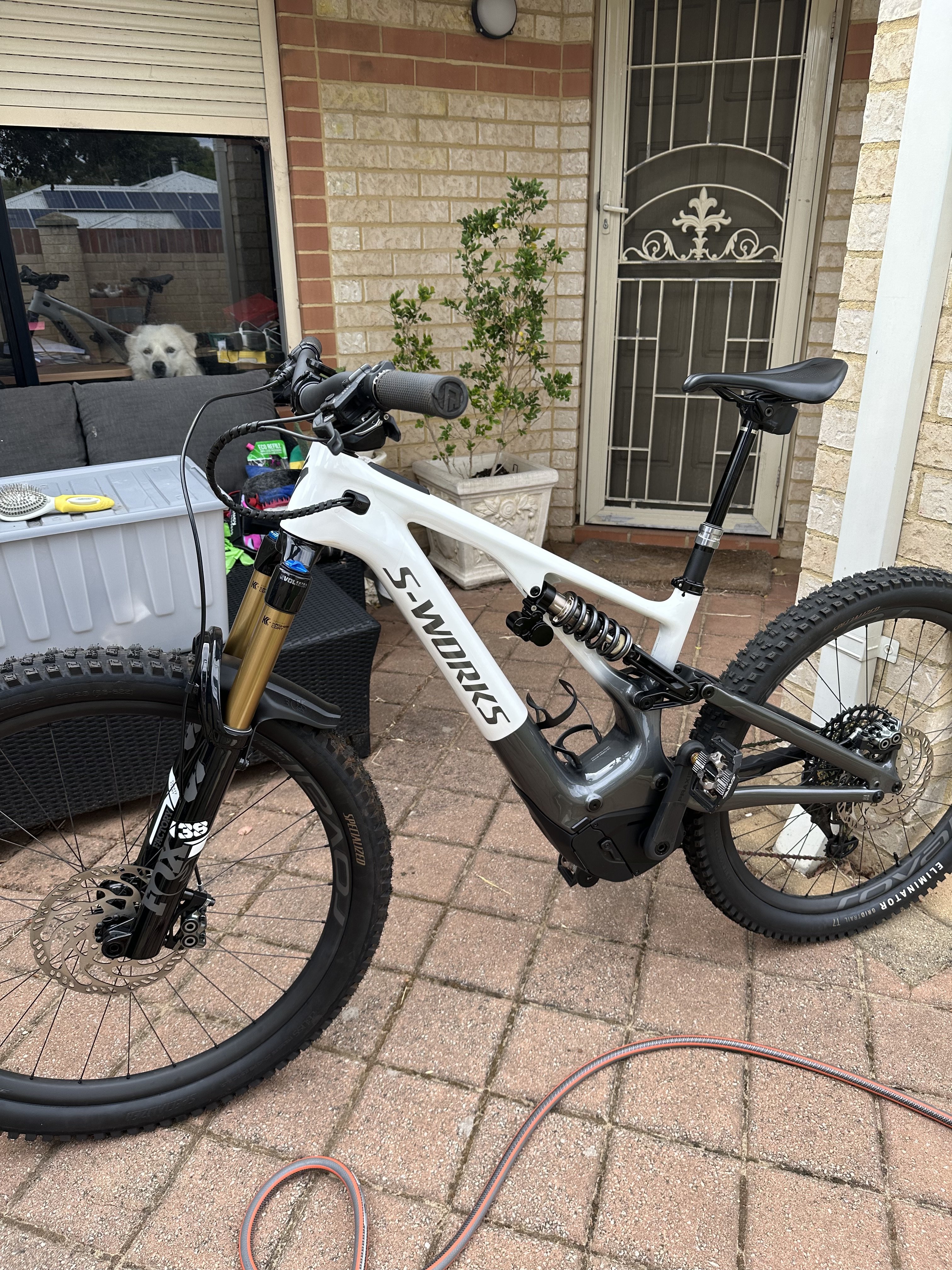

Hi !
Today my X2 in the S-Works is blown. After 2 months of riding trails and jumplines i could see black residuals on the shaft. Looks like the seals were running dry and grinded away. A few rides later the shock lost 50% of the air pressure suddenly.
I‘m now asking me if a warranty repaired shock will not have the same problem. Perhaps this is a design problem of the yoke-linkage which gives the shock extreme sideloads.
I‘m runnign with 210psi/2airvol spacers/80kg
Are there same issues with your X2 ?
If the compatible coil optins where cheaper i would swap to that, but i actually only see EXT and Push as robust yokelink compatible shocks

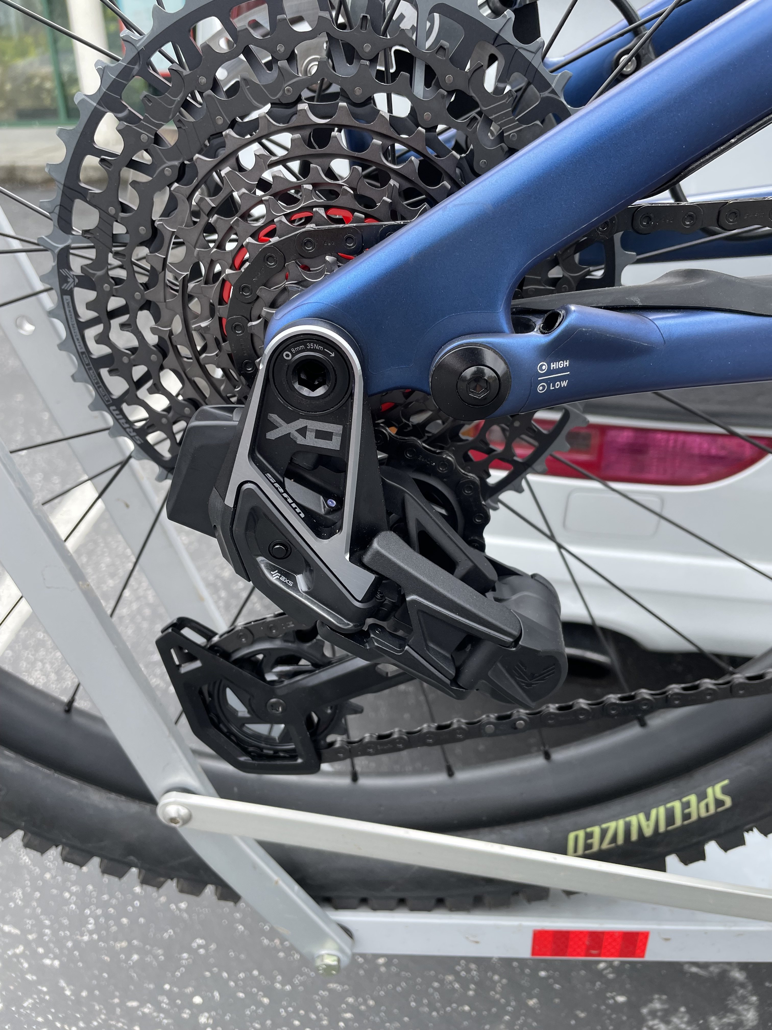

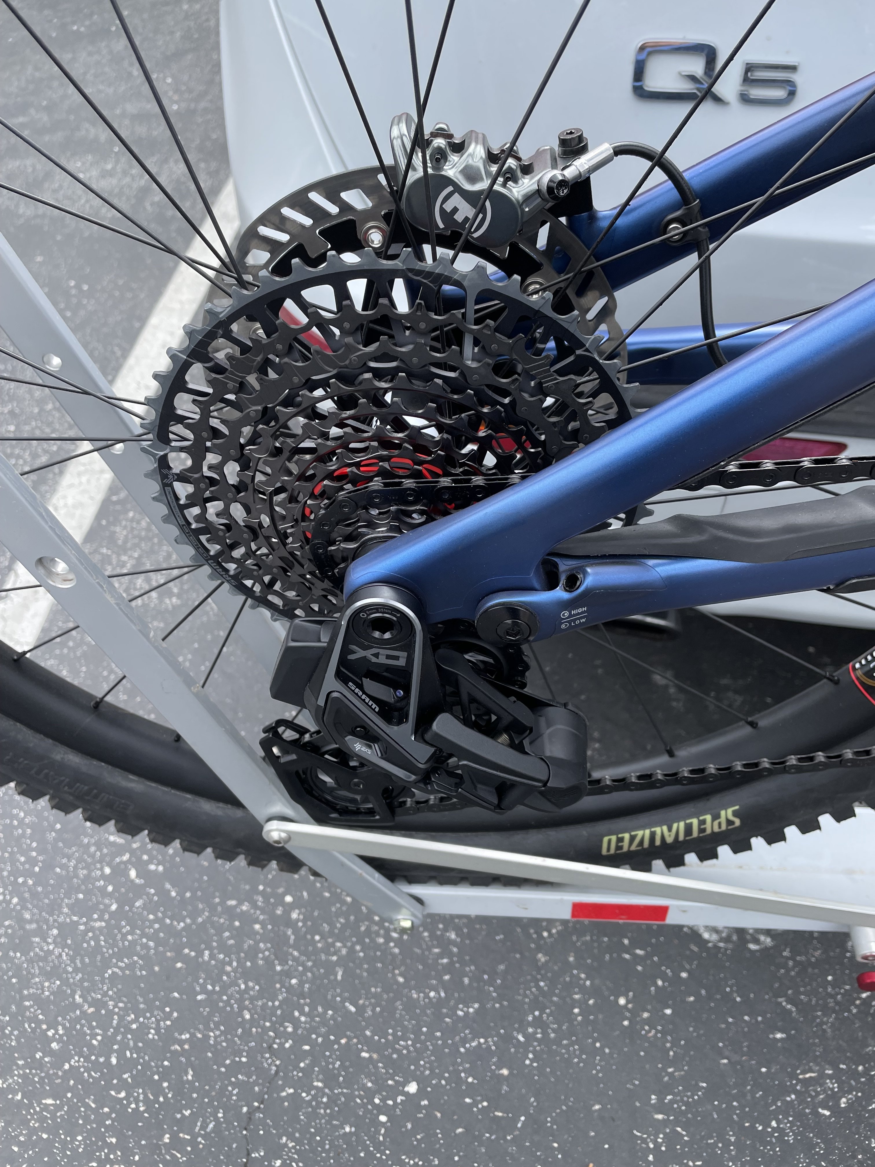

There is talk of even the GX coming soon. I highly doubt they will wait til 2024 to feature it, rather it's in the pipeline I believe. btw, it's really good stuff. Think it's worth it.
View attachment 110555 View attachment 110556
I’m still on the fence about picking the new AXS stuff up. According to SRAM I’ll need 2 chains in different lengths since I swap the high/low position depending on terrain. The tech I spoke with also said I’d have to go back through the set up anytime I changed the head angle. It’s not a deal breaker if you never change any of that stuff but I do a good bit.
