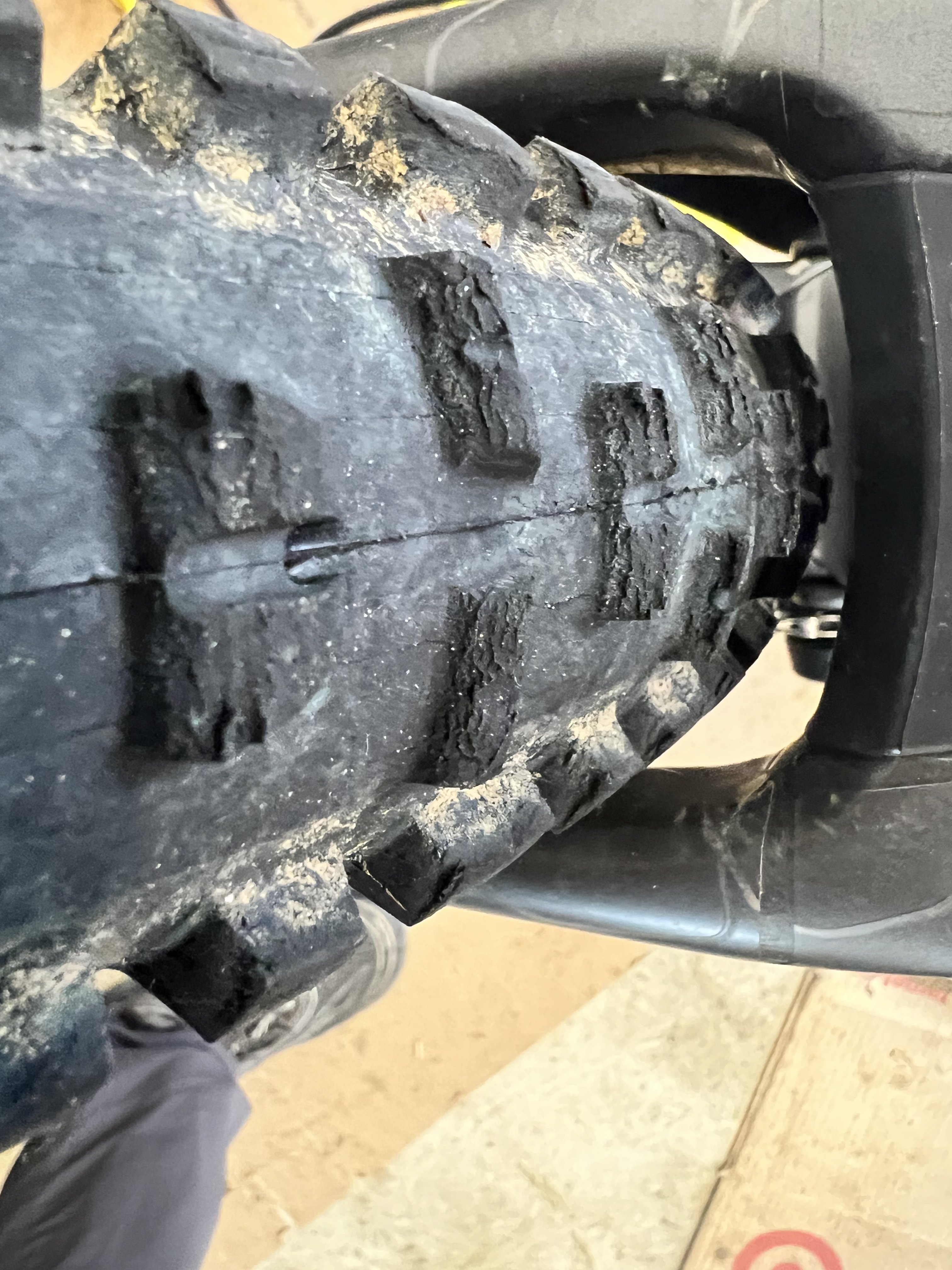

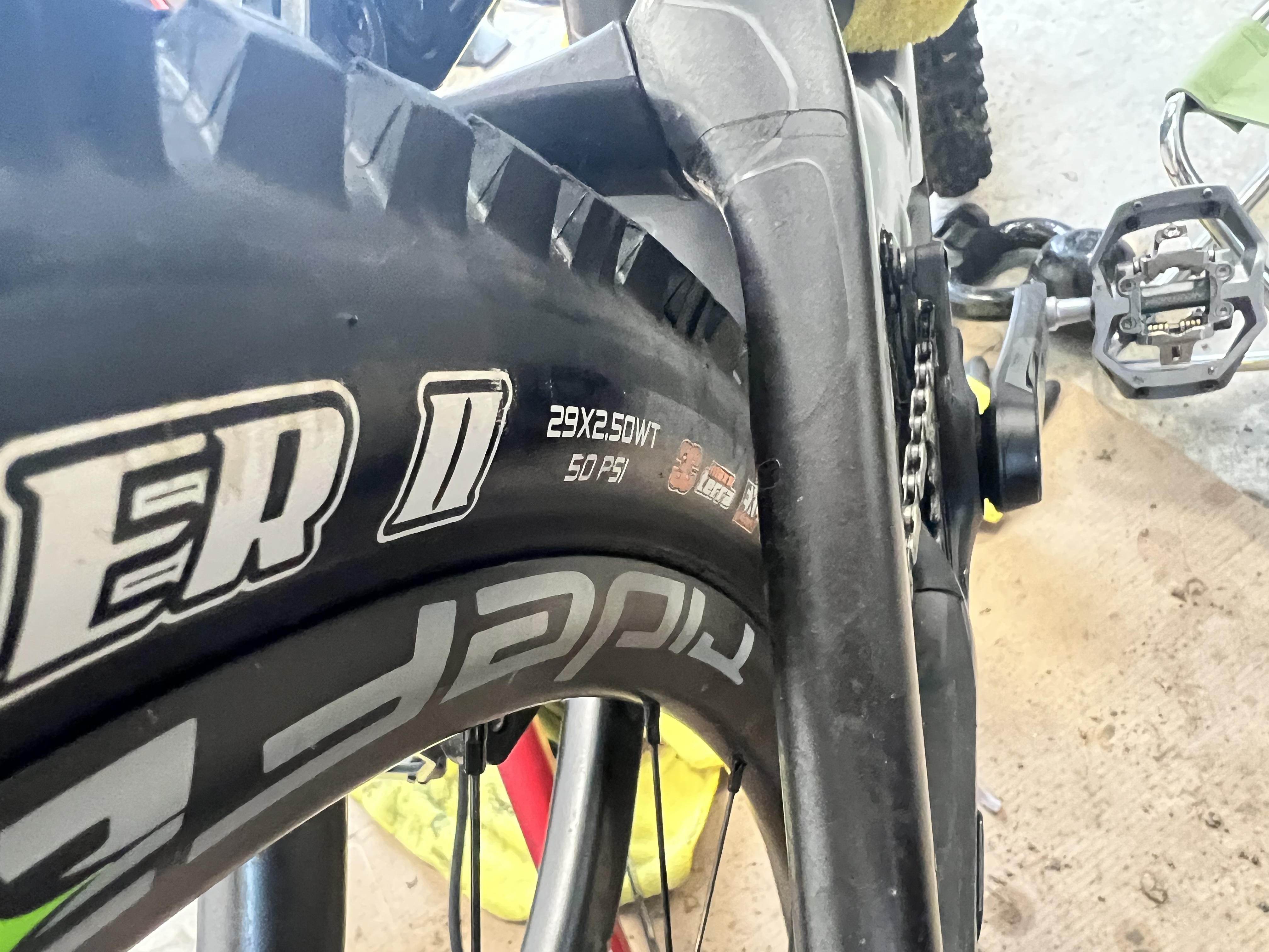

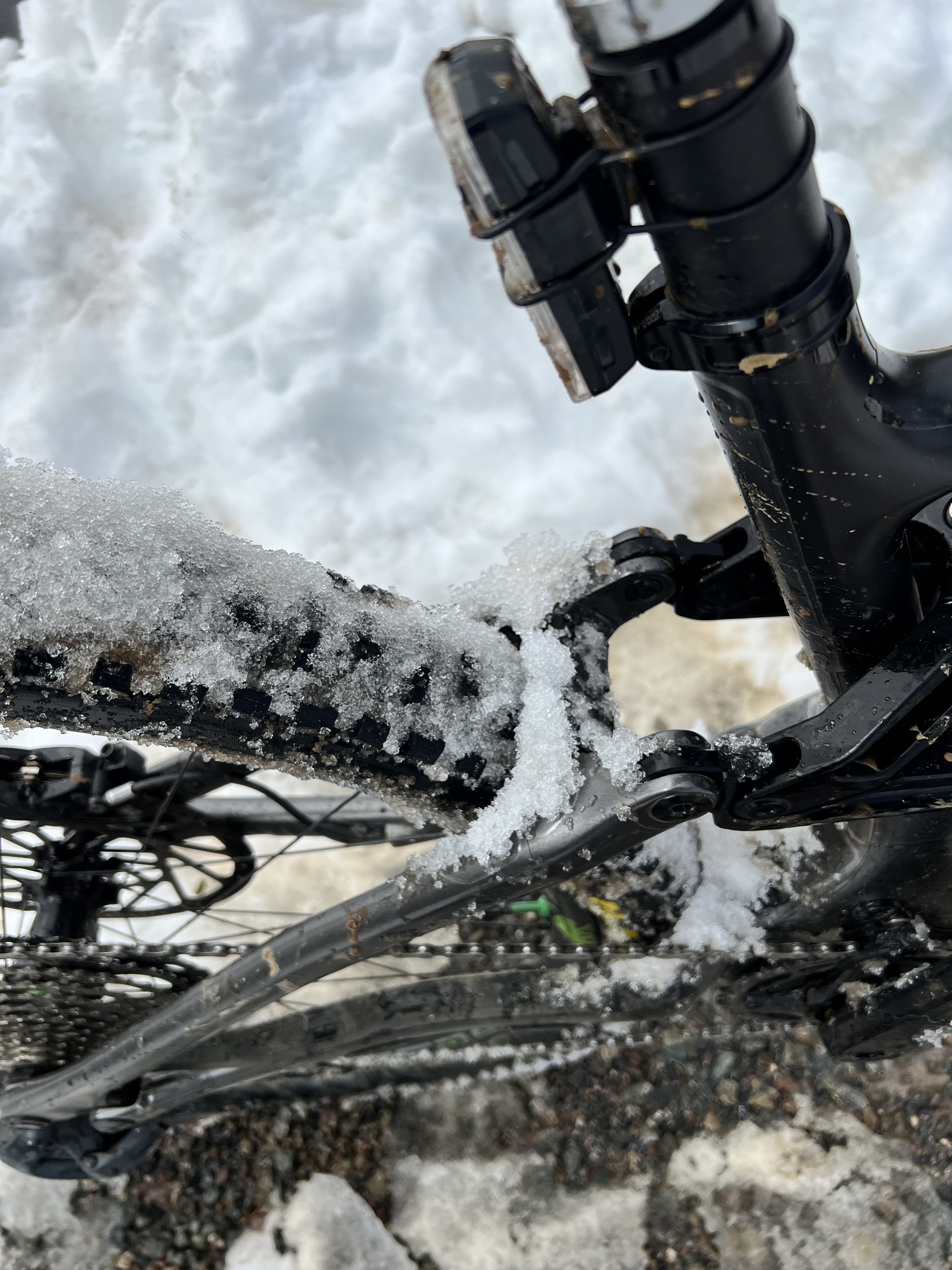

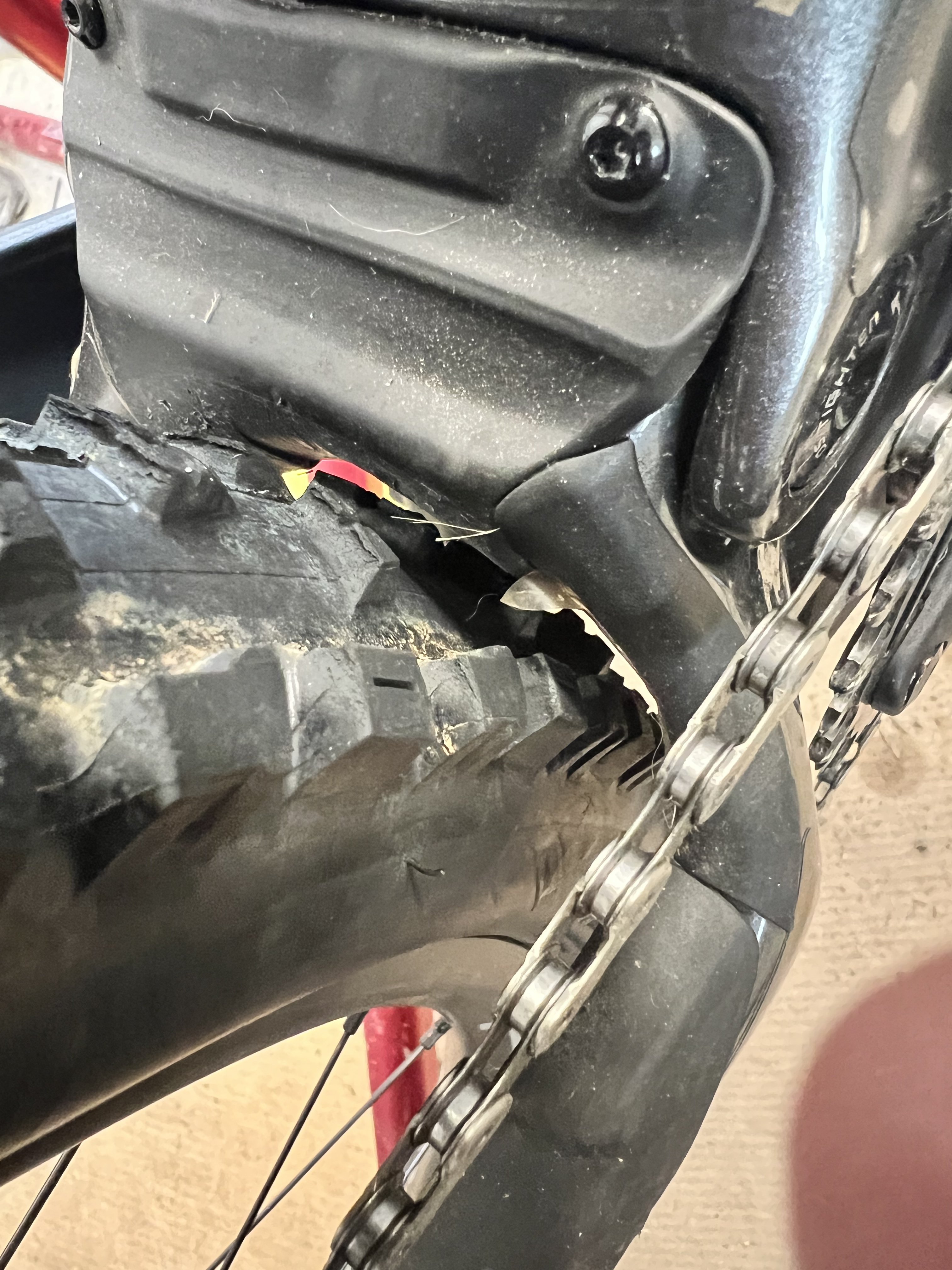

Curious, has anyone successfully put a 29 wheel in the back of their mullet set up frame? If so, how is it and what size tire are you getting away with?
BruceJR
Jun 16, 2022
141
72
USA West
I’m running a 29” 30mm internal wheel with 2.5” High Roller with Tannus insert. Also running Cascade Long Shock Link in Low. The side to side clearance is plenty but the seat stay and bottom bracket is pretty tight. Can’t use my mud guard anymore. So far I’ve ridden some pretty muddy and snowy conditions without major clogging. I generally ride dry dusty conditions so it will for sure be good most of the year here.
So far I’m pretty happy with the change.
