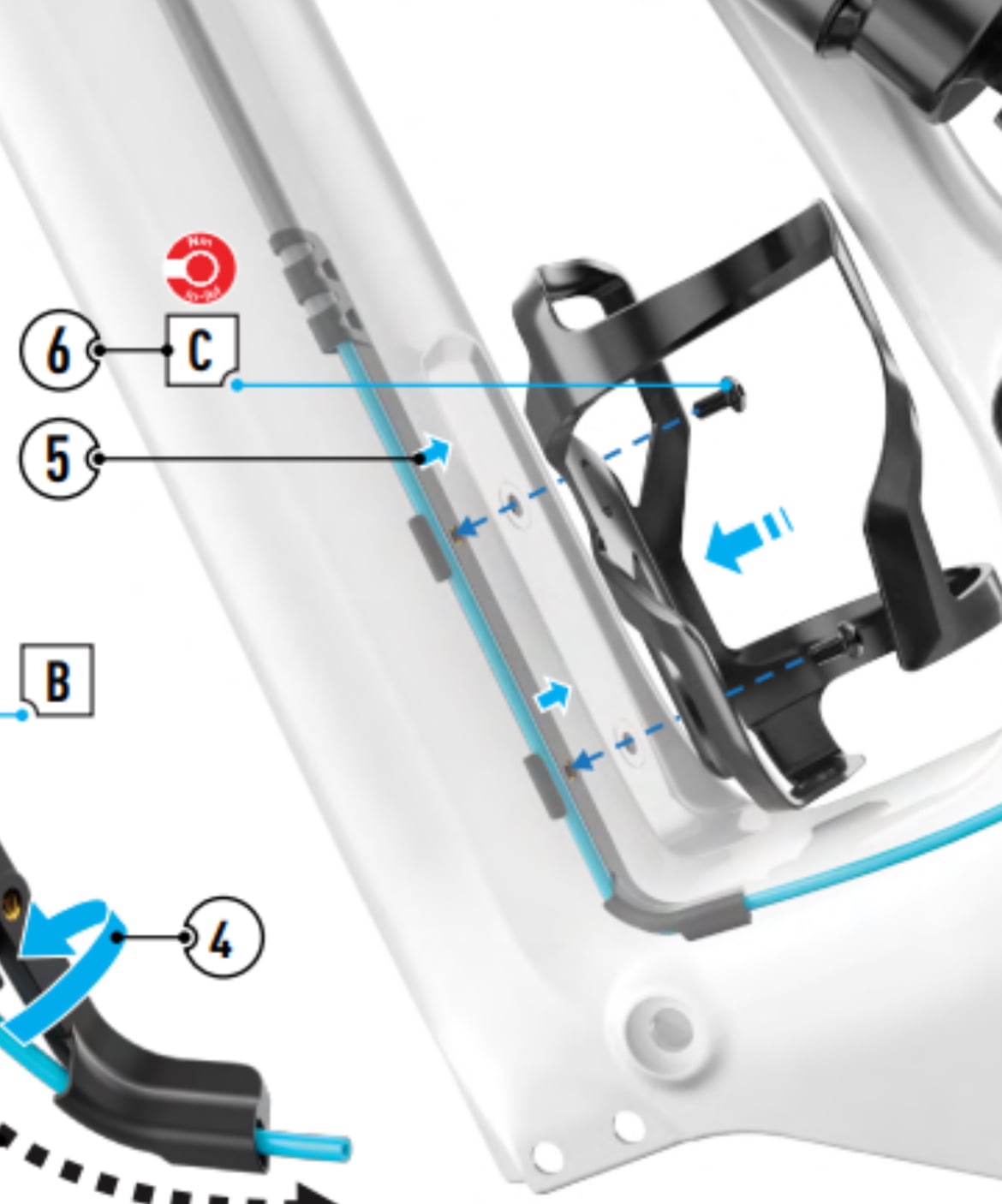

Ended up having to remove motor just to get the cable moving and see what was going on. Turned the actuator at the bottom of the seat post 90 deg in order to get a better line for the outer. What a ball ache - but at least it’s sorted.

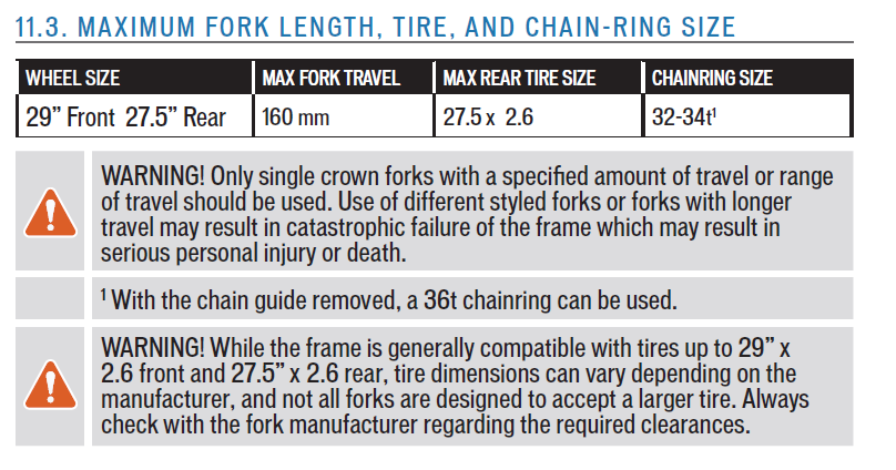

A 104bcd chainring is not offset, the spider (or a spacer) is used to achieve the desired offset. As standard, the Levo runs a 52mm chainline.
The manual calls out that the chain guide should be removed if a 36t chaining is used. There are some adapters available that allow you to run the chain guide with larger chainrings.

I installed a 36T today, I was in a rush and saw your post so simply just cut my new chain to 120 links, everything seemed to work out OK in the stock position. I'll have to flip the chip and see if a 118 length is really needed. I would imagine you could get by with maybe playing with the B tension.
When I installed my 36T today I didn't remove the factory chain guide and I had zero issues. it's on a sliding rail, I simply slid it up as high as it would go, tightened it down, and it looks just fine with enough clearance that I'm not worried at all.
@ruppia I think you'll be just fine, worked for me with no special modifications

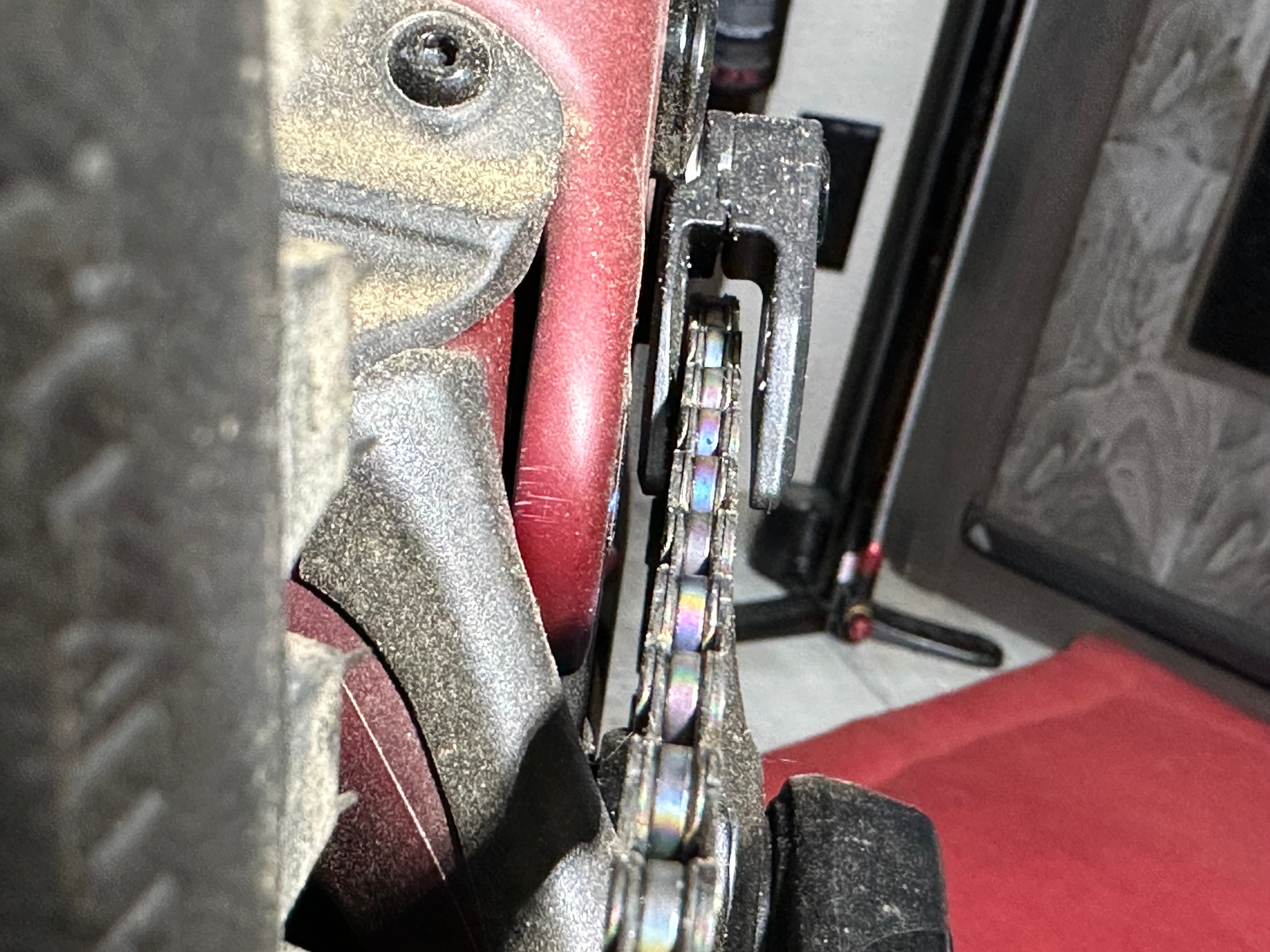

Btw, here’s a couple quick pics showing the stock chain guide with a 36T chainring.
It’s not touching the chain at all but I’ll probably remove one of the spacers/washers to bring it a tad inwards towards the frame so it’s more centered.

Maybe consider getting rid of the chain guide ?
I have done 2.200 miles without - combined with both 36T and 38t chainring
Never lost a chain 😎
haha yeah to be honest, on my other bikes with the clutch derailleurs and a narrow/wide chainring, I'm fairly certain a chain guide isn't needed.
But, it's also not in the way, it fits without issues, so I'll just leave it or now.
But yes, I completely agree, most likely not needed :)

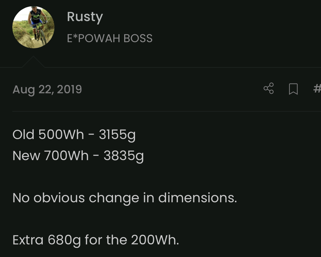

What is the weight difference between the 700 and 500wh battery?
Around 700 grams. I run both in my Gen 3, 500wh battery makes a noticeable difference to the handling.
