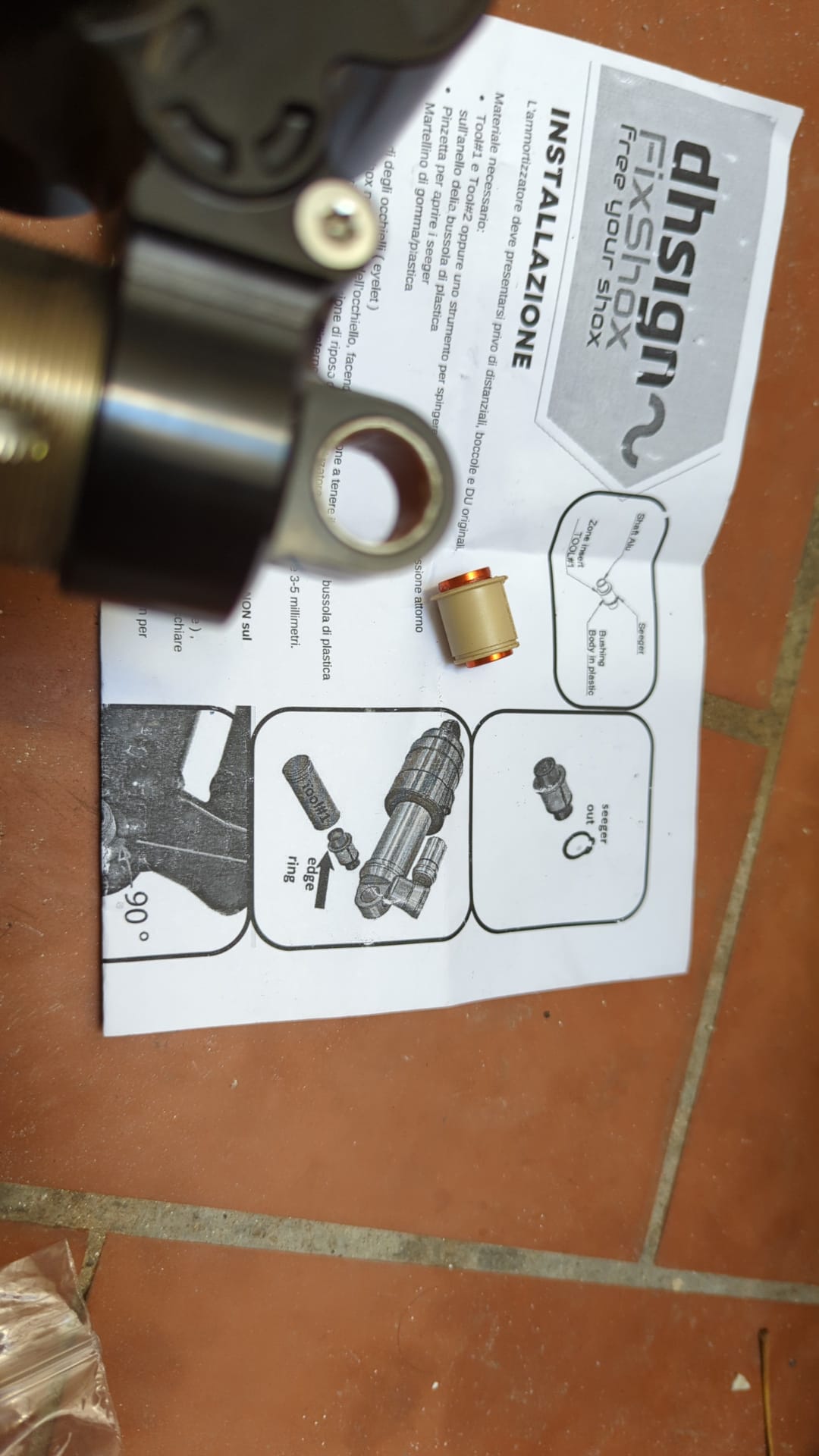

I will probably need to ask the shop to install it as I even miss the tool to remove the bearing which is still in the shock eye.
But have the little think alreeady on my other shocks.
