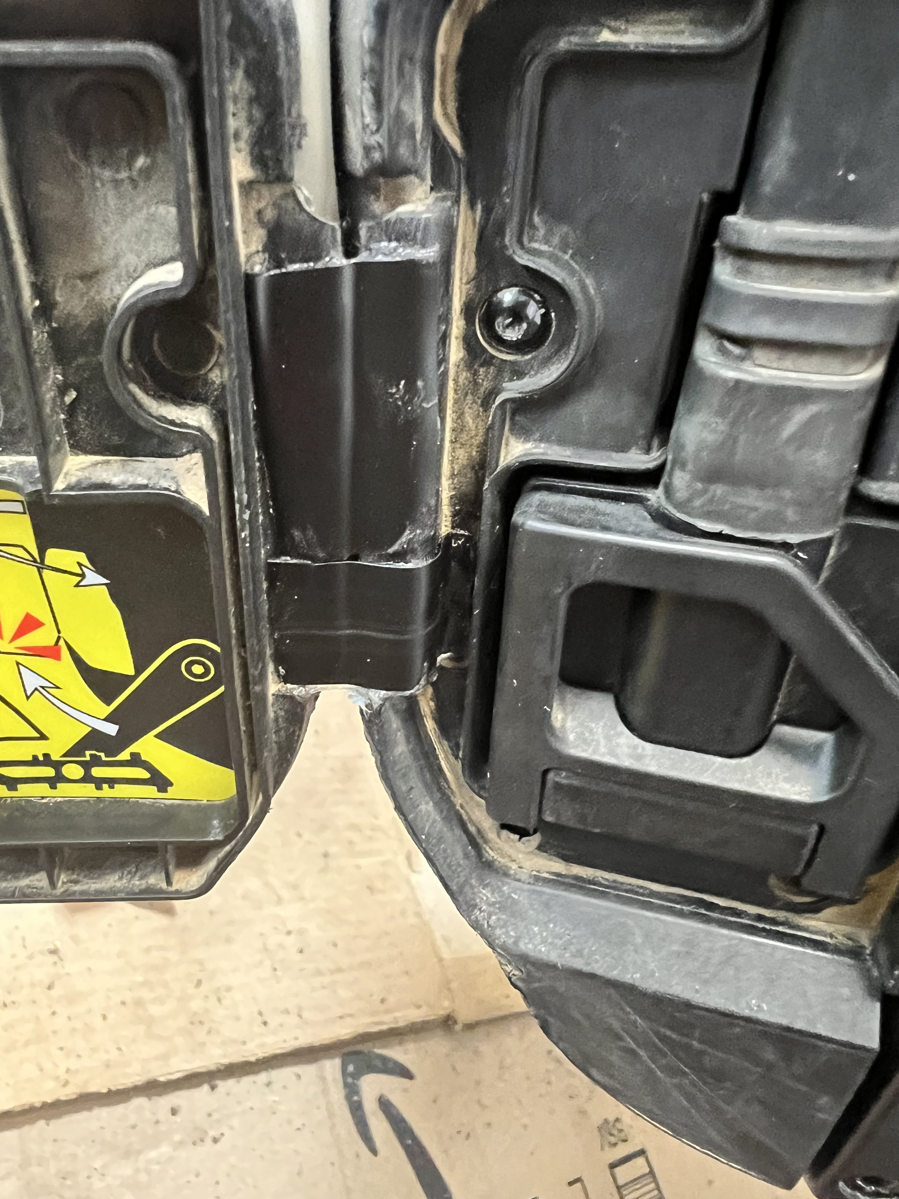

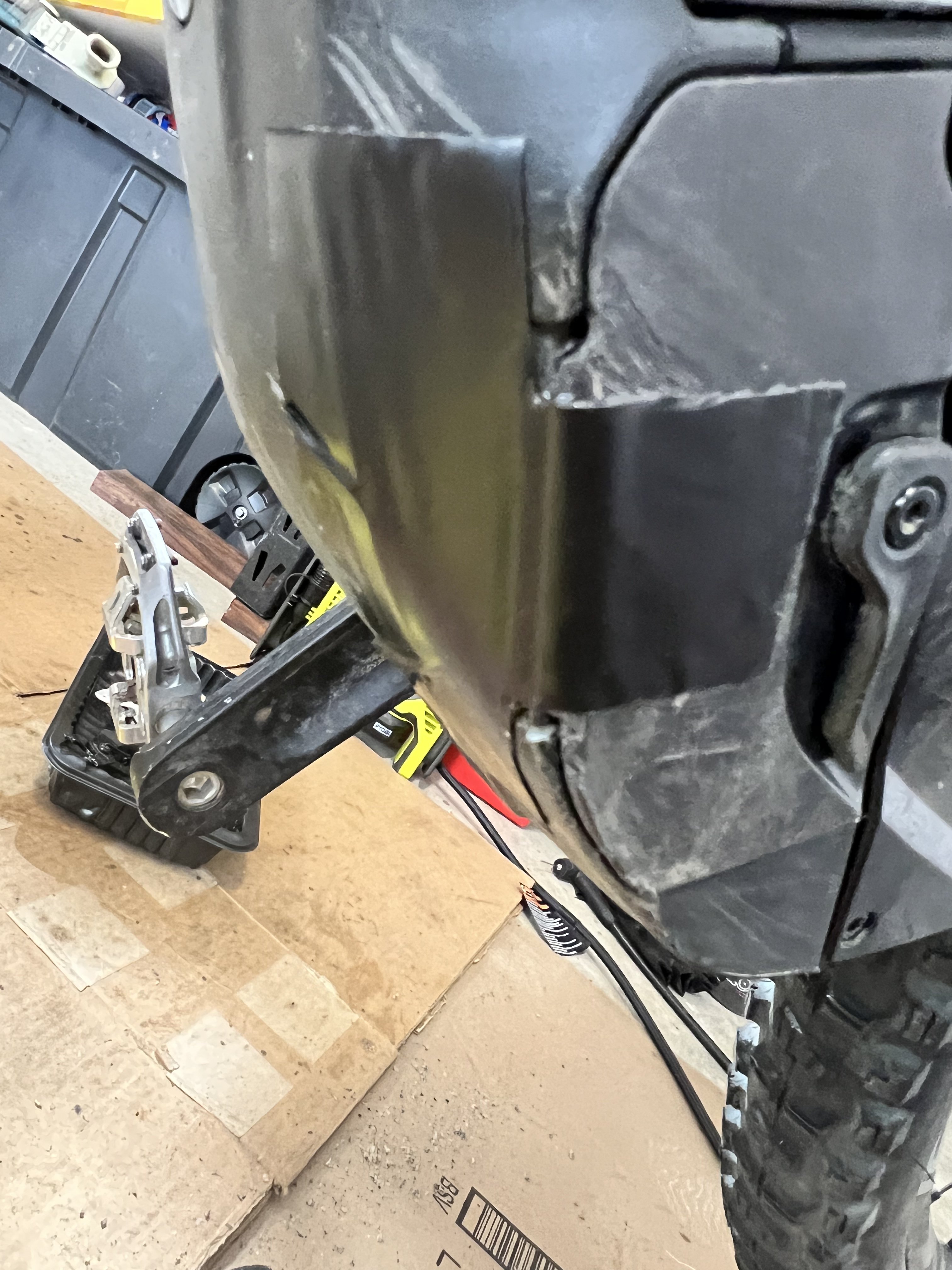

Stupidly broke off my charging port door dropping the battery for the aforementioned bearing service. Duct tape and 20mil tape didn’t work well but black Flex-Seal tape repaired it like a charm. This will easily hold until I can get a replacement.
6384644A-7C5C-4741-B35E-243860DDD023.jpeg 34E08C7E-866D-4D7A-A443-39585CA4EAB4.jpeg

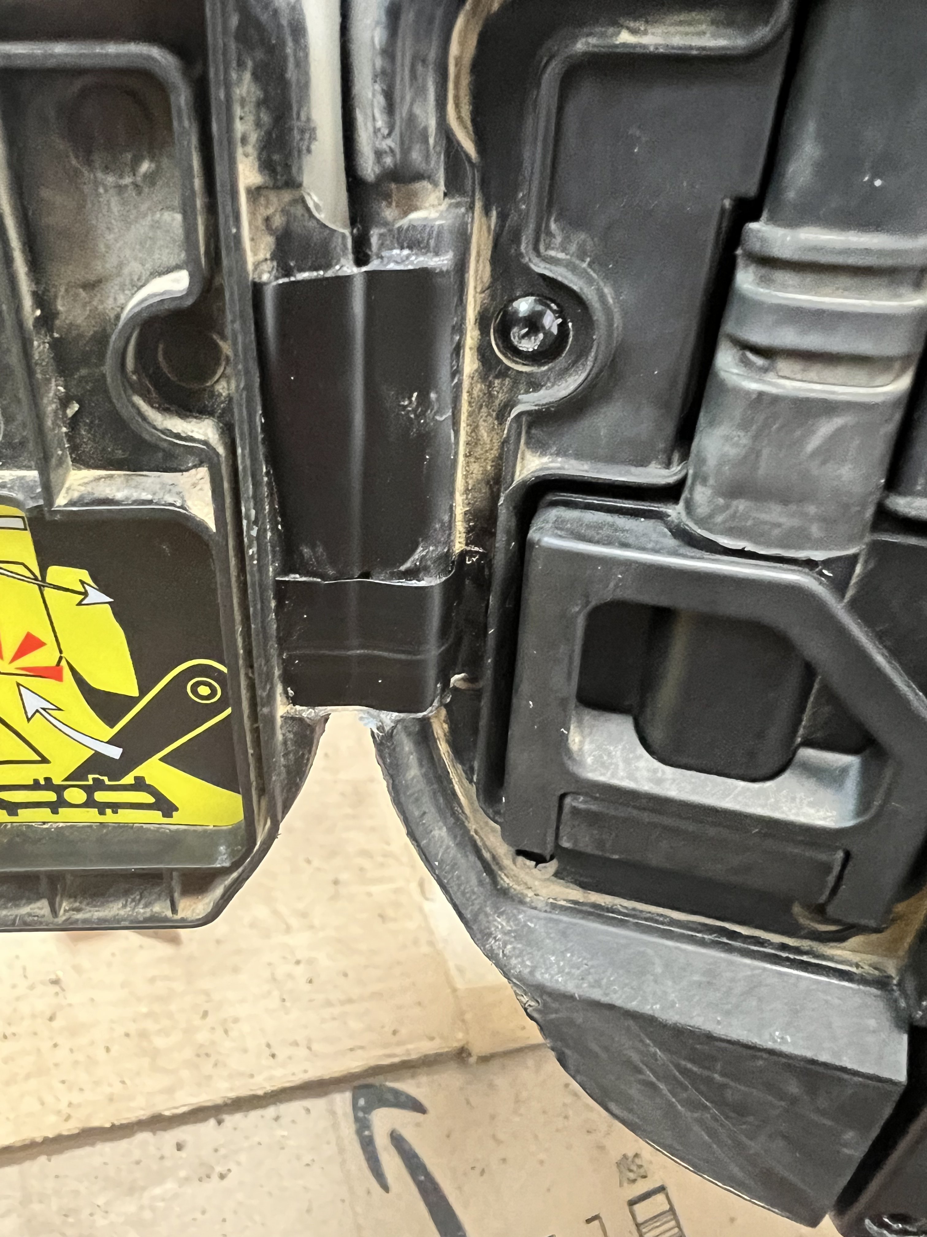

View attachment 113642 View attachment 113643
Replace with the updated version...
Specialized S229900031 MY22 Levo Gen 3 Rock Guard Door Kit V2 Hinged Version​
