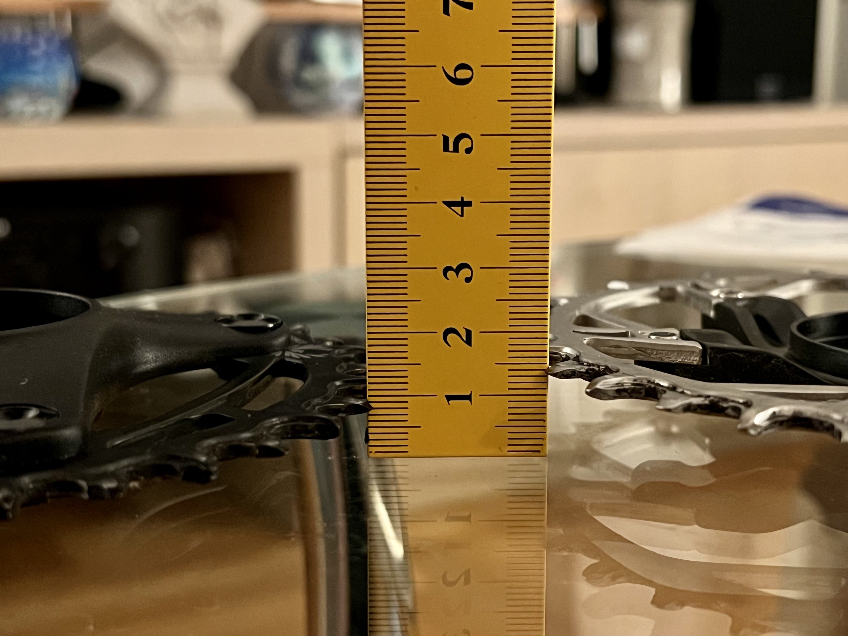

This is a more sensible way to measure the difference! Pic shared by another person going through the same pain! ;)
Ok I was able even to film what's going on while I was shifting from bigger cogs to smaller ones in here. And SRAM came back with the following response:
Hello,
Thank you for reaching out to SRAM Rider Support. I am sorry to hear you are having trouble with your new Transmission kit.
Just so we are on the same page when you say the shifting performance is bad, would you be able to give me some details about some of the symptoms that you are experiencing?
While that bike has a Brose motor and we make a Brose-specific e-bike kit, based on conversations with Specialized, the Levo's motor and frame are offset, making the kit incompatible with the bike. The motor sits a couple of millimeters toward the non-drive side. In talking to our product development team, when you put the Brose-specific chainring on the Levo, the resulting chainline causes significant shifting issues, which is likely what you are seeing.
Additionally, because of the offset, while you may be able to install the Brose cranks on that bike if you compare the cranks that come stock on a Levo versus the Transmission cranks, you will notice that the Levo-specific ones are designed to compensate for the offset of the motor so the rider still sits more centrally over the bike versus being more towards the non-drive side. Because the chainring/spider mounts directly to the motor, you would be able to use your original cranks instead of the Transmission cranks.
I appreciate you sharing which model of Levo you currently have. Based on Specialized's specs, that bike should have come with a 104 BCD chainring spider. In order to get the correct chainline, you would want to use the spider in combination with a 104 BCD T-Type chainring. Below is the part number for the correct chainring.
Compatible chainrings:
11.6218.057.000 CHAINRING T-TYPE 34T 104 BCD STEEL BLACK
Your local shop/dealer or favorite online distributor would be your best resource for ordering the part. If you are installing it yourself, here is a link to our Transmission welcome page. The page includes lots of information about the installation and setup of the new drivetrain.
I hope that helps answer your question. If you have any additional questions, please don't hesitate to reach out.
