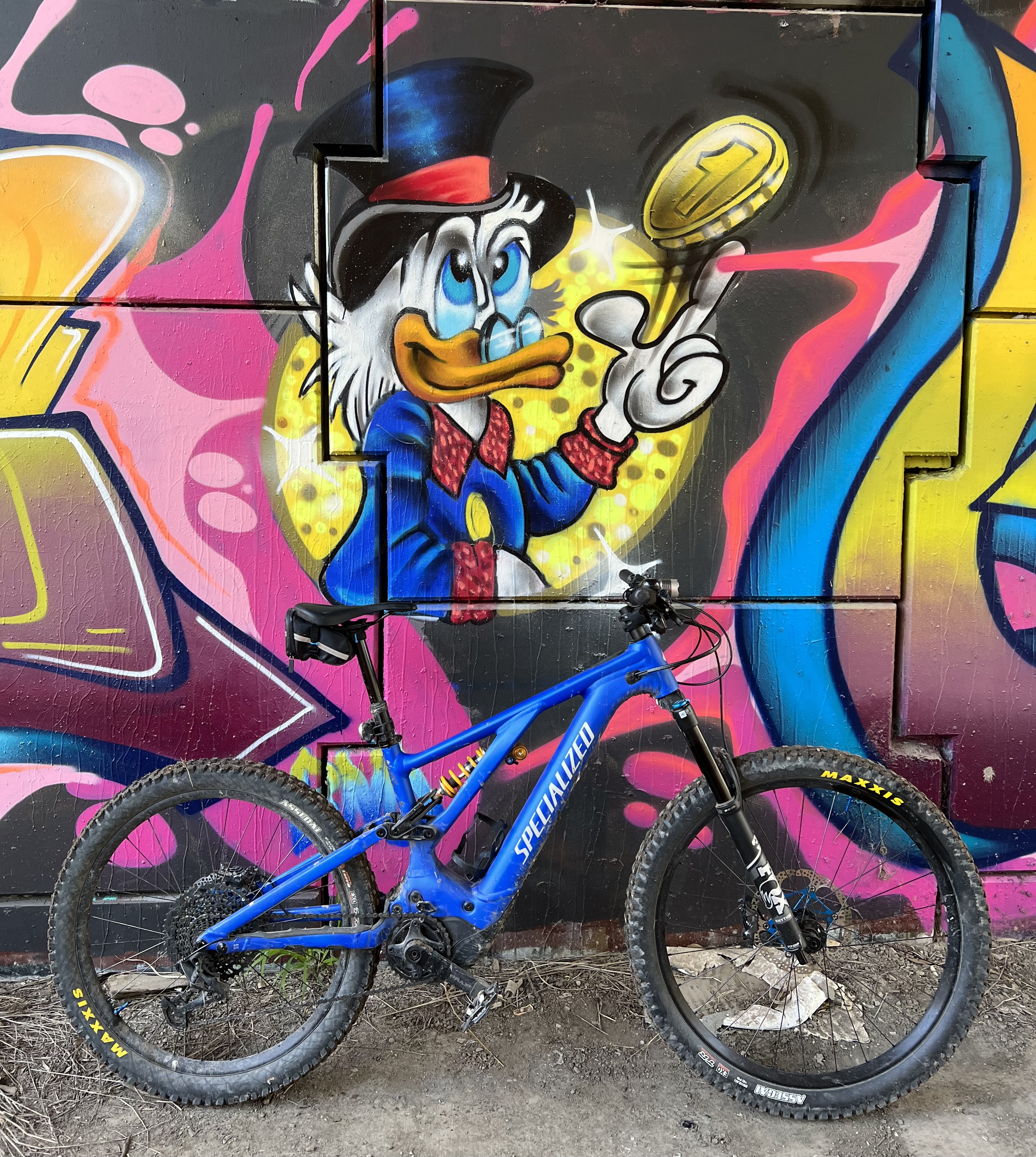

Ozmtb
Apr 7, 2023
12
3 months in and still having a blast riding this.
