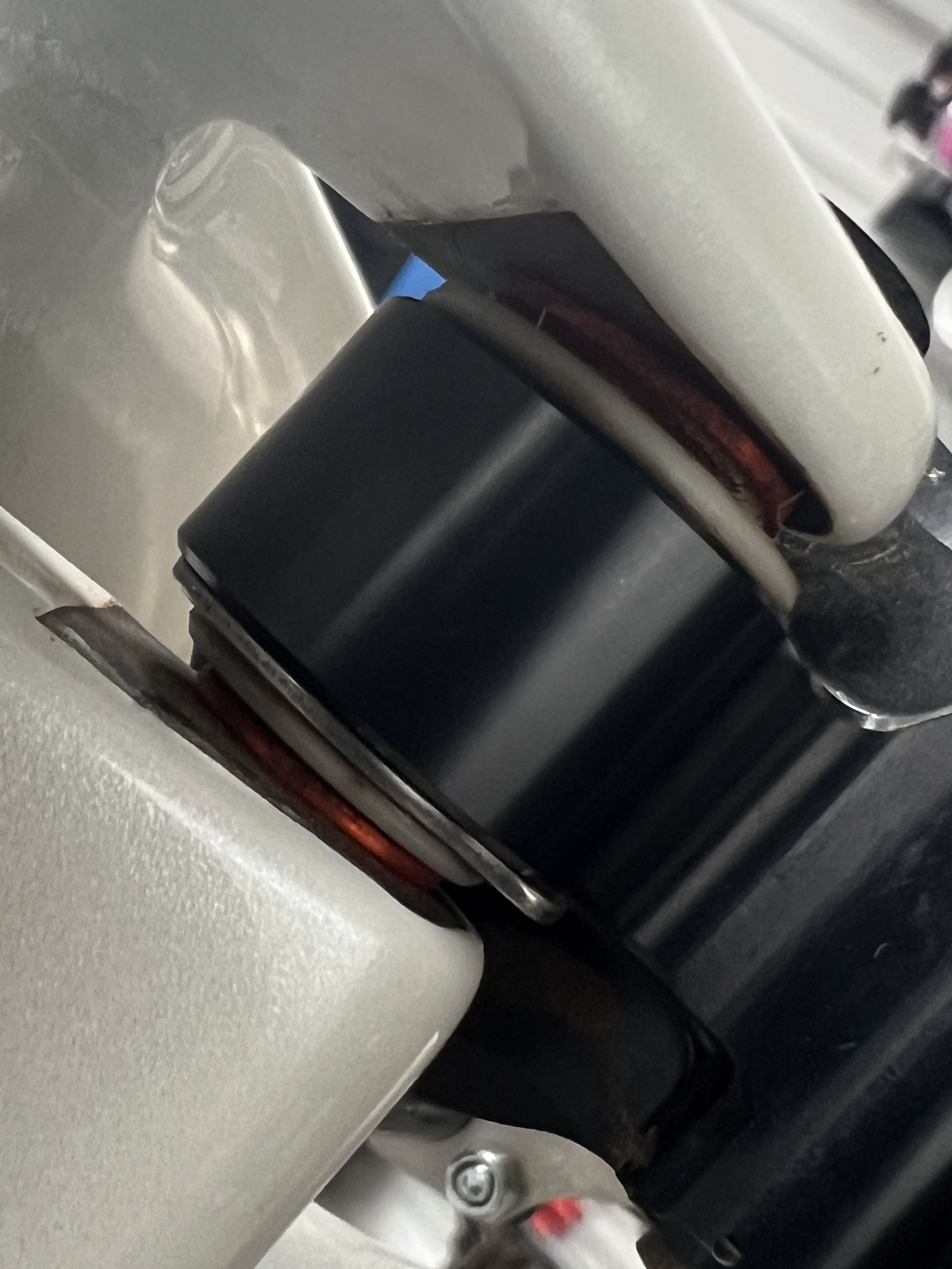

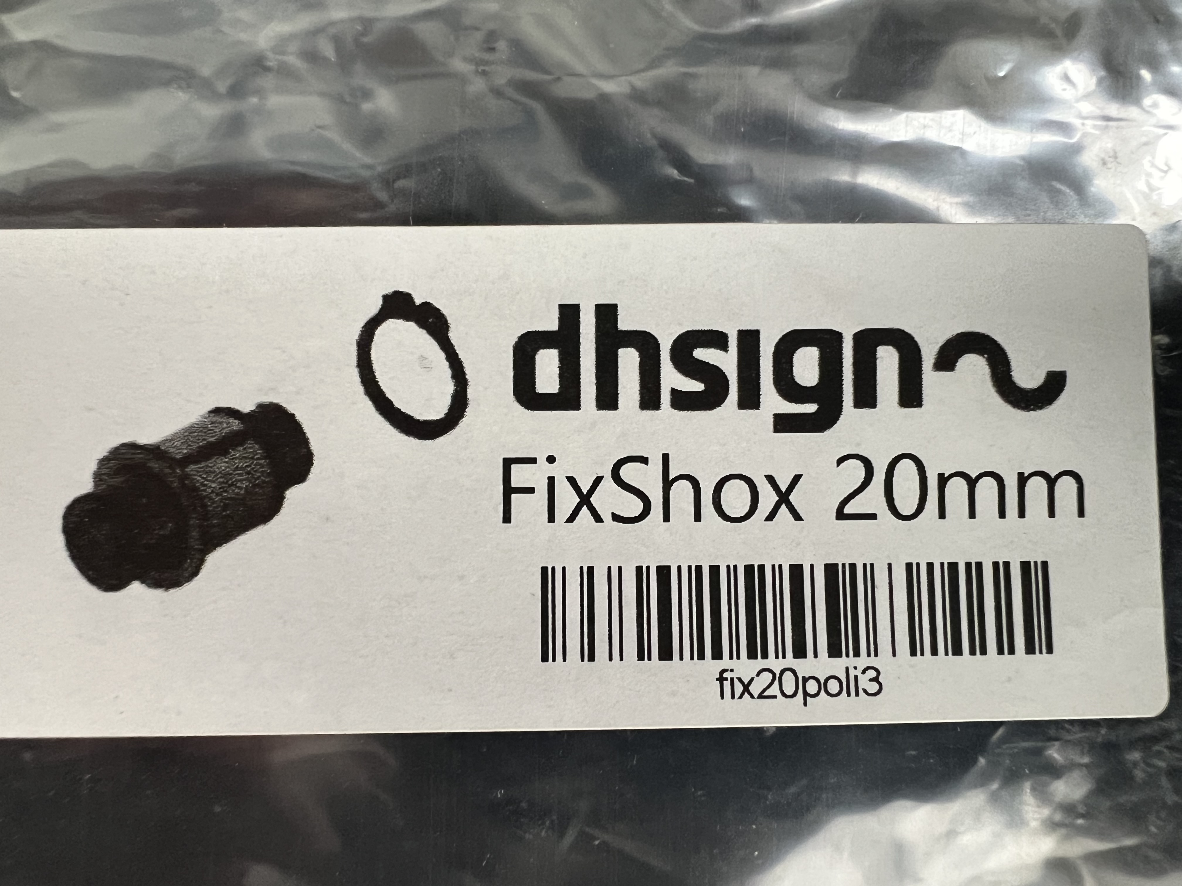

Did I read somewhere that there is an offset bushing that negates the side load on the shock?
Ou812
Jun 26, 2022
861
651
Inverness
I believe this is the one that a few people suggested.
AlumiPro
May 1, 2023
224
220
California

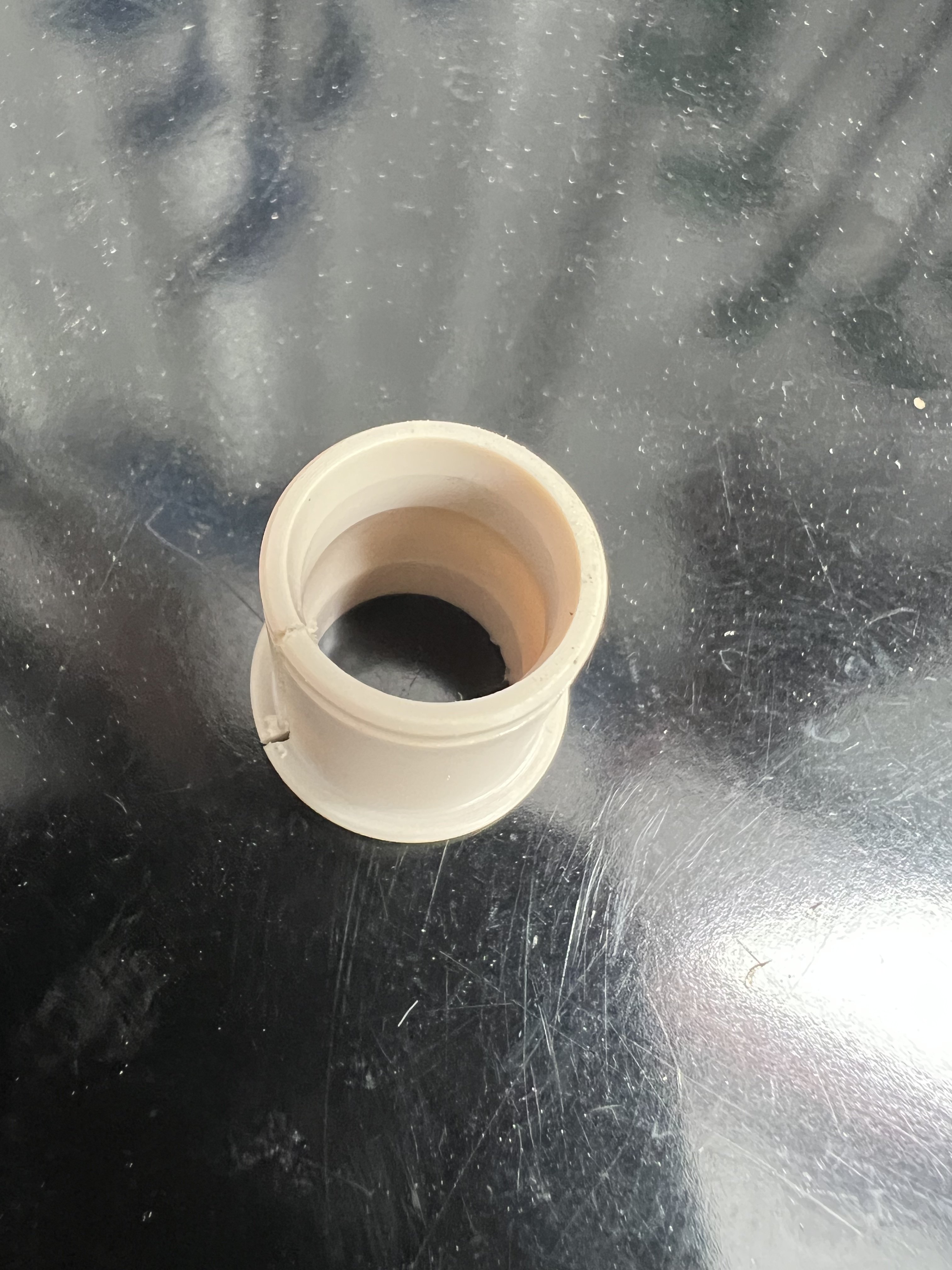

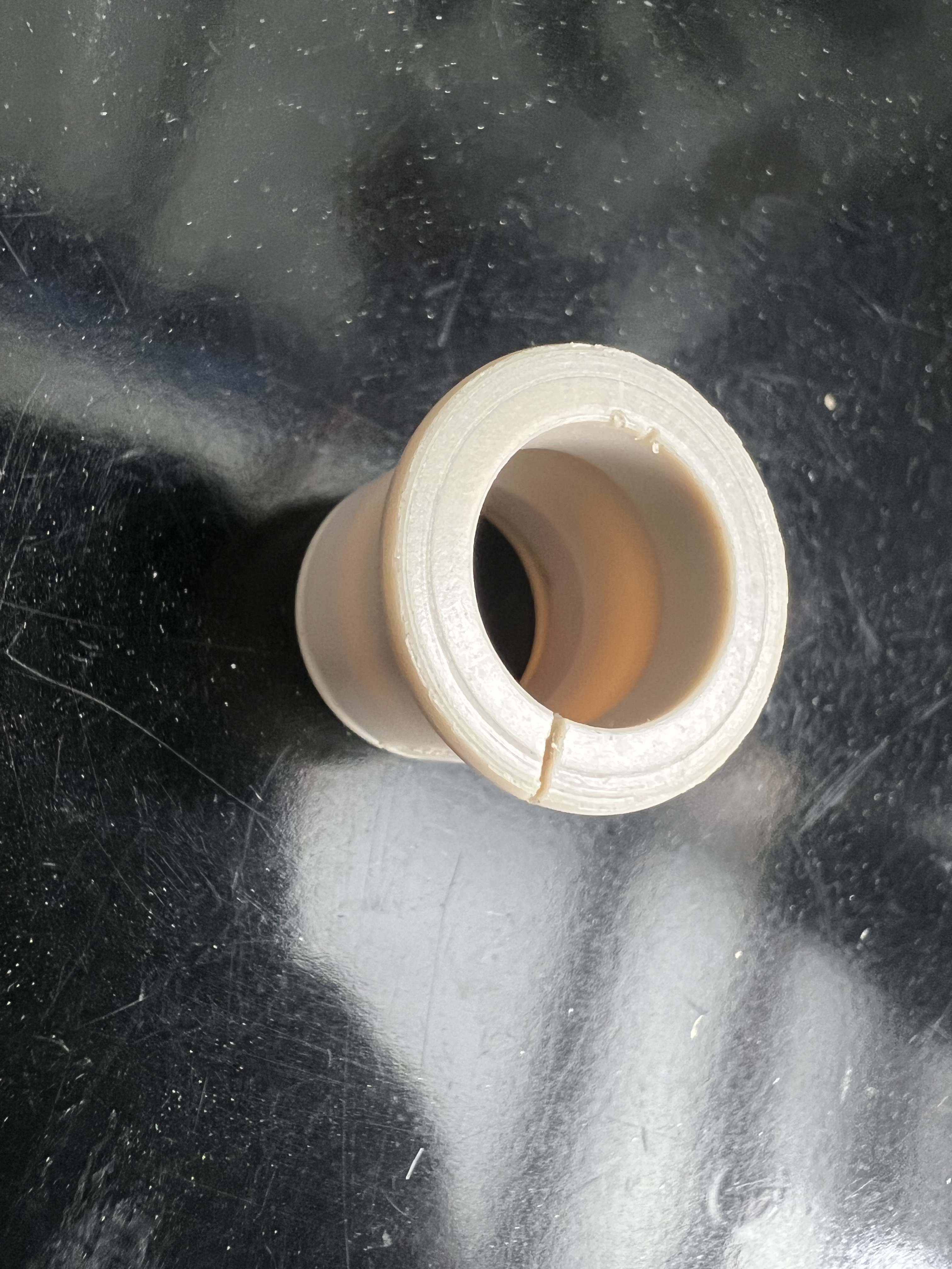

So what is it doing exactly?
Moving the shock mount slightly to one side?
No, it’s acting like a uni-ball or ball joint to some degree. The inner orange sleeve has spherical movement inside the outer bushing, instead of it only allowing it to rotate inside the outer sleeve (like a standard bushing would do) This allows the shock to move freely between the frame and the second point of engagement.
They send a second/extra outer bushing, see attached pic to see the inside of it.

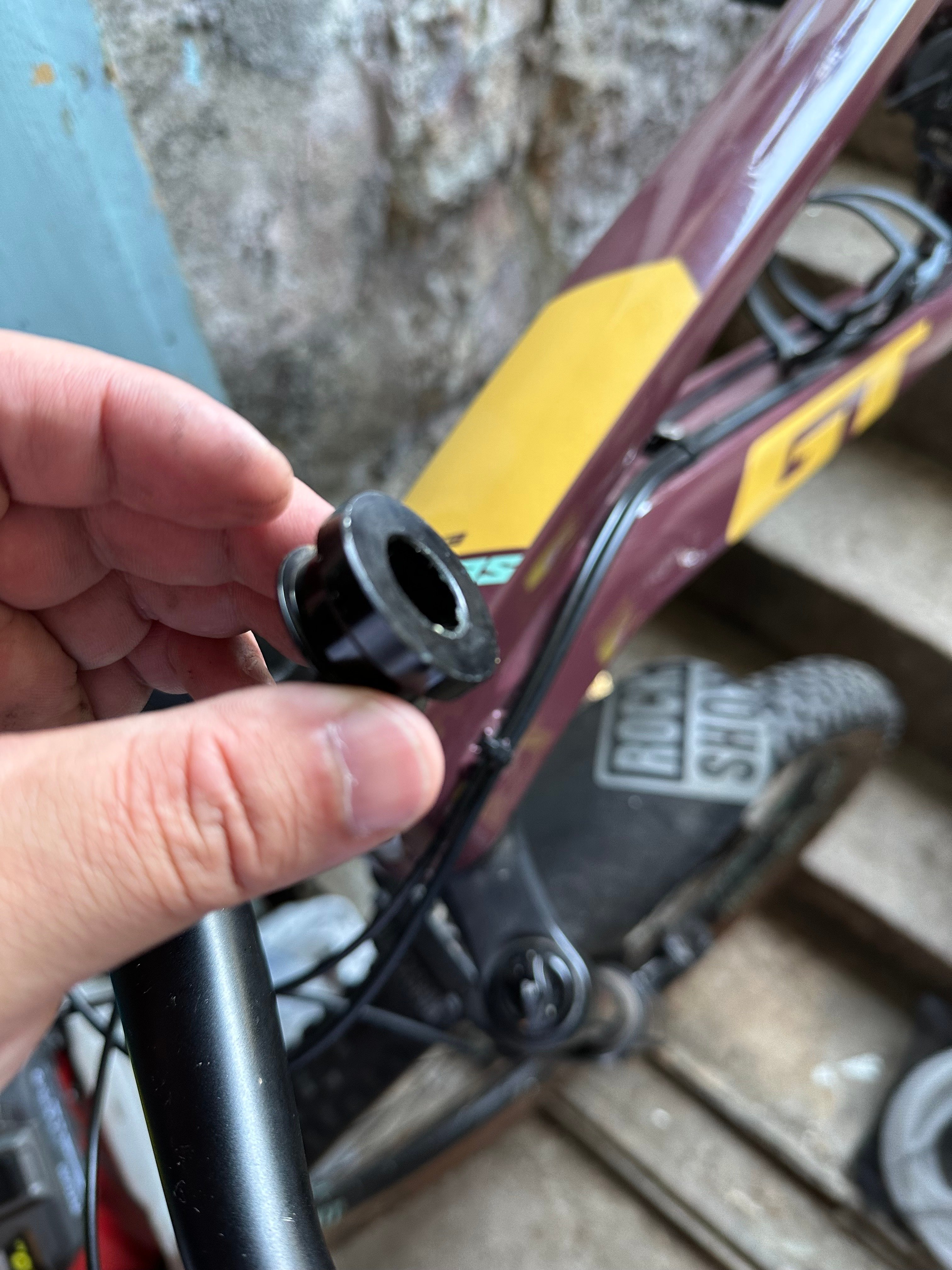

Thanks for that link, I'd heard about those before I got my Levo and forgot about them. Just ordered 1. Push does the same thing on their current 11-6. EXT does on some of their eStorias but I think maybe not on the Levo for some reason.
You want the one he linked, the 8x20.

I have it aswell, no problem so far, going to Finale Ligure tomorrow for a proper test! Yes it allows rotation on the other axis to compensate for twisting forces, it has a spherical joint
How did it perform at Finale ?
trx
Dec 5, 2022
31
27
Milan
Flawlessly, actually the whole bike was a riot coming down Rollercoaster, so good! Also did some more rocky trails near Savona and can’t complain, actually the only thing is I need a bigger water bottle 😅.
