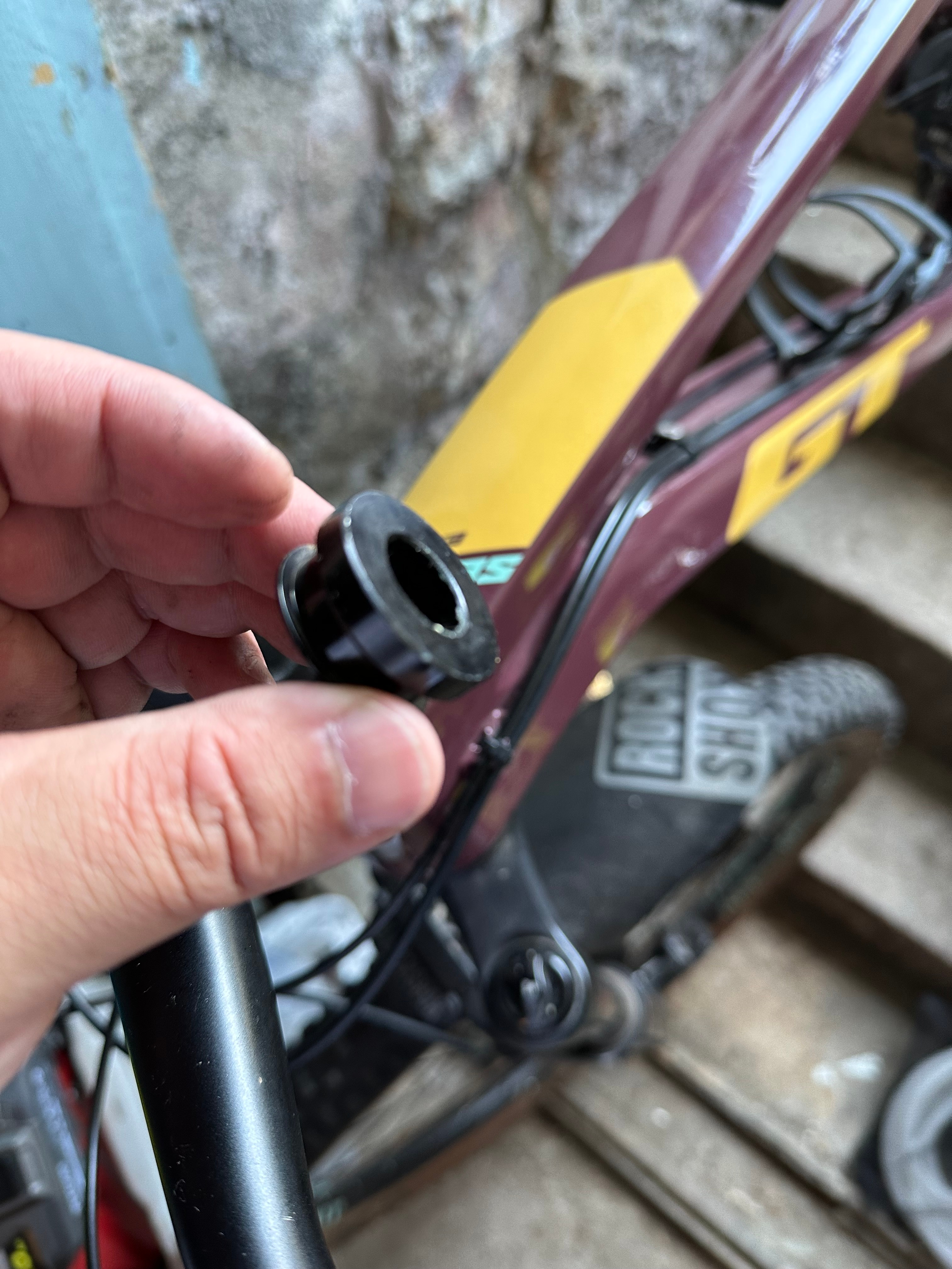

It is a 29" fork, what I mean is that the wheel has this. View attachment 120601
Yep, torque caps, as others have said.
I tried to find some hub adaptors for the factory stock hubs when I tried fitting a Fox 36, which apparently are a thing, but failed spectacularly.
I ended up swapping the Nukeproof Horizon V2 29” front wheel from another bike which has interchangeable hub adaptors, including the standard ones that fit the Fox.

I havent tried popping off the torque cap, but I doubt it works. It looks like a solid piece.
They should pop off the front hub, mine did but were solid so needed alternative end caps.
I spent a few days searching for the specialized part number for the alternative hub end caps, but didn’t find anything definitive or anywhere in the UK that had stock of any of the part numbers I dug up.
I couldn’t even work out who made the stock hubs, but I think they’re Roval?
This is the closest I got to a part number, assuming your front hub is Roval; S175900002

Replaced the wheel. I had an old wheel that I found, but it isnt emtb specific, but I guess it will work. I contacted a specialized concept store here in Norway, and they didnt have the caps. So in order to ride my bike this weekend, I had to replace the wheel. Specialized shouldve provided the caps like they do with tubeless valves.

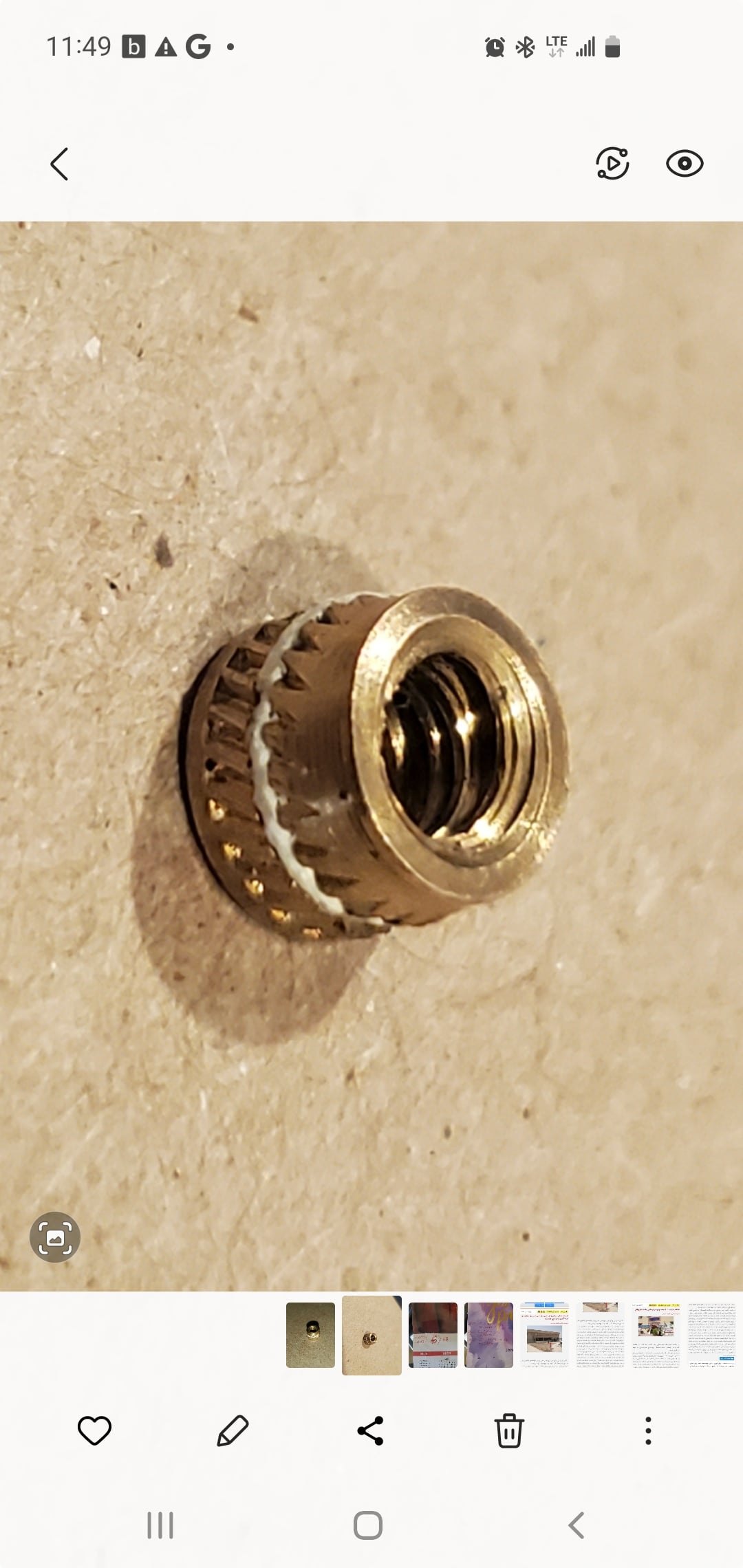

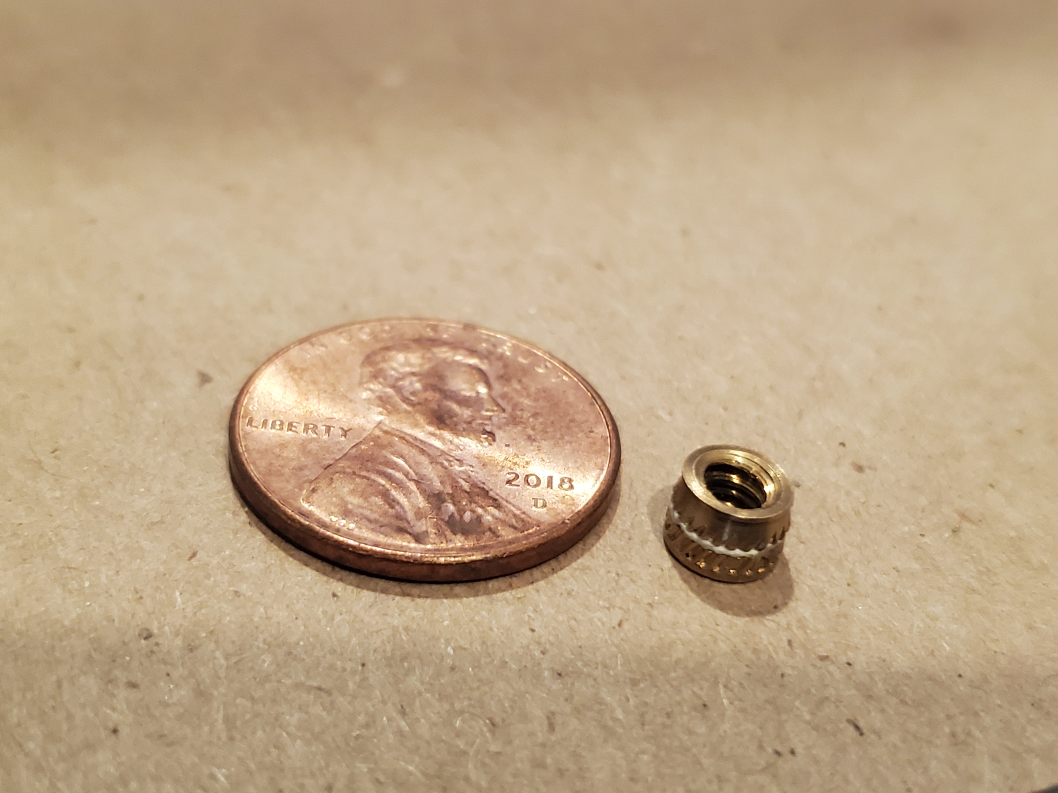

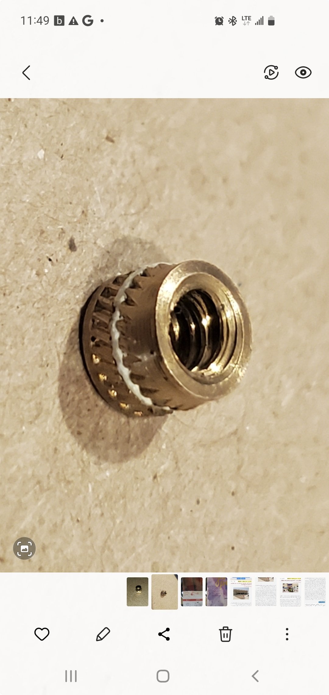

Hello everyone,
New member with a 2022 Levo Comp Alloy.
Does this look like a part that may have fallen off of my Levo?
TIA

Just a hunch, but it could be the insert for the water bottle screws? If this is the female part, it sits in a plastic guide for the dropper cable and it came loose. It’s definitely not a nut, but an insert imbedded in something.

@Chicane, good call!
How critical is this part, and how much of a pain is it to put back where it belongs?
I plan on going for a ride early tomorrow AM and it is hotter than hell out in my garage right now.
Thanks
PS,
I just went out and checked. Both water bottle holder mounting screws are still in place and appear to be tight!

If the 2 screws are tight, it’s likely not from that and could be a leftover insert that fell inside the frame during original assembly. If you haven’t removed any bolts, then that’s likely the cause for it. What place in the frame did it fall out from and were you removing the battery when this happened? I also have a carbon frame, so it may be a bit different. I would double check just to make sure all the motor bolts are tight and all screws for that matter. If so, then you probably have nothing to worry about.

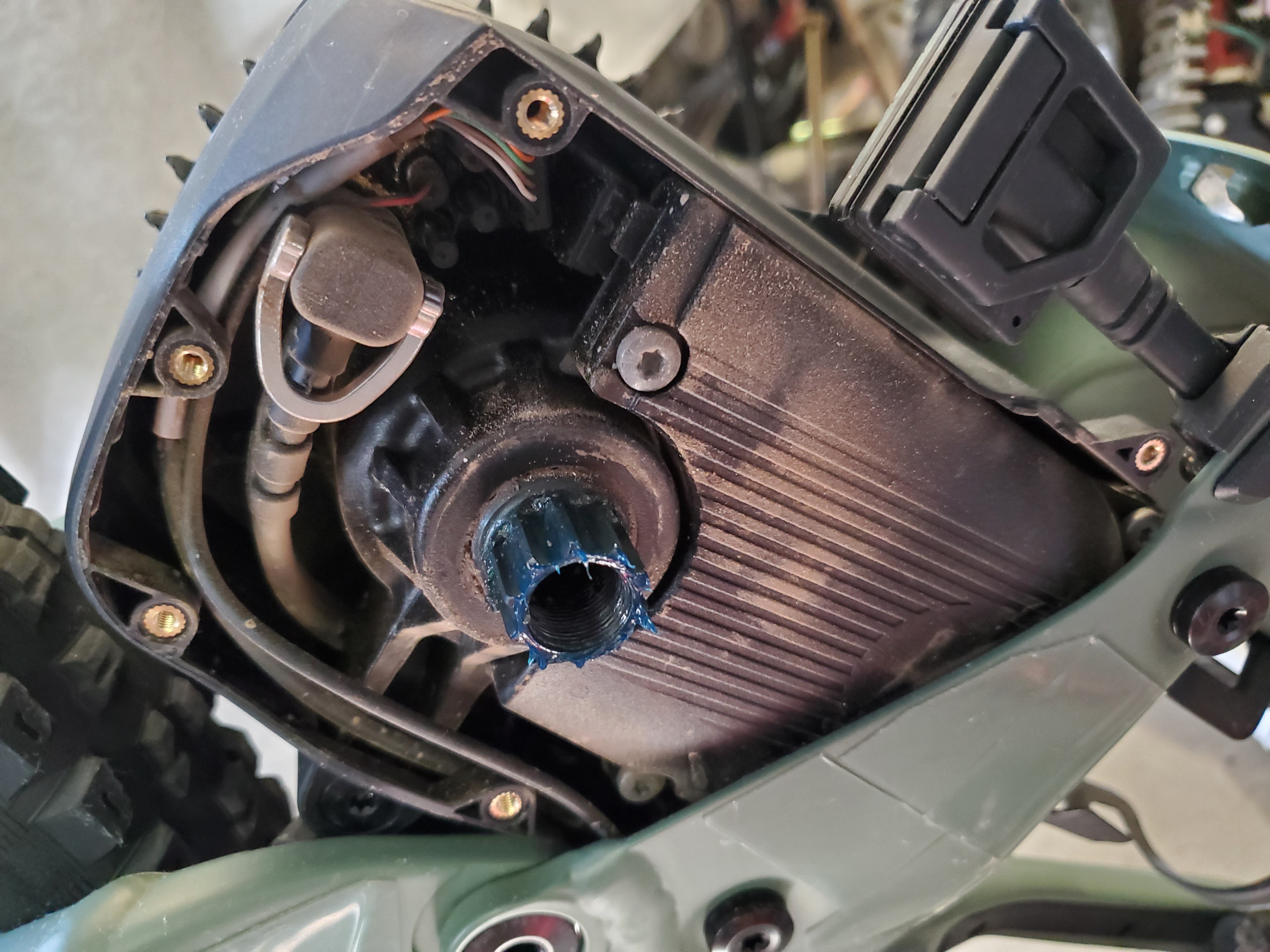

It also looks like the built-in nuts for the motor cover on the non-drive side.
Kudos, that is exactly what that insert is also used for,
However, all 5 for the NDS cover are still in place. as seen in the picture.
So either the one that fell out is an extra floating around inside the motor cavity, left over from the assembly process (somewhat unlikely), or from some other application higher up in the frame.
Also, both inserts for the water bottle cage appear to be in place as well.
Oh, sorry, I missed your questions.
Prior to this, I had never taken out the battery.
My neighbor and riding buddy found the insert in the bed of his pickup truck after we got back from a MTB road trip to the local mountains.
Most likely it fell out from the drain holes on the bottom of the motor cover due to the continuous vibration from riding in the back of a truck for a couple of hours.

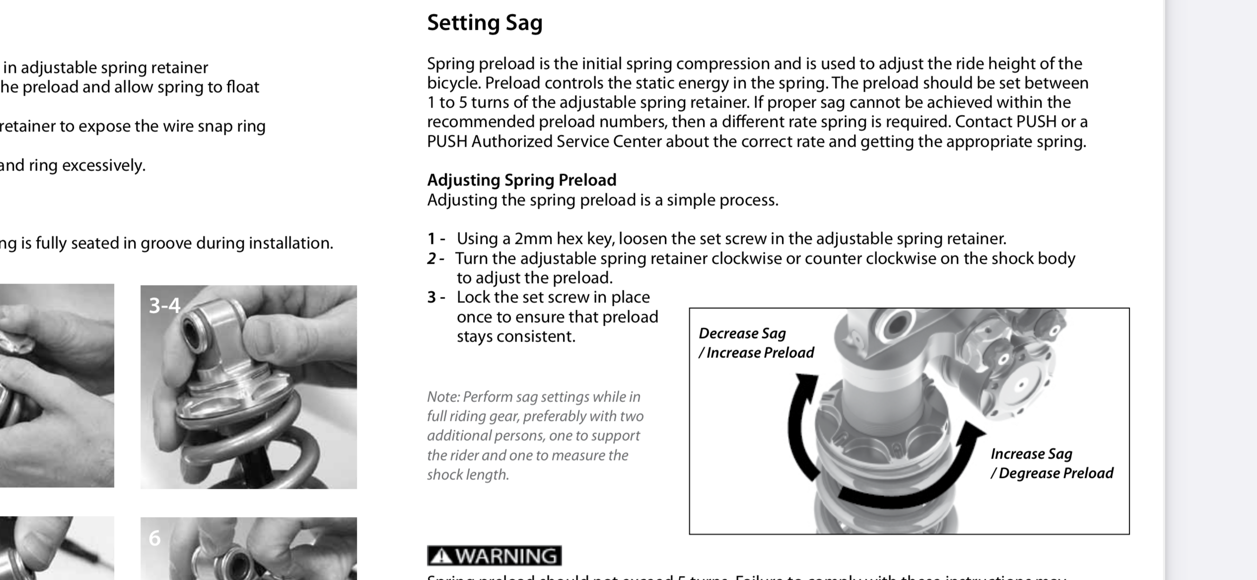

Purchased a new coIl shock (Push Eleven Six), installed and noticed spring can be moved side to side (Slight rattle). Is this normal? It’s suppose to have everything setup (for bike, rider weight, riding style) but perhaps preload was not setup?
I’m not sure I fully understand the way you are describing the problem. However, it sounds like your preload collar is not set properly and is too loose. Allowing the spring to move freely. You need to follow the instructions in the manual for setting the preload. Once this is done the spring should not rattle.
Thanks. I’ve now adjusted the preload and tightened the set screw. Seems 11/6 missed this step.
It's not really possible to set the sag up properly without the actual bike and the rider. It's the whole process. Based on your comment thinking Push should have done this for you, I have a feeling you didn't set it properly just yet.
Per the ElevenSix manual: "Note: Perform sag settings while in full riding gear, preferably with two additional persons, one to support the rider and one to measure the shock length."
