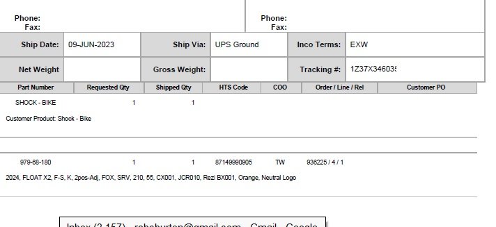

I was on the Fox website and filled out the online form. I received an auto email and a day later I received another email from a tech letting me know that they are just going to replace it with the 2024. Fill out the form instead of just sending an email if you haven't done that yet. The difference between the 2021(?) that came with my 2022 Turbo Levo and the 2024 is night and day.
A 2024 or 2023? I just ordered the redesigned 2023 first I've heard about a 2024..
I removed the personal information but this is the slip that came with the shock.
