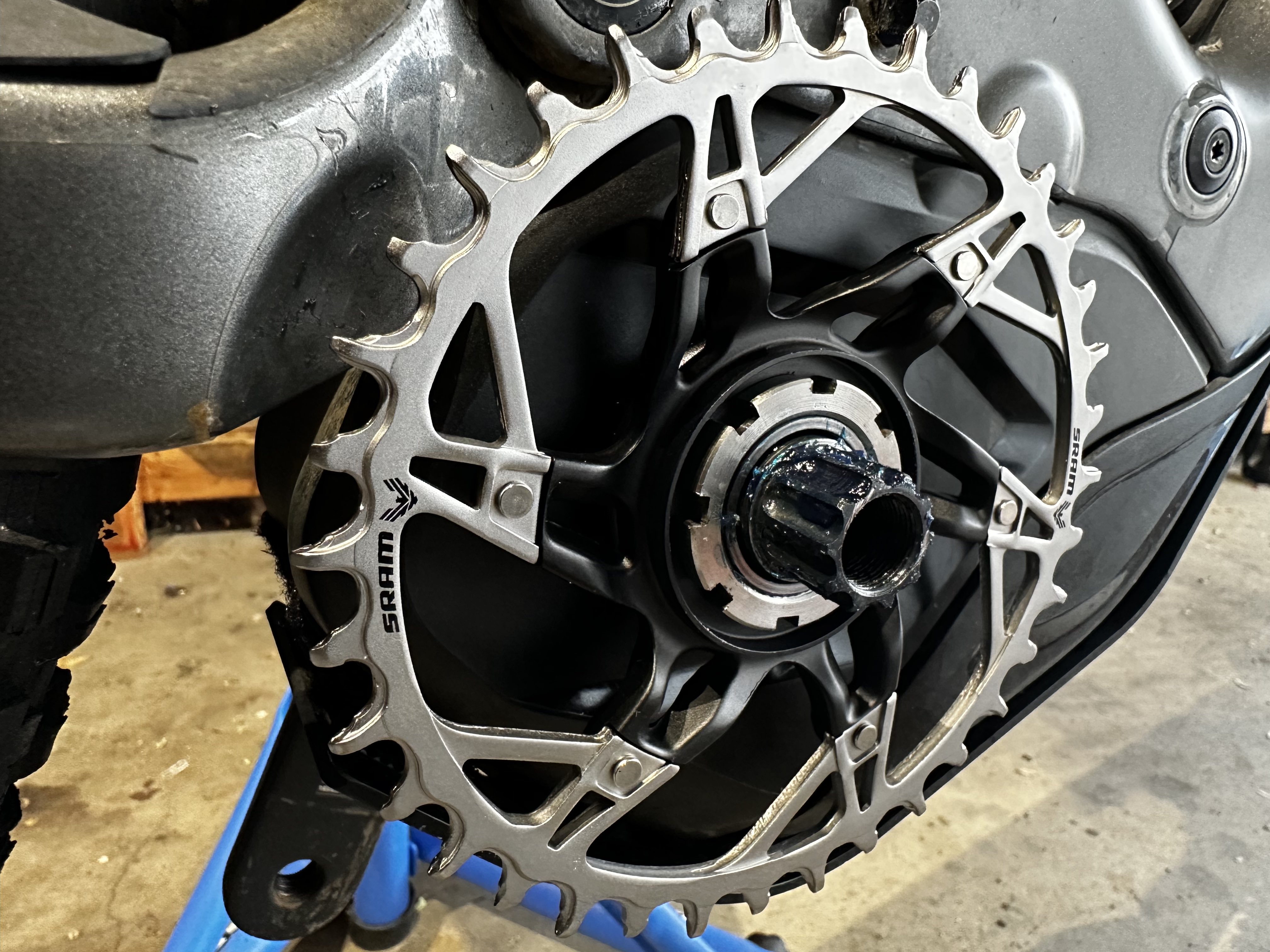

I just installed on my Levo Gen-3 Sram XX Brose Kit transmission. I installed brosekit DM chainring - followed all the instructions and reinstall probably 5 times just to make sure I did everything correctly following every mm of guides and instructions also tried micro-adjust but the shifting performance is so awful. When it shifts under pressure from bigger cog to smaller cog - it snaps with this clink sound that is very disturbing and when in reverse it shifts with awful sound but not snapping. Guys any ideas what did I do wrong, did you have similar experience? Thank you.

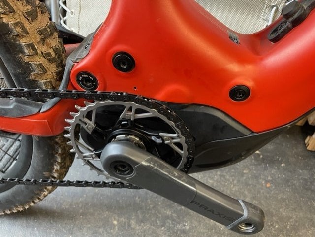

Okay this is what we know in regards to SRAM transmission on Gen 3 Levo. The Levo has a 52mm chain line, this is set by the position of the motor in the frame and the offset on the spider. If you buy the groupset with a 104BCD chainring you will be running the same 52mm chain line.
SRAM confirmed that for bikes with a 148 rear axle spacing, the Transmission system will be compatible with 52-55mm chain lines. There should not be any noticeable difference in the wear and lifespan of the components as a result of the chain line.
Due to the position of the motor in the frame, if you use the direct mount chainring you will end up with a 57mm chain line. You will also find the SRAM cranks don't cater for the position of the motor in the frame, resulting in the wrong offset on the cranks and a wider Q-Factor.
Some people are modifying the direct mount chainring, removing 2mm to give the perfect 55mm chain line, others are using the 104BCD chainring with a 52mm chain line. Personally, I'm running an unmodified direct mount chainring with zero issues. I did end up going back to the Praxis cranks to get the correct Q-Factor (not that I actually had any issues with the SRAM cranks). All the journalists (including Rob) were running a DM chainring with SRAM cranks on the Levo, I don't remember reading any negative reviews...

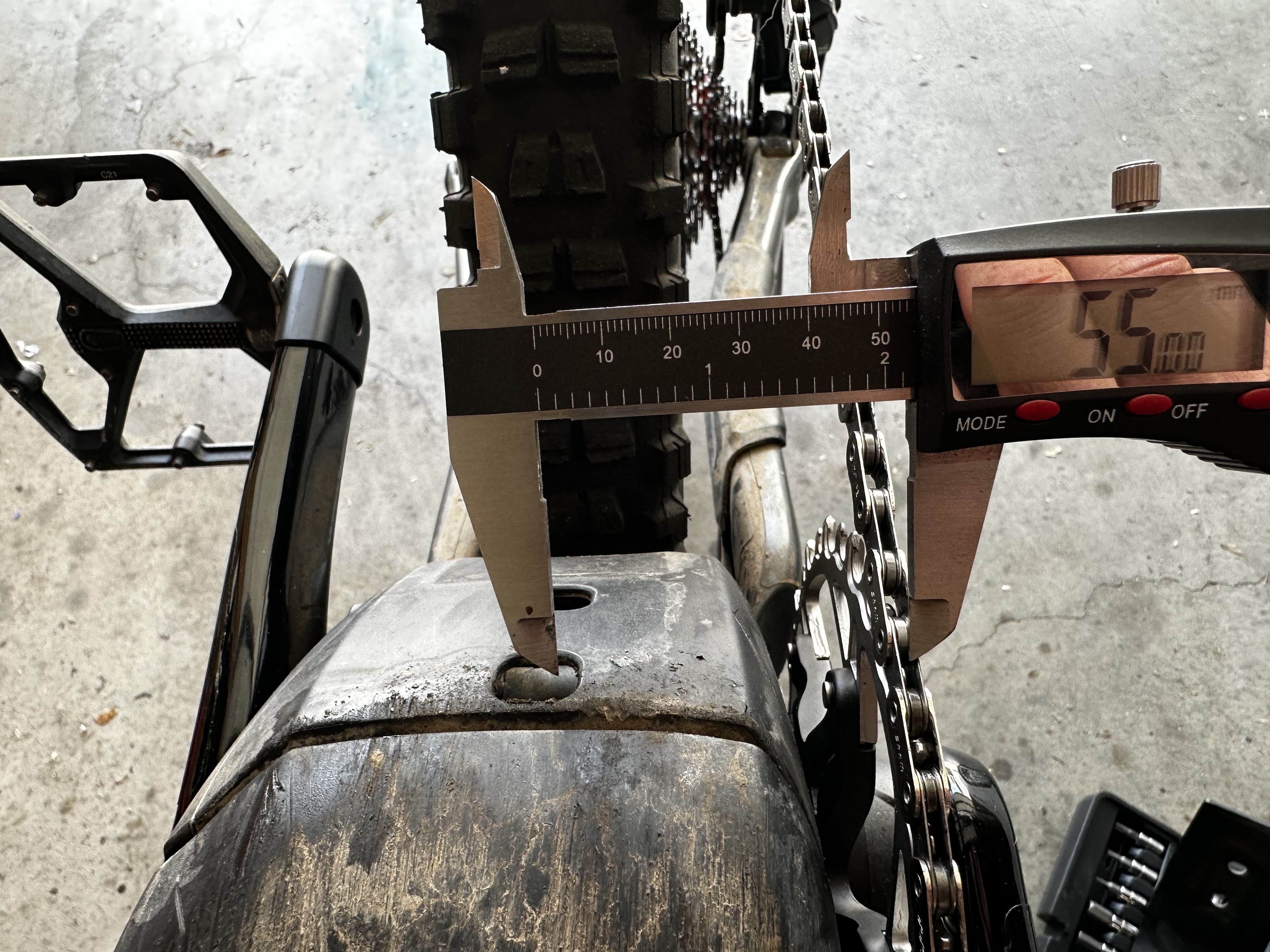

Thanks a lot Rich-H! Oh wow I thought it would be 55mm from your previous posts but thanks for clarifying about "position of the motor" as I measured yesterday chainline and it's definitely more than 55mm. Regarding cranks I tried both to be honest didn't feel the difference in the backyard but definitely will post when I try them on trails. So I'll try to shave 2mm from the DM brosekit chainring - will provide with an update. Thanks a lot!

Not the best picture but I reckon the center of the motor drain hole is the centerline of the frame. I'm off by approx 2mm.

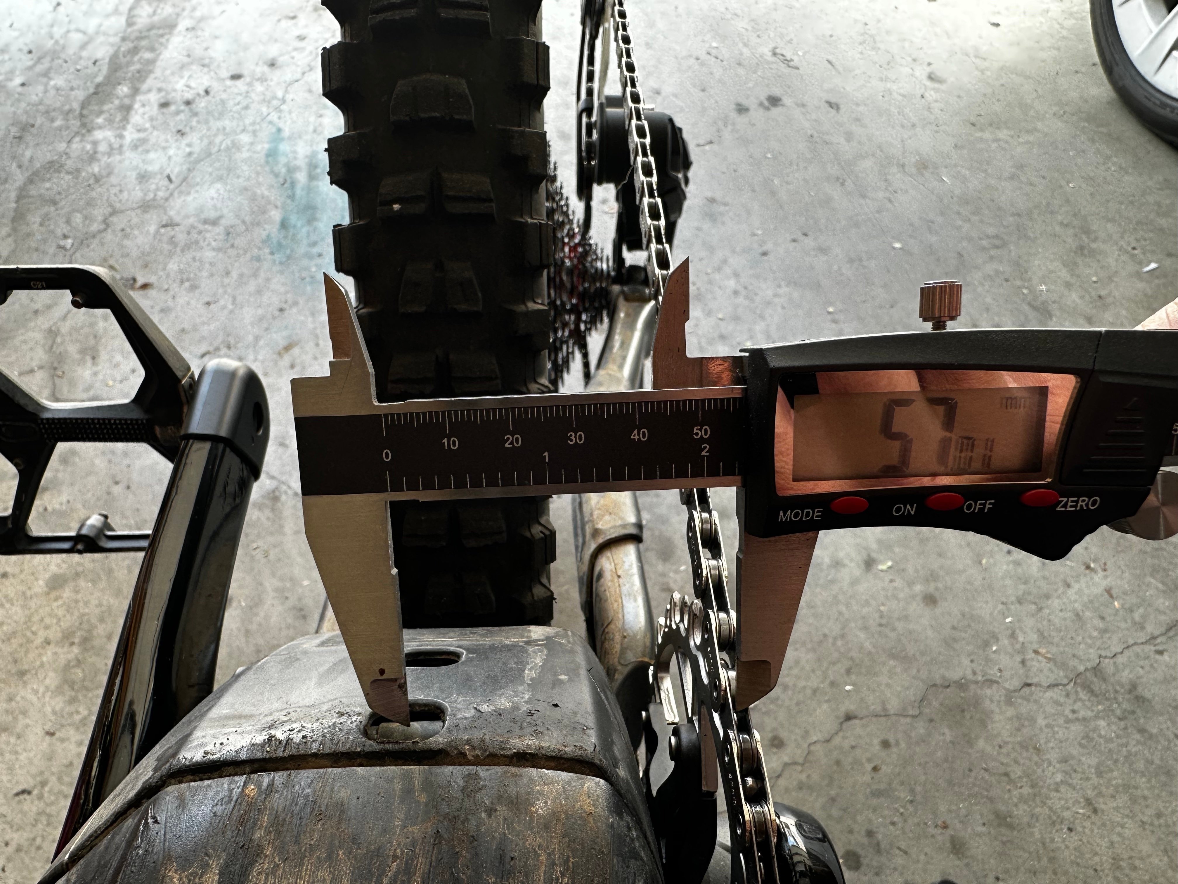

georjetto
May 11, 2023
United States

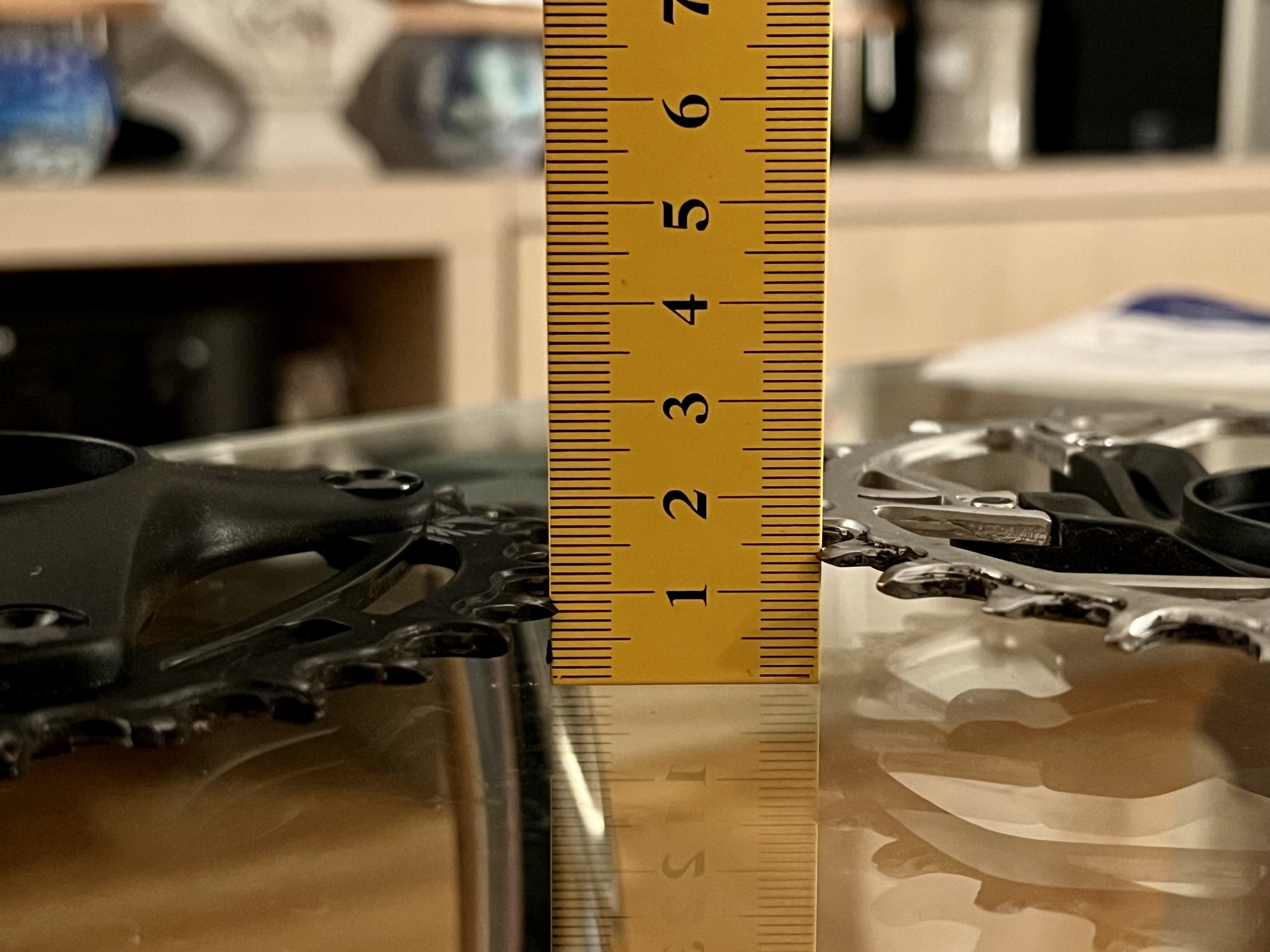

Thanks for the image - yeah as you can see it's exactly 2mm to get to the real center. Here are my measurements for 55m and 57mm. I think you are right chainline just with DM chainring is 57mm! But our measurements are subjective :) because of the angle that you can create...

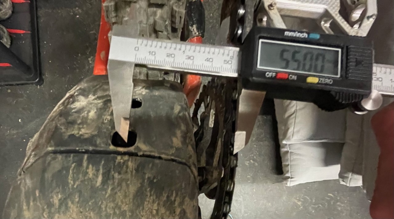

Rich-H
Apr 3, 2023
153
111
Hampshire
This is a more sensible way to measure the difference! Pic shared by another person going through the same pain! ;)
