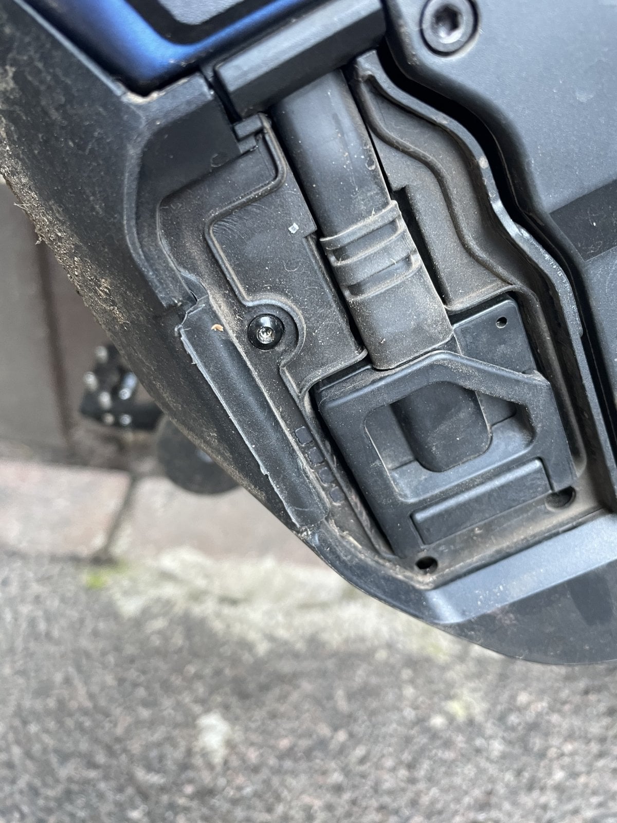

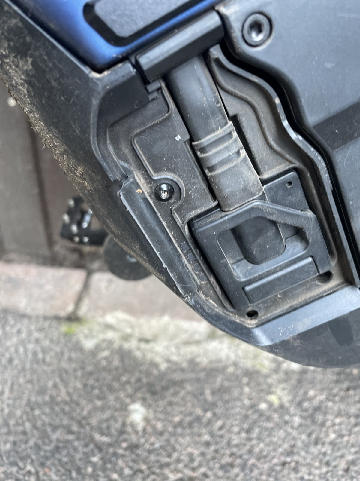

Hi did you get this part and if so
Where? I just broke mine the same!!! Please let me know.
thx
Brian
My S-Works didn't even come with it or the LBS broke it when putting my bike together. Been running around with the port area taped up using gaffers tape. I've been waiting for a warranty replacement from Specialized through the LBS for almost a month now...
