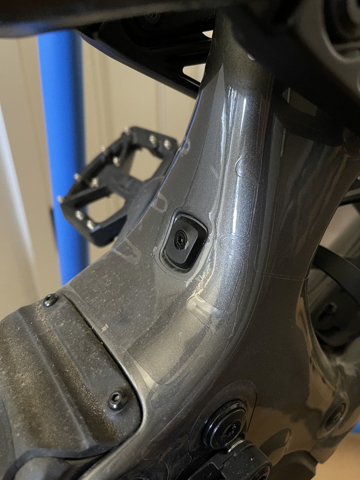

I left mine on. I see it as more protection but it’s going to look messy on the rear triangle or anywhere the existing film is. I just use my heat gun to make the Ridewrap pliable around the existing film. Seat tube is easy. I have some air bubbles along the down tube film edges but not too noticeable. I’m ok with it.
So if I understand correctly, you put the Ridewrap over the factory film?
sometimesjoe
Mar 17, 2021
35
28
SF Bay Area, Ca
Correct. Ends up looking like this in the rear.
ruppia
Dec 14, 2020
250
183
Italy
If you held the factory film, unfortunately some dust and powder will get into two films.
I have experience about that on new White Levo. You can see dust inbetween.
You can mitigate this issue pay more attention when you apply new one.
At the end, for me it's better to leave original protection

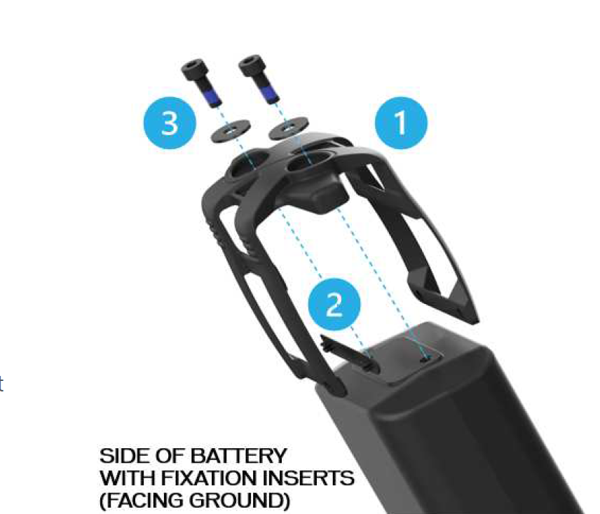

It's rare that you buy something that's actually a big upgrade from what you already have. Such is the case with my new Levo expert. The bike is magical. I'm 71 year old and I'm tackling stuff that I thought was completely impossible. After two years and two bikes and about 3K miles of single track, I thought that I was about where I'd always be in terms of skill, but not on this bike. It's a monster truck that turns like a Porsche. Coming from XT brakes, I don't love the Code brakes, but my shop got them set up pretty well and for now I'm ok with them.
I've had the bike for ten days and I've logged 150 miles. I'm not very good at figuring out where noises originate so I'm looking for a little help.
When charging down hill on rough track there's little rattle coming from somewhere. It sounds more like something is slapping. I'm heading to my shop but since I can't duplicate it on the pavement, I'm not sure they'll be able to locate the issue, hell, there might not even be an issue.
Typically its the battery. the plastic sleve mounted to its end should really sit tight if you push it up the downtube.
If not check if that piece nr.2 is there:
I have the same constant rattle, i bought the Sworks and the dealer couldn't sort it out so swapped for a Pro, same issue, I have taken the battery out same, checked pivots same, rear brake hose adjustment same, so no idea where the rattle comes from. as said, only rattles when going through trail chatter.. i give up, dont know how to resolve this. Sworks went back to Spec HQ, they rebuilt it and rattle gone, so they dont know the fix either
What a pain. It's got to be the battery. This a known problem, that is why they mention it in the workbook and sell the kit to fix it.
I should not have read this thread! Today I suddenly had a rattle as well. Checked whattever I could check on the trail, I even put a peace of bark under the battery sleve to make it thicker, but no way....
Maybe its the cables?

About that battery rattle, I went to my dealer today and they said that the little plastic piece that's required on S4 and up was taped to the inside of the shipping box and probably it got tossed so they are ordering another.
I thought the same, so removed the battery and rode over some roots, same rattle. It’s not the battery, also the dealer put foam spray in the frame to check it was not cable rattle, still rattles. Only when riding and going over roots/trail chatter.
So guess our Levo’s now sound like shimano motors are in as they have the same rattle:(
The dealer put foam spray in the frame?? Like expanding foam? Please clarify :unsure:
yip expanding foam in key areas where they though it could possibly rattle, needless to say I wasn't too pleased and still rattled anyway...
I have given up looking for it... 1 or 2 pivot bolts where not torqued correctly, did those, still rattles.
